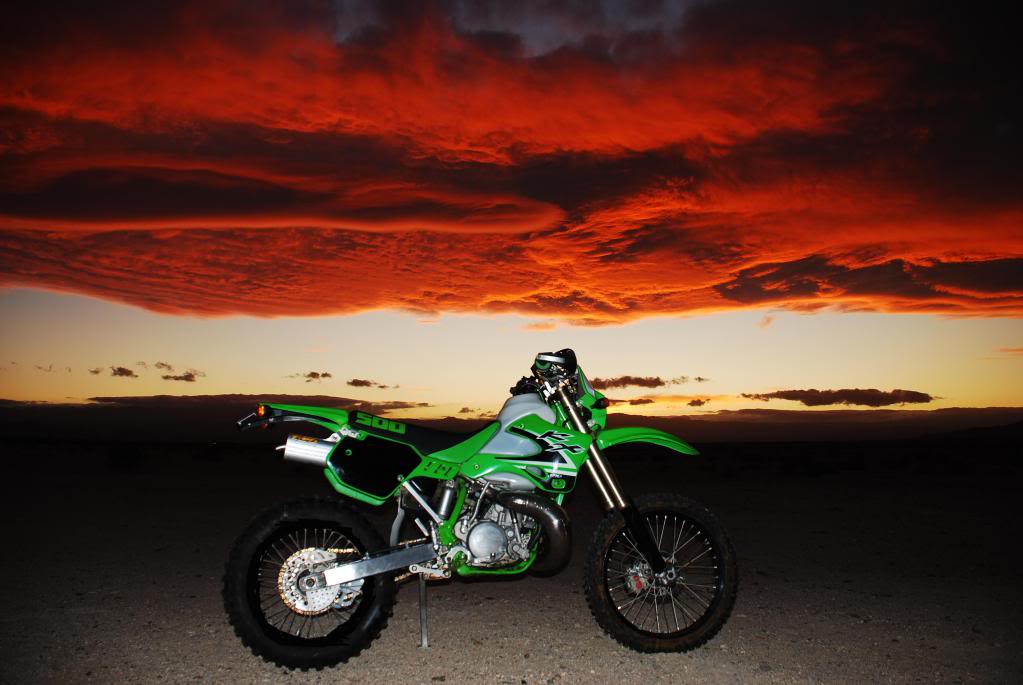

Out riding around today....
Didnt even feel like I was stringing her out... Still had more to offer!! evil
MUCH BETTER THAN BEFORE EH DOUG!?

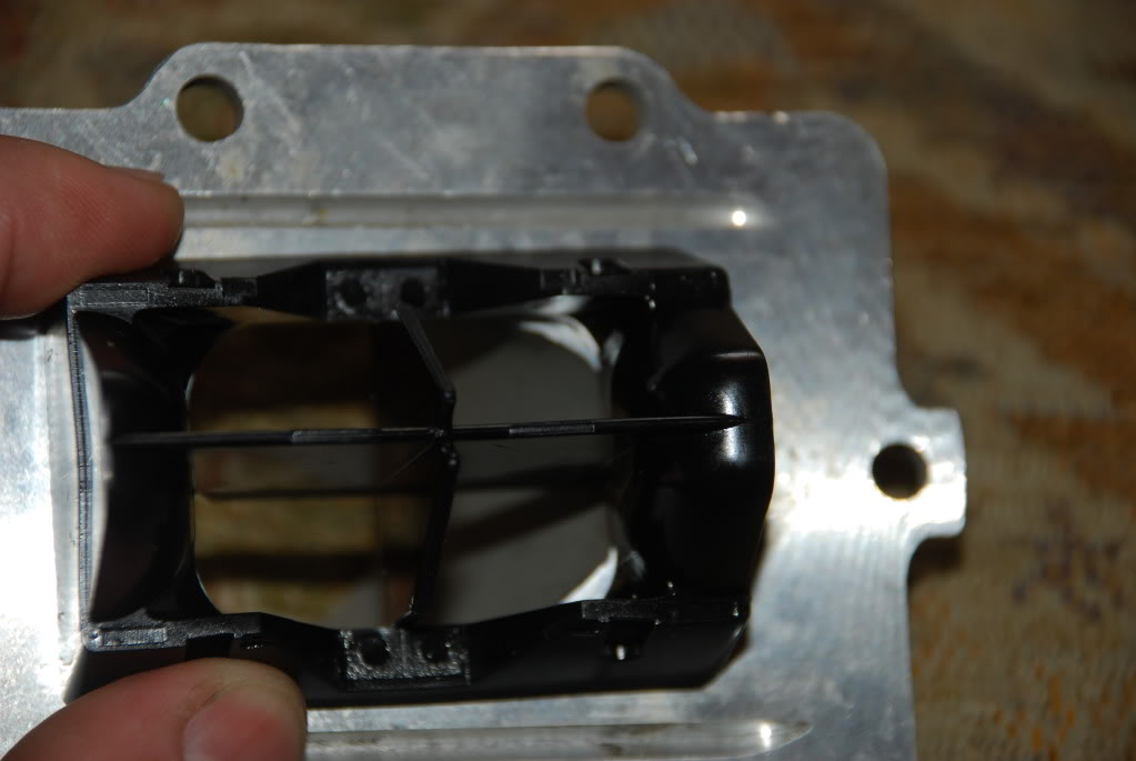

AND NOW for tomarrows project while at work ... afro
reed stuffer from a 2004 kx250 layed ontop of a cut rad valve..
Motorrads Jeff Wards Engine build round 2 9-99999-9.jpg (56.58 KiB) Viewed 7583 times
Ran a bunch of math... and the stuffer is the same volume as 38MM hole (carb)..(SHOCK thats what the 2004 Kx250 came with carb size)... so Im going to take some off the edges to get it out to 39mm worth of volume... then BUILD UP a s**t TON of weld on the Rad valve... so I can make the RESTRICTIVE hole in it match the reed stuffer from the 2004 reeds... Blah Blah Blah....
Volume wise... SAME SIZE HOLE from carb mouth to reed tip...
should get Intake velocity up a BUNCH A MUNCH...
Even though the hole is a bunch smaller than stock Kx500... the 39mm Keihin will only flow so much CFM's so should the rest of the reed block etc, as its setup for the same size carb, and volume wise (I know not exactly always the best determining factor of CFM rate) its the same all the way through...
My only worries,
#1 Not being as wide, it may starve the boost ports. But many members used to run the kx250 Vforce with good results, so why not..
#2 volume loss due to narrow reed (crank case volume).. perhapse not a big issue on my bike with the stuffers, also the smaller intake trac may make up for it...
#3 If the reed setup shows promice I can machine some delrin "stuffers" to bolt to the cage to fill that extra volume...
am I missing anything here?
Oppinions? thoughts?

Id be interested to hear your thoughts on the bored to 39mm rad valve up to the Kx250 reed cage Larry.. VS a stock Kx500 cage
I know that reed doesnt have the Face area that the K5 one does... but it may not be an issue for a Non Drag motor

no one has any thoughts on this?
its way backwards from what everyone is doing... (big carb big this, big that)..
But My thoughts... if the transfer tunnles are already known to be too big... (they goofed).. then like Kawrider said... why do ya need a 46mm hole after a 39mm carb? I measured the reed tip area today on the 250 reed's... not much differant than the 500 ones.. due to less dividers.. I realize that this wont be making power at 9000RPM etc that everyone is fairy tail chasing (drag guys and hill climb guys I know.).. But in the desert if I can make more power at 1000RPM lower than everyone else without giving up too much up top...... Im faster..
Perhapse it wont work.. but I have to try it..
Same size hole from carb mouth to Reed Tip is good in my head...
The carb signal will be good, and there wont be all the dead space to pull before it starts sucking on the carb... so perhapse a more compleete fill...

Definitly some sound logic in not over carbing a motor ,but I would wonder about it with the thought that a 250 can run a 38mm & still be smooth. If a 500 only turned half the rpm then bingo thats the size. If you look at a banshee with a 175cc cylinder 36mm carbs are the sweet spot. I think Larry's coment on playing with the pipe might be more likely as to getting the tune set where you want it. I ran a low pipe on my kx525af build "cr500 gnarly" & it didnt seem near as good as down low the stock kx500 with a fmf gnarly. Like the 86 cr500 I'm riding now, part of their magic was room for a fuller length pipe. Thats why I'm trying a topend cr500 pipe for the af this go round. I do like the idea of keeping the intake tract the same diameter all the way down, but I'd still vote bigger. Maybe epoxy stuffing the transfers to get the pressure of the charge up, it will certainly help feed the lower end power.
Or bigger bore & stroke to help make the transfers the right size evil

Like I said before... I realize the pipe is an issue on the K5.... it always will be... and I have chosen to work within the perameteers of my pipe... being it was the last new one avail... EVER... and I love the Tank that goes with it, for desert race...
Mine are already stuffed (JB welded) (transfers)..
Going to play with Bigger Bore and stroke later on.. evil
But a 39mm hole has roughly
1194mm?
The 250 reed stuffer has roughly
1139?
So with MINIMAL massaging... it is the same size..
If you all know anything about V8 chevys... Ill take good intake velocitys over BIG CARB'S any day of the week...
if it shows good promice..
I will be testing this next.
