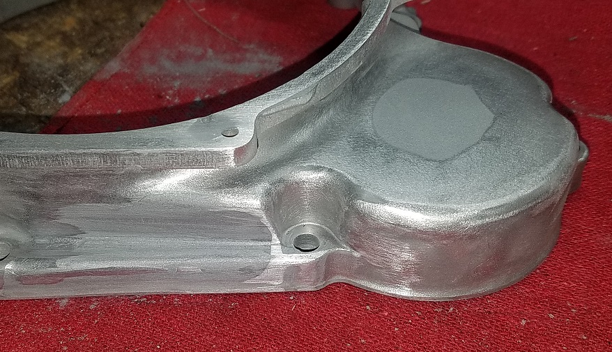

Before I go any farther... I'm going to test this filler for expansion due to heat...
I hope it holds up well but that's why you experiment.. :shock:

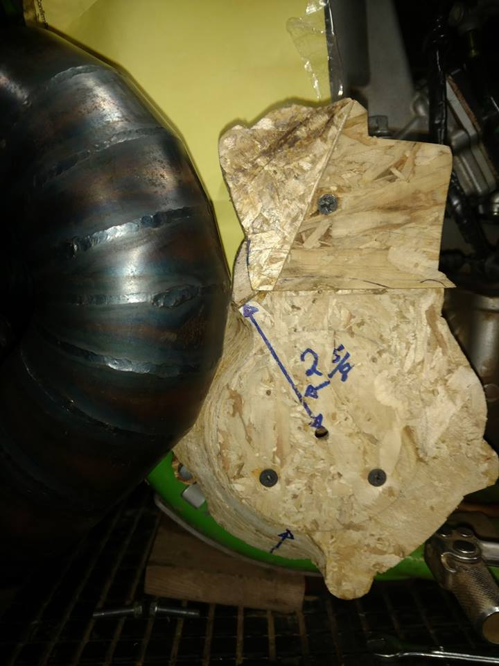

Posted: Wed Nov 22, 2017 3:31 pm
Here is the template for the electric starter after Mathew modded it a bit more.. 8-)
KX GURU RACING 2016 KTM 250SXF KX500 CONVERSION PIPE 171.jpg (68.28 KiB) Viewed 10336 times

Ok... the fillers did not work.
Every time I got the temps up much past 250f the putty would crack.
So, enough playing with the putties and fillers..
I took the cover to the welder and had him fill it in :o
KX GURU RACING TSR BUILT BILLET KX500 ENGINE CASE with a 2 piece clutch cover 129.jpg
KX GURU RACING TSR BUILT BILLET KX500 ENGINE CASE with a 2 piece clutch cover 129.jpg (629.98 KiB) Viewed 10306 times
I have a little work to do just yet on it but making good progress...

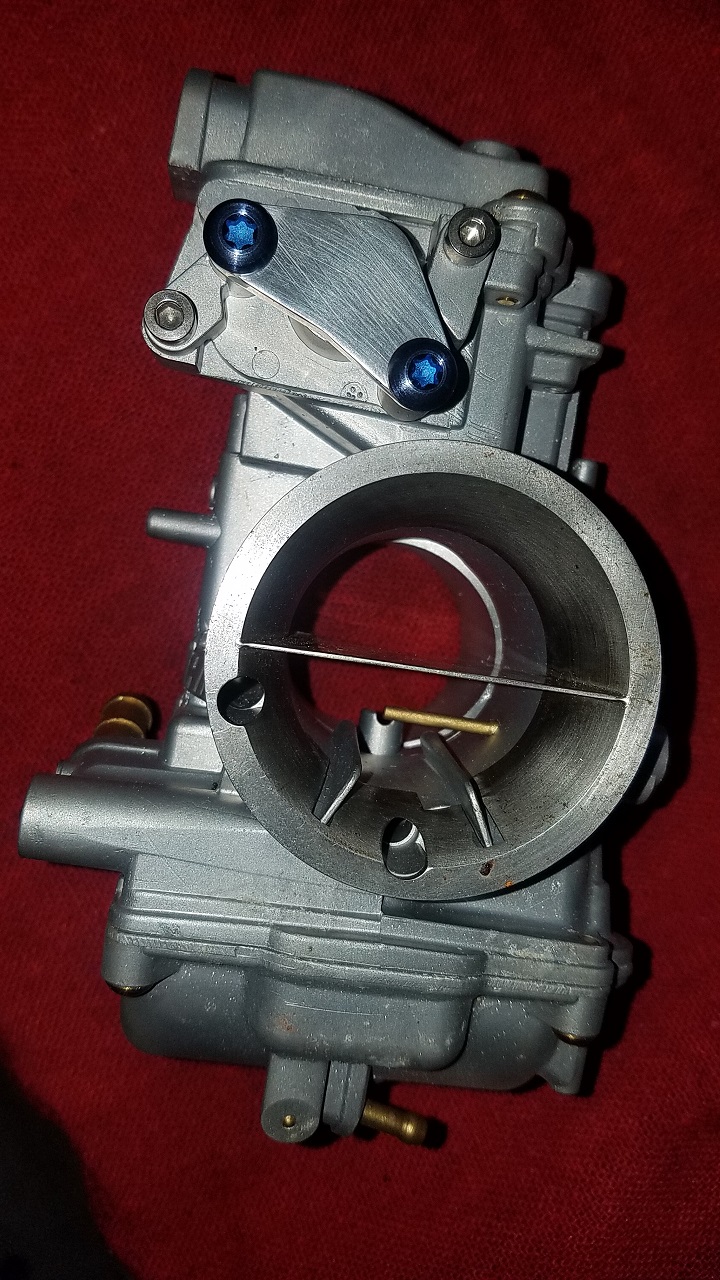

I almost have this carb ready to go..
KX GURU RACING KTX500E BUILD CARB 127.jpg (364.98 KiB) Viewed 10305 times

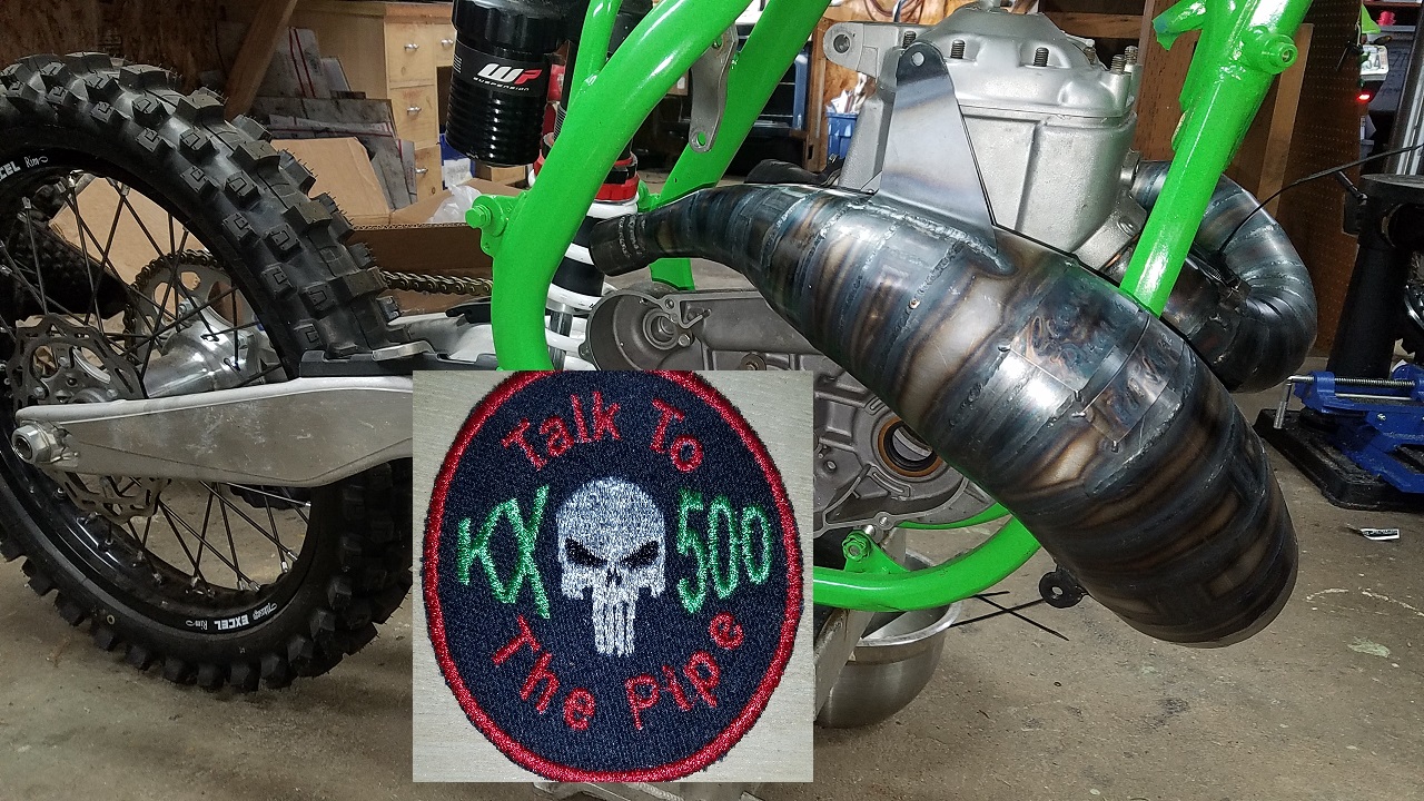

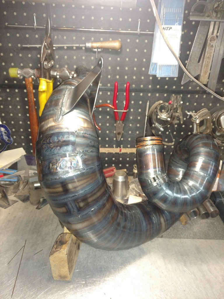

The pipe is in but needs a bit of work yet..

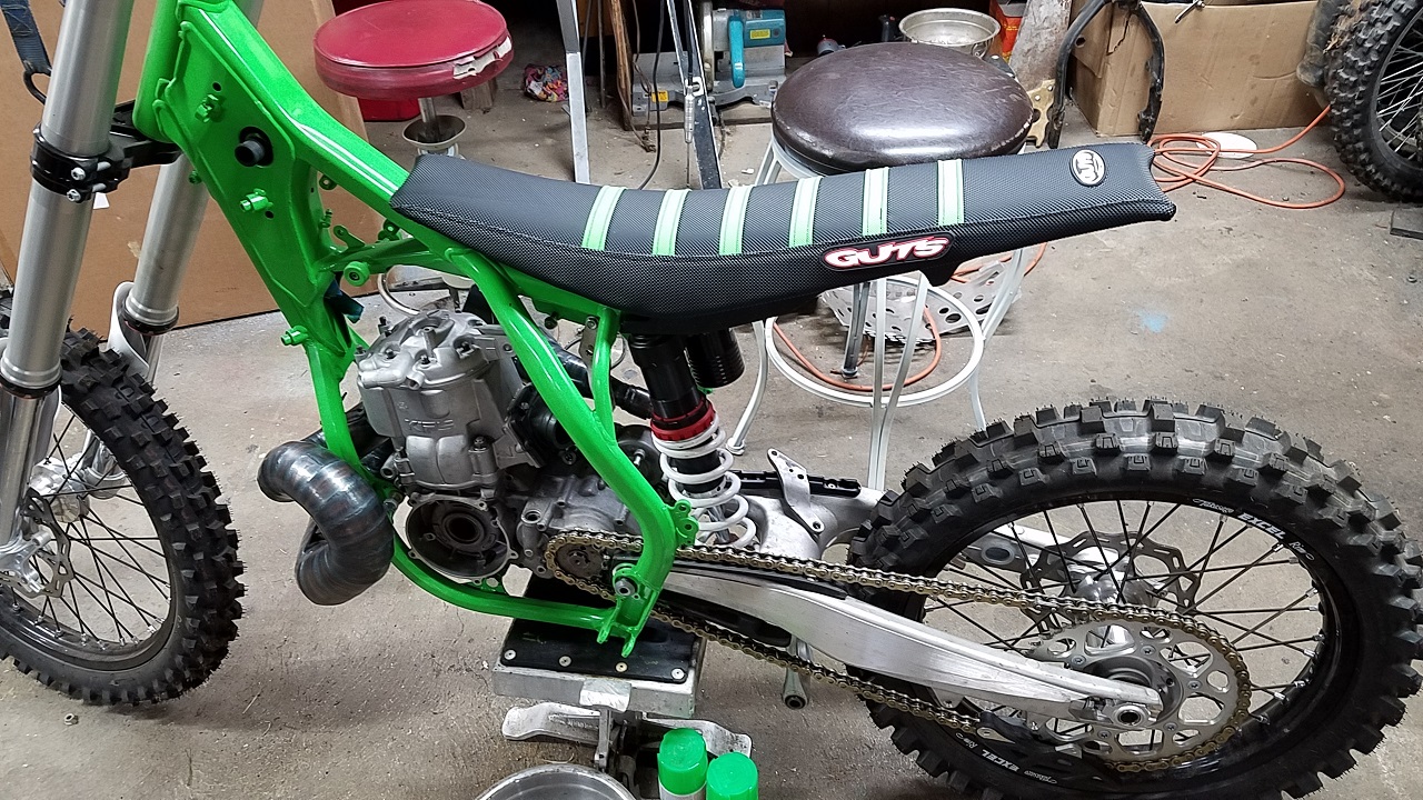

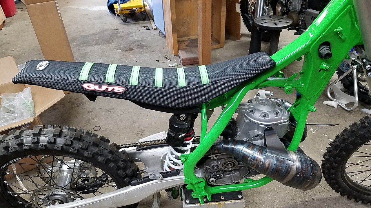

One of the many issues you run into when building a conversion is lack of color availability.
I have been working hard on stripping off the pumpkin rind and replacing with the beautiful Kawasaki Green scheme..
When it came down to the seat, nobody made a Kawasaki color scheme for the KTM..
What to do?
Oscar from KX Guru Racing called his buddies at Guts Racing and they set me up!!!

Check this work of art out...
kx guru racing guts racing custom seat 101.jpg (497.84 KiB) Viewed 10251 times
kx guru racing guts racing custom seat 102.jpg (494.82 KiB) Viewed 10251 times
Not only did they nail the colors but they used a soft foam which is very important when you get older and realize that your no longer a iron man :lol:
Thanks Guts racing, I really, really, appreciate it!

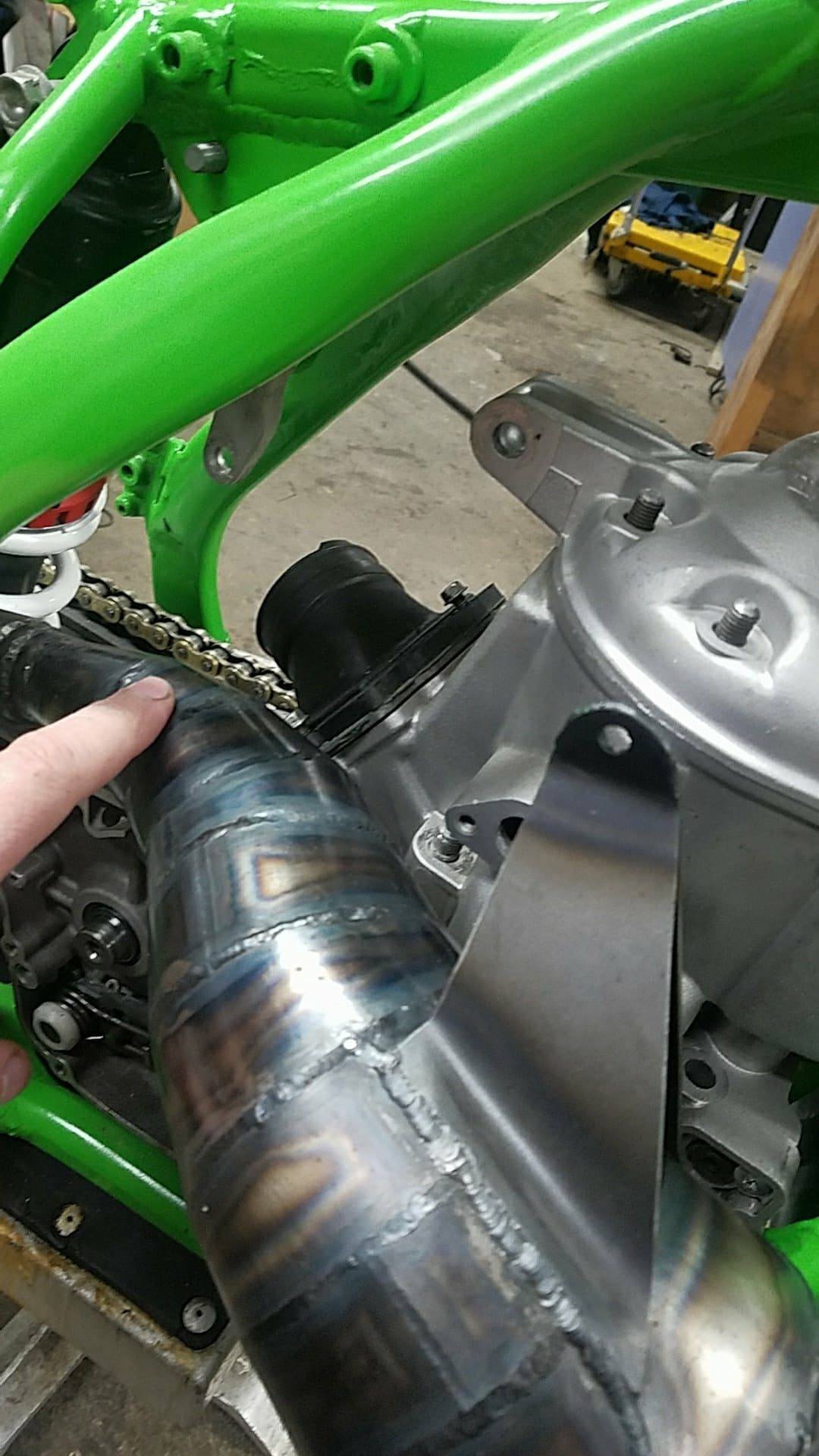

The pipe came with some mounting brackets for the pipe to the chassis..
I have to either figure out something for this mount or I have to move it :shock:
It would be nice to move the bracket back here..
