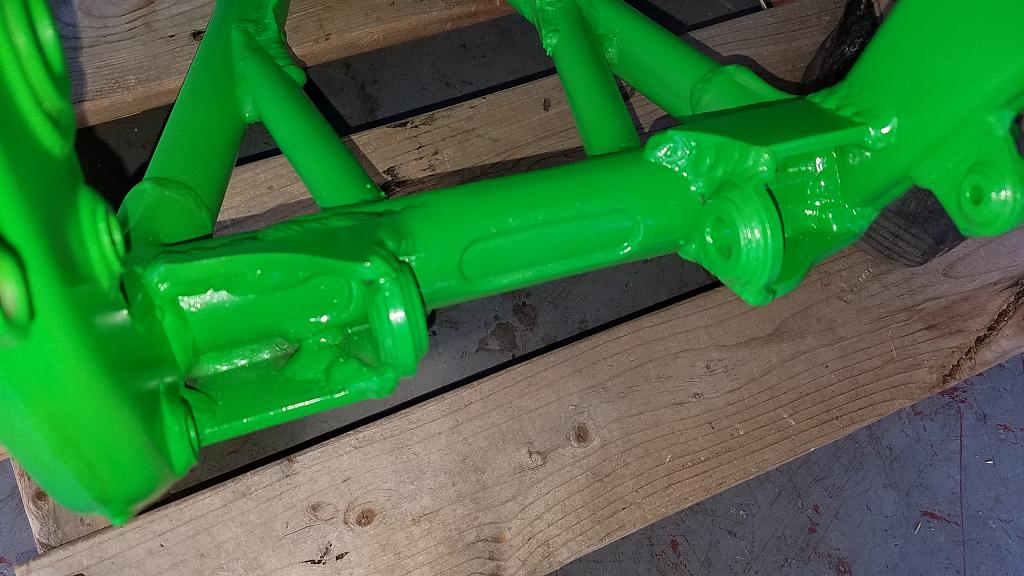

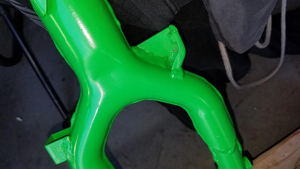

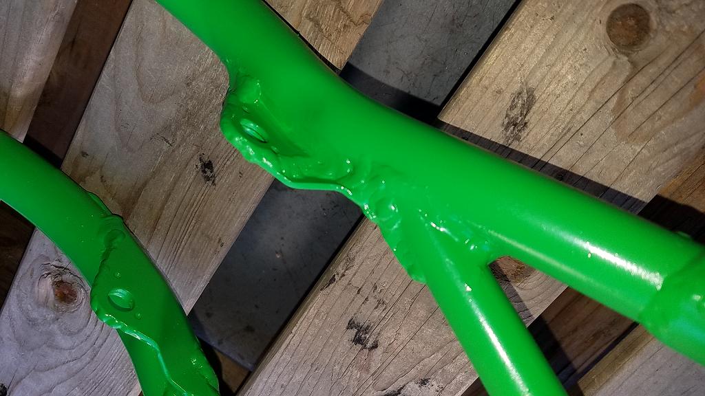

Hopefully these will never be a issue for Sean again.

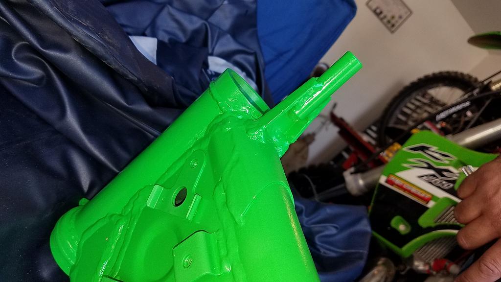

Steering dampener post
KX GURU RACING SEAN COLLIER KX500 371.JPG (87.6 KiB) Viewed 9713 times

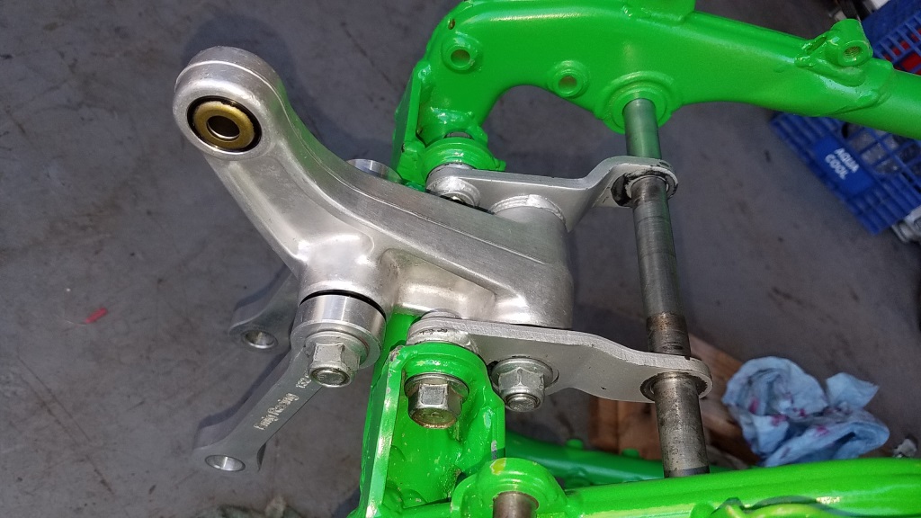

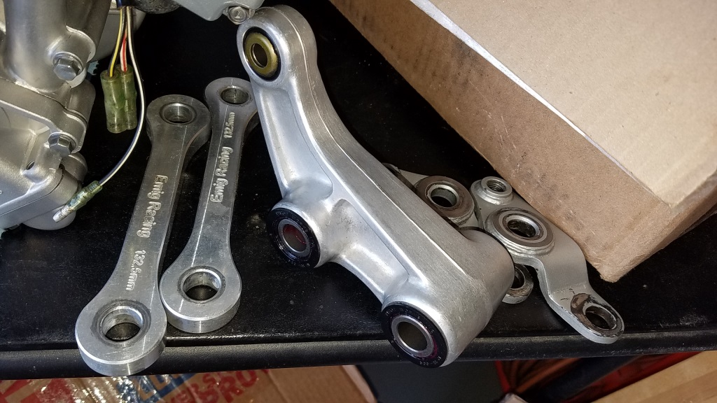

Suspension linkage... Everything was cleaned in the bucket and every bearing and seal was replaced.
KX GURU RACING SEAN COLLIER KX500 381.JPG (215.6 KiB) Viewed 9698 times
Emig dog bones were used to help change the KX500 handling characteristics..
KX GURU RACING SEAN COLLIER KX500 382.JPG (173.85 KiB) Viewed 9698 times
With about an hours worth of scrubbing these sure came out clean ;)

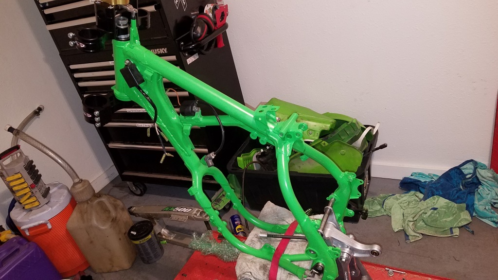

A little more progress...
KX GURU RACING SEAN COLLIER KX500 383.JPG (198.38 KiB) Viewed 9697 times
And a little more..
KX GURU RACING SEAN COLLIER KX500 384.JPG (238.67 KiB) Viewed 9697 times

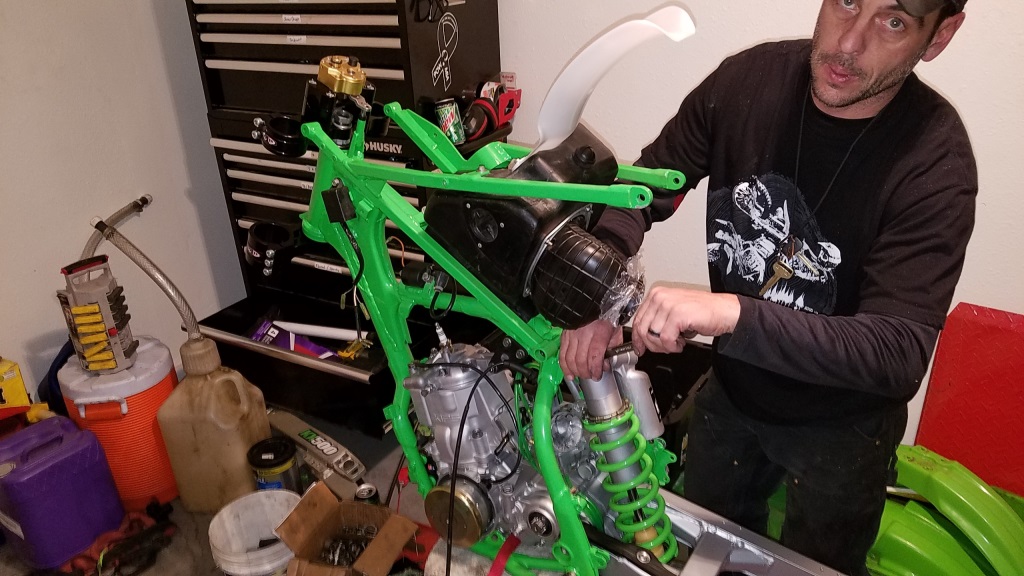

Check out that Pro Action suspension... Nice!

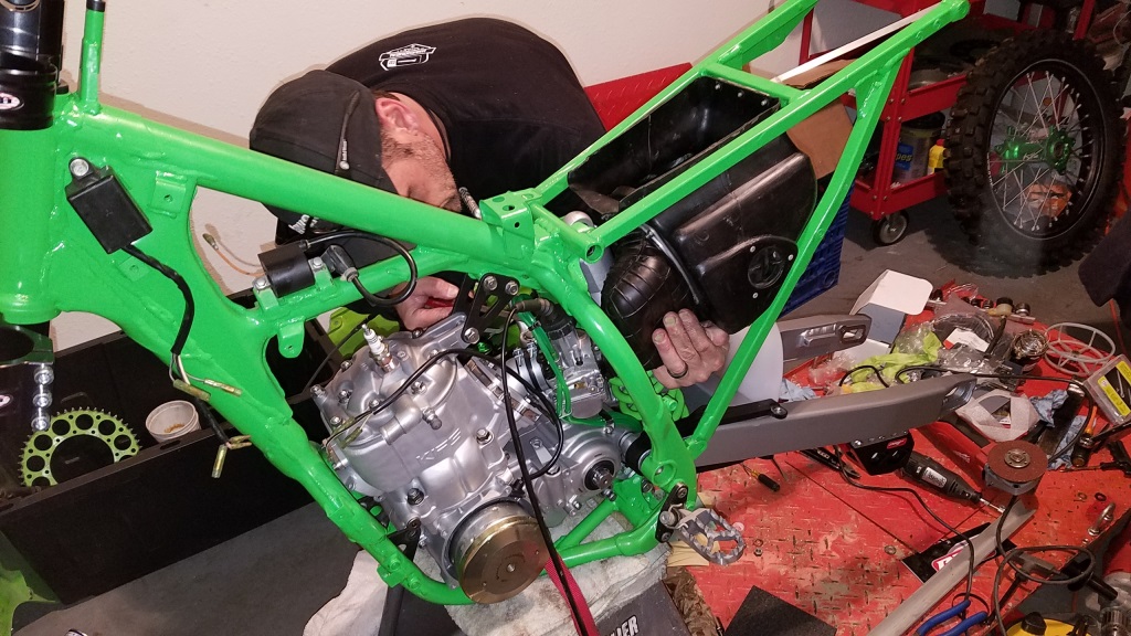

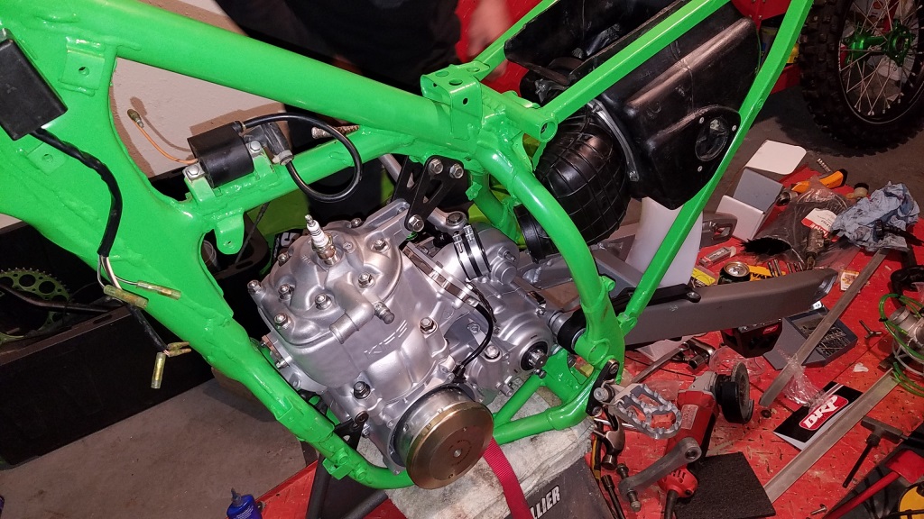

Jason is hooking up the boot to the inlet side of the carb.. Always a pain when dealing with a 20 year old piece of rubber and using a 10mm reed spacer... But, a lot easier to do it now then after the bike is built :lol:
KX GURU RACING SEAN COLLIER KX500 387.JPG (257.33 KiB) Viewed 9694 times
