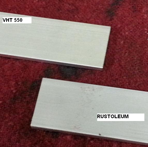

After 1 hour the Rustoleum is gone :o
After a hour the VHT 550 is still there but gooey :(
PAINT CHOICES FOR COMPARISON 102.JPG (38.29 KiB) Viewed 9061 times
Tomorrow we will test the other two products.

Right cool project. I've use vht stuff on a pipe before, baked on per instructions. Didn't stick for .... Went back to good old barbecue black. Be sure to scratch test before committing . My stuff was glassbeaded even.

Wow that surprises me.
I have used VHT for about 35 years and through several car and truck projects and always had good success.
I wonder why the problem :?:
