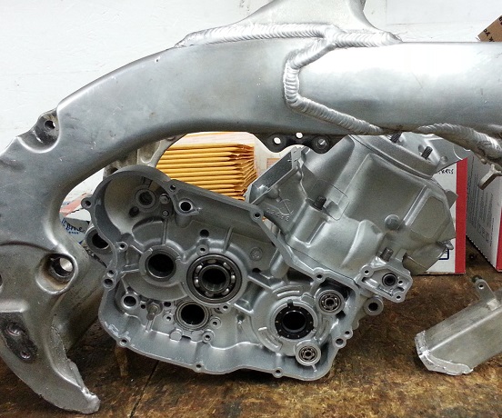

Re: 2007 KAWASAKI KX250AF BUILD

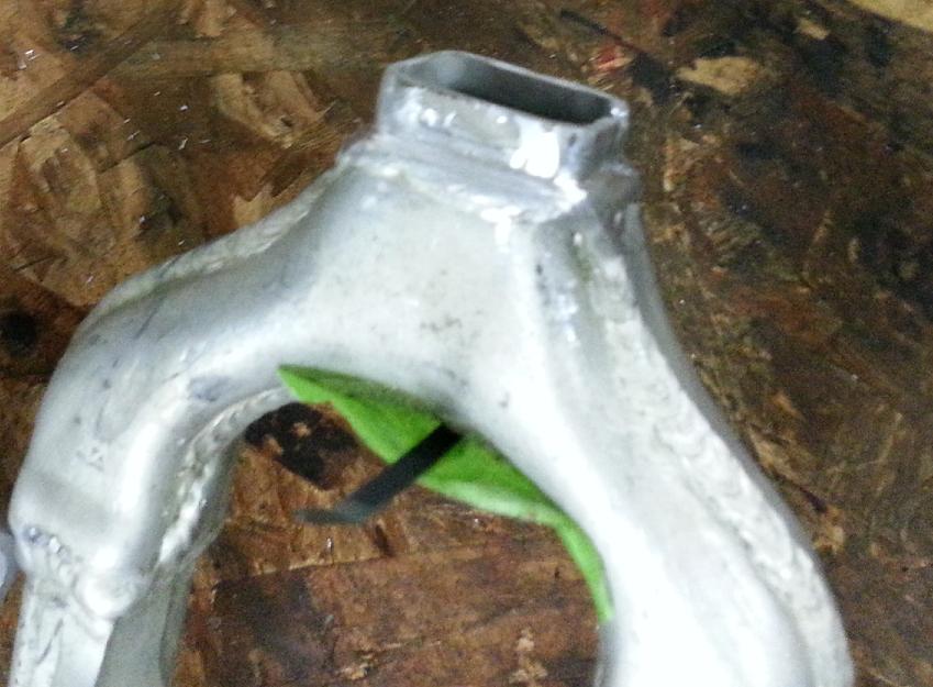

On the AF conversions, one of the problem area's is the cradle.
A lot of guys have trouble with the down tubes cracking around the engine mounts.
Just for grins, I wanted to see how Honda does their Y section and was a little surprised at what I found.
In this next pic, look at how little material actually goes up inside the main tube..
OEM-CYCLE.COM 2007 KX250AF BUILD 125.JPG (55.75 KiB) Viewed 9447 times

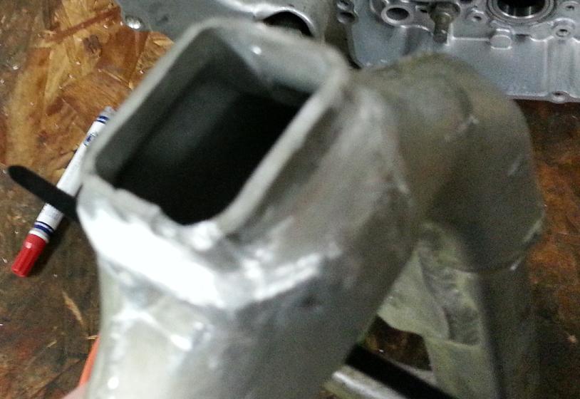

In this pic, look at how thin the tubing is.
The wall measures approximately 1/8" thick.
OEM-CYCLE.COM 2007 KX250AF BUILD 126.JPG (71.47 KiB) Viewed 9447 times

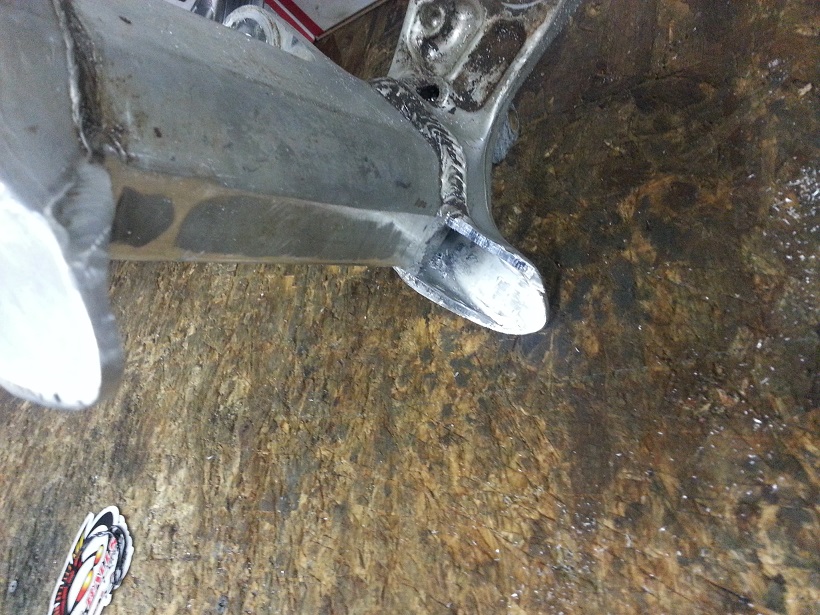

Just a little bit more trimming...
Almost ready for weld..
OEM-CYCLE.COM 2007 KX250AF BUILD 127.JPG (64.89 KiB) Viewed 9442 times
OEM-CYCLE.COM 2007 KX250AF BUILD 128.JPG (52.5 KiB) Viewed 9442 times

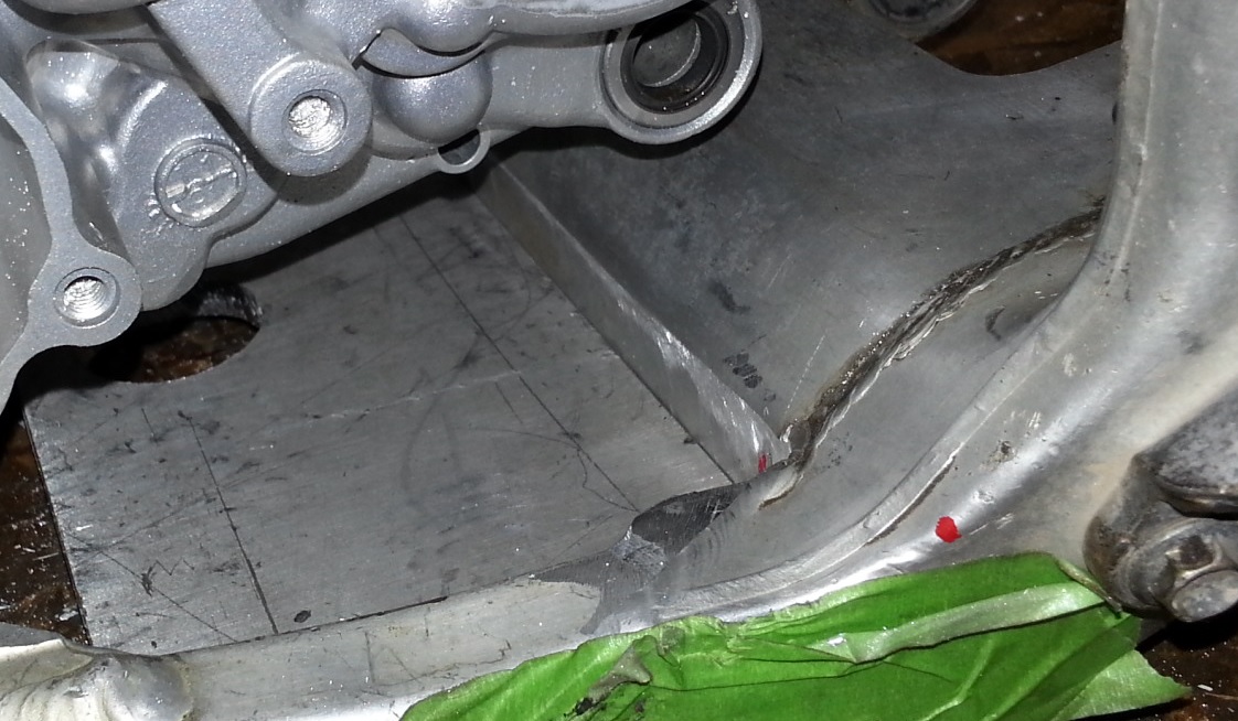

So... My buddies idea is confirmed!!!
You can use the cradle from a 01 CR250 in the KX450F frame.
It takes a little grinding and fitting but it fit's amazingly well.
And I'll tell you.... It was a L.O.T. easier fabricating it using the Honda cradle then it was building a cradle using pre-bent tubing.
And, we get a really strong Y section to boot.
The only drawback is scraping a 01 CR250 frame.
Then again, there is a lot of earlier CR250 frames on the market for cheap.
In fact, I found frames on eBay delivered for less money then the pre-bent tubes.
Time will tell if this was really a good way to go as we have a lot more of the build to go but it looks very promising.

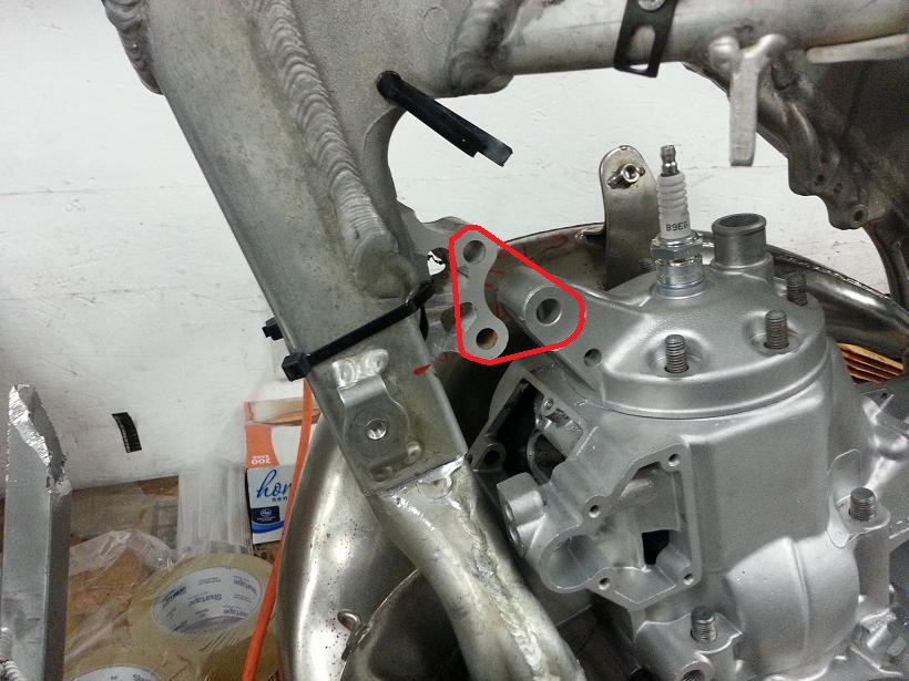

Nice clearance on the gas tank.
OEM-CYCLE.COM 2007 KX250AF BUILD 133.JPG (86.66 KiB) Viewed 9431 times
The tightest area is around the Y and the head stay.
Unfortunately in order to get the cylinder off you will need to remove the engine mounts and loosen the swing arm pivot pin, the tilt the engine back.
Not a big deal but it would have been nice not to have this issue... :shock:
OEM-CYCLE.COM 2007 KX250AF BUILD 134.JPG (70.46 KiB) Viewed 9431 times

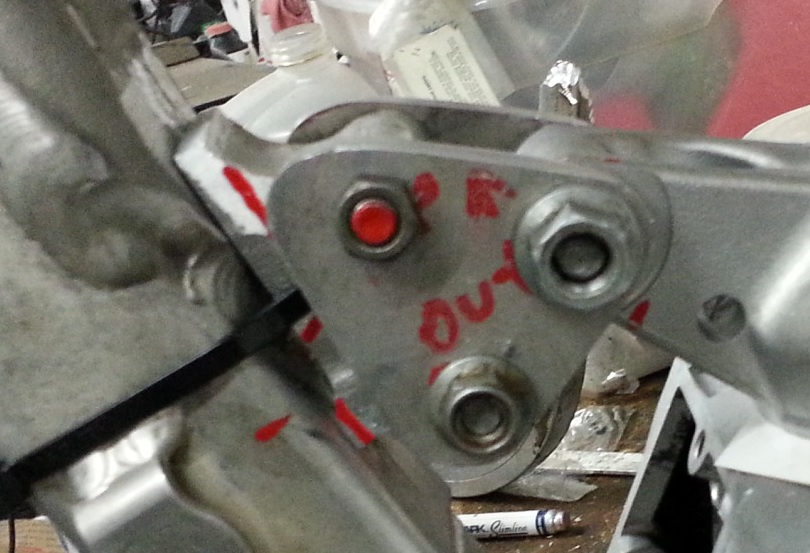

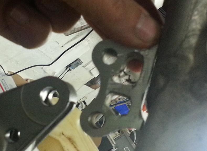

We will be making some engine mounts like this..
OEM-CYCLE.COM 2007 KX250AF BUILD 134.JPG (139.93 KiB) Viewed 9415 times

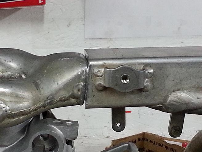

The head stay mounts are almost done.
The bolts are temporary :D
OEM-CYCLE.COM 2007 KX250AF BUILD 136.JPG (129.98 KiB) Viewed 9413 times
The rear frame rail to frame plate is done.
OEM-CYCLE.COM 2007 KX250AF BUILD 137.JPG (218.82 KiB) Viewed 9413 times
