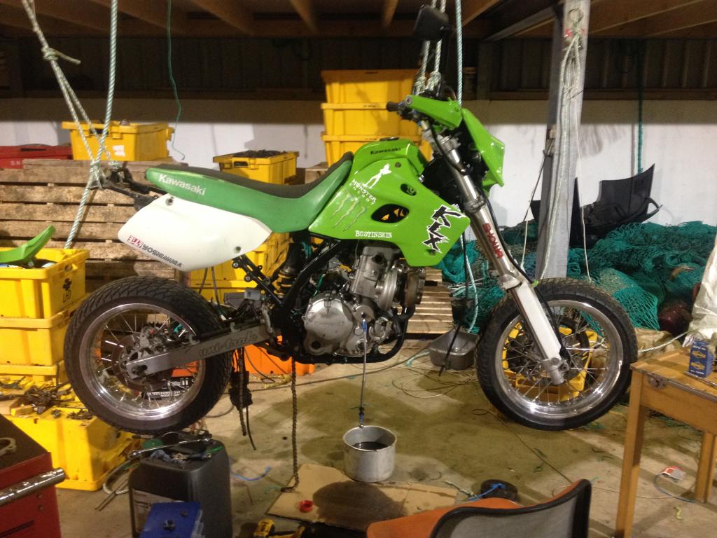

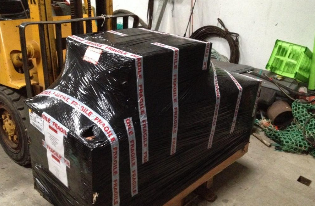

Got a picture sent to me last night from my wife, I've been waiting for this delivery. It's a lathe, just a small one but hopefully big enough to hack out some bespoke parts for the KLX build, it will possibly take a moment to get it set up and me set up, it's been +25 years since I operated one of these, when I was at the school.
I've had an idea for the plenum, I'm thinking of cutting the subframe off the bike and making up a monocoque aluminium subframe that doubles as the plenum and also houses the tank for the water/meth injection and the W/M injection pump. I got the W/M kit a couple of weeks ago and I was a bit disappointed on the size of the pump, I should have known, the kit catered for +500hp so it probably figures. The lowest point of the tank has to be above the pump and the W/M jet has to be above the pump. The battery would need to go there somewhere too so.....
If I make an integral rear fender/tank, a plenum(up to 4litres and as near to that as possible) with a recess for the battery and a tray space under the seat to put the CDI and reg/rectifier.
This is absolutely a case of easier said as done, there's a lot of fabrication there but what the hell, what is right up mu street is finding an elegant solution, something that has dual purpose, I don't have a big love of polishing things but it has to look right or it will be a constant irritation till it' is right. I'm not a stranger to changing my mind about stuff so that is only the current version, last week I was building a plenum inside the original subframe but I went off this idea because of the volume I was going to potentially loose making it fit around the subframe rails. There is a few things to go on here yet. Fuel pump, fuel pressure regulator, wideband, just saying all this makes me think of weight. But if I can get it running well and looking the way I want it, I will perhaps have to be content with that.
It will be a couple of weeks before I get some time off again so I've ordered a couple of books on metal turning and I'll swot up on that so I refresh my memory on the lathe and find out about turning stainless, I didn't do any of that before and I would like to make a couple of exhaust parts out of that.
And that's all for now, what do you think.? Am I barking up the wrong tree?

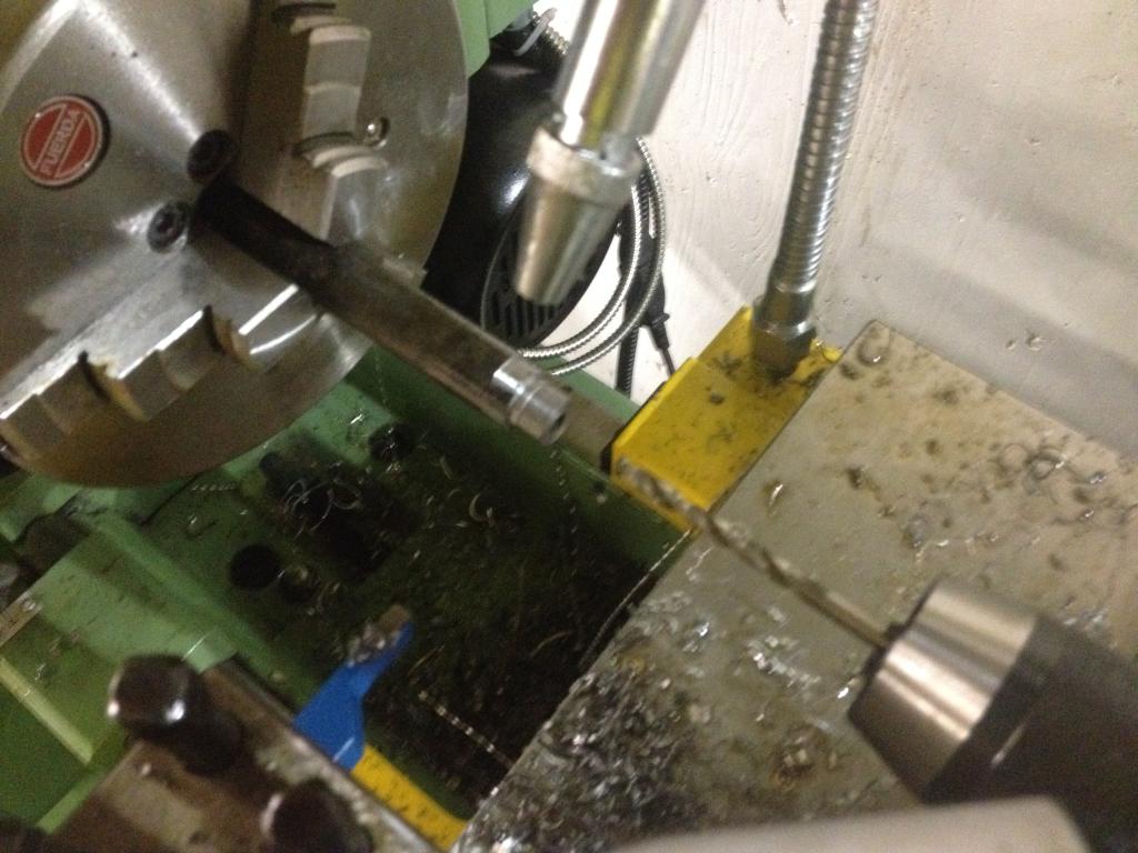

Got a bit of old bar that was lying around. It wasn't even straight.
Crofter985 klx650c supermoto build 105.jpeg (95.59 KiB) Viewed 10779 times

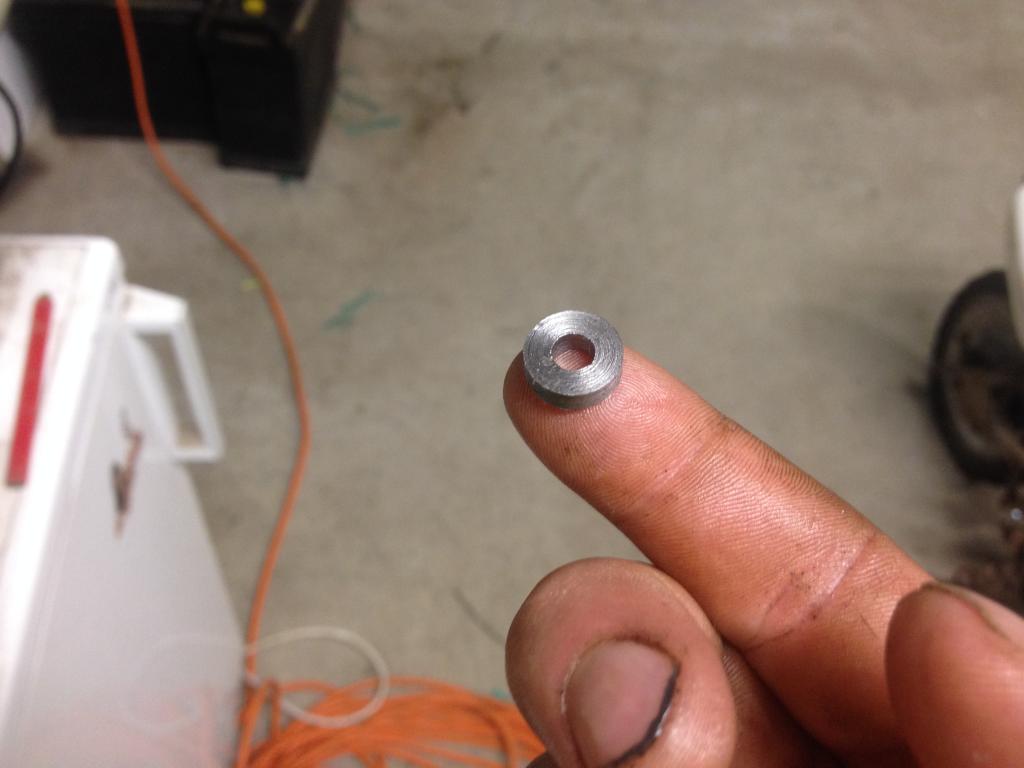

Turned it down to just under 12mm, drilled a 5.5mm hole down the middle.
Crofter985 klx650c supermoto build 106.jpeg (50.41 KiB) Viewed 10779 times
Then parted off a bit that looked big enough.
Crofter985 klx650c supermoto build 107.jpeg (97.39 KiB) Viewed 10779 times

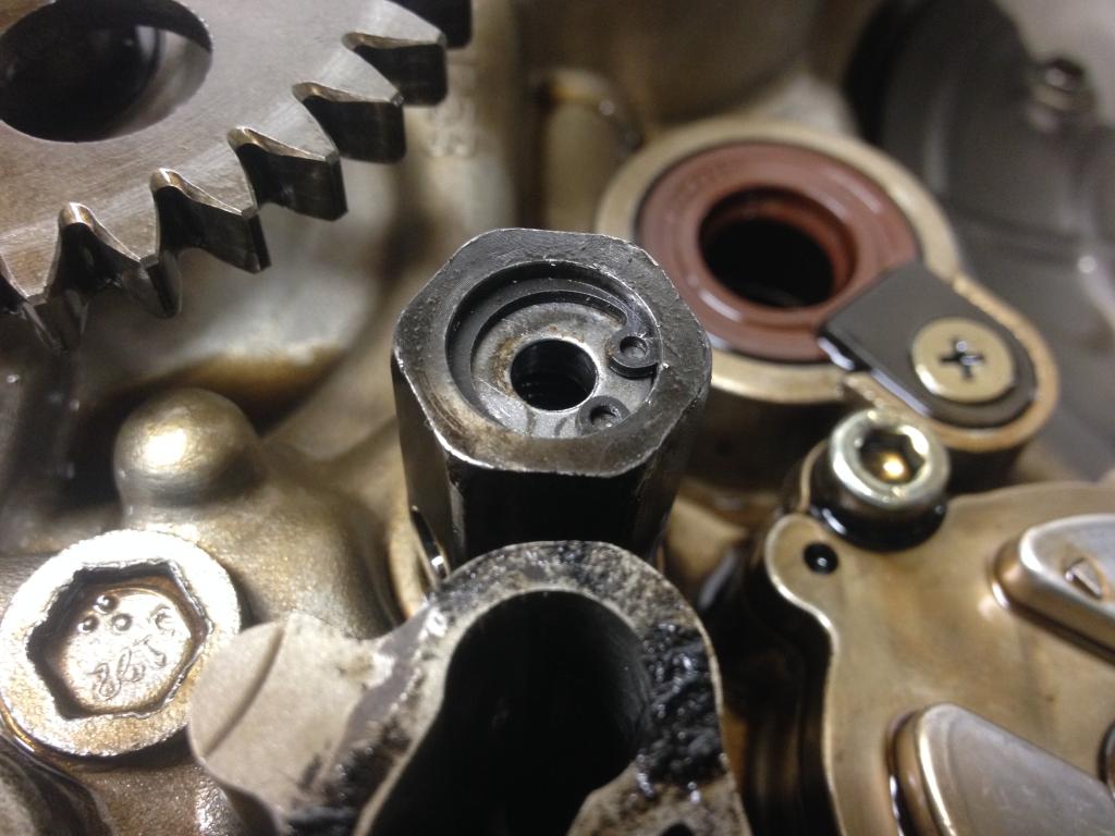

This is the relief valve, I've taken the retaining circlip off....
Crofter985 klx650c supermoto build 108.jpeg (79.89 KiB) Viewed 10779 times

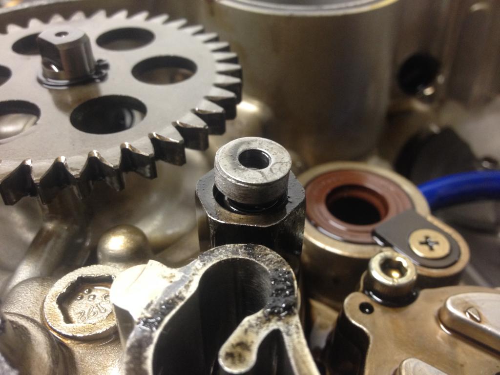

Spacer under the washer and on top of the spring.....
Crofter985 klx650c supermoto build 109.jpeg (84.85 KiB) Viewed 10779 times
And circlip back on. Spring preloaded.

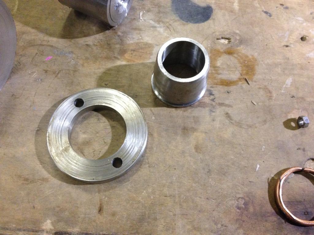

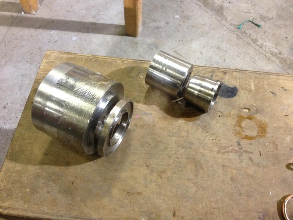

Turned the exhaust stub and a flange to press down on the stub out of some bits of stainless.
Crofter985 klx650c supermoto build 111.jpeg (105.25 KiB) Viewed 10779 times
Another view of the parts.

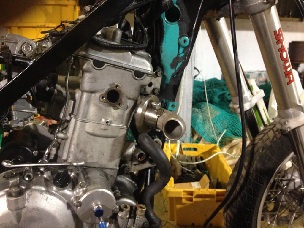

That's it together and on the bike, I've tacked a 1 1/4" 90' elbow on to it and if you look close you can see a red line which I drew on it that is in line with the seams in the side cases. I cut it there next on a chop saw.
At this stage I made up these three alloy spacers, they are to space off the radiator, it was too near the exhaust stub and flange, well it was the rad hose that was the problem. This should sort it, they are 14mm long, I might shorten them yet but ok for now.

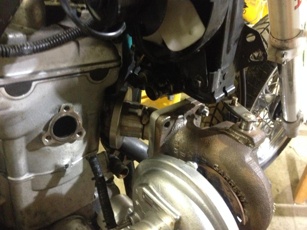

Here's a few problems to overcome. Oil line adaptor is too long, fouls on one of the m5 bolts holding on the compressor housing on. And the oil line fouls on the waste gate actuator, same problem though as shortening the oil line adaptor will fix this too.
Also now I've rotated the turbo around so it fits the new application, the holes in the outer edge of the compressor do not line up with the holes in the waste gate actuator. I've just had a thought, it might be able to be turned around? Failing this, I might drill and tap some new holes to line up with the holes in the bracket.
