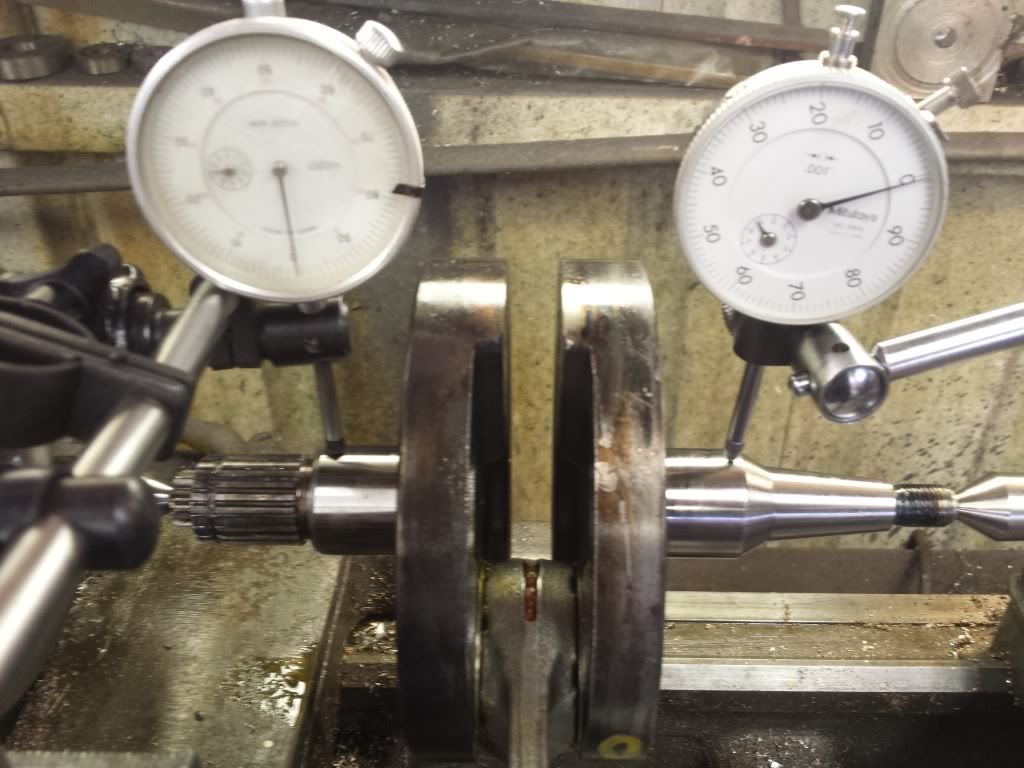

Motorrad;
Huh. Figured I'd get some comment about something. Like how dirty my lathe is. Etc..
sandblaster:
Nope, didn't want to hurt your feelings.... but now that you mention it.... A happy lathe is a clean lathe.... Wish I had one... grin
81cr450:
d**n so what your saying is only .0005 runout. I was way off

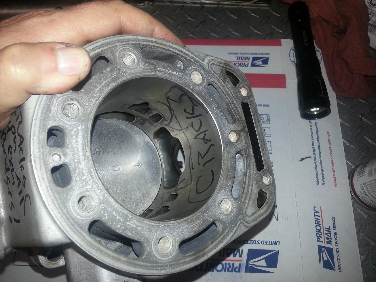

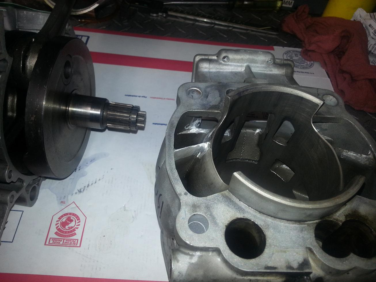

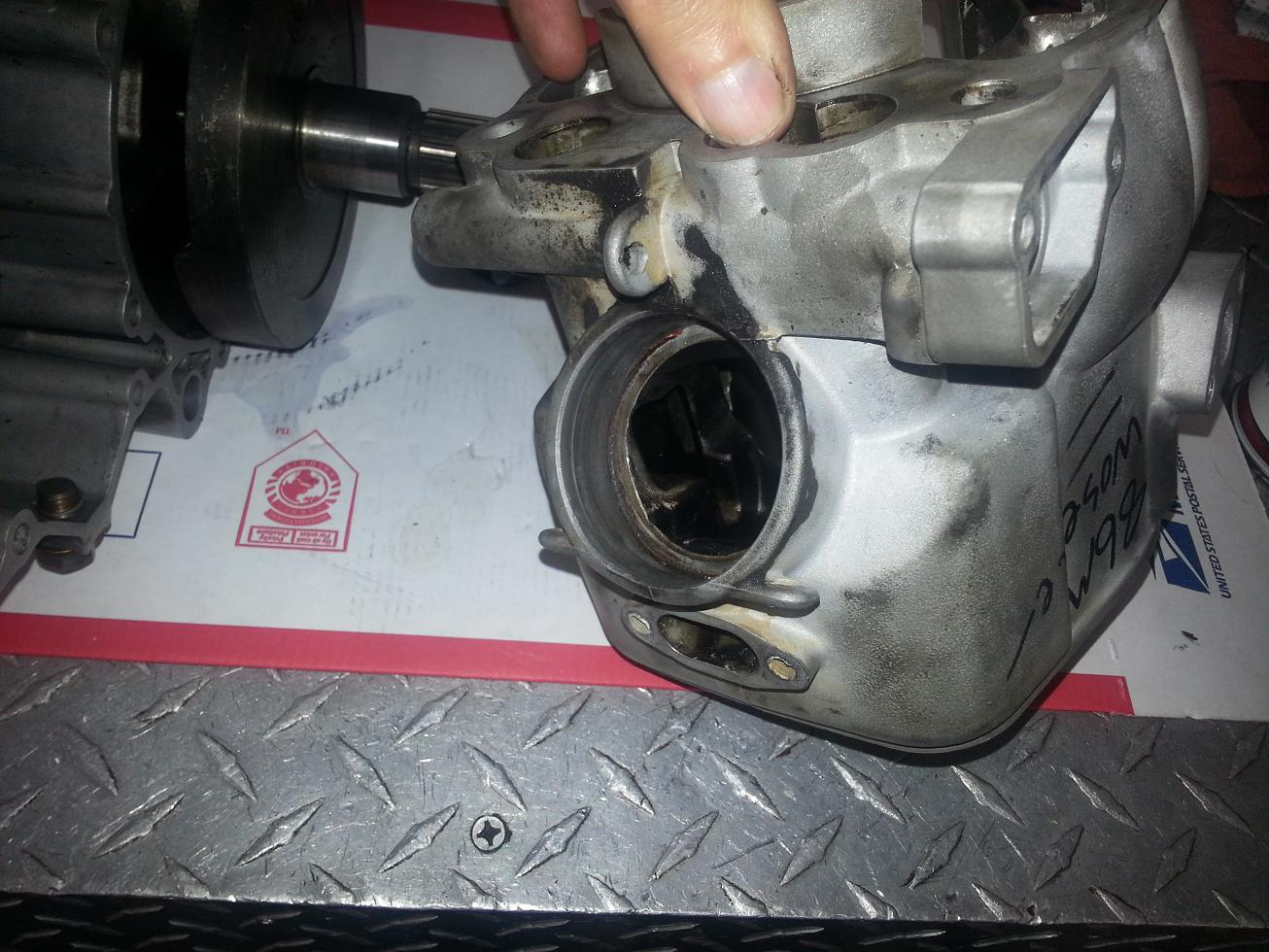

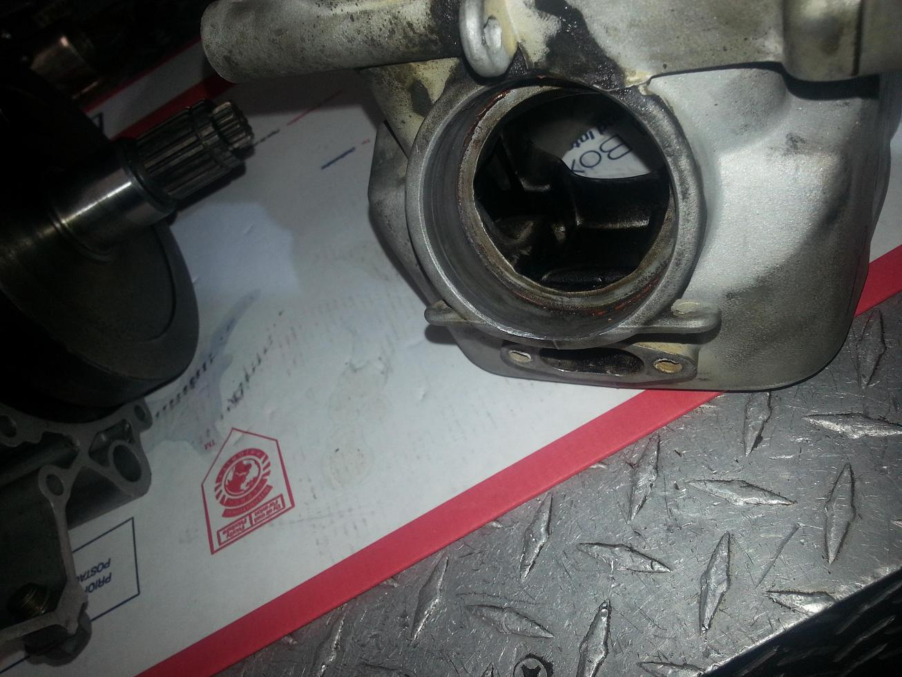

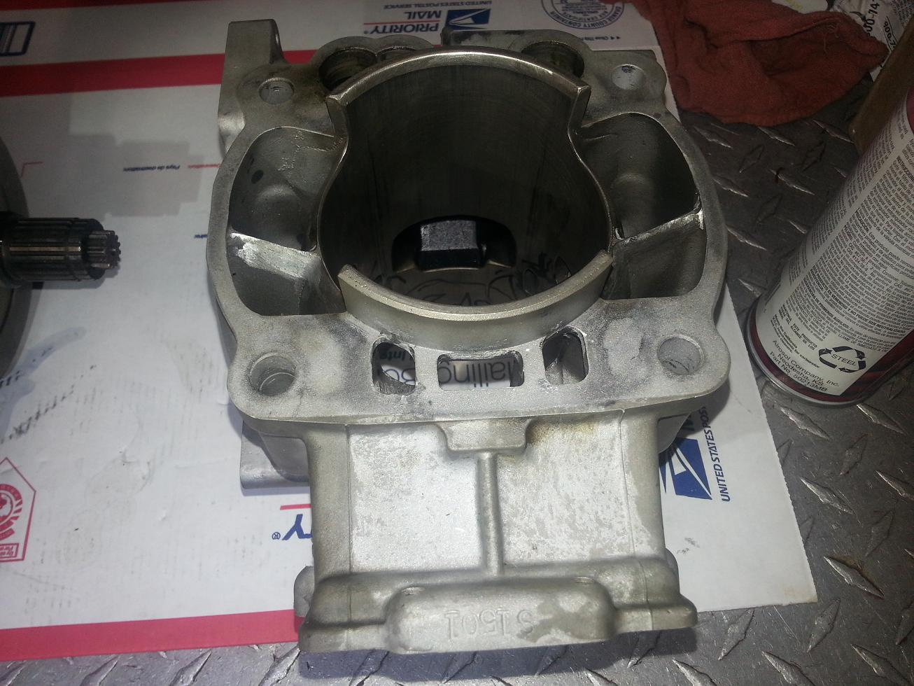

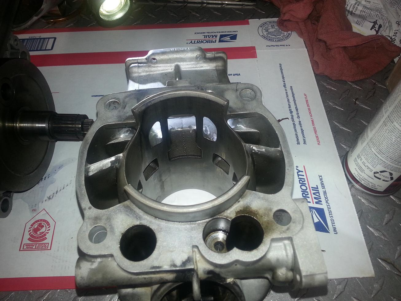

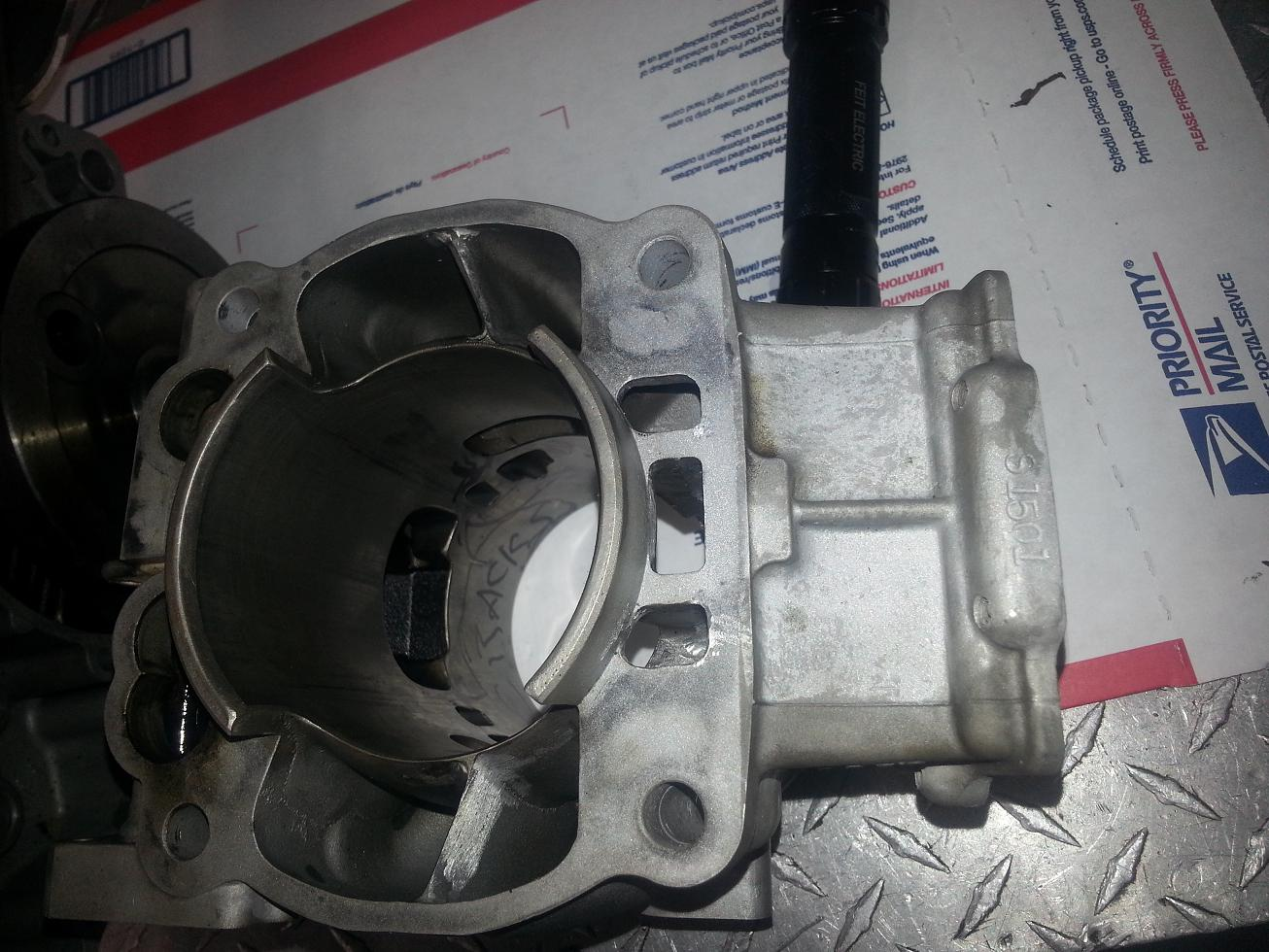

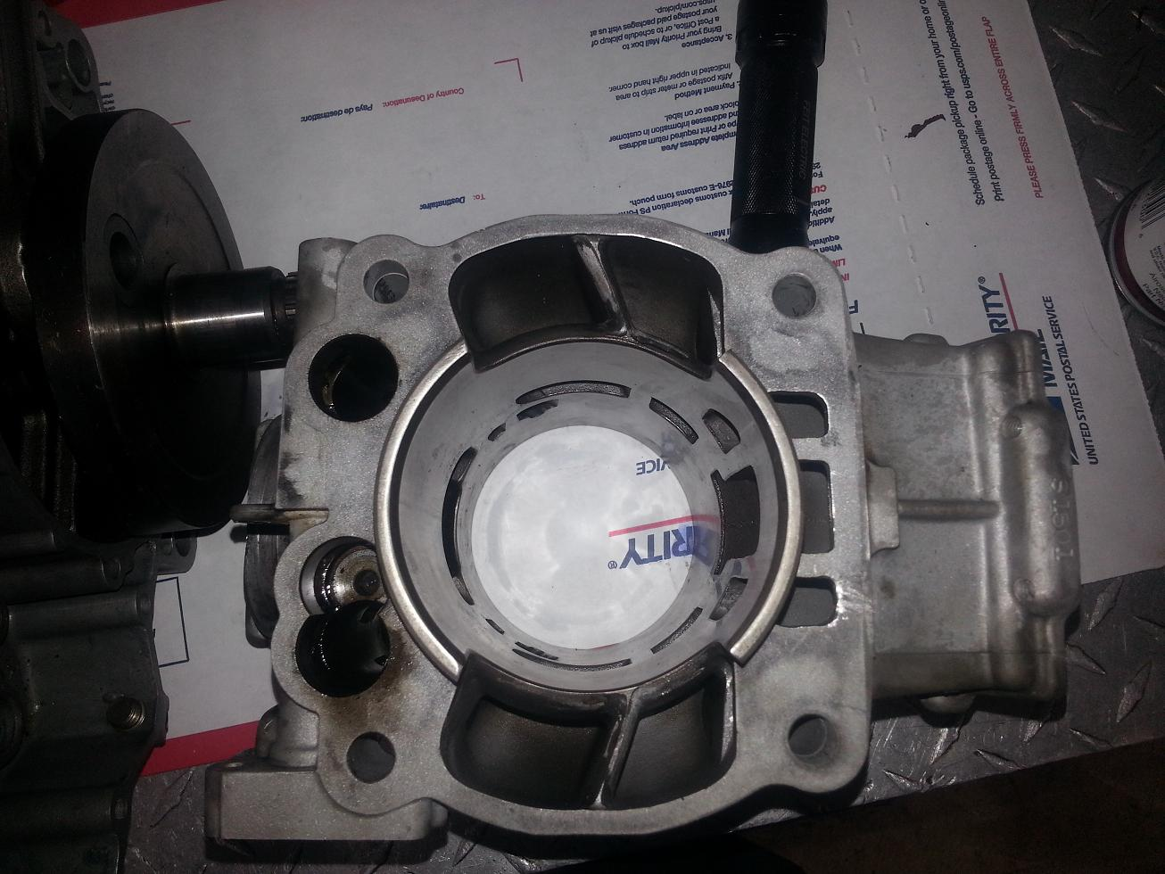

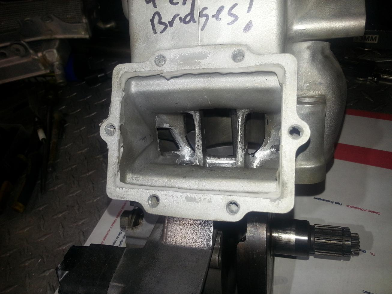

I received Motorrads jugs today.
I was real busy so I couldn't inspect the jugs until this afternoon.
When I finally had my hands on the jugs they were everything I expected and a whole lot more grin
Funny thing is previous pics I saw of the jugs was showing something I should have seen but I completely missed it....
sandblaster:
I'll start with Oscars M cylinder first..
If you want to see larger pics go here:
posting.php?mode=edit&f=5&t=566&p=2186

motopunk:
thats the typical area where also the newer kx250`s (88 and up) can become cracks.. on a used bike, you never know, what the preowner has realy done with it...
