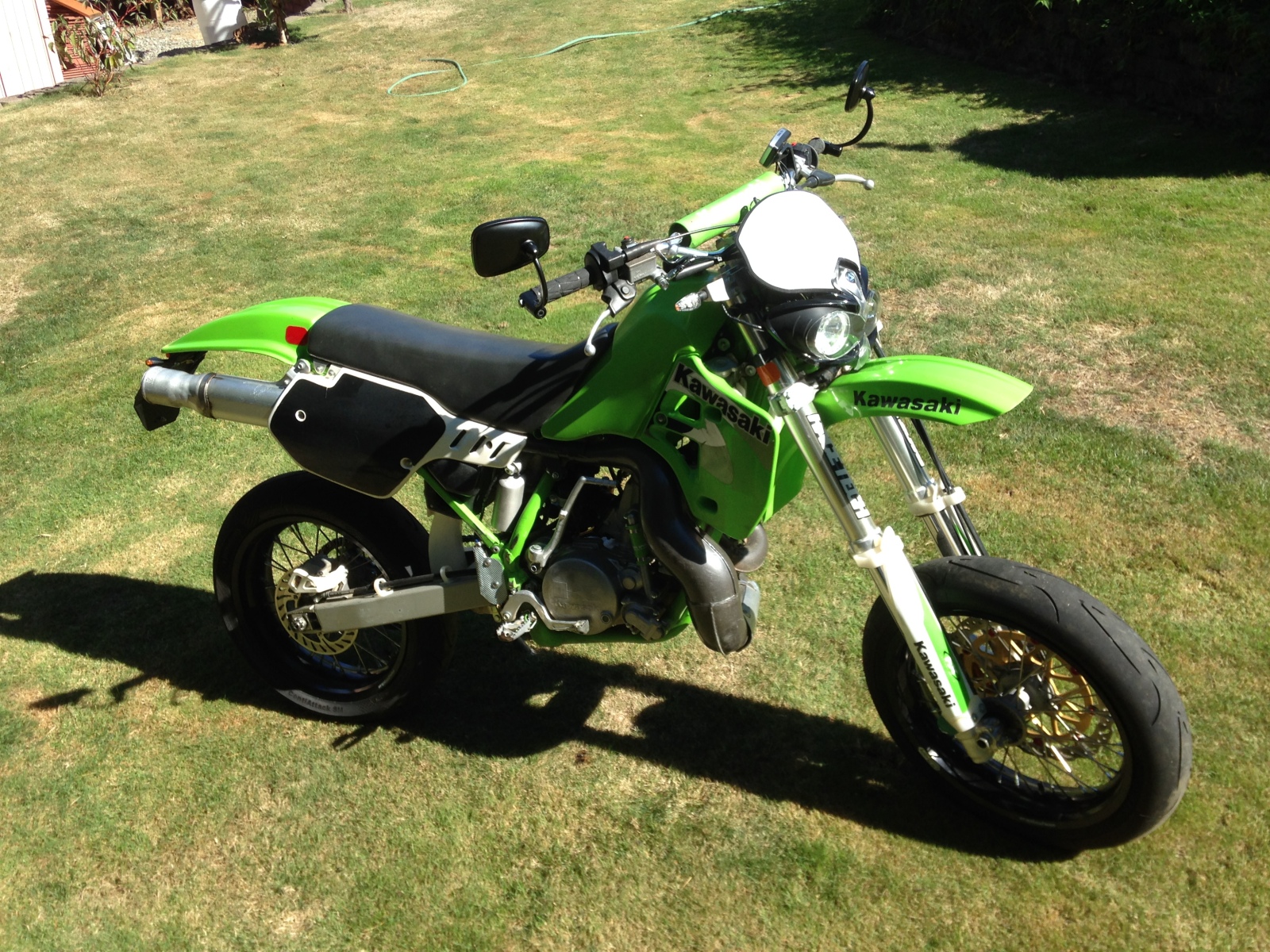

Brutes 2000 KX5 Street SuMo Build
Re: Brutes 2000 KX5 Street SuMo Build
Latest look with rubber mounted bar end mirrors. So far so good with the rubber inserted bar ends. Had to bore out the ends of the extra thick aluminum bar to make them work but if they do not leave or break off the bike I will be happy.

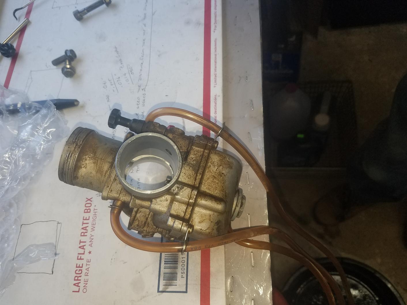

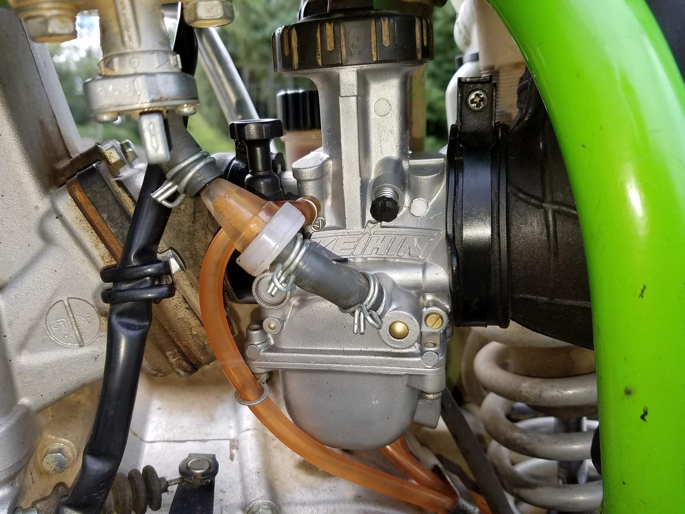

I forgot to mention that before we rode it, we changed the oil, cleaned the filter, checked the jetting, set the floats, and generally cleaned up the carb a bit
Before
After
