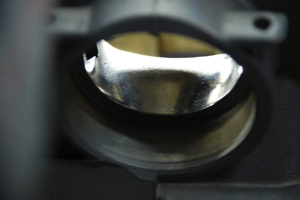

Not going to get in a debate of polished vs non ... I like mine this way...
Really hard to get the camera to do it justice...

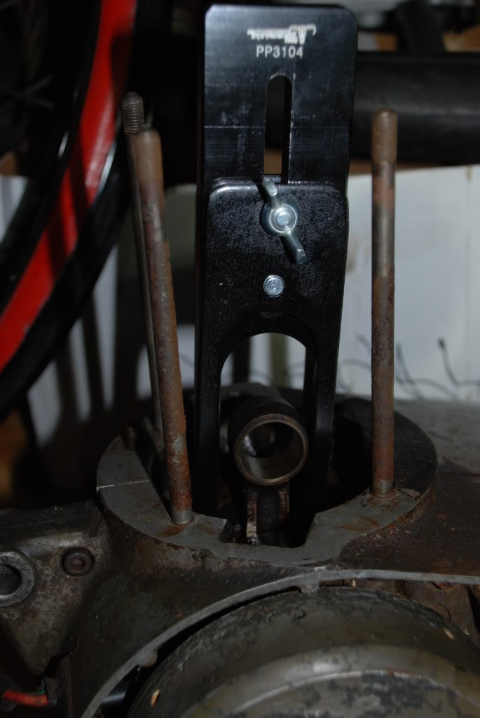

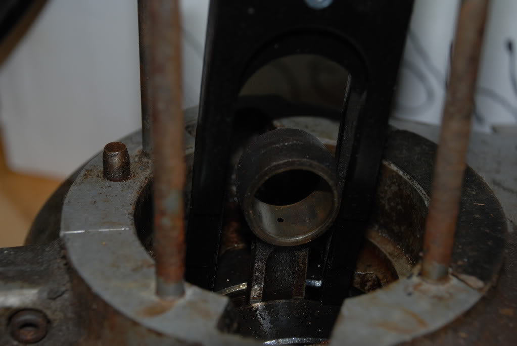

Was thinking about it today.. And I dont think I have ever seen anyone on here mention the use of a crank Jig..
Since the Big K5 cant use the (crank pulling tools).. being a Circlip on the primary side...
It really is your best friend!
Extra points if you can tell me what kind of motor that is....
Motorrads Jeff Wards Engine build round 2 2-7.jpg (71.9 KiB) Viewed 7172 times
Motorrads Jeff Wards Engine build round 2 2-8.jpg (51.04 KiB) Viewed 7172 times
(1972 Bultaco persang 350cc)

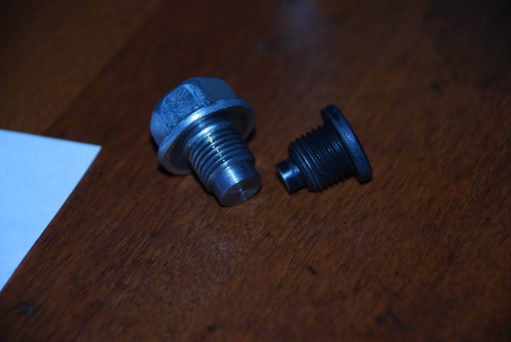

A word on greasing seals.
We all know you should grease your seals... (little smear of grease between the sealing lips before you toss in the waterpump, kips, crank, etc etc etc..
But how many of you know that alot of grease's out there will actually deteriorate rubber and nitrile?!
I learned long ago, a trick from the auto industry... working on A/C...
the trick to keeping a long service A/C system... is to grease all the little o-rings...
But with what?!
Motorrads Jeff Wards Engine build round 2 2-9.jpg (7.49 KiB) Viewed 7172 times
Yep. Dielectric grease...
It wont deteriorate rubber. It actually conditions it!.
I have since moved this trick over to building motorcycles, and any other sealing application.. and have had great results over the years...

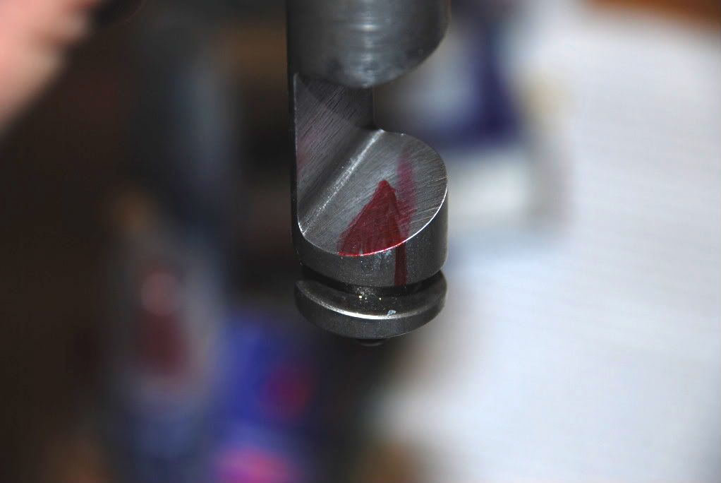

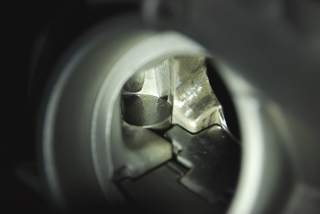

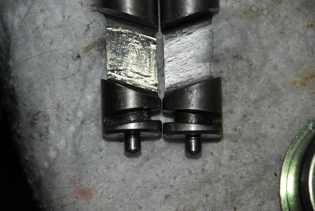

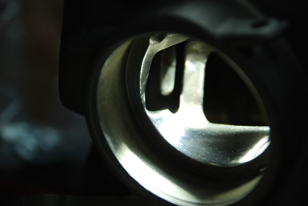

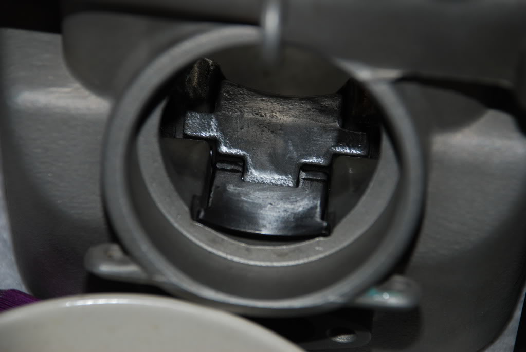

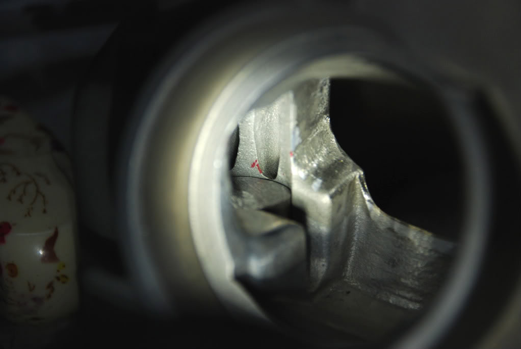

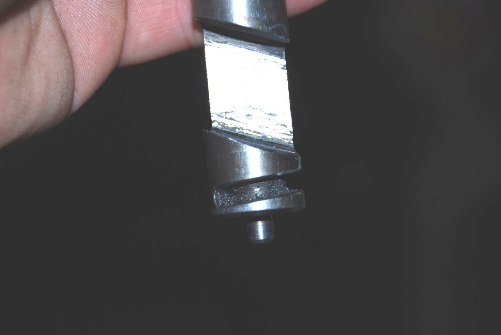

Okay.. did somthing about the kips today..
Marked it with a Marker where it started to cover, and the end of travel... so I knew where to remove material..
Shaved the back (lower part of taper) down to where I was happy with it.. then blended....
Didnt touch the high portion (of the taper), as it directs out of the CYL.. and into the resonator.... and didnt want to cut on CYL... and dont know enough about how the resonator effetcs the motor to change the ammount of exhaust going in and out of it....

Cut on left, uncut on right

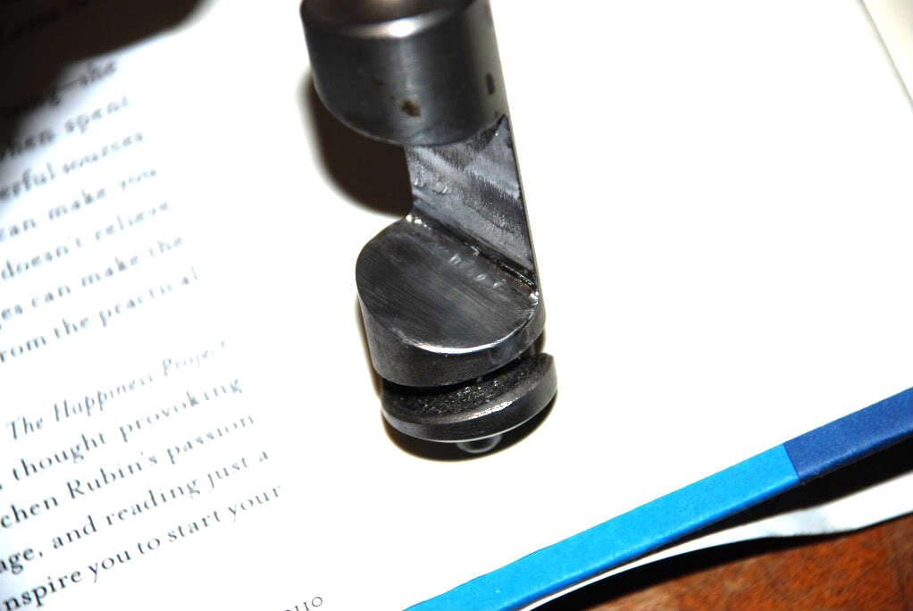

Before
Motorrads Jeff Wards Engine build round 2 3-4.jpg (48.46 KiB) Viewed 7172 times
After
Motorrads Jeff Wards Engine build round 2 3-5.jpg (46.75 KiB) Viewed 7172 times

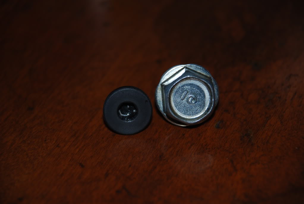

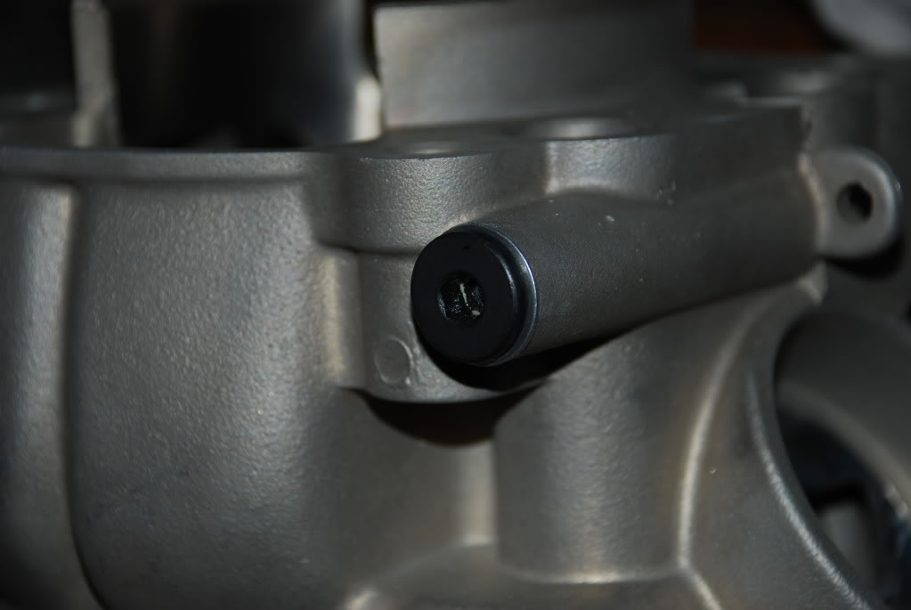

Got me some Nifty parts in the mail today!.
Thanks Kaw Rider..
It looked great right out of the box... But me.. being the way I am (obsessive compulsive).. I gave it a quick bath in some gun blue....

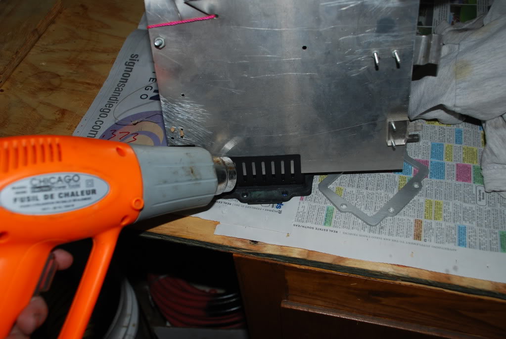

Kaw Rider brought somthing to my attention today over the phone.. and after both of us taking measurements it confirmed it.
The V3 reeds, stops compress quite a bit once put into the cyl..
Mine were actually stuck this way (heat from the motor, caused the stops to have a memory)..
SOOO. to attempt to fix this issue.. This is what I did today..
First to fix the memory problem, I put a piece of alum plate betwen the peddles and the stops, heat the stops up really fast with a heat gun, and bend outward...
Motorrads Jeff Wards Engine build round 2 3-9.jpg (59.13 KiB) Viewed 7172 times
Motorrads Jeff Wards Engine build round 2 4-0.jpg (97.21 KiB) Viewed 7172 times
Mine measured 1.36" (and still shrunk once pushed in CYL)... Kaws new ones measured 1.5" (going off memory here).. after I reshaped them, mine are now at 1.65... (this is measuring inside to inside from one stop to the other).

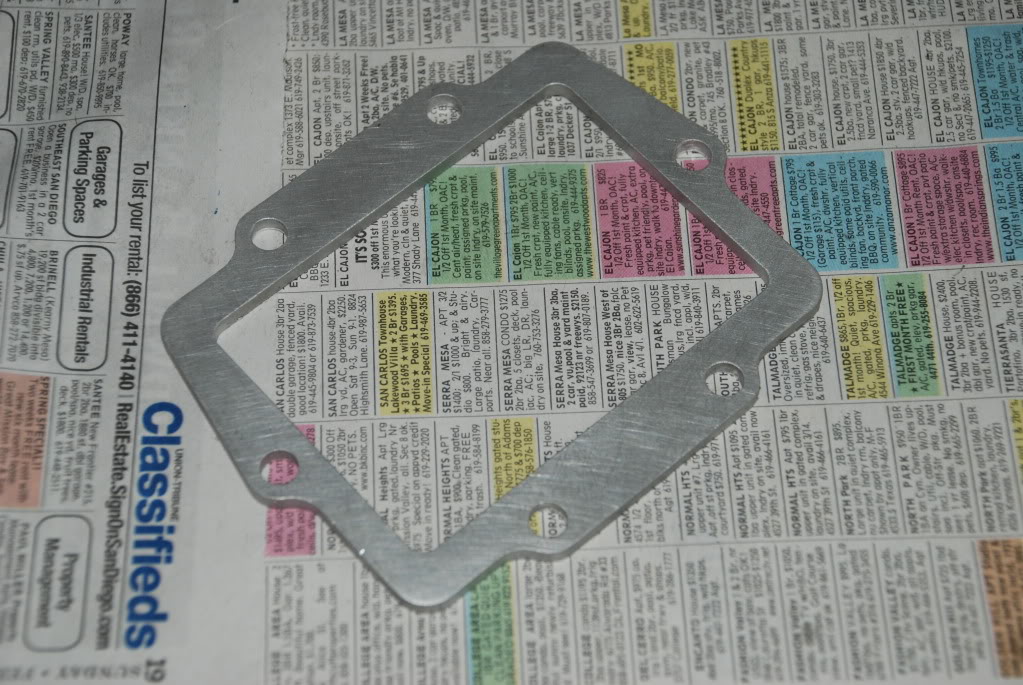

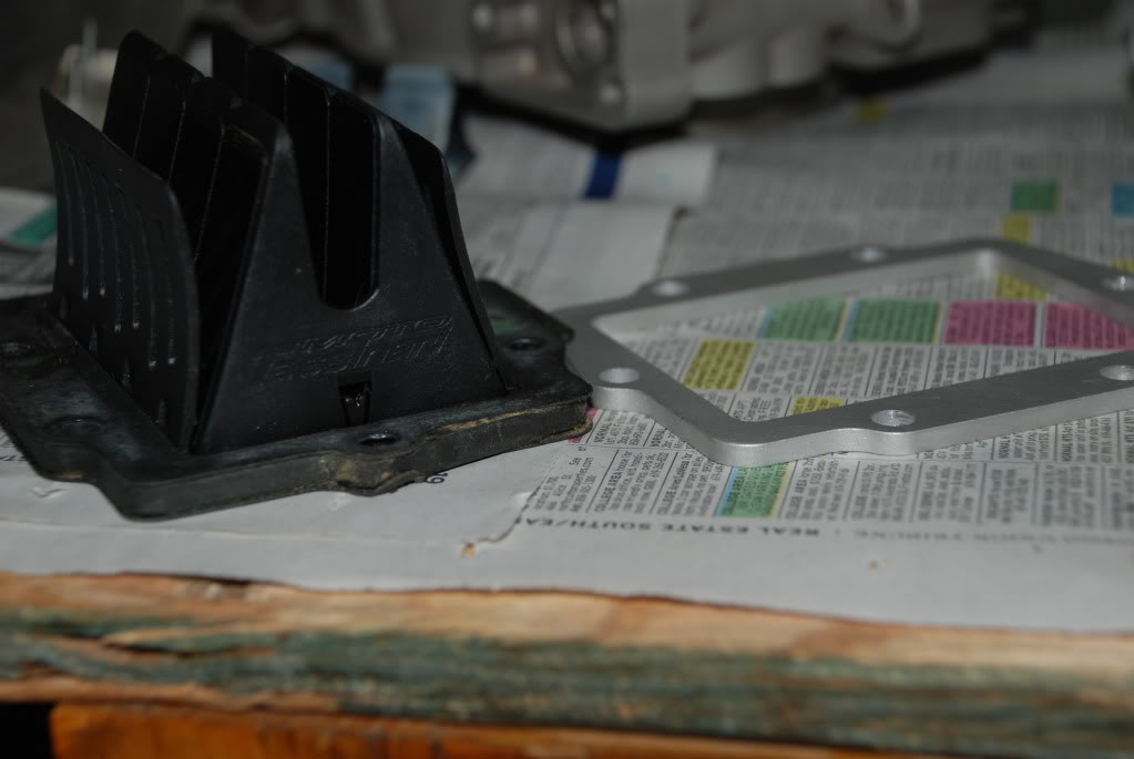

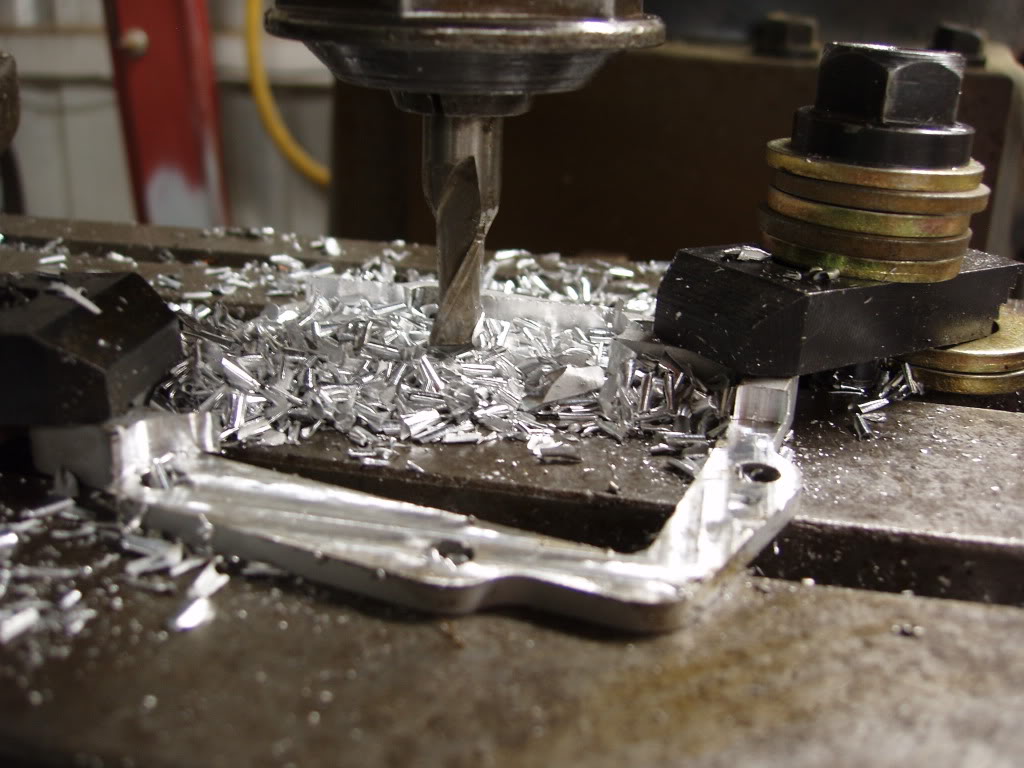

So after that. I needed to see about fixing the problem... Well I am not a huge fan of reed spacers, well atleast not the 3/8" ones.. Not going to argue one way vs the other..
SOOOO.. I took a reed spacer and milled it down to 1/8" not enough to mess with stuff much.. I also threw a bit of taper on it to clock the reeds more tward the top of the CYL.. (not much, thickness of a a&N washer wink )...
Initial cut, to see if Taking to 1/8 would be too much. , Taper cut,/final cut after this ..
Motorrads Jeff Wards Engine build round 2 4-1.jpg (114.75 KiB) Viewed 7172 times
Motorrads Jeff Wards Engine build round 2 4-2.jpg (169.14 KiB) Viewed 7172 times
I havnt measured to see how much this fixed the problem yet. as I plan on looking at possibly trimming the end of the stops as well... (and a 7mo old child decided I dont have time to measure tonight..)
