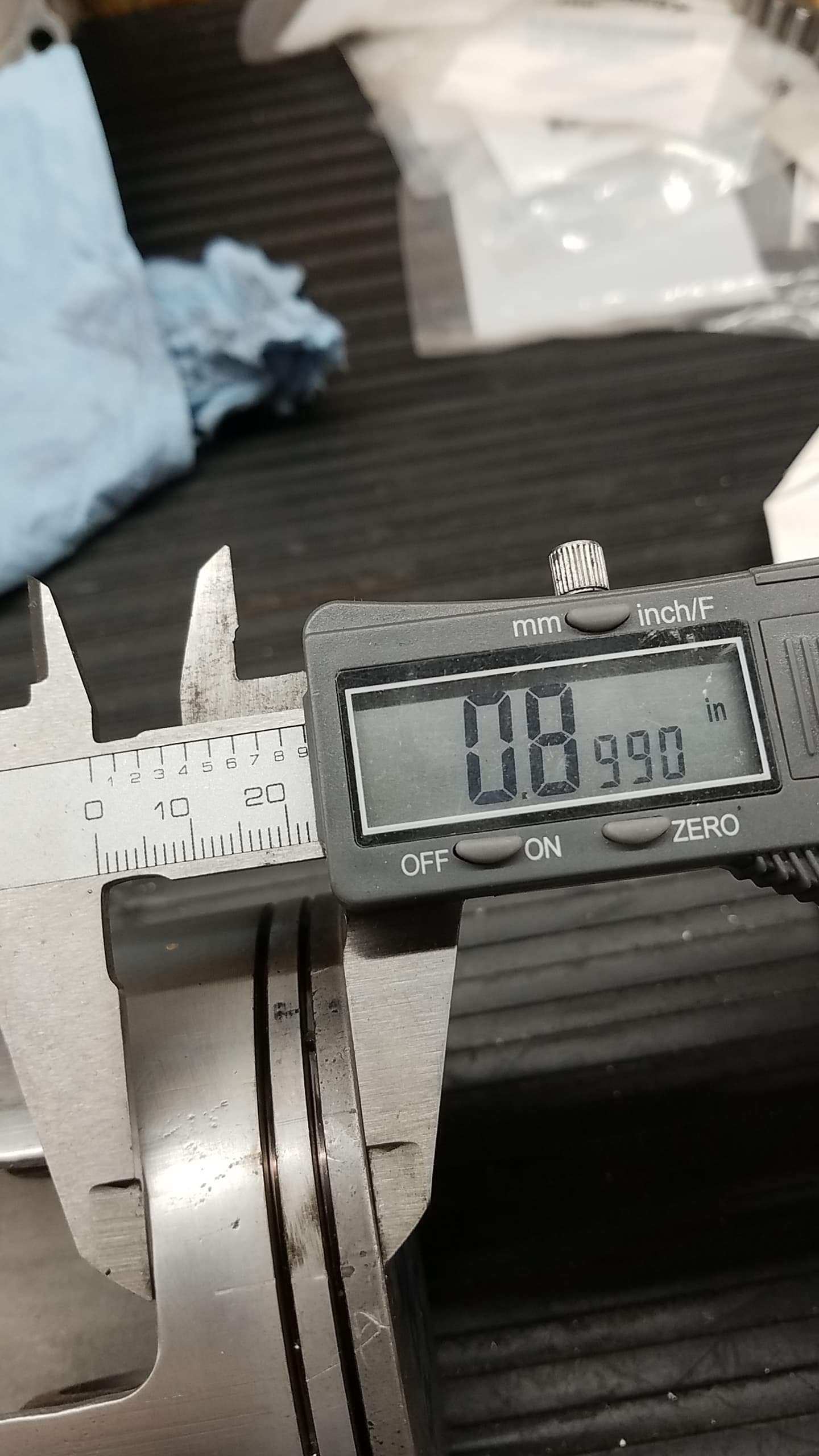

Re: To Window a KX500 piston or not to window???
Here is some measurements for a 89-04 KX500.
From the top edge of the piston to the top of the port .900"
Width: .905"
Height: 1.000"
10-23-20 UPDATE:
So, as with all things Moto... there is more than one way to do something.
Here is some new window specs that have proved to be just the same HP wise.
From the top edge of the piston to the top of the window .970".
Window height 1.160"
Window width .840"
