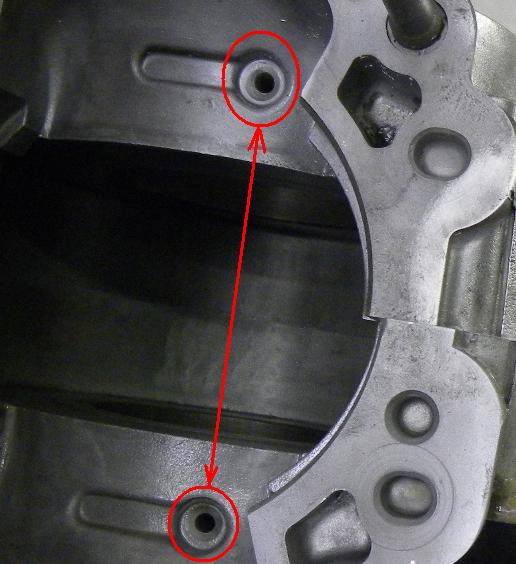

Seals aren't the only place for a potential air leak.
This is a troubled spot pointed out by Motorrad.
A small punch, cleaning, patience, cleaning, cleaning, cleaning, and some J-B Weld or Case sealant will fix this area up nicely.
Good vision would also help...
PUNCH CLEAN UP.JPG (40.94 KiB) Viewed 18387 times
Remember, if there is any oil or debris, J-B Weld will not stick and you've just wasted your time :o

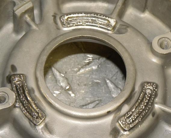

Here is the same view after clean up with a stainless steel wire wheel and carb cleaner.

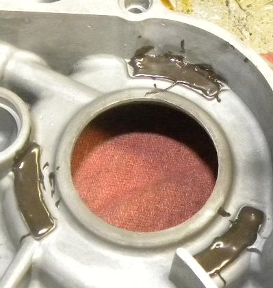

Here is how my cases looked after applying the JB-Weld.
kx500 engine case jb-weld 1.JPG (27.51 KiB) Viewed 18675 times
kx500 engine case jb-weld 2.JPG (21.35 KiB) Viewed 18675 times
Not the neatest job of applying the JB-Weld but I think it will work.

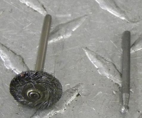

Another thing that may help you is the tools that I used to clean the cases up.
Besides the punch I used a wire wheel (Left).
However, I felt as though it may have left too smooth of a surface so I used a small cutting tool (Right).
Man, did that do a quick and nice job of cleaning.
Because of the radius shape it was easy to get into all the nooks and cranny's.
A word of caution.... This thing cuts QUICK!!!

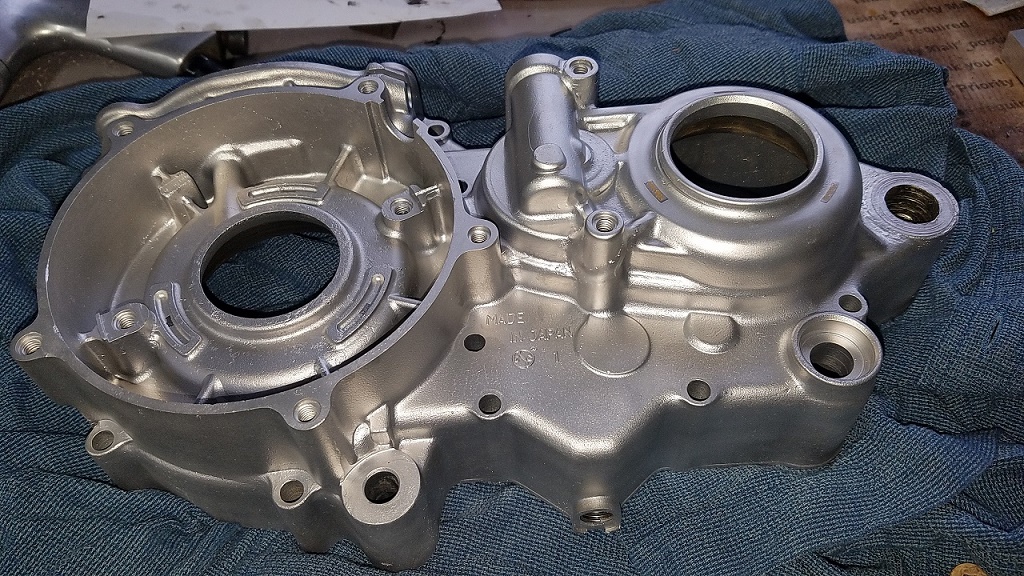

Since this was originally wrote, I invested in a vapor blaster and it was one of the best things I have done..
Now our cases are amazing 8-)
And no media impregnation...
