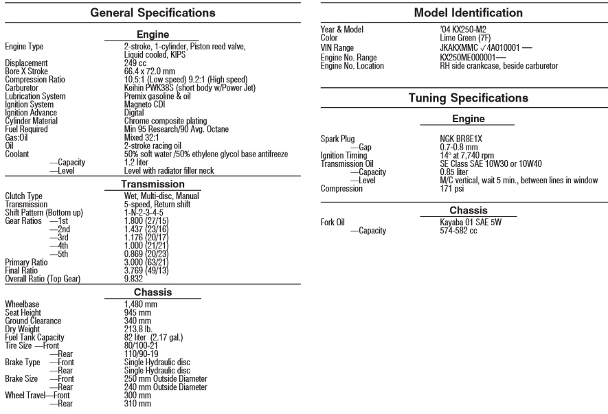

2004 KX250 SPECIFICATIONS
2004 KX250 SPECS.jpg (125.15 KiB) Viewed 7567 times

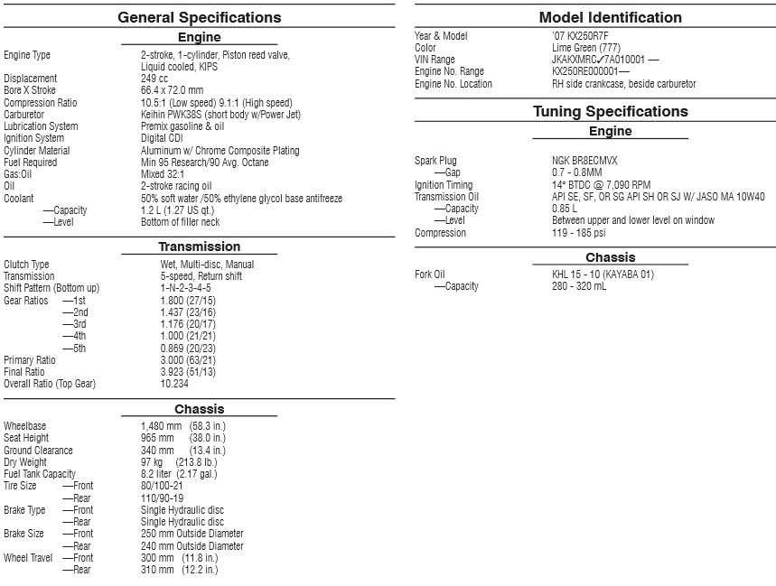

2007 KX250 SPECIFICATIONS
2007 KX250 SPECS.jpg (126.71 KiB) Viewed 7567 times
