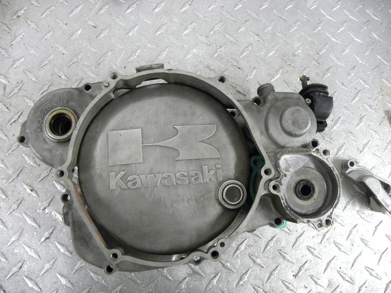

KX500 2 piece clutch cover adapter
Re: Making a KX500 2 piece clutch cover :-)
I hear you.
I had that same pic and enlarged it a bit to show some more detail
kx500 2 piece clutch cover 1.JPG (50.84 KiB) Viewed 16381 times
