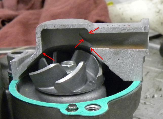

On KXriders.com Motorrad posted this bit of info that should help you decide what clearance to run on your water pump cover to impeller:
Guess since it looks like people might actually do this one... instead of just just humoring my tinfoil hat wearing rants.... I should give what I think should be the service spec..
If I had to write a service spec in a Clymer manual. It would be
.012"-.020"
I agree with that spec.
On mine just to be on the safe side, after I get the impeller shimmed to what I think is correct, I will gently turn the motor over a few times to be sure that the impeller is not hitting anything.
I know it should go without saying but better to be said then to have someone trash their impeller or worse :shock:
Mr Motorrad.
What do you think about rounding some of these edges:

Laminar Flow = Mo Flo ....No?

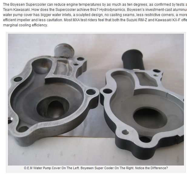

S.B. have you ever had one of the Boyesen Supercooler watepump cover / impeller come in the shop?
http://www.boyesen.com/supercooler-spectra-kits-offroad
http://boyesen.com/supercooler-kits-offroad
http://www.dirtrider.com/tests/gear/141 ... _pump_kit/
I get them on great occasion but never for the big K5 or it would be on my bike :D
What bike do you need one for?

Here is a pic of the Boyesen cover vs a stock cover.
boyesen super cooler.png (433.18 KiB) Viewed 17326 times
From what I'm reading and from what I can see they improve the casting so there is less flaws, seams, ect and much larger ports.
It's possible that their impellers have a better design as well as having tighter clearances.
It looks like you want smooth transitions but not a polished surface.
