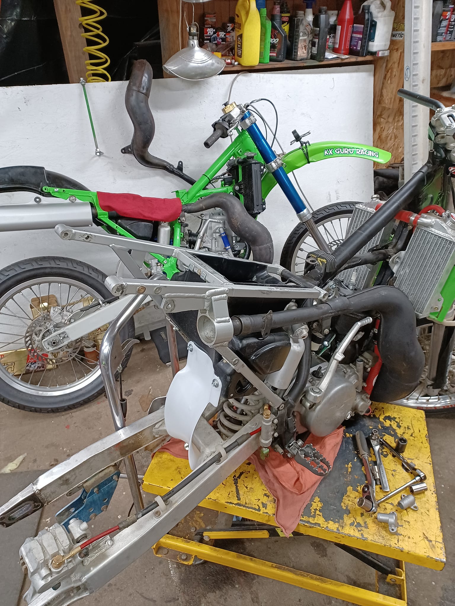

Due to work schedules I am building a back up bike so that we can double up our testing times.
And since the dyno work is done our focus will be on street testing.
I'm close to having the back up bike ready to go..
The bike in the front is the backup bike or LSBB.
The bike further away is known as LSB.
LSB is ready for another test as soon as the weather clears up.
LSBB needs a few things :-)
