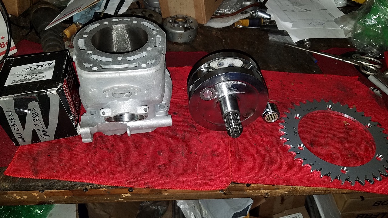

This all came back from Tom Morgan last week and is ready for my secondary engine.
I prepped the crank.
Doug Haas made my stuffers for the pin and the crank.
Tom Morgan, assembled and balanced it.
I did the port work and made the calculations for the desired port timing.
Tom then plated the cylinder to the piston size and a little extra clearance 8-)

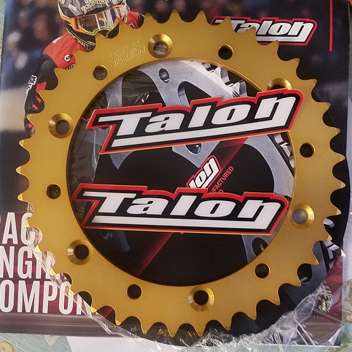

Nigel Fern from the UK sent me this sprocket.
37T rear sprocket.
Thanks again Nigel!

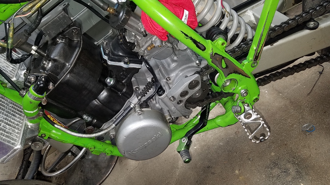

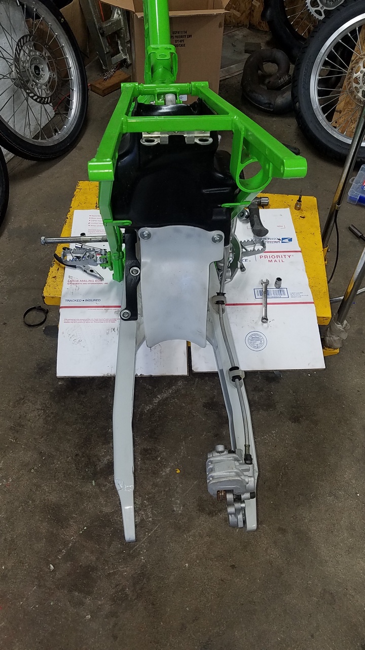

Due to work schedules I am building a back up bike so that we can double up our testing times.
And since the dyno work is done our focus will be on street testing.

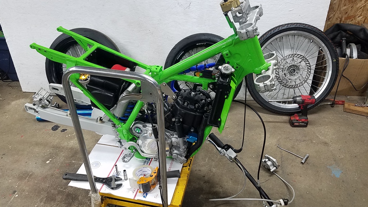

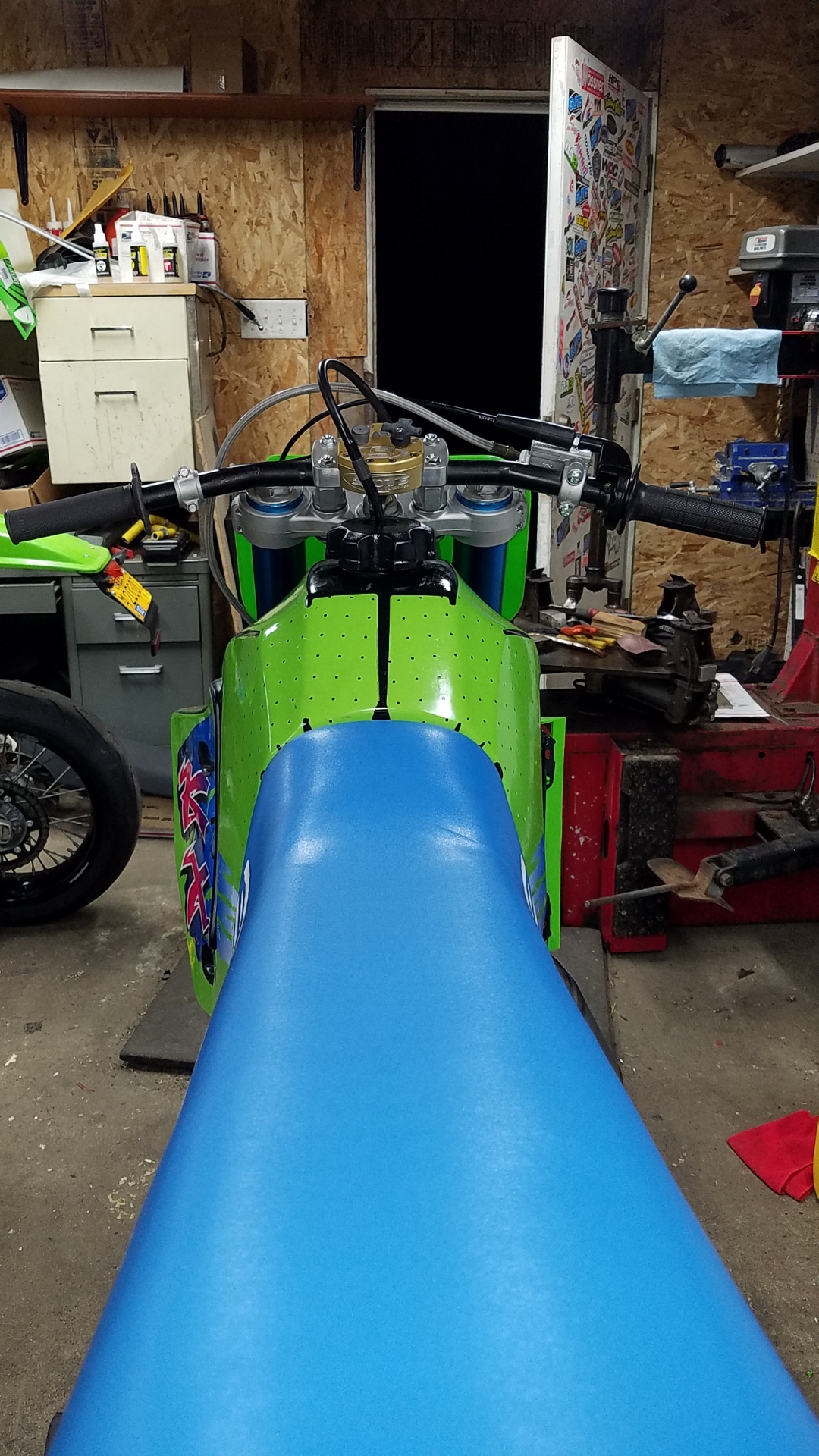

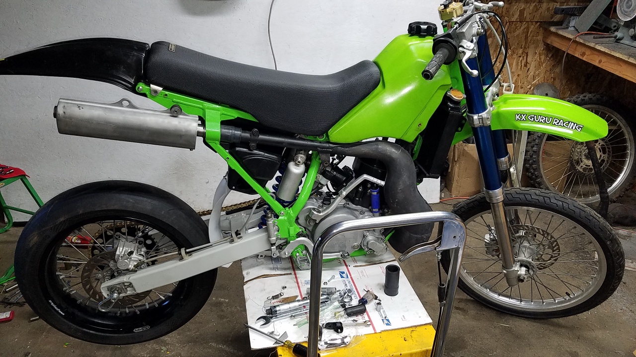

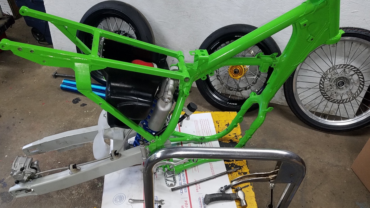

I'm close to having the back up bike ready to go..
The bike in the front is the backup bike or LSBB.
The bike further away is known as LSB.
LSB is ready for another test as soon as the weather clears up.
LSBB needs a few things :-)
