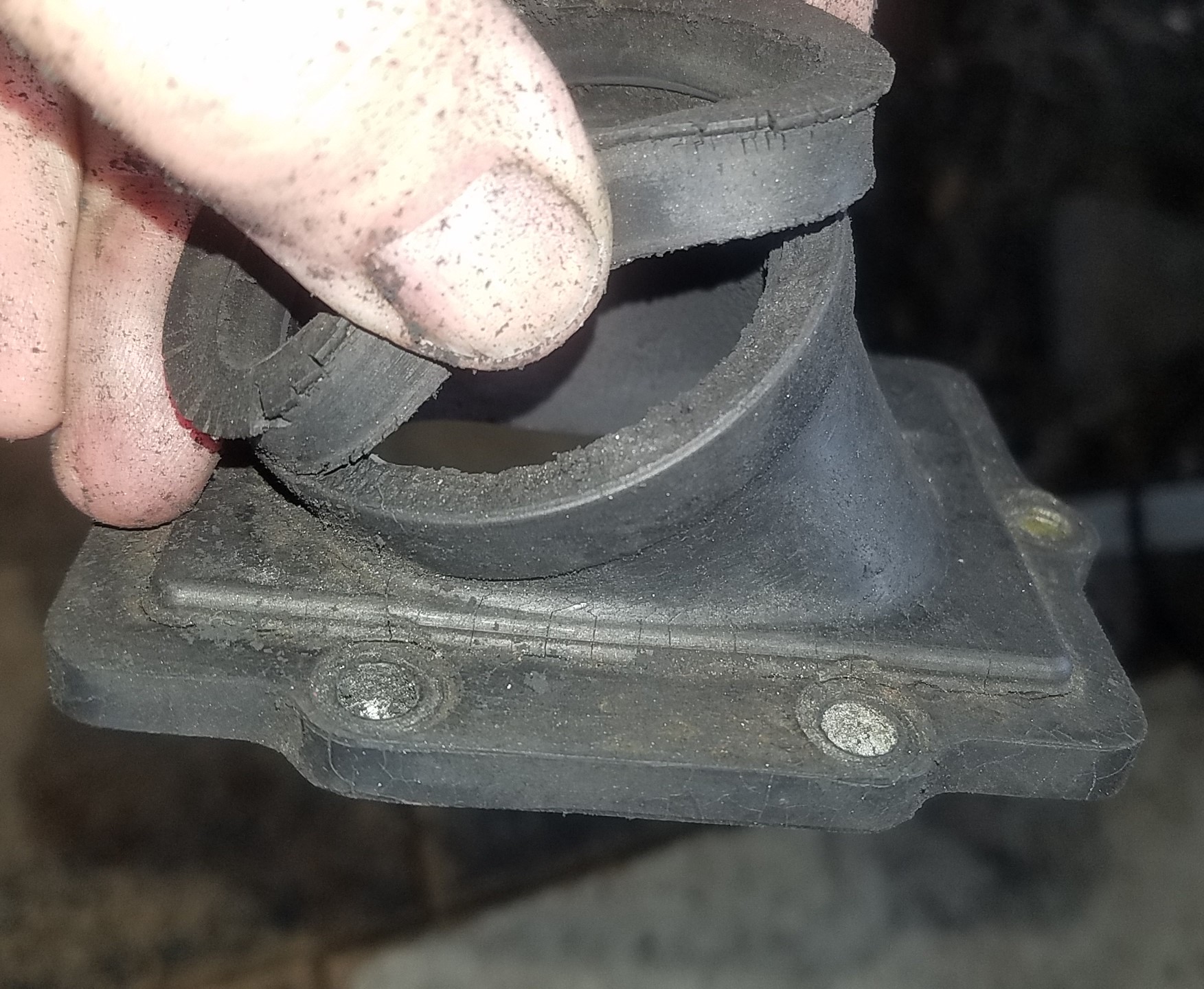

Ok, almost got it done...
Whoops... Not so fast...
Starting over...

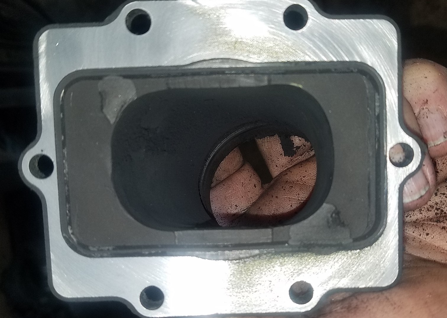

Re: KX500 VF2 Reed boot modifications. What works?
Posted: Sat Mar 20, 2021 8:10 pm
Take two...

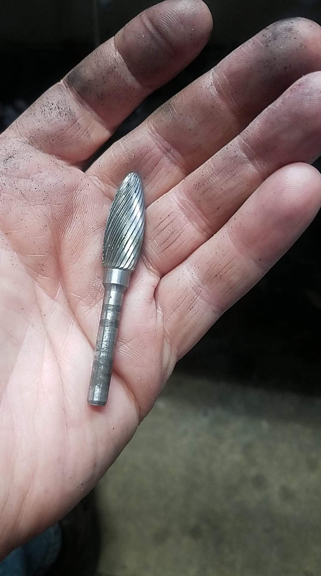

That's what happens when you don't want to ruin good parts so you use some junk you have lying around :lol:
This burring tool works great for cutting rubber away.

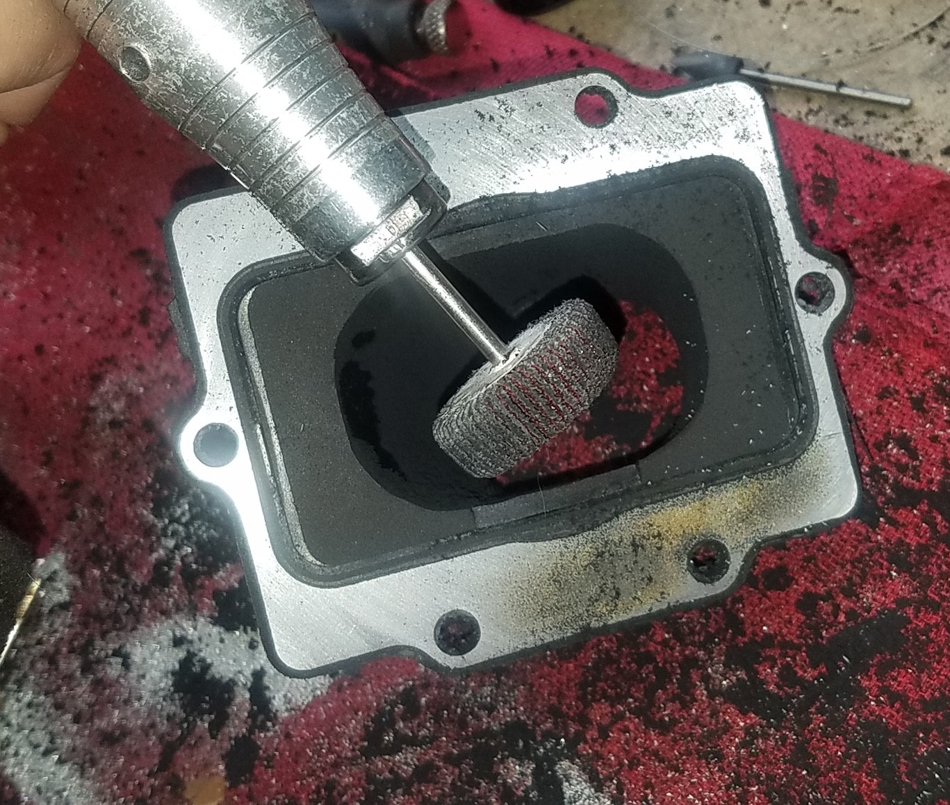

Posted: Sat Mar 20, 2021 8:11 pm

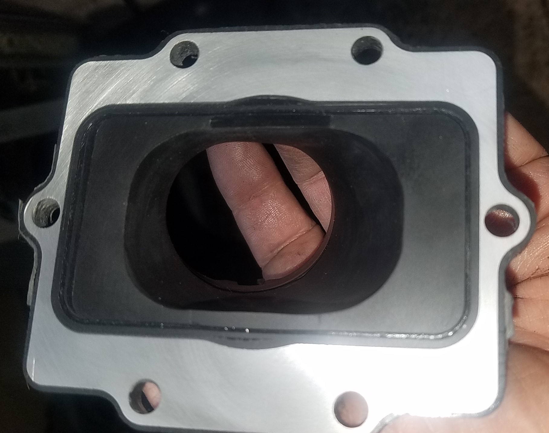

A little sanding after the rough cutting..
Done!

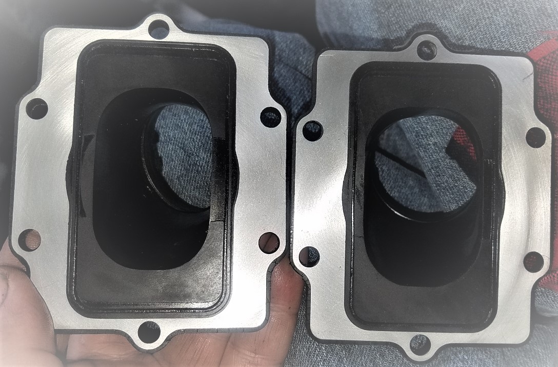

Here is a comparison between stock (But made to fit the VF2) and modded...
As you can see there is not a huge difference but it doesn't take much to make a difference...
Next, time to hit the dyno...
