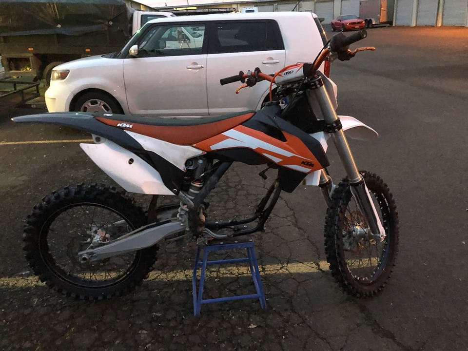

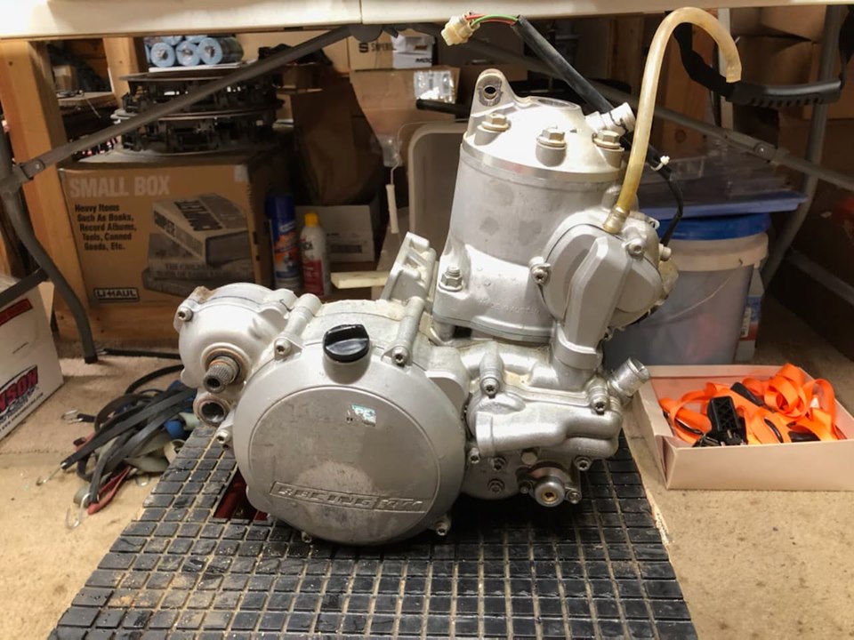

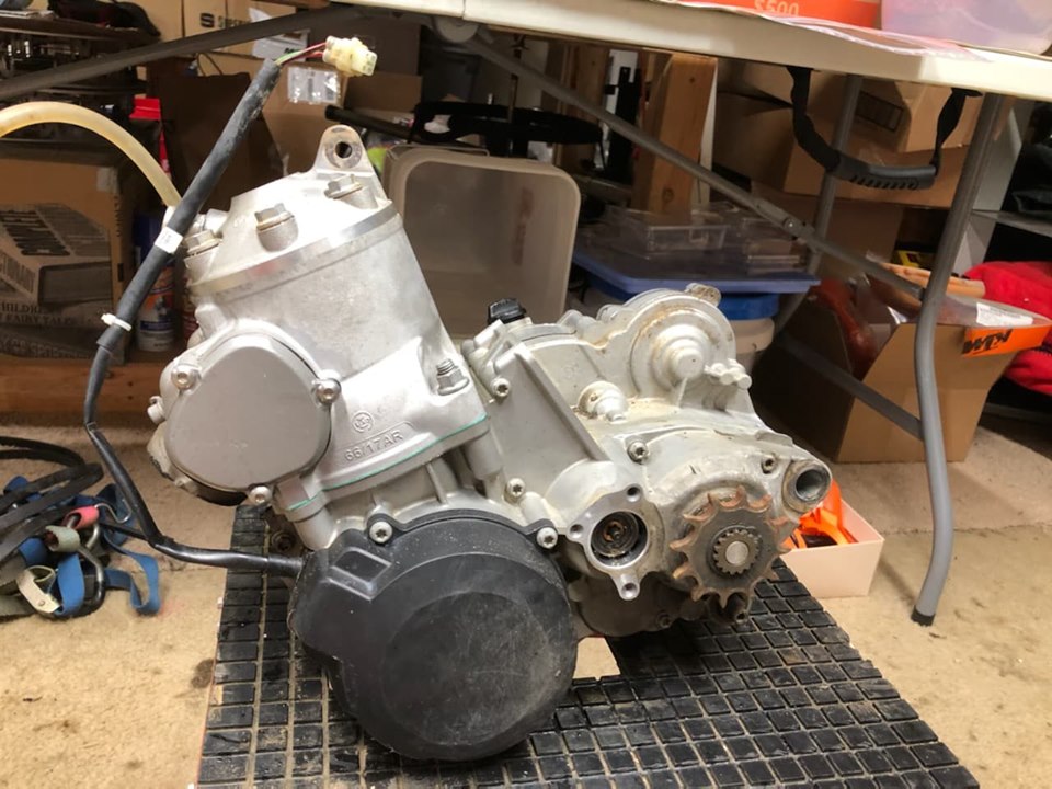

Here is some before pics of the bike..

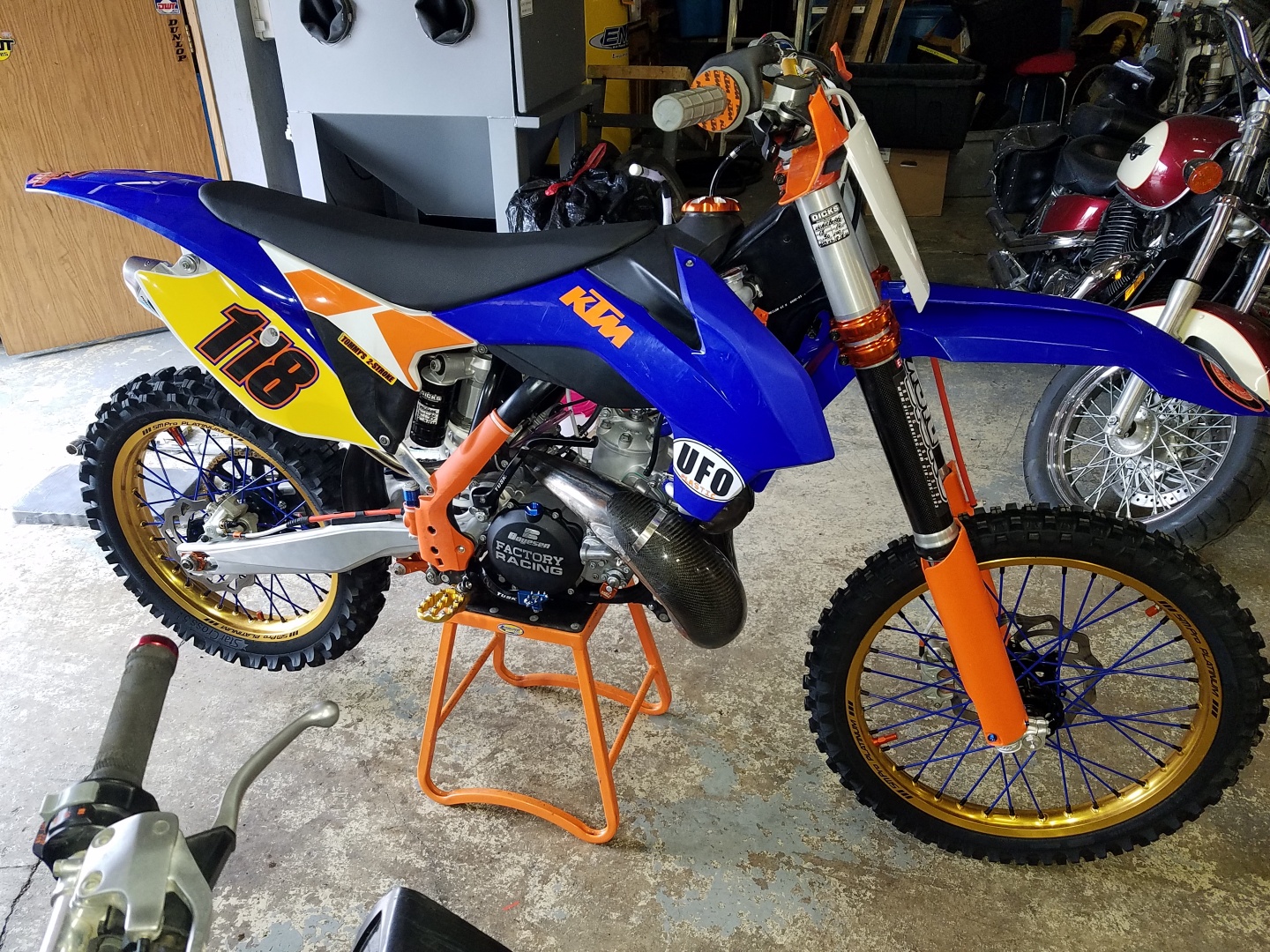

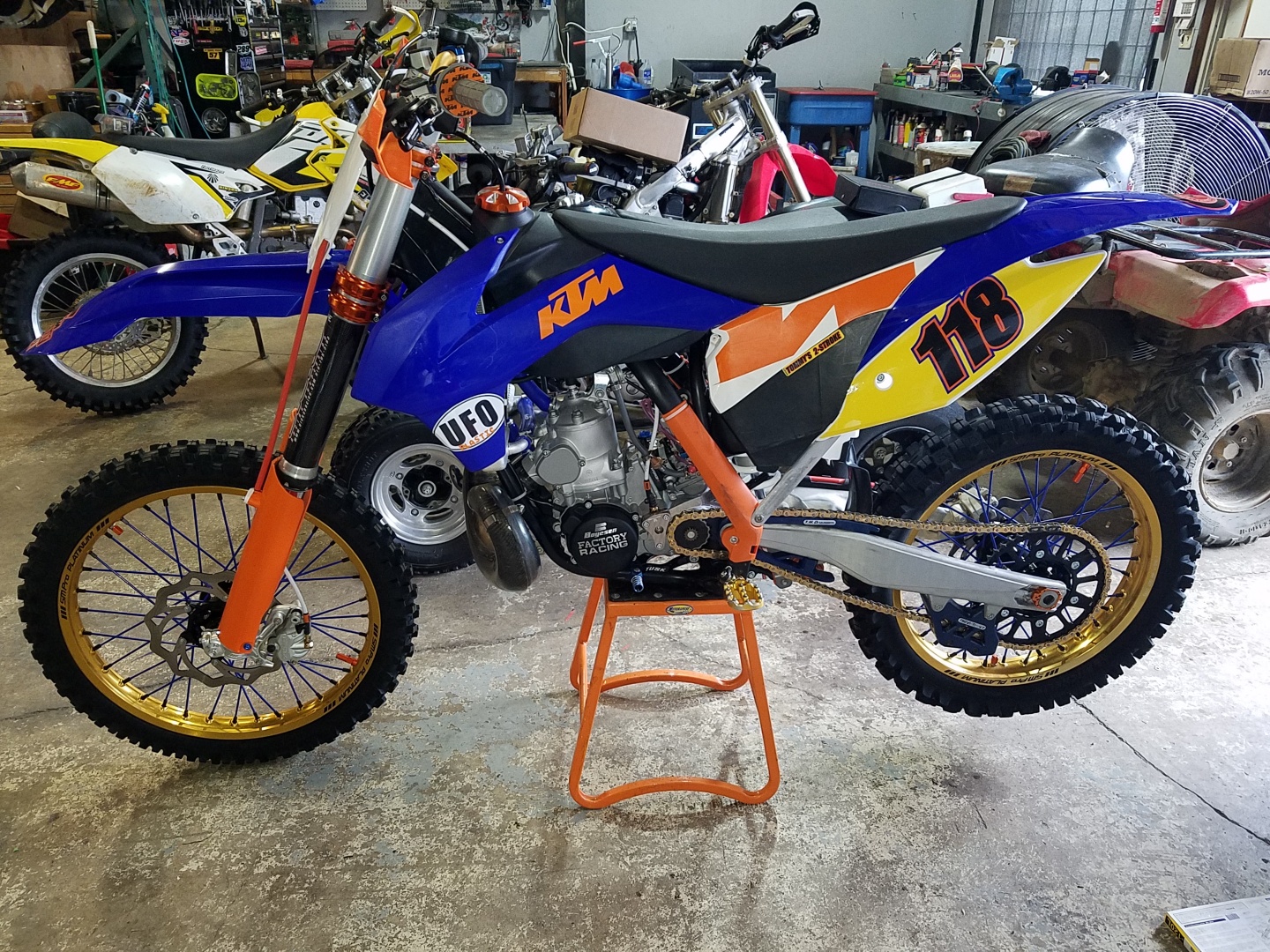

Ok...
This build is still under way.
Rider feedback from Novice to Pro level riders is this is a awesome bike.
The power is smooth and controllable.
The handling is superb when compared to a 450 as it weighs about 30 lbs less yet the engine has approx the same HP and torque.
I'll get some dyno pulls posted before long...
