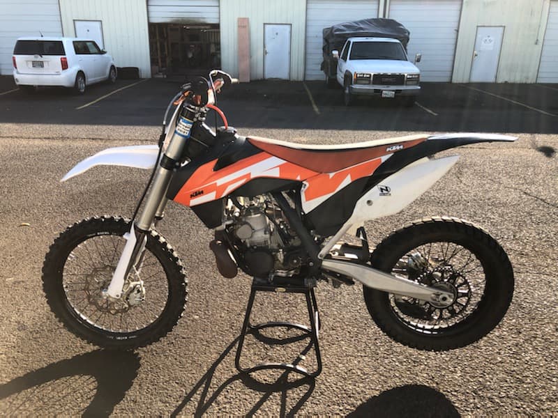

Here is some before pics of the bike..

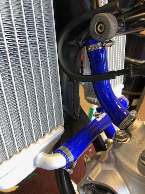

Ok... The owner has started engine asy...

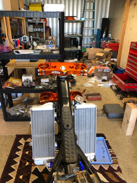

More progress.

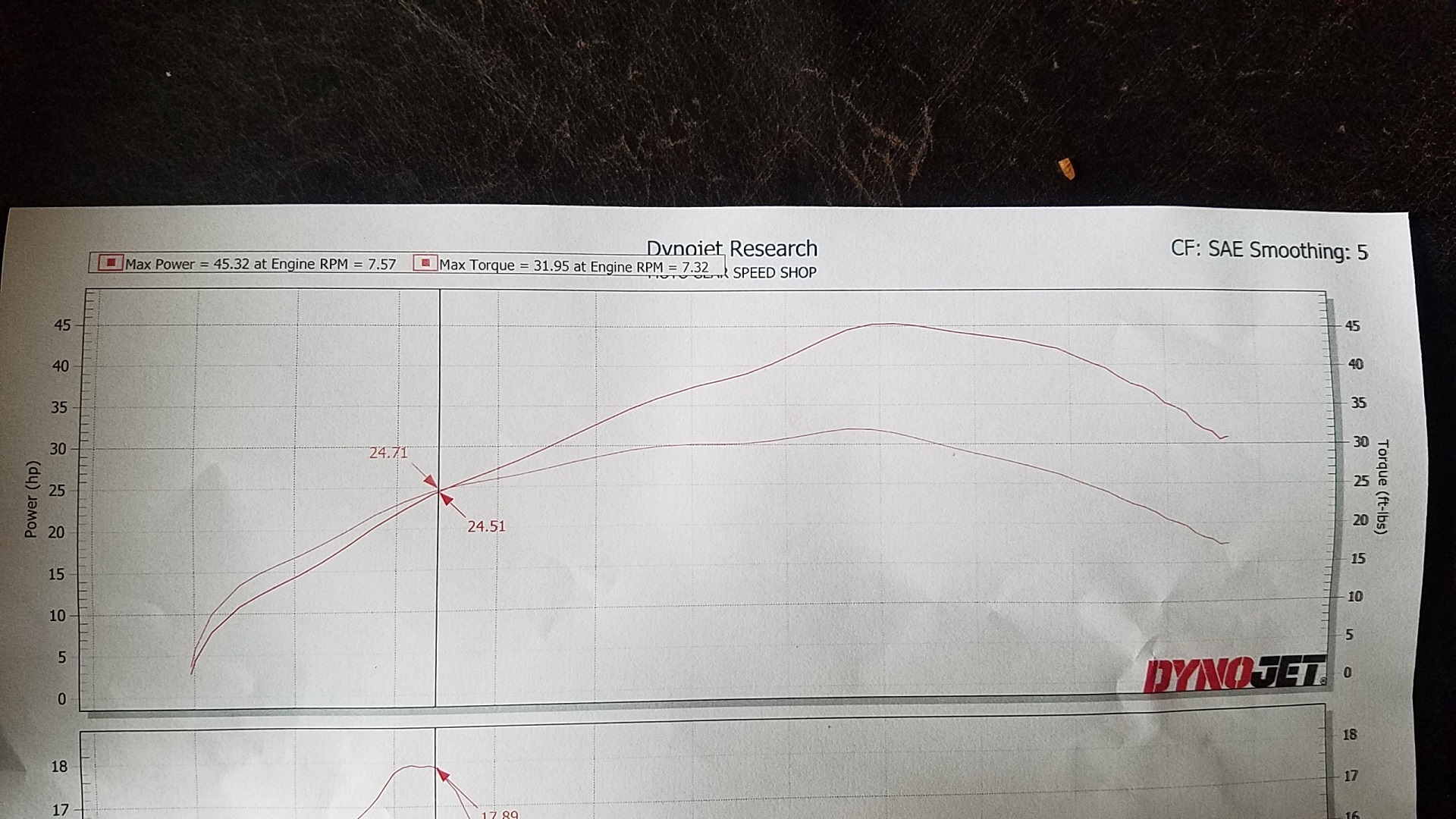

I'll get some dyno pulls posted before long...
