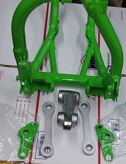

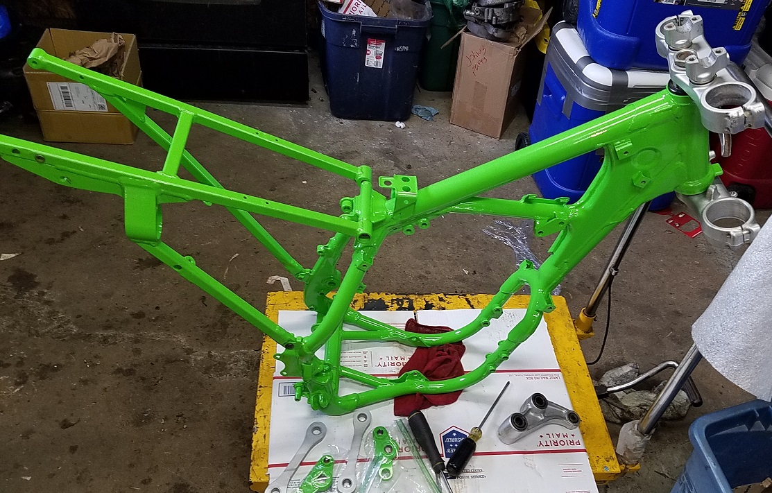

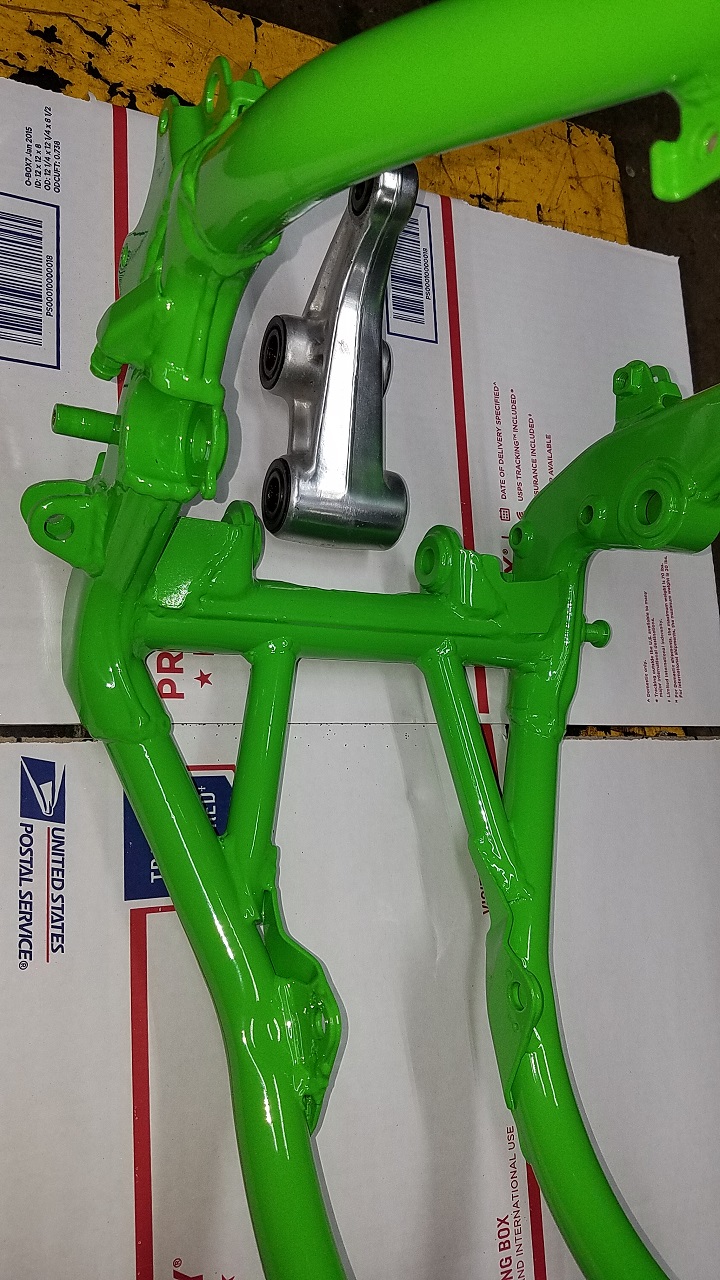

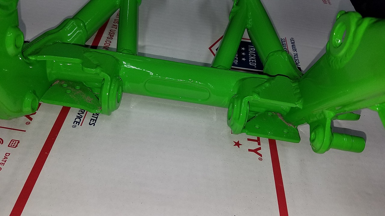

Getting things ready
Notice the frame gussets..
play 102.jpg (385.02 KiB) Viewed 17503 times
play 103.jpg (538.22 KiB) Viewed 17503 times
play 104.jpg (360.39 KiB) Viewed 17503 times
play 105.jpg (124.74 KiB) Viewed 17503 times

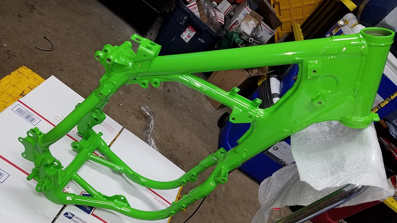

Re: Play bike KX500.

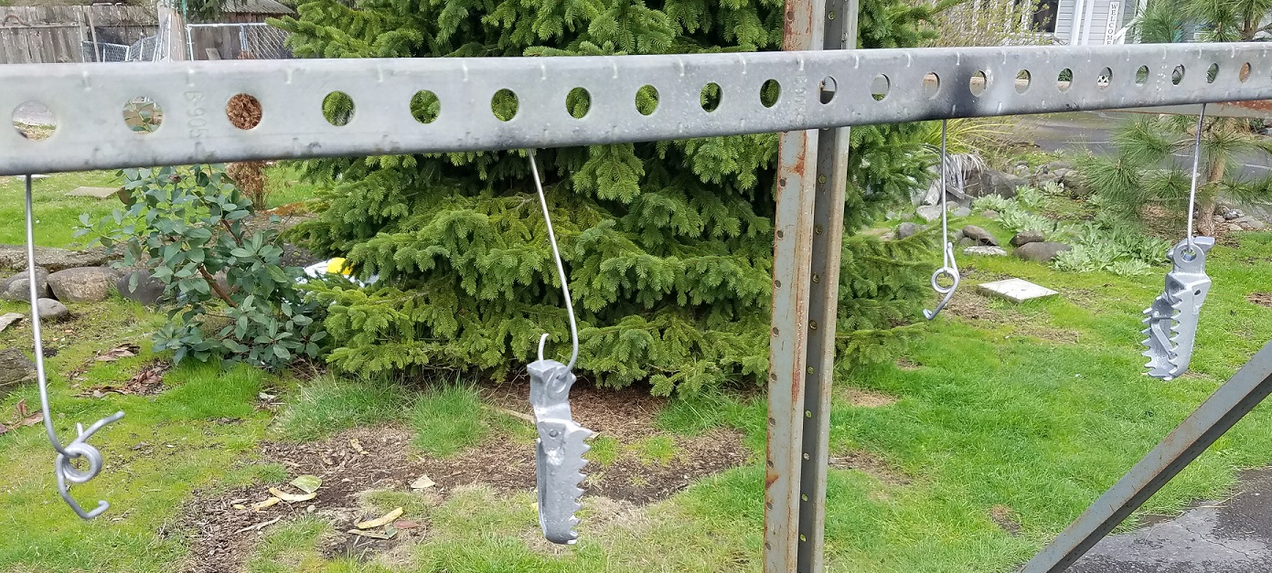

Some of the blasting media leaked from the weep holes..
Gonna shake this one before assembly..
play 106.jpg (308.39 KiB) Viewed 17501 times

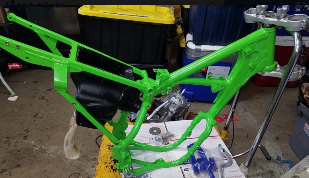

Didn't have much time today but got a few things mounted..
play 110.jpg (379.95 KiB) Viewed 17497 times

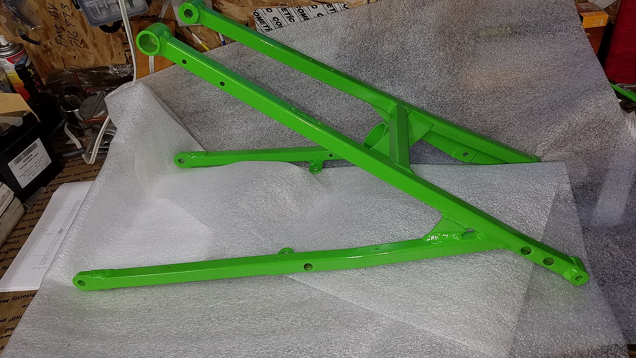

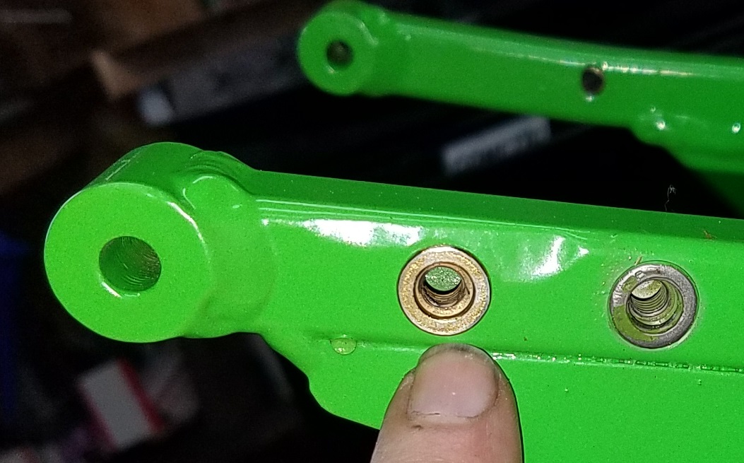

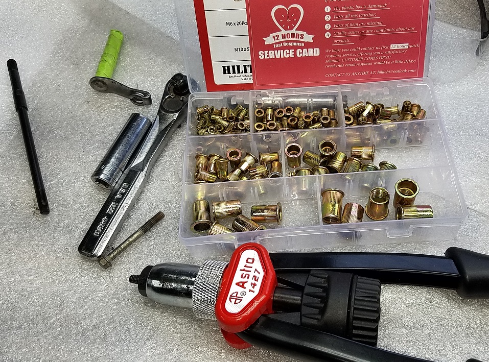

Ok... some very astute members have asked me about the holes in the sub frame..
Why are there holes? There is suppose to be Nutserts in there...
How to fix???
Just need these...
KX500 01 PLAY BIKE 122.jpg (420.58 KiB) Viewed 17492 times
Looks nice!!!
KX500 01 PLAY BIKE 123.jpg (206.3 KiB) Viewed 17492 times

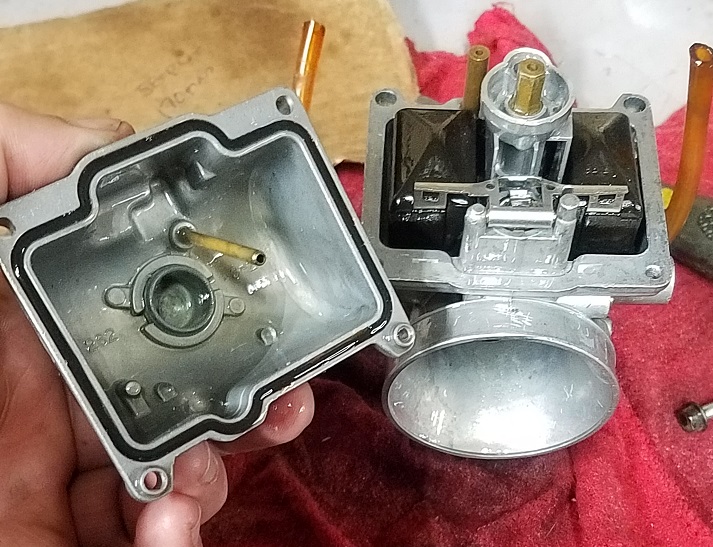

A trip through the Ultrasonic cleaner, check the float height, inspect the jets.
Good to go.

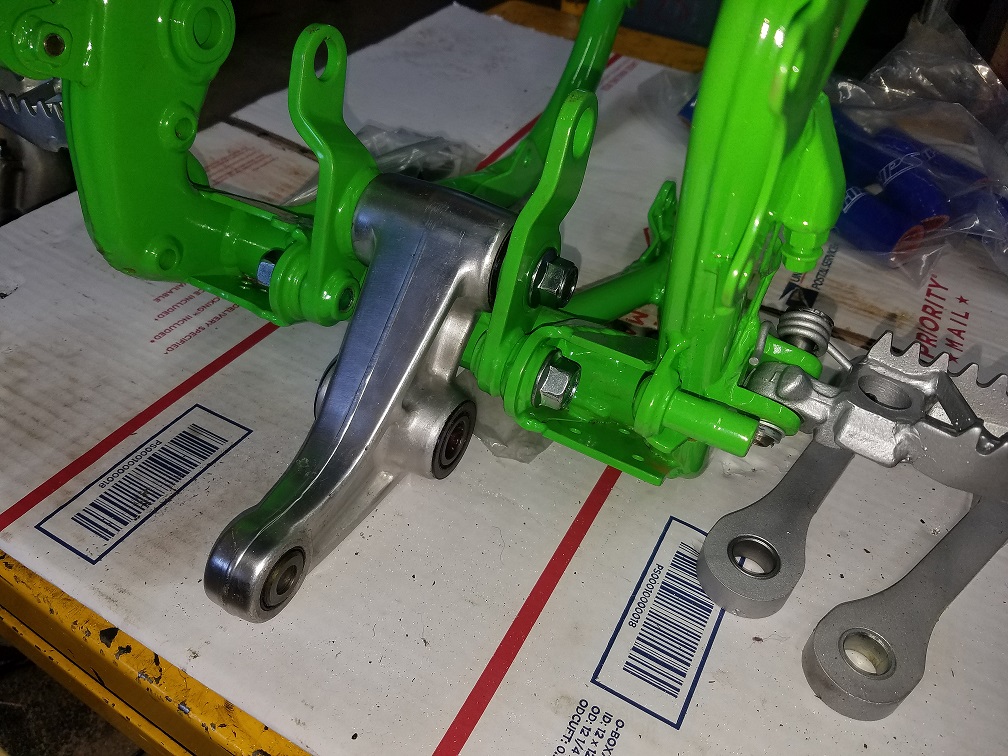

Once you start cleaning up parts it's really a snow ball effect...
This part looks so nice and shiny but this part that goes right next to it is UGLY :o
So.....

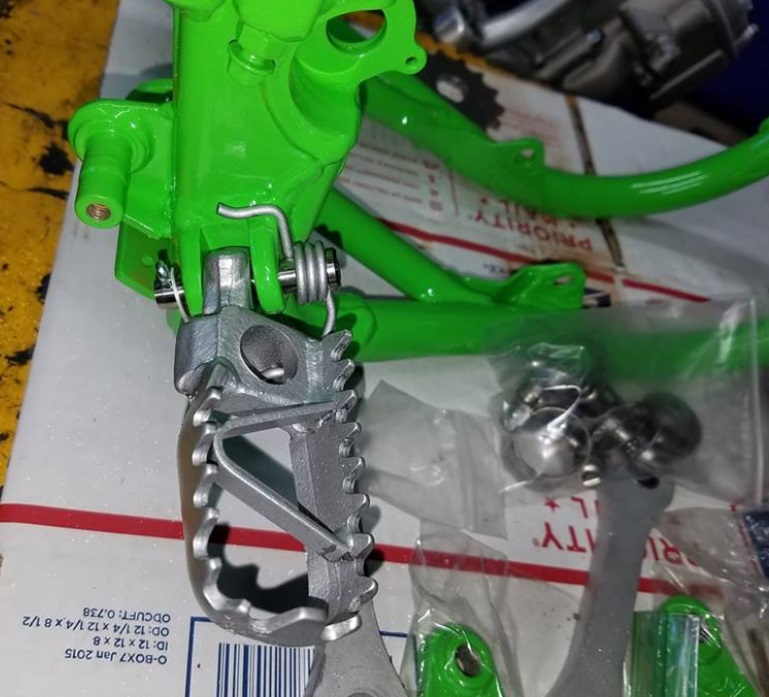

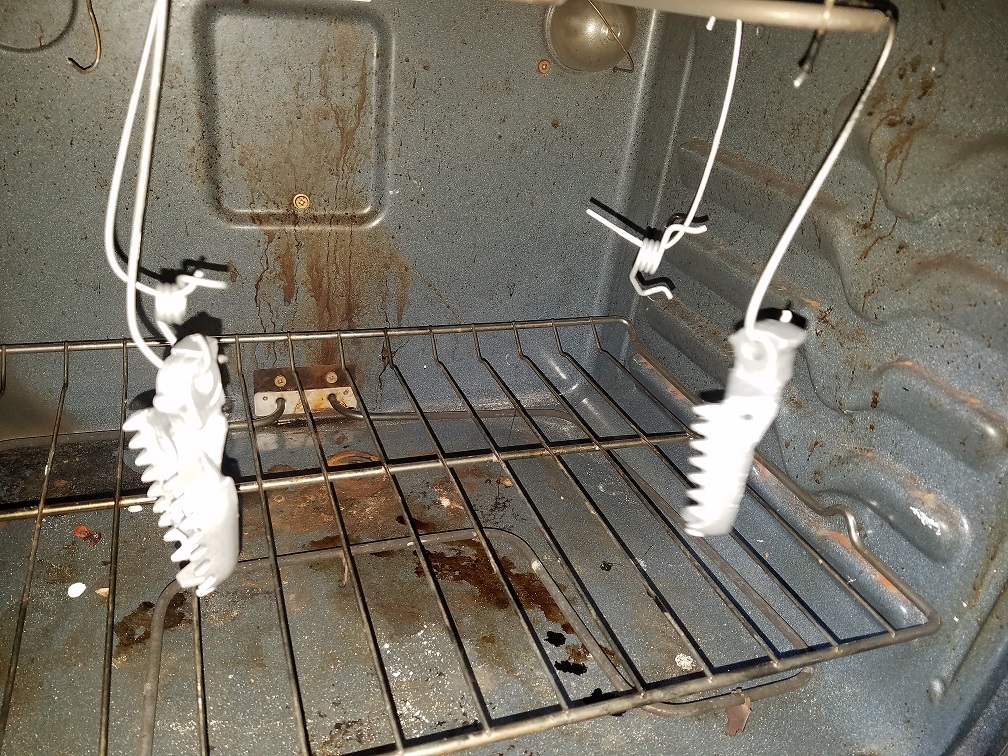

Pegs... They weren't bad but a fresh coat of paint and they will look marvelous :D
A little paint, some new hardware, and bam...
