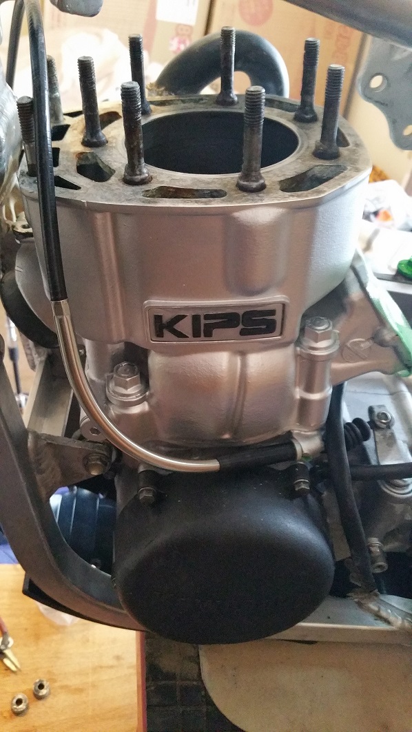

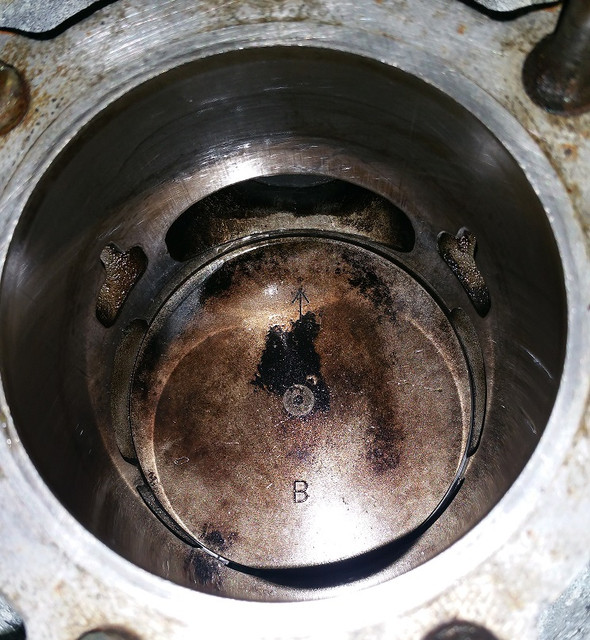

The reason I asked is because I ran the numbers and the calculated port timing would make your cylinder a 88 unless a lot of work has been done to it.
I can tell if I see the side and if you post another of the sub ports looking into the cylinder.
I want to give you the best advice that I can.
Re: 1987 KX500 Head mods for kyser777
Posted: Thu Dec 27, 2018 6:07 am
by kyser777
the cylinder is black originally, has been painted.
the KIPS badges has been glued.
thanks
