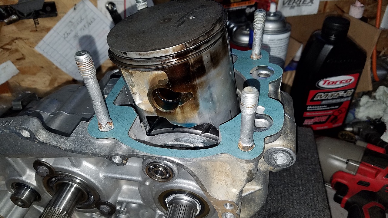

Disassembly went fairly smoothly... no issues.... Nothing really worn out beyond usability... Just dirty... and really not that bad.
KXGURU RACING JT ENGINE WORKS KX500 TURBO CRANK TESTING 121.jpg (501.66 KiB) Viewed 16556 times
