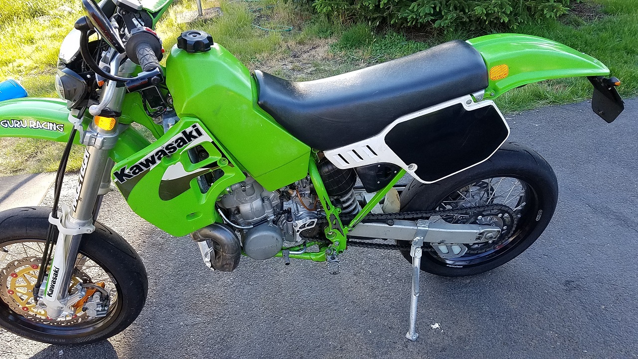

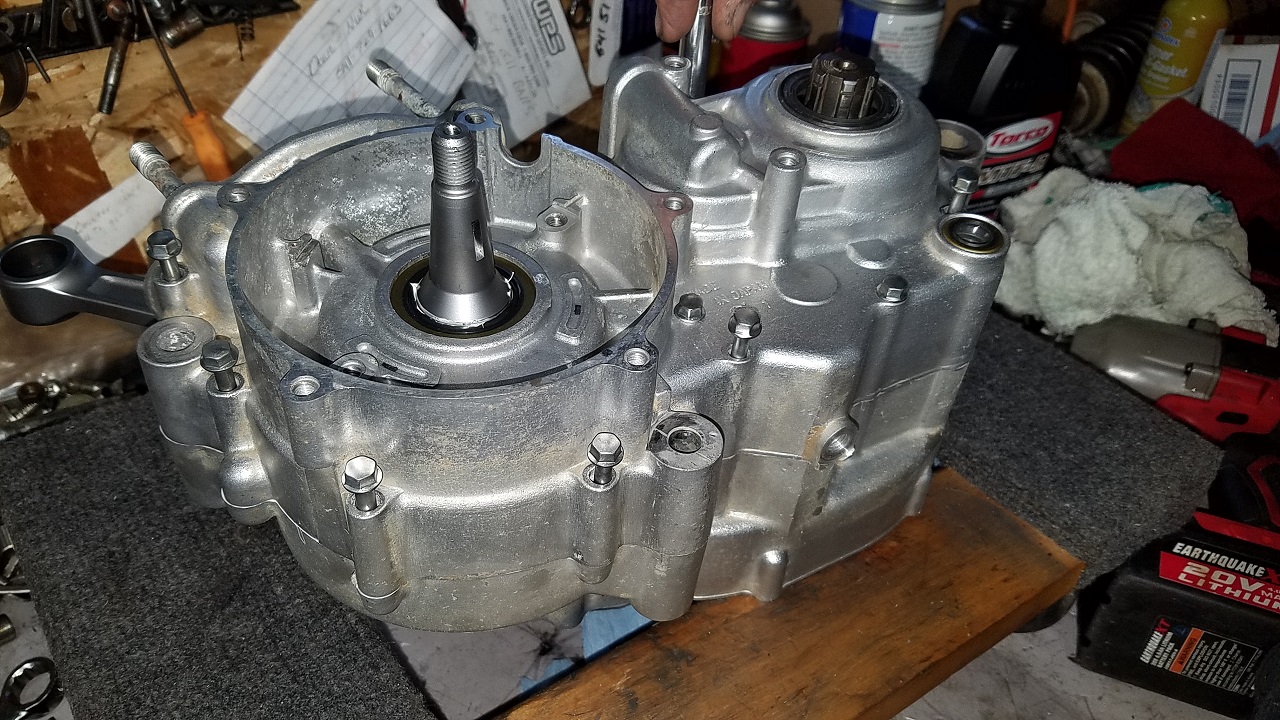

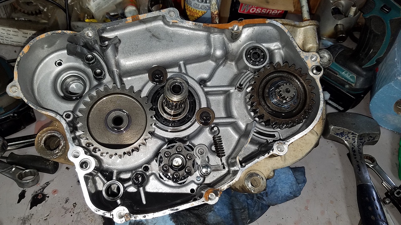

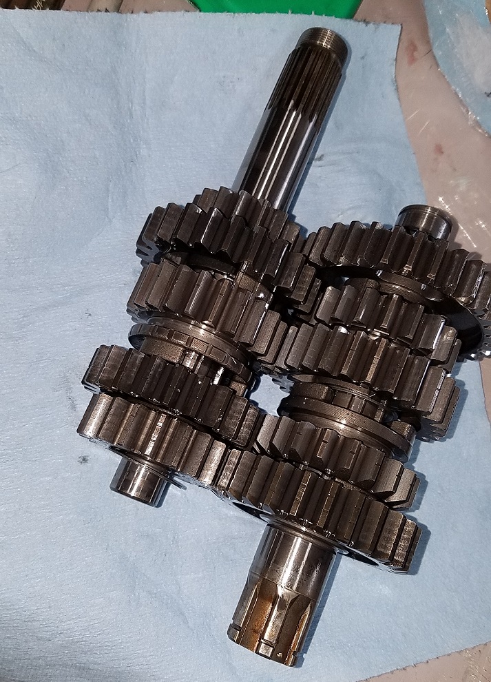

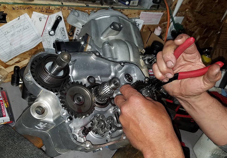

Disassembly went fairly smoothly... no issues.... Nothing really worn out beyond usability... Just dirty... and really not that bad.
KXGURU RACING JT ENGINE WORKS KX500 TURBO CRANK TESTING 121.jpg (501.66 KiB) Viewed 16564 times

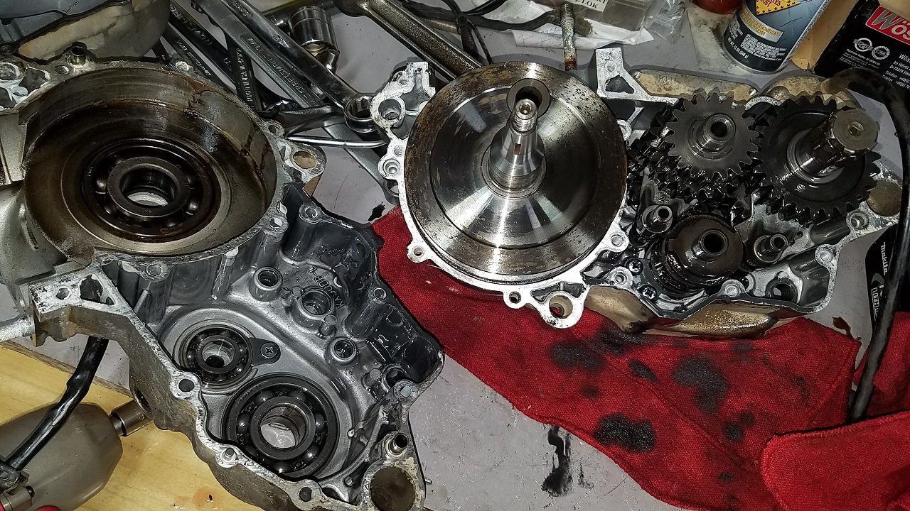

KXGURU RACING JT ENGINE WORKS KX500 TURBO CRANK TESTING 122.jpg (536.51 KiB) Viewed 16564 times
KXGURU RACING JT ENGINE WORKS KX500 TURBO CRANK TESTING 123.jpg (339.8 KiB) Viewed 16564 times

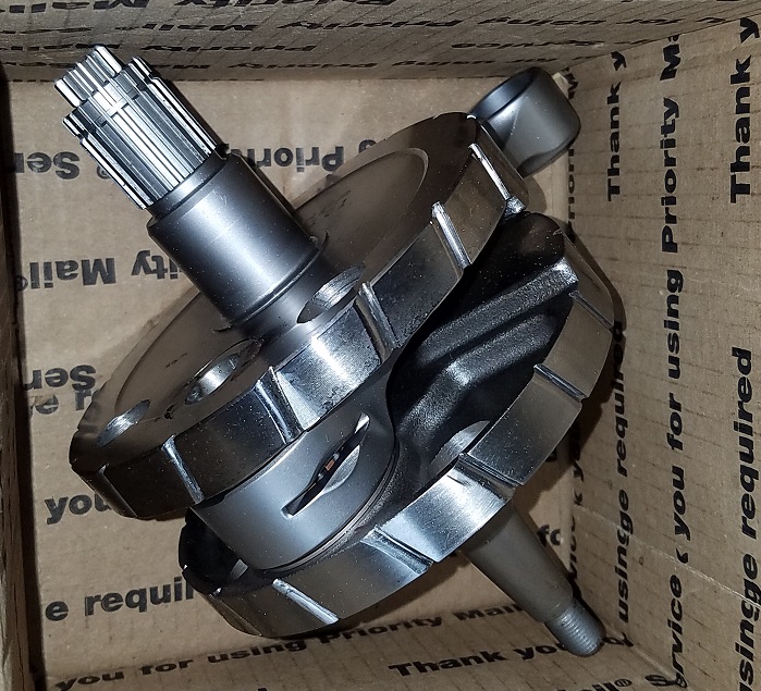

If the testing proves out that this is a good mod then this crank will be disassembled, cleaned, polished, and sent to Steve Parris for his patented Turbo Crank modifications, then reassembly and balance. For my own bike, I will not build a crank without balancing.
KXGURU RACING JT ENGINE WORKS KX500 TURBO CRANK TESTING 124.jpg (282.32 KiB) Viewed 16564 times

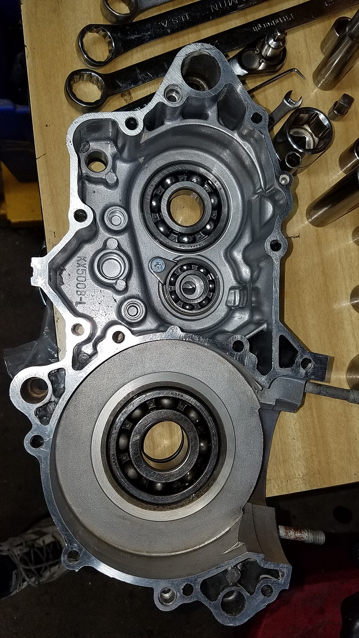

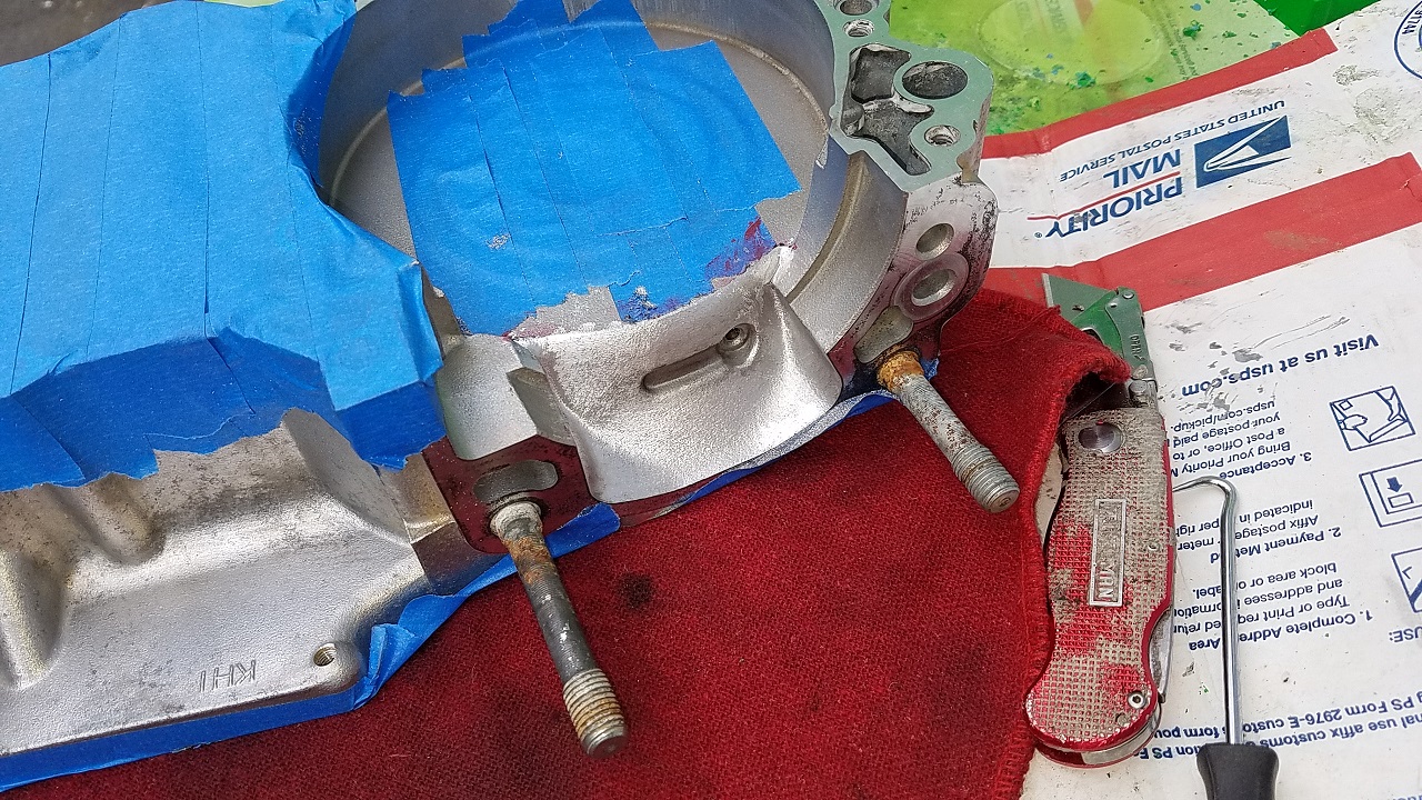

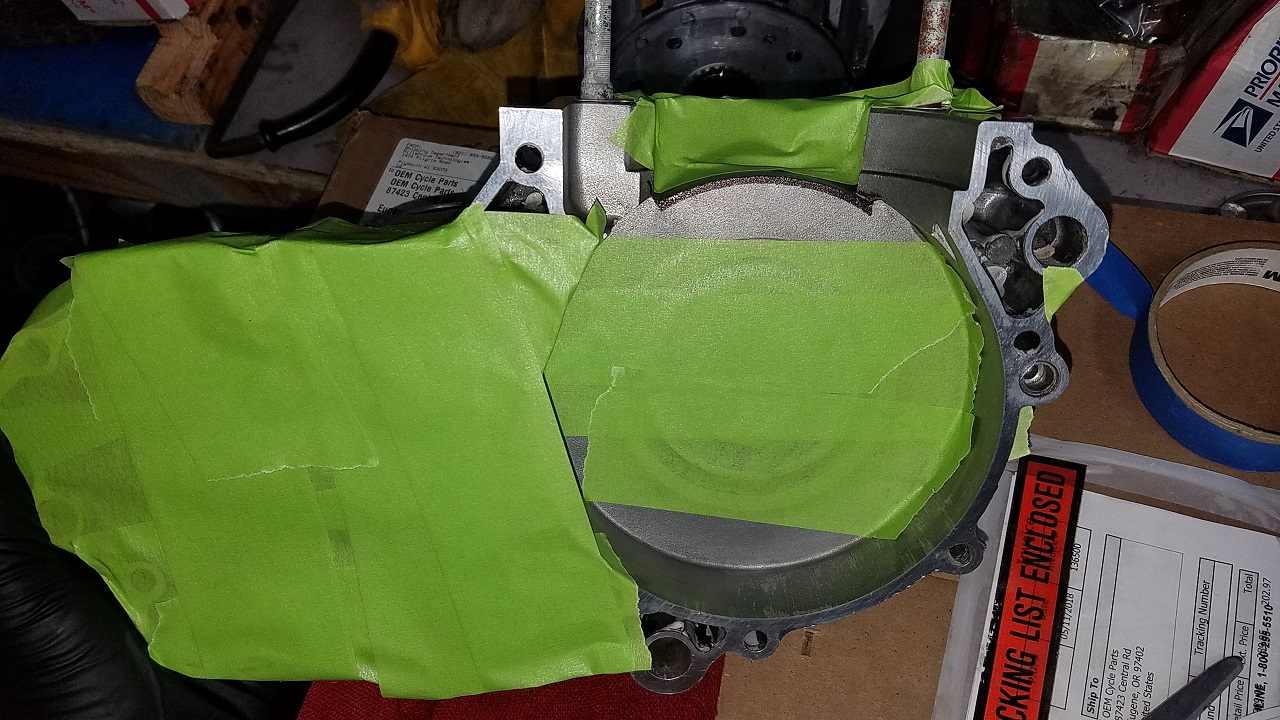

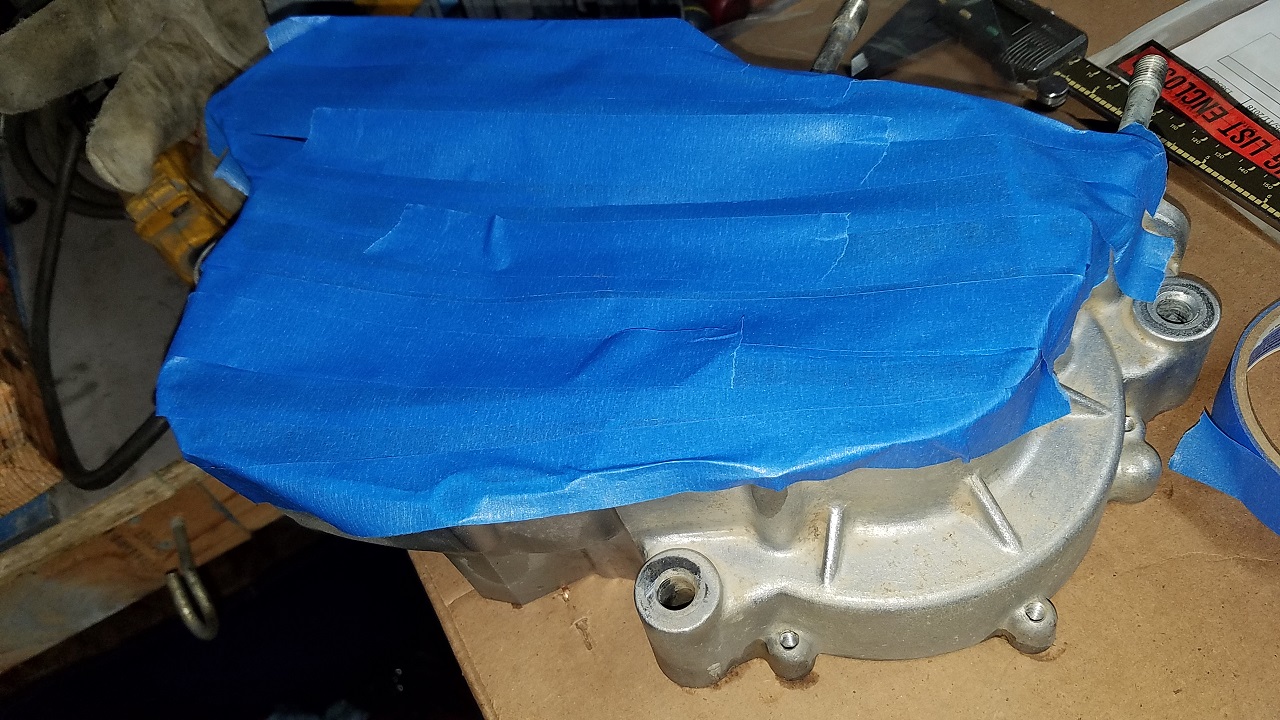

Masking off the bearings from the work that will be done on the cases.
We don't want to contaminate the bearings and seals any more then what would happen during a careful disassembly.
KXGURU RACING JT ENGINE WORKS KX500 TURBO CRANK TESTING 126.jpg (370.96 KiB) Viewed 16563 times
KXGURU RACING JT ENGINE WORKS KX500 TURBO CRANK TESTING 127.jpg (469.12 KiB) Viewed 16563 times

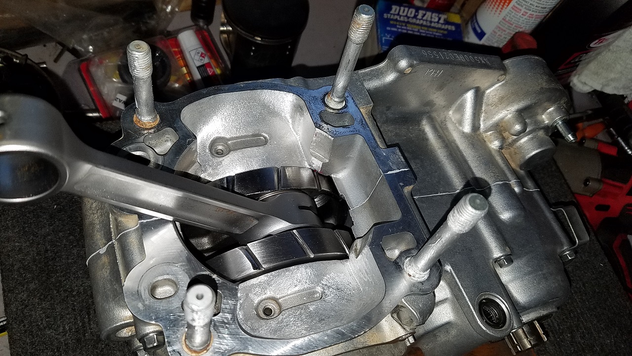

You can see the black mark at the top of the crank area.
that is to give us a guide when we round the corner.
KXGURU RACING JT ENGINE WORKS KX500 TURBO CRANK TESTING 128.jpg (398.02 KiB) Viewed 16562 times

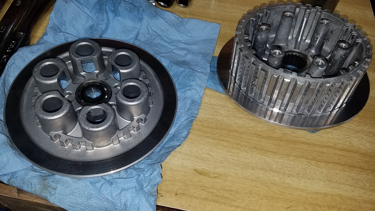

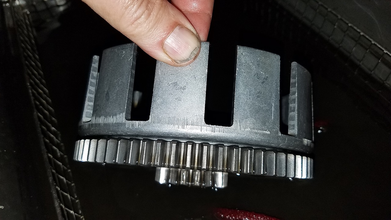

The clutch components looked good so they were rinsed off and put back in... even the plates...
KXGURU RACING JT ENGINE WORKS KX500 TURBO CRANK TESTING 131.jpg (315.12 KiB) Viewed 16559 times
KXGURU RACING JT ENGINE WORKS KX500 TURBO CRANK TESTING 132.jpg (469.4 KiB) Viewed 16559 times

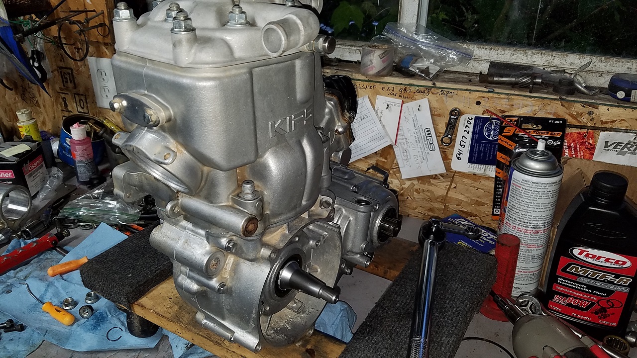

The crank is in so now it's time to get this thing rolling again..
KXGURU RACING JT ENGINE WORKS KX500 TURBO CRANK TESTING 133.jpg (454.34 KiB) Viewed 16559 times
KXGURU RACING JT ENGINE WORKS KX500 TURBO CRANK TESTING 134.jpg (437.52 KiB) Viewed 16559 times

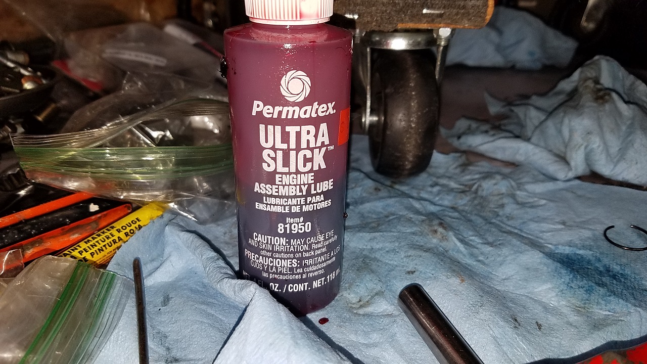

Just in case you were wondering what assembly lube Jason used..
KXGURU RACING JT ENGINE WORKS KX500 TURBO CRANK TESTING 137.jpg (403.55 KiB) Viewed 16557 times

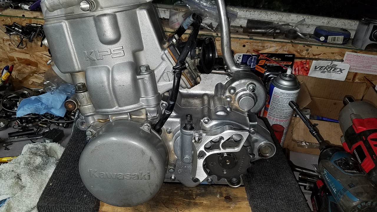

It's 9pm and we are ready to drop it back in... Not world record time but for what we did and how we had to do things, not bad :D
KXGURU RACING JT ENGINE WORKS KX500 TURBO CRANK TESTING 138.jpg (488.47 KiB) Viewed 16557 times

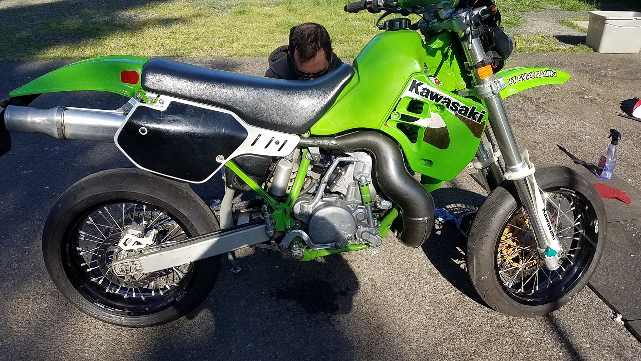

The engine is in and Jason is working on jetting...
KXGURU RACING JT ENGINE WORKS KX500 TURBO CRANK TESTING 140.jpg (561.6 KiB) Viewed 16553 times
After a few hours of test rides and jetting changes we are using a 152 main :o :shock: :o
I know I know... but that's what it want's with forced induction....
KXGURU RACING JT ENGINE WORKS KX500 TURBO CRANK TESTING 141.jpg (589.04 KiB) Viewed 16553 times
