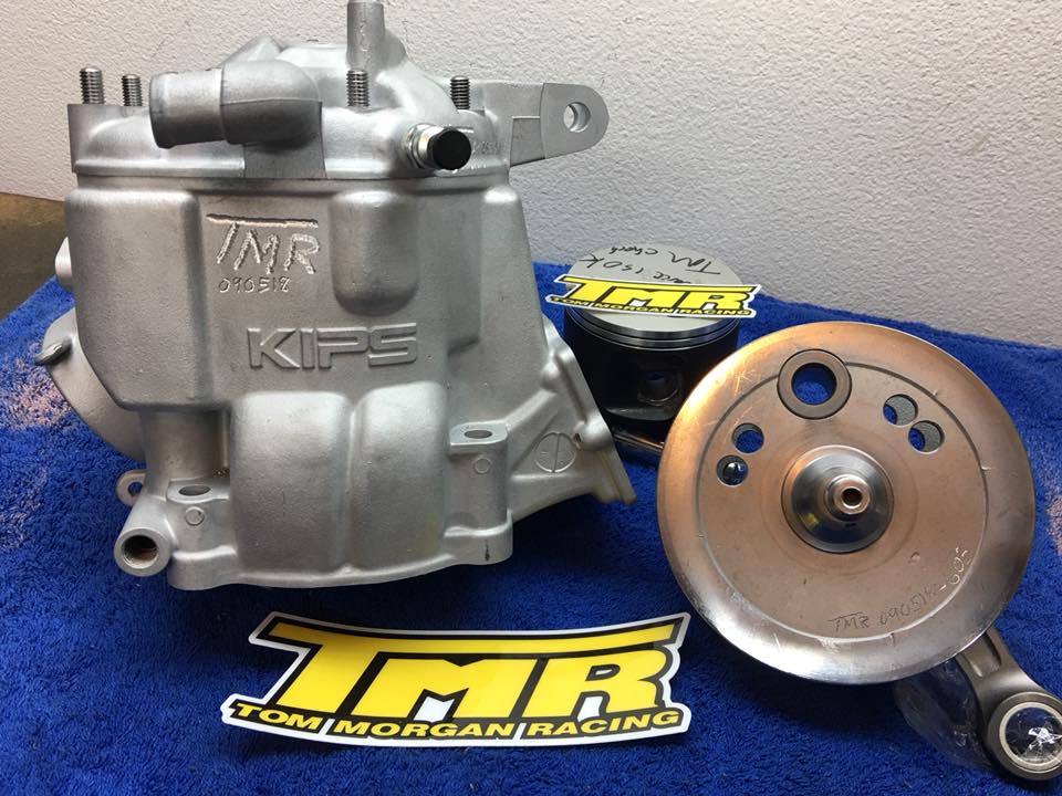

Tom Morgan Ported, polished, head re-cut, decomp, the works.
I have played with a lot of porting myself and for a good all around MX port job this would be hard to beat.
More power everywhere..
You must run good fuel..
This will do the job.

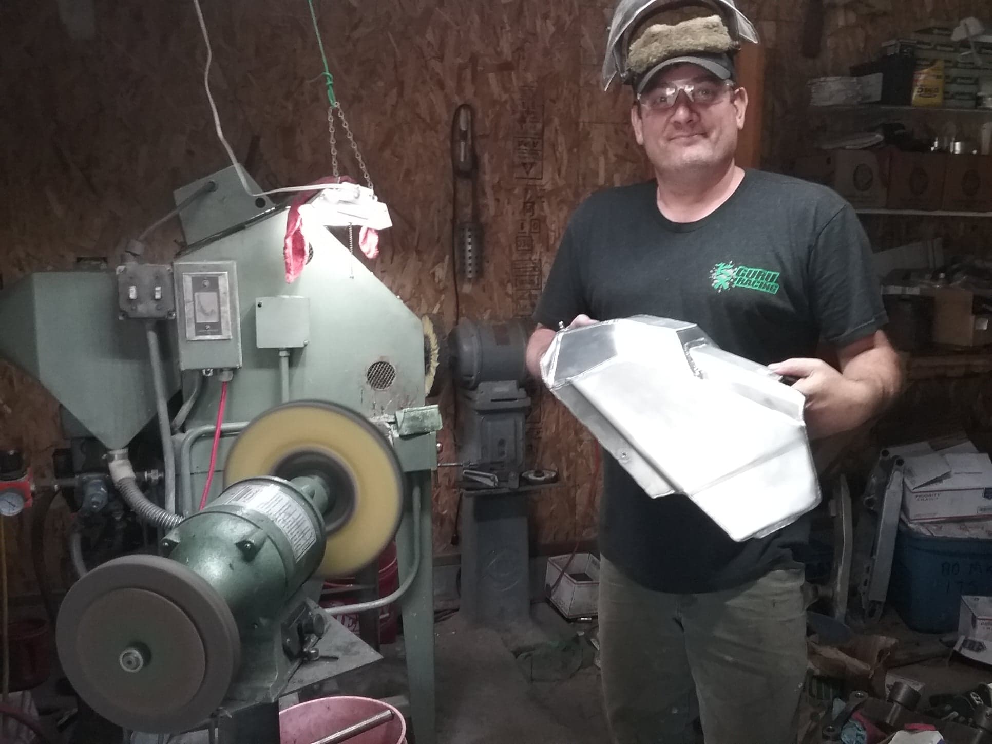

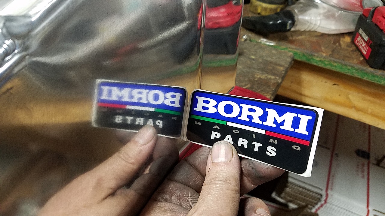

So... who would take a Italian made custom aluminum gas tank made for a KX500 and try to polish it? :lol:
SUNNY GARCIA KX GURU RACING BORMI ALUMIUM KX500 GAS TANK 101.jpg (279.02 KiB) Viewed 16425 times
SUNNY GARCIA KX GURU RACING BORMI ALUMIUM KX500 GAS TANK 102.jpg (350.51 KiB) Viewed 16425 times
SUNNY GARCIA KX GURU RACING BORMI ALUMIUM KX500 GAS TANK 103.jpg (359.16 KiB) Viewed 16425 times

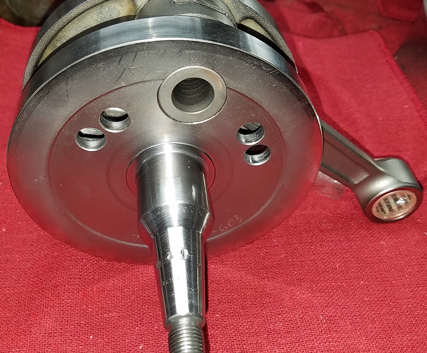

Re: Sunny Garcia Pro surfer KX Guru Racing KX500 build
This is a Tom Morgan Racing balanced and assembled KX500 Crank assembly with a Wossner rod.
It is going in Sunny Garcia's build featured in Racer X Magazine.
Something of note... There was no heavy metal used in the balancing of the crank.
Weight was removed but none was added.
For me, that is the best way to balance.

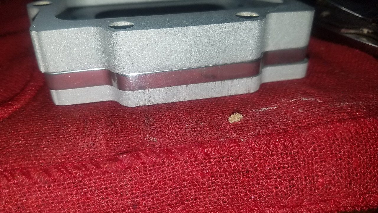

Here we have a Adam Millar custom VForce 2 reed block holder.
They are available from 1/4" to at least 1/2" in thickness.
Can you guess which is Sunny's? :lol:
KX GURU RACING SUNNY GARCIA ADAMMILLAR KX500 V FORCE CUSTOM 101.jpg (467.56 KiB) Viewed 16416 times
Every fastener was removed and red loctite was used to make sure none of the bolts rattle out and destruct Sunny's engine.
Superior quality, superior flow... Feel the power.....
KX GURU RACING SUNNY GARCIA ADAMMILLAR KX500 V FORCE CUSTOM 102.jpg (351.94 KiB) Viewed 16416 times

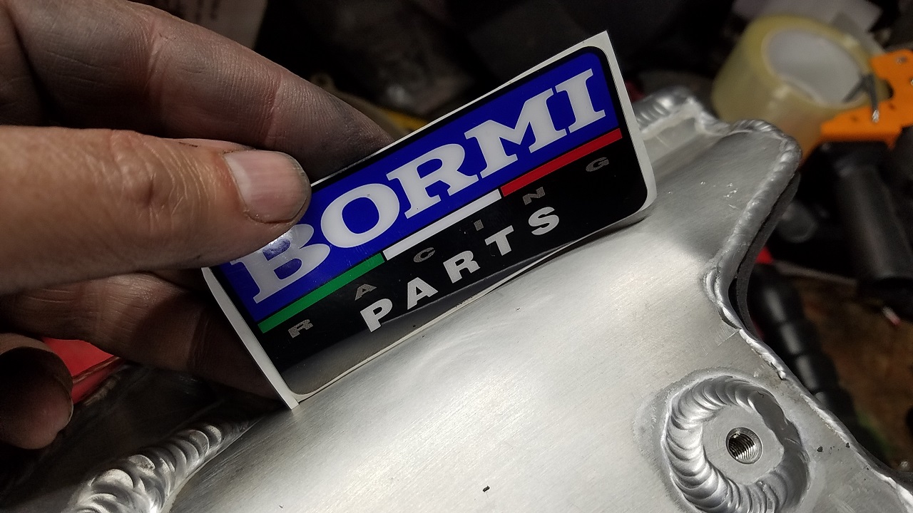

More work on Sunny's tank
SUNNY GARCIA KX GURU RACING BORMI ALUMIUM KX500 GAS TANK 104.jpg (416.87 KiB) Viewed 16412 times
SUNNY GARCIA KX GURU RACING BORMI ALUMIUM KX500 GAS TANK 105.jpg (372.84 KiB) Viewed 16412 times

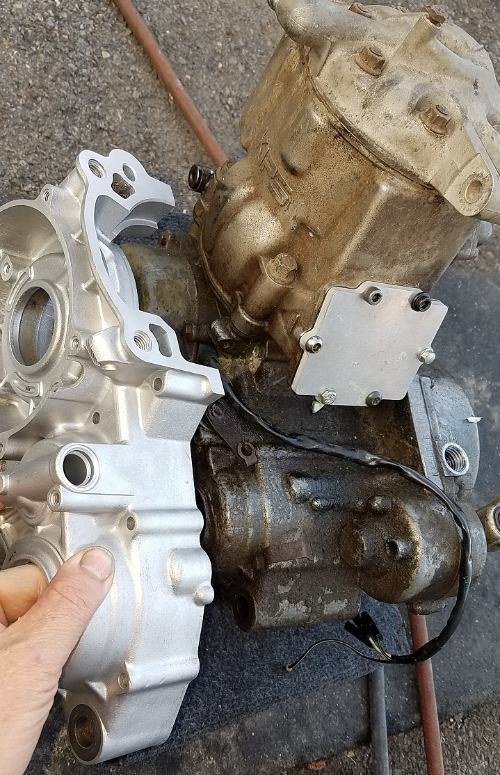

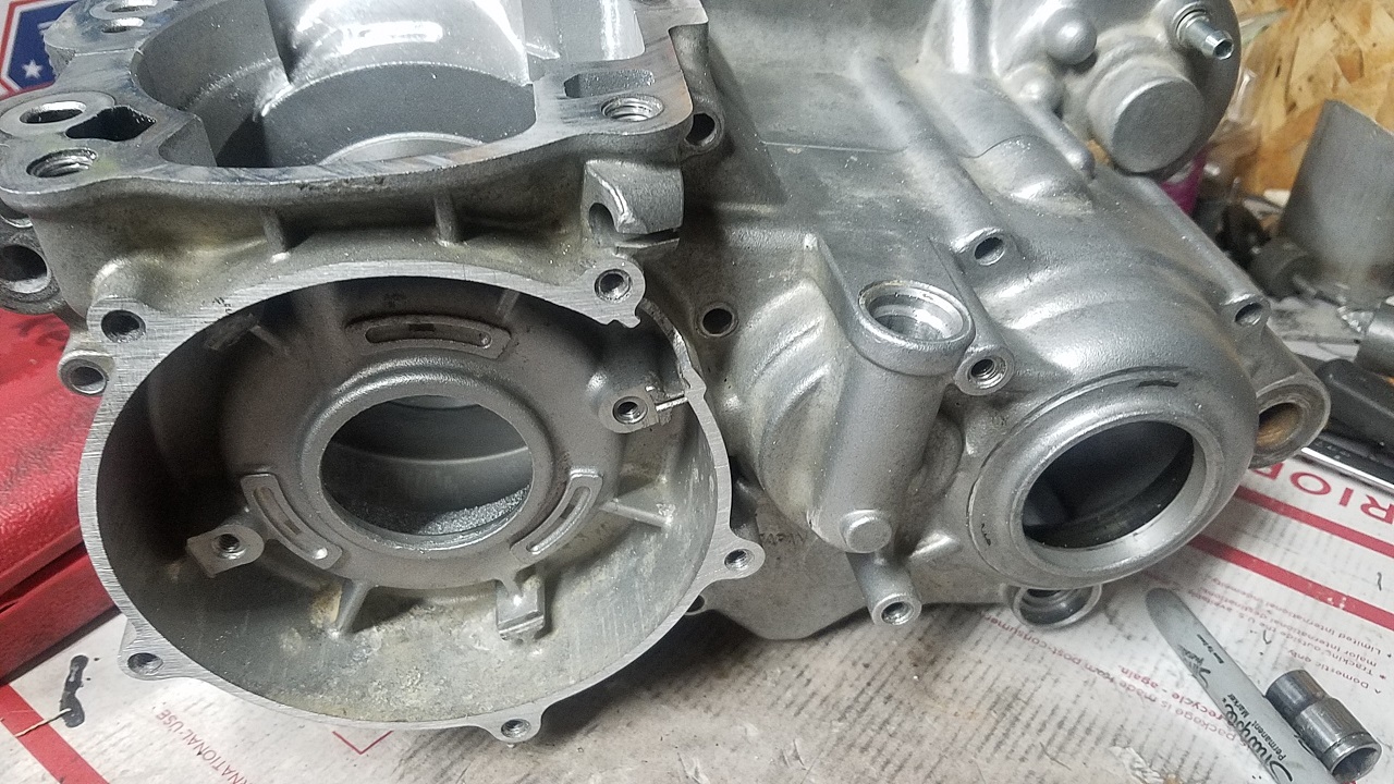

Jason hand lapped all mounting surfaces on the cases and performed all of KX Guru Racing case mods to improve lubrication... 8-)
Just need a trip through the vapor blaster and oven and they will be ready for assembly..
KX GURU RACING JT ENGINE WORKS SUNNY GARCIA CRANKCASE MODS 101.jpg (406.96 KiB) Viewed 16030 times
KX GURU RACING JT ENGINE WORKS SUNNY GARCIA CRANKCASE MODS 102.jpg (399.8 KiB) Viewed 16030 times

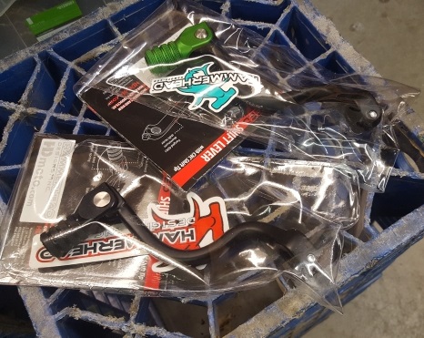

Hammerhead came though with a nice shift lever.
I have used Hammerhead products for years and I can tell you from experience that they are top quality.
