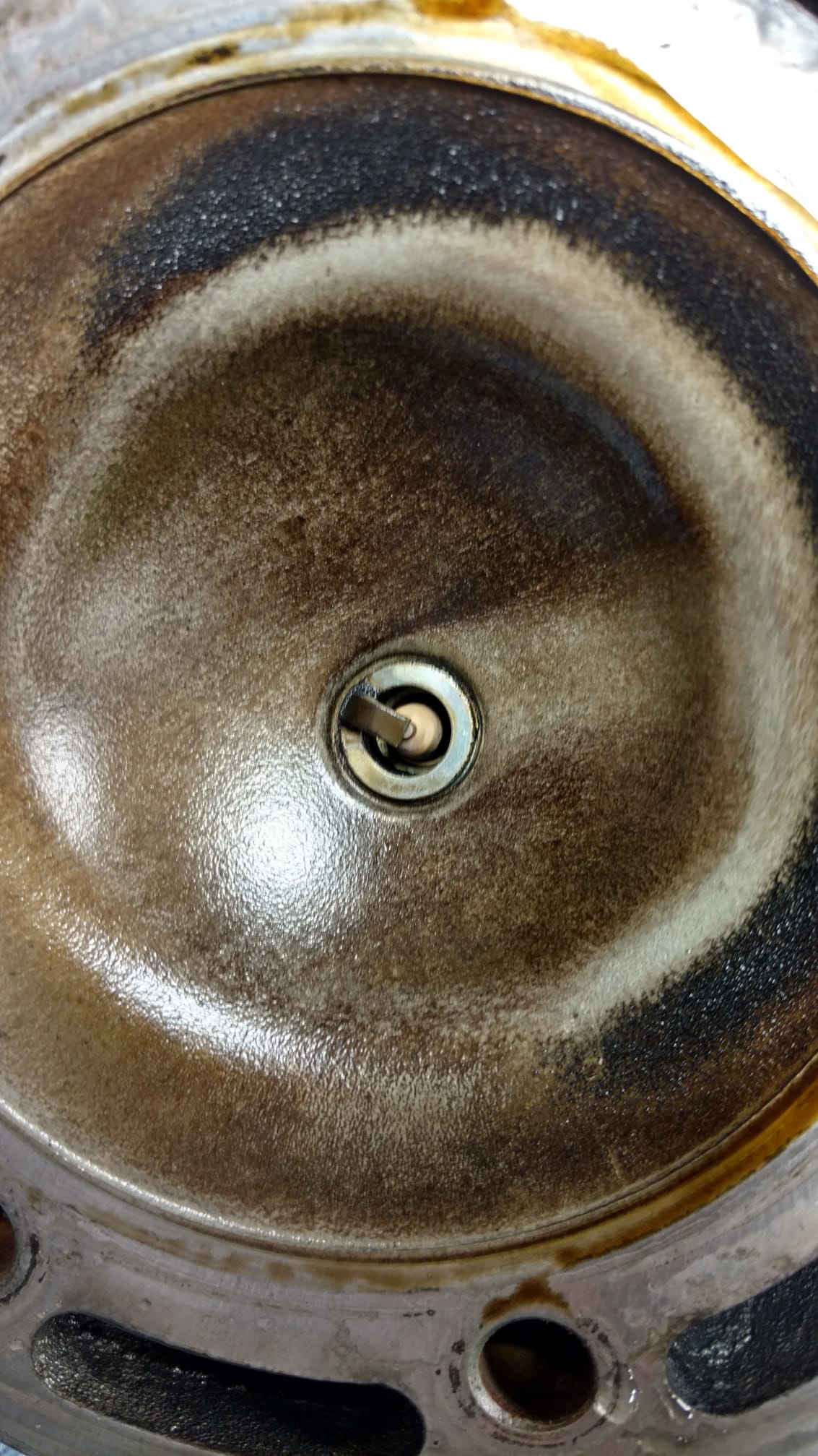

I get excellent performance and mocha brown plug readings when up that high.
