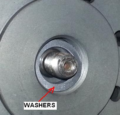

The first thing I noticed is that my crank stuck too far out into the flywheel hole :o
KX500 2001 MZB INSTALLATION 3-1.JPG (22.45 KiB) Viewed 16503 times

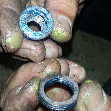

But, the kit came with 3 washers that were perfect for the job... Almost like they knew I would need them..
KX500 2001 MZB INSTALLATION 3-2.JPG (21.83 KiB) Viewed 16503 times
So I put the washers on then slipped the flywheel on with just a light smear of blue (Weak) retaining compound.

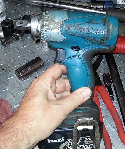

Then I took my Makita and ran the nut up on the flywheel fast to drive the flywheel on and set it in position.
Makita...
KX500 2001 MZB INSTALLATION 3-4.JPG (48.42 KiB) Viewed 16503 times
Because the flywheel moved when I did this (About .010") I had to figure something else out.
So, I read the directions :?
It says to use a block of wood to lightly tap the flywheel on and then set the nut.
I tried it by the directions and the flywheel moved again!
So after talking with Alward25 I tried another tactic...

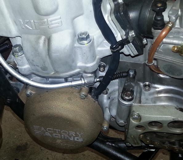

Put the stator cover on and we are ready to run the wires.
KX500 2001 MZB INSTALLATION 2-5.JPG (52.62 KiB) Viewed 16499 times
