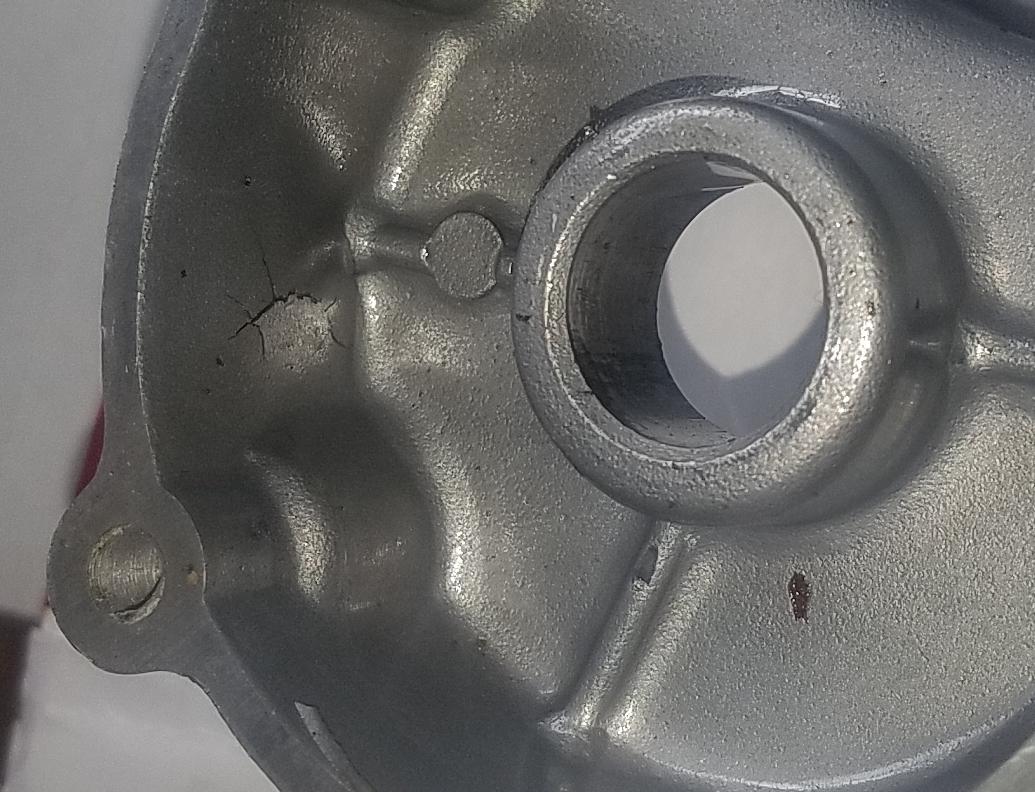

Plating is hashed..

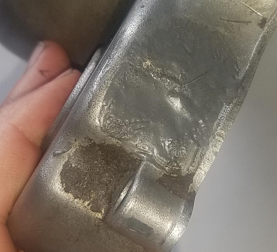

Clutch cover is jacked up..

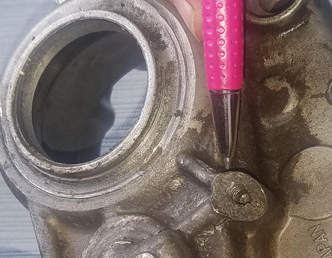

Oh, good ole JB Weld... Someone knew they had an issue.. :lol:

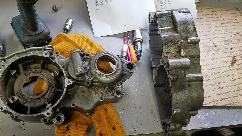

Cases are in sad shape,,
KX GURU RACING 1992 KX500 SNOW BIKE ENGINE BUILD FOR BRENT 126.JPG (150.69 KiB) Viewed 37834 times
But no worries... After Jason and I get done with them.... You won't recognize them...
Here is what the left case looks like just before I sent it off to weld..
KX GURU RACING 1992 KX500 SNOW BIKE ENGINE BUILD FOR BRENT 127.JPG (111 KiB) Viewed 37833 times
This is what we call our Pre-clean up..
Gotta make sure the welder has nice clean material to work with..

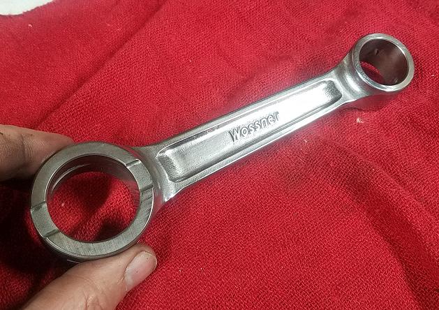

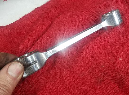

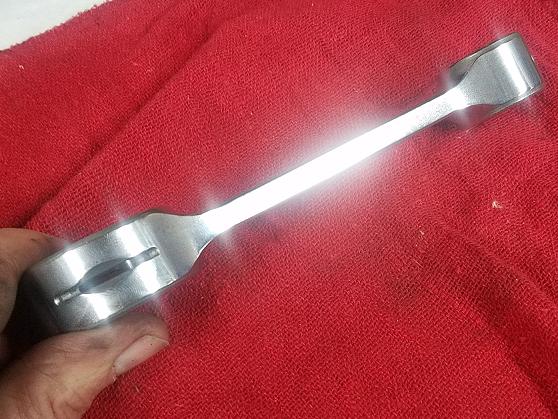

Wossner rod after polishing..
KX GURU RACING 1992 KX500 SNOW BIKE ENGINE BUILD FOR BRENT 131.JPG (55.24 KiB) Viewed 37832 times
KX GURU RACING 1992 KX500 SNOW BIKE ENGINE BUILD FOR BRENT 128.JPG (76.19 KiB) Viewed 37832 times
KX GURU RACING 1992 KX500 SNOW BIKE ENGINE BUILD FOR BRENT 129.JPG (57.08 KiB) Viewed 37832 times
KX GURU RACING 1992 KX500 SNOW BIKE ENGINE BUILD FOR BRENT 130.JPG (59.93 KiB) Viewed 37832 times

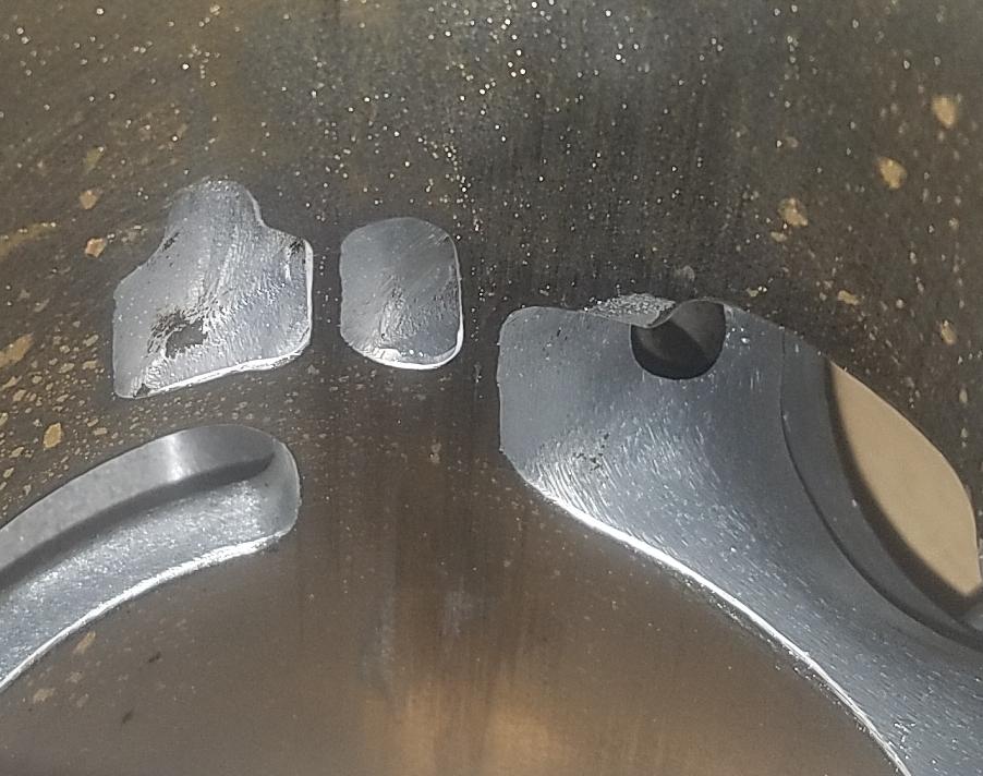

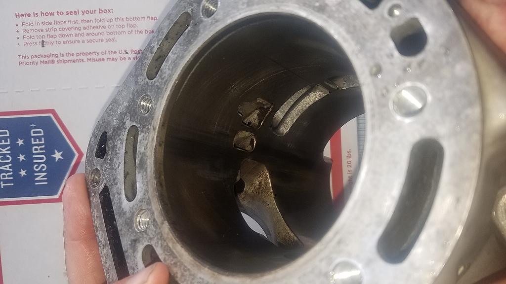

I went ahead and spent some time last night porting the cylinder.
Normally the exhaust ports look like this..
KX GURU RACING 1992 KX500 SNOW BIKE ENGINE BUILD FOR BRENT 133.JPG (90.38 KiB) Viewed 37794 times
But not for long... Just starting to whittle away some material..
KX GURU RACING 1992 KX500 SNOW BIKE ENGINE BUILD FOR BRENT 134.JPG (78.43 KiB) Viewed 37794 times
