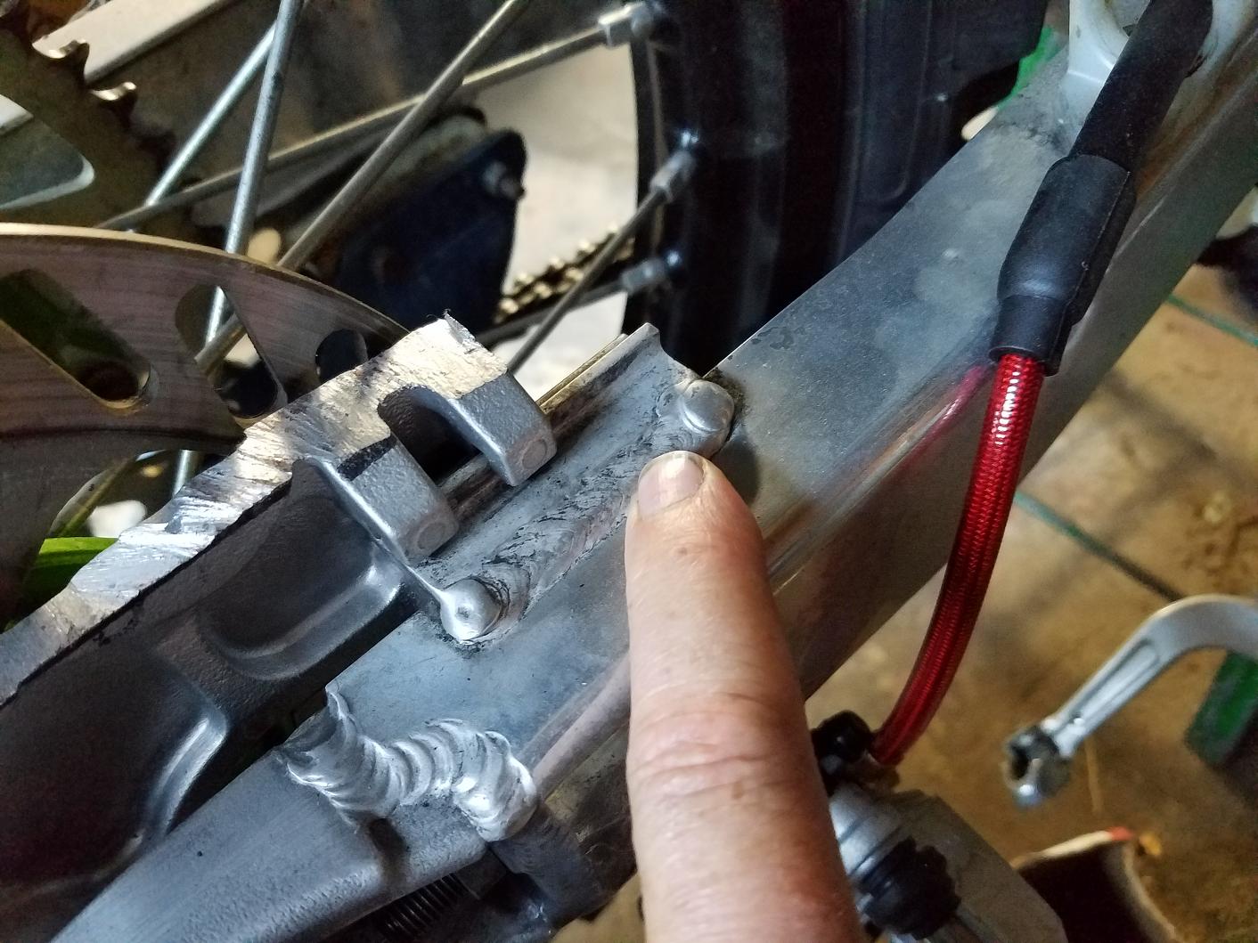

And I make a new hanger on the inside of the swing arm to fit this..
KXGURU.COM KX500 REAR BRAKE MOD 105.JPG (171.74 KiB) Viewed 12691 times

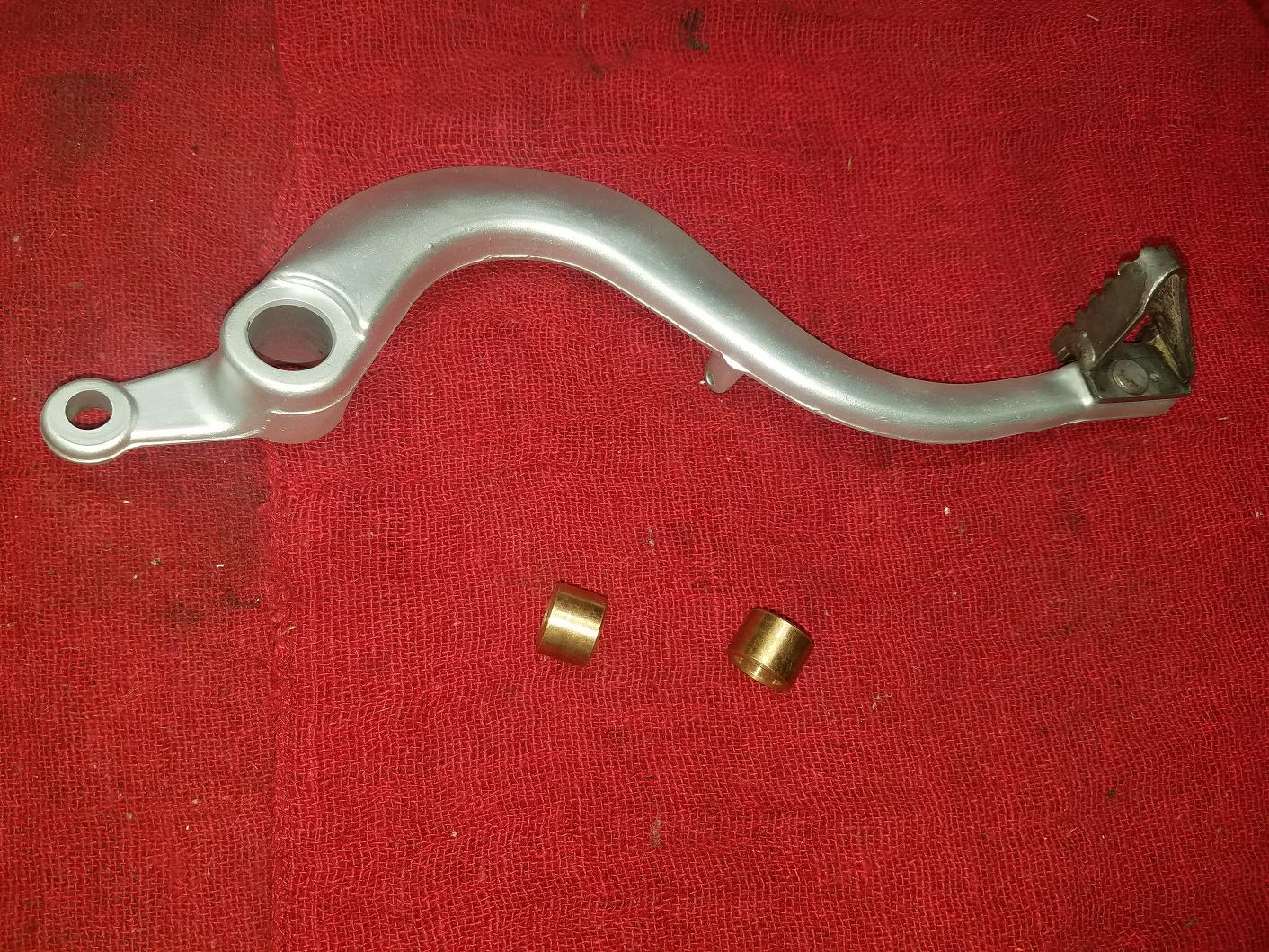

Back to the rear brake lever...
KXGURU.COM KX500 REAR BRAKE MOD 106.JPG (409.93 KiB) Viewed 12658 times
KXGURU.COM KX500 REAR BRAKE MOD 107.JPG (203.02 KiB) Viewed 12658 times
Ready to test fit
