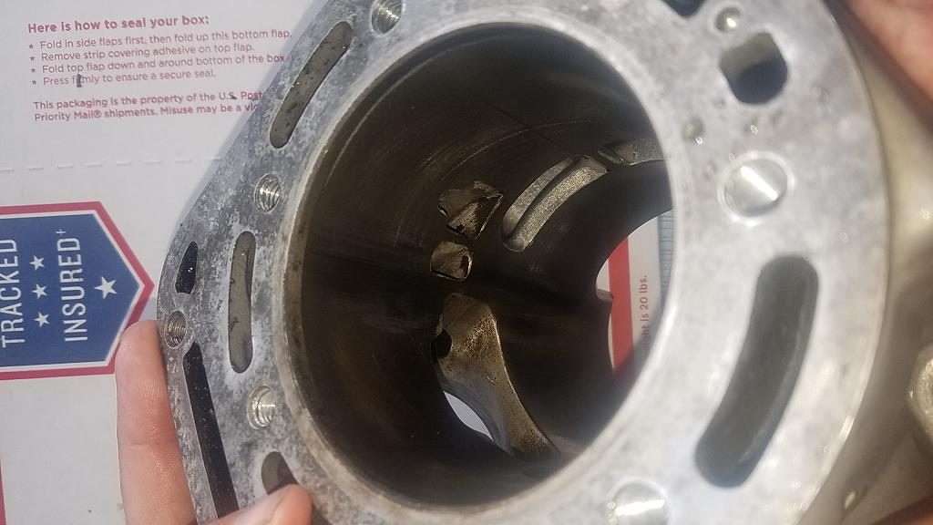

Plating is hashed..
KX GURU RACING 1992 KX500 SNOW BIKE ENGINE BUILD FOR BRENT 121.JPG (83.9 KiB) Viewed 10885 times

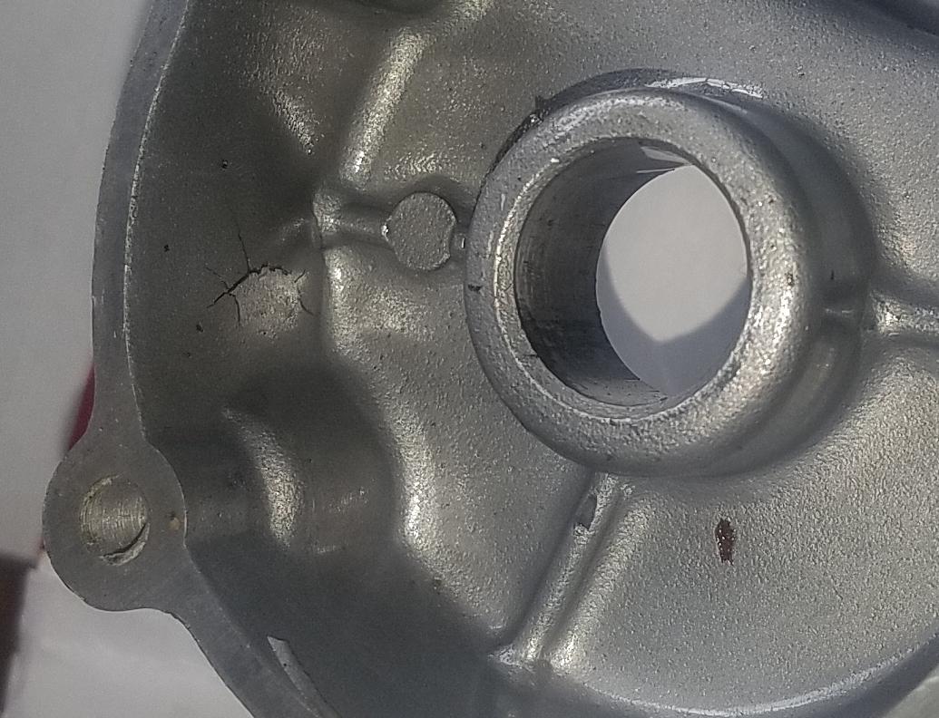

Cases are in sad shape,,
KX GURU RACING 1992 KX500 SNOW BIKE ENGINE BUILD FOR BRENT 126.JPG (150.69 KiB) Viewed 10883 times
But no worries... After Jason and I get done with them.... You won't recognize them...
Here is what the left case looks like just before I sent it off to weld..
KX GURU RACING 1992 KX500 SNOW BIKE ENGINE BUILD FOR BRENT 127.JPG (111 KiB) Viewed 10882 times
This is what we call our Pre-clean up..
Gotta make sure the welder has nice clean material to work with..

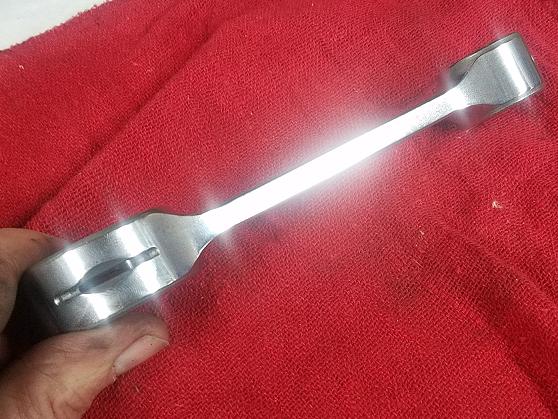

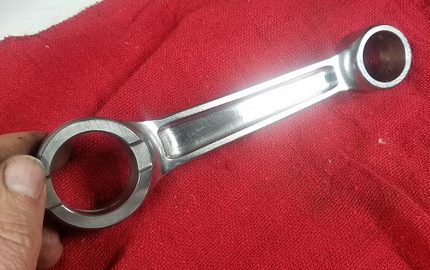

Wossner rod after polishing..
KX GURU RACING 1992 KX500 SNOW BIKE ENGINE BUILD FOR BRENT 131.JPG (55.24 KiB) Viewed 10881 times
KX GURU RACING 1992 KX500 SNOW BIKE ENGINE BUILD FOR BRENT 128.JPG (76.19 KiB) Viewed 10881 times
KX GURU RACING 1992 KX500 SNOW BIKE ENGINE BUILD FOR BRENT 129.JPG (57.08 KiB) Viewed 10881 times
KX GURU RACING 1992 KX500 SNOW BIKE ENGINE BUILD FOR BRENT 130.JPG (59.93 KiB) Viewed 10881 times

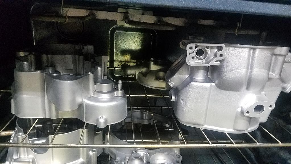

I like eye candy 8-)
The top rack has the parts for this project.
All these are in their pre-cleaning stage..
KX GURU RACING 1992 KX500 SNOW BIKE ENGINE BUILD FOR BRENT 132.JPG (117.13 KiB) Viewed 10880 times

I went ahead and spent some time last night porting the cylinder.
Normally the exhaust ports look like this..
KX GURU RACING 1992 KX500 SNOW BIKE ENGINE BUILD FOR BRENT 133.JPG (90.38 KiB) Viewed 10843 times
But not for long... Just starting to whittle away some material..
KX GURU RACING 1992 KX500 SNOW BIKE ENGINE BUILD FOR BRENT 134.JPG (78.43 KiB) Viewed 10843 times
