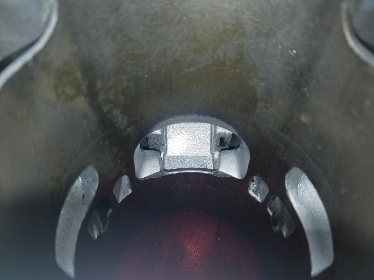

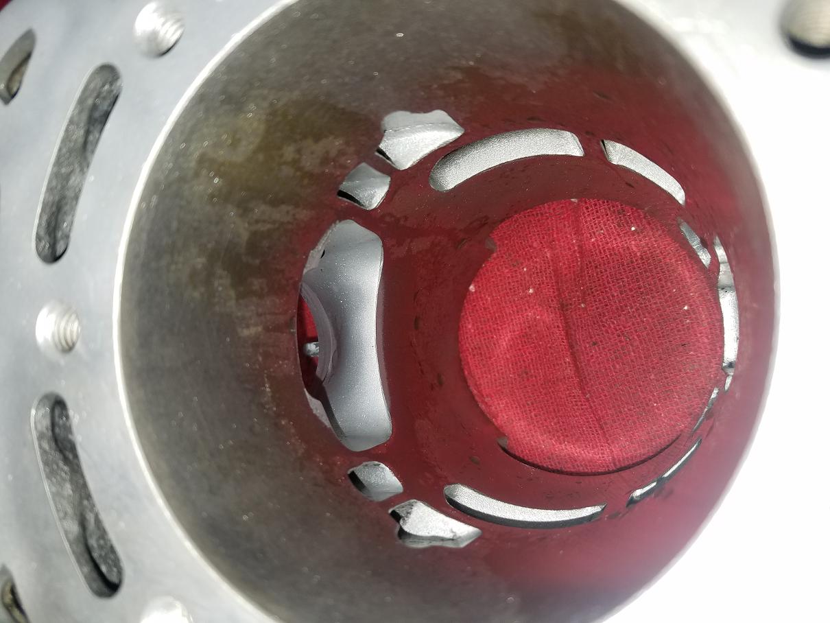

I was doing some more clean up at the bottom of the cylinder and discovered that the plating is wearing through at the bottom of the exhaust port.
KX GURU RACING SEAN COLLIER KX500 177.JPG (124.62 KiB) Viewed 11289 times
KX GURU RACING SEAN COLLIER KX500 178.JPG (91.68 KiB) Viewed 11289 times
But, we are not rebuilding anything on this except for addressing the shifting issues.

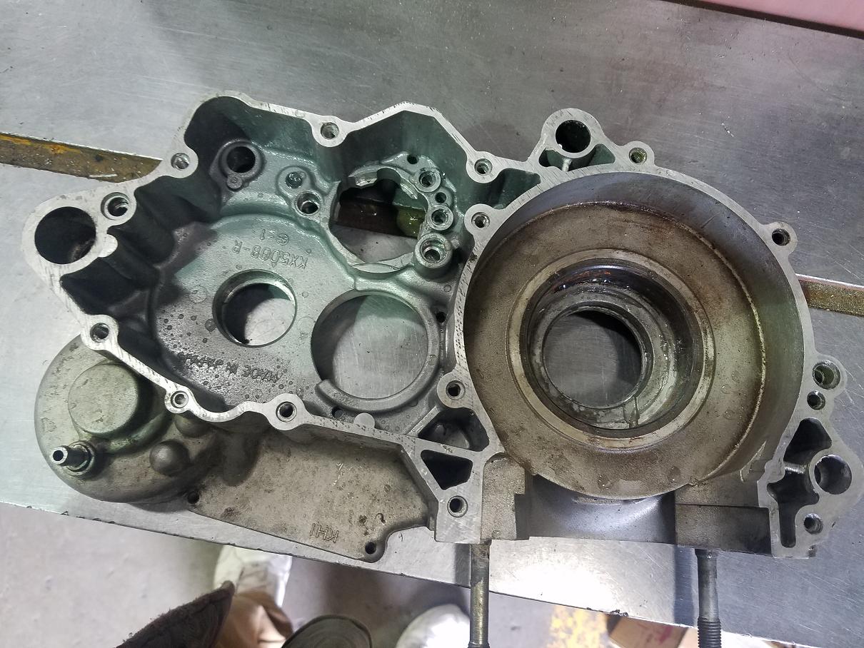

Posted: Wed Oct 05, 2016 3:45 am
The left main seal was leaking.
I was told that there was some sort of repair done there.
Sure enough, the main bearing journal was bored out then sleeved.
In practice, this would be an excellent repair.
Unfortunately this one was not carried out correctly.
I believe that it is out of round which may be helping contribute to the intense vibration this motor puts out.
KX GURU RACING SEAN COLLIER KX500 187.JPG (234.04 KiB) Viewed 11286 times

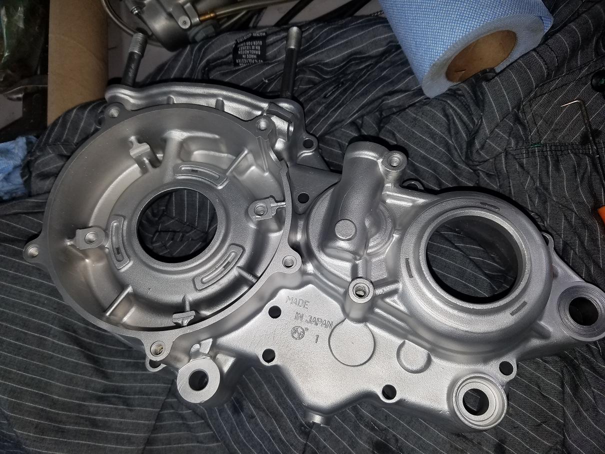

Going back to our original mandate which was to fix the shifting issue I really should just put it back together as is..
However, I can't justify it so I rounded up this replacement case..
She is a beauty..
KX GURU RACING SEAN COLLIER KX500 180.JPG (256.41 KiB) Viewed 11286 times
KX GURU RACING SEAN COLLIER KX500 181.JPG (241.1 KiB) Viewed 11286 times
The fact is I was going to save this case for something special so it's going to a good cause ;)

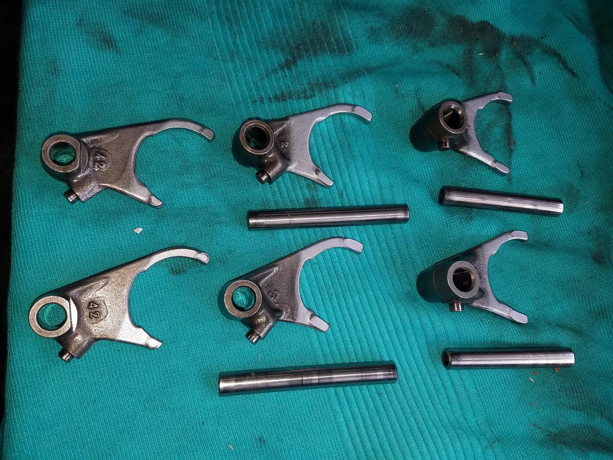

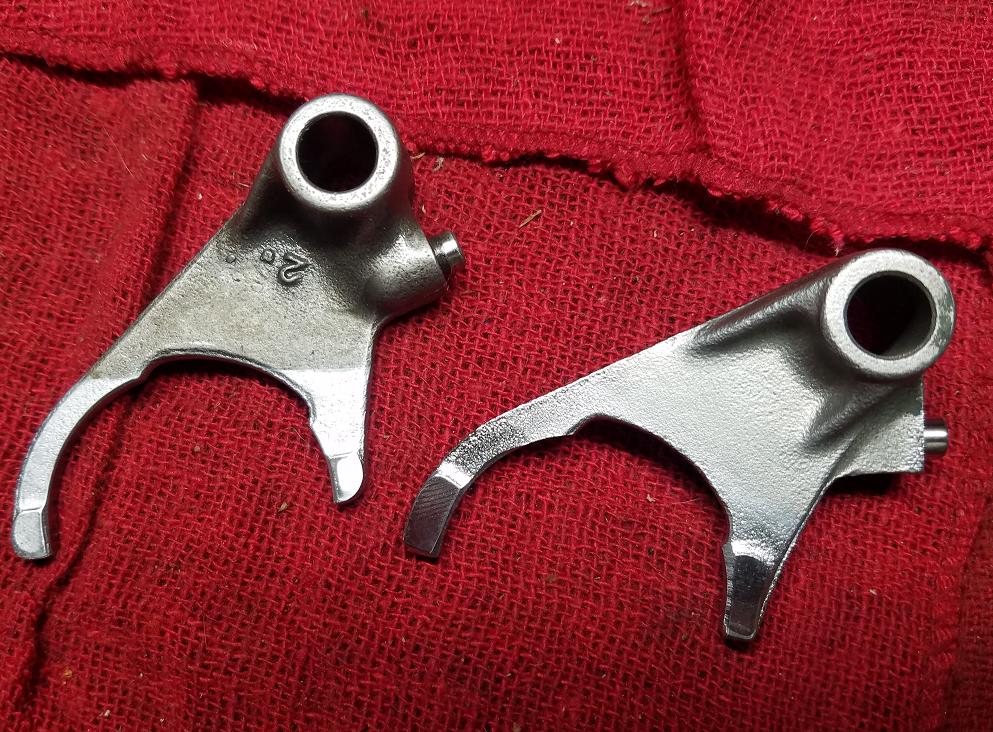

Posted: Wed Oct 05, 2016 3:50 am

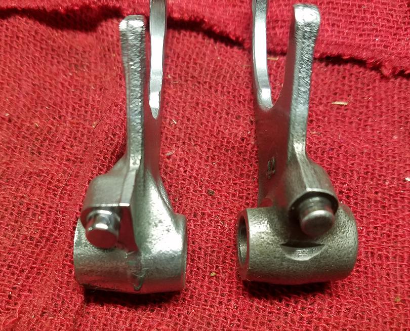

I compared 3 sets of shift forks to find the set with the least amount of wear.
I actually compared these two used sets to a brand new factory set still in the package.
Believe it or not, some of the used parts were closer to new spec then the new forks :o :shock: :o
KX GURU RACING SEAN COLLIER KX500 179.JPG (349 KiB) Viewed 11285 times
The Fork on the right has the tips polished. The fork on the left is not polished.
KX GURU RACING SEAN COLLIER KX500 186.JPG (177.7 KiB) Viewed 11285 times
Even though this is a major budget build and we are only suppose to fix the shifting issue, the goal is to make it shift better then any other KX500 Sean has rode to date.
On Sean's all new bike we will surpass this bike.... :geek:
The left shift fork pin is polished, the right is not.
KX GURU RACING SEAN COLLIER KX500 184.JPG (131.8 KiB) Viewed 11285 times

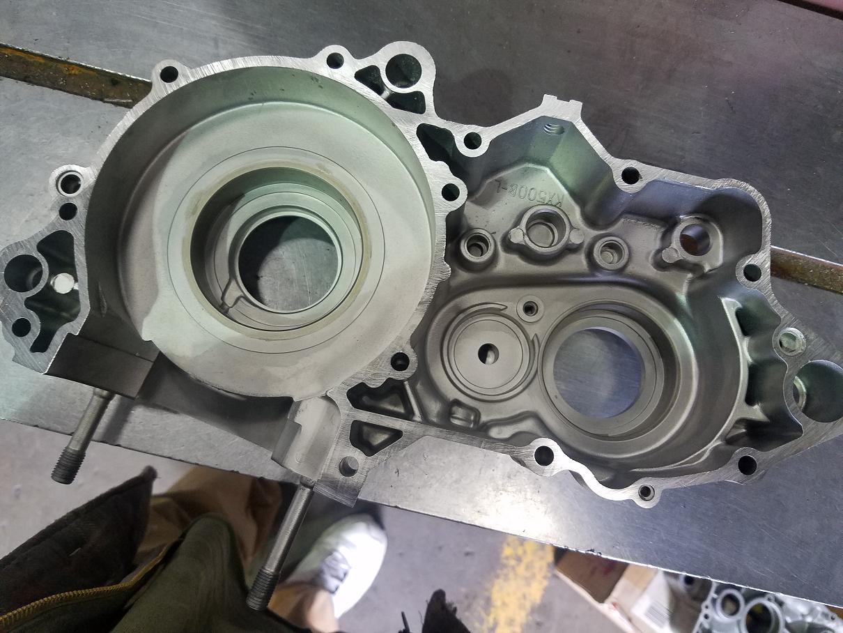

Ok, took the cases down to a local machine shop and ran the cases on a surface machine..
Before..
KX GURU RACING SEAN COLLIER KX500 178.JPG (184.9 KiB) Viewed 11276 times
After..
KX GURU RACING SEAN COLLIER KX500 179.JPG (176.6 KiB) Viewed 11276 times

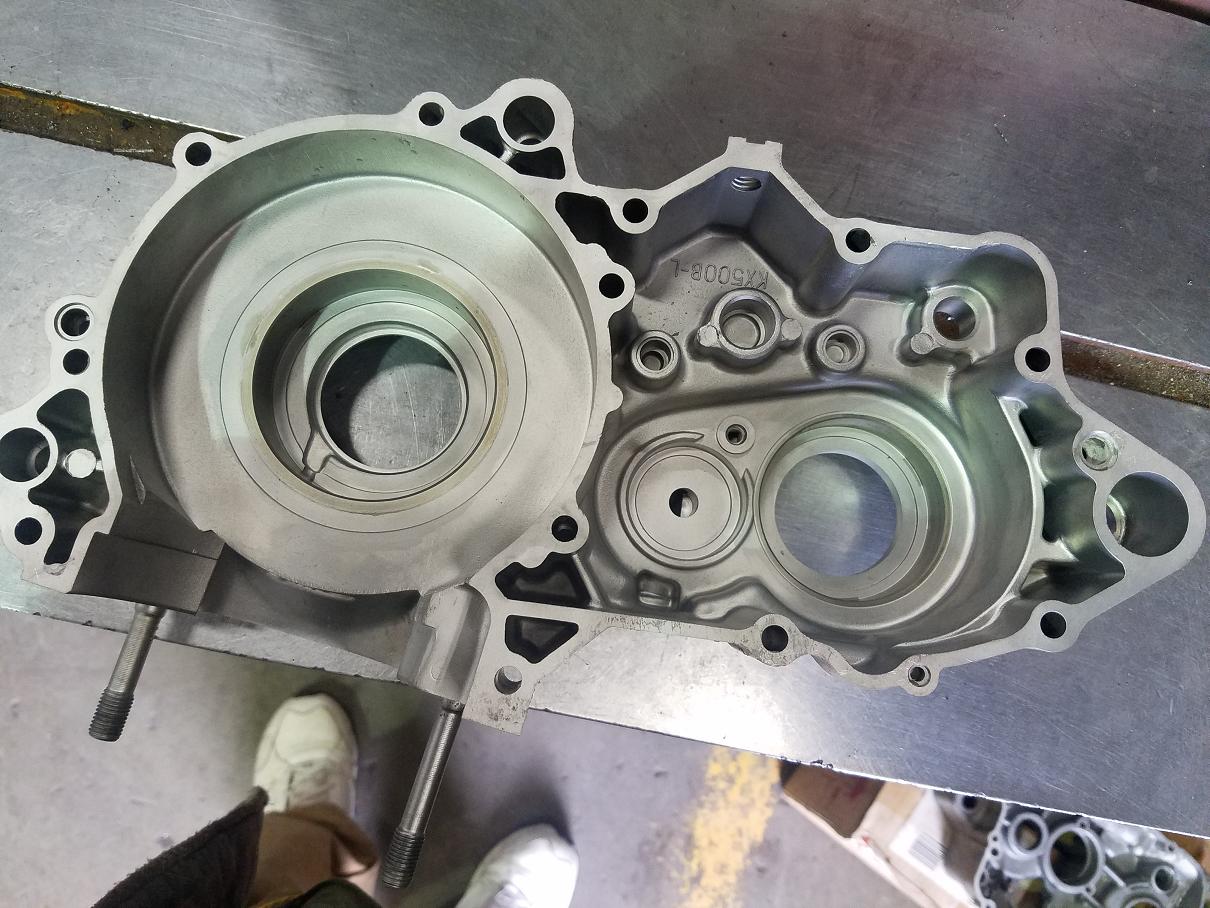

Posted: Wed Oct 05, 2016 8:17 pm
Other side... Before..
KX GURU RACING SEAN COLLIER KX500 180.JPG (209.91 KiB) Viewed 11275 times
After...
KX GURU RACING SEAN COLLIER KX500 181.JPG (211.61 KiB) Viewed 11275 times

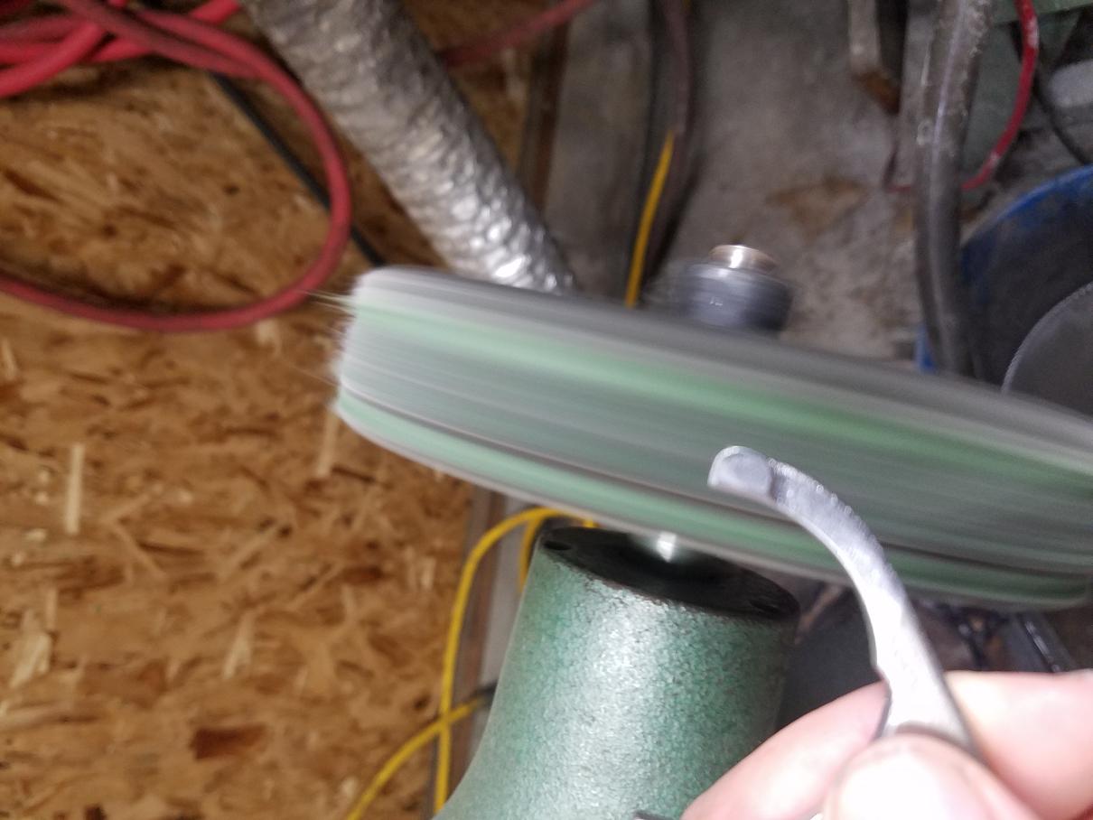

Posted: Thu Oct 06, 2016 12:02 am
A little time with a buffing wheel and some polishing compound goes a long way..
KX GURU RACING SEAN COLLIER KX500 183.JPG (108.61 KiB) Viewed 11272 times

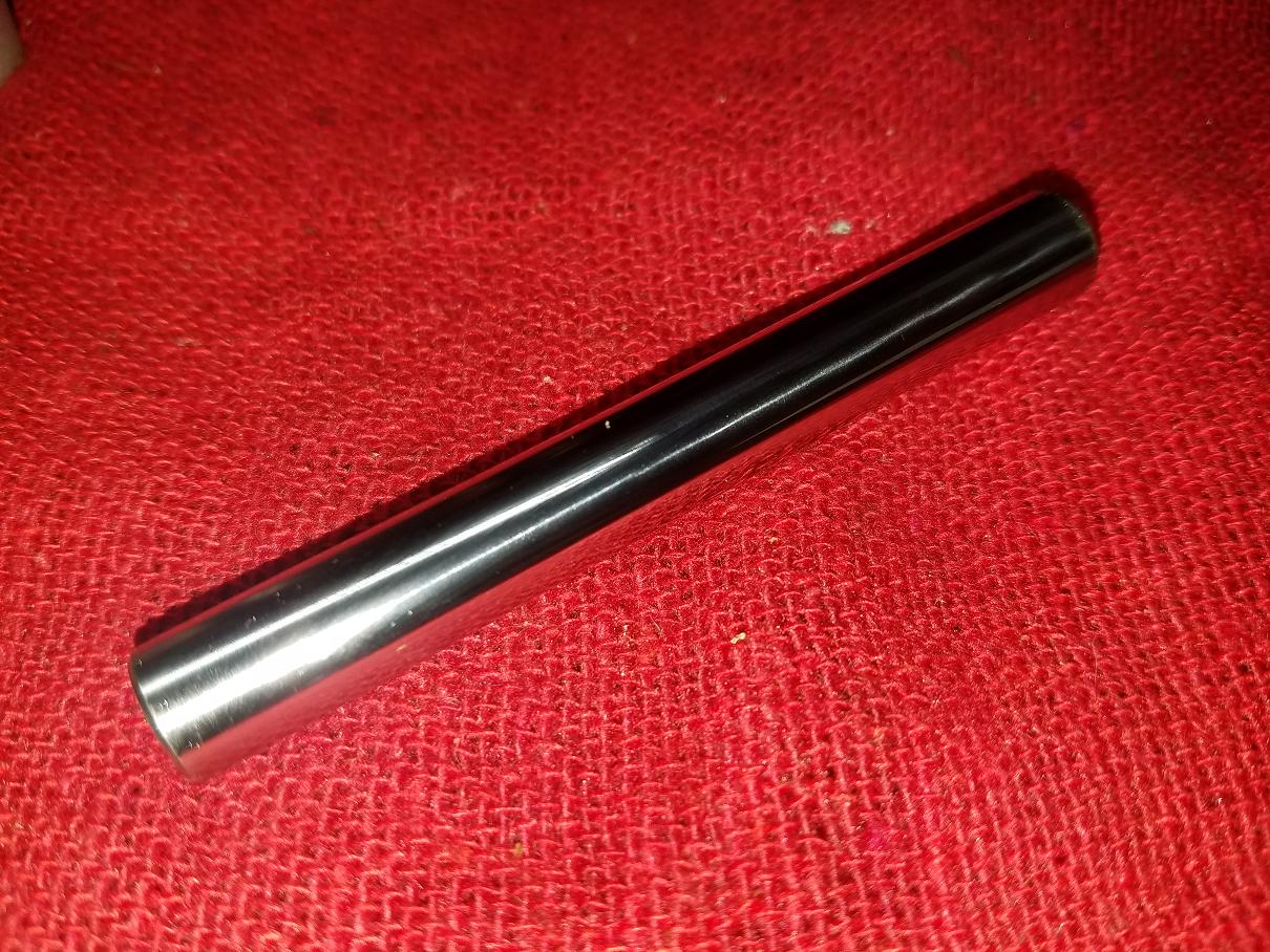

Shift fork shaft... One of many parts being polished to improve shifting..
KX GURU RACING SEAN COLLIER KX500 184.JPG (259.49 KiB) Viewed 11272 times
