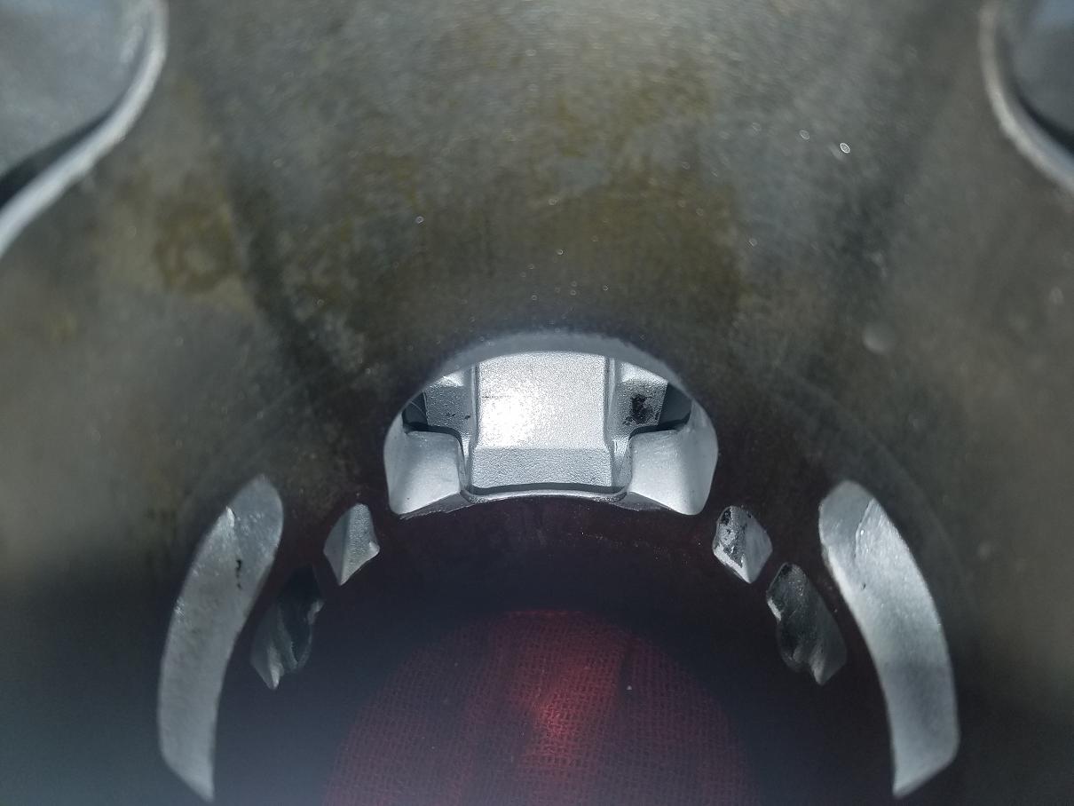

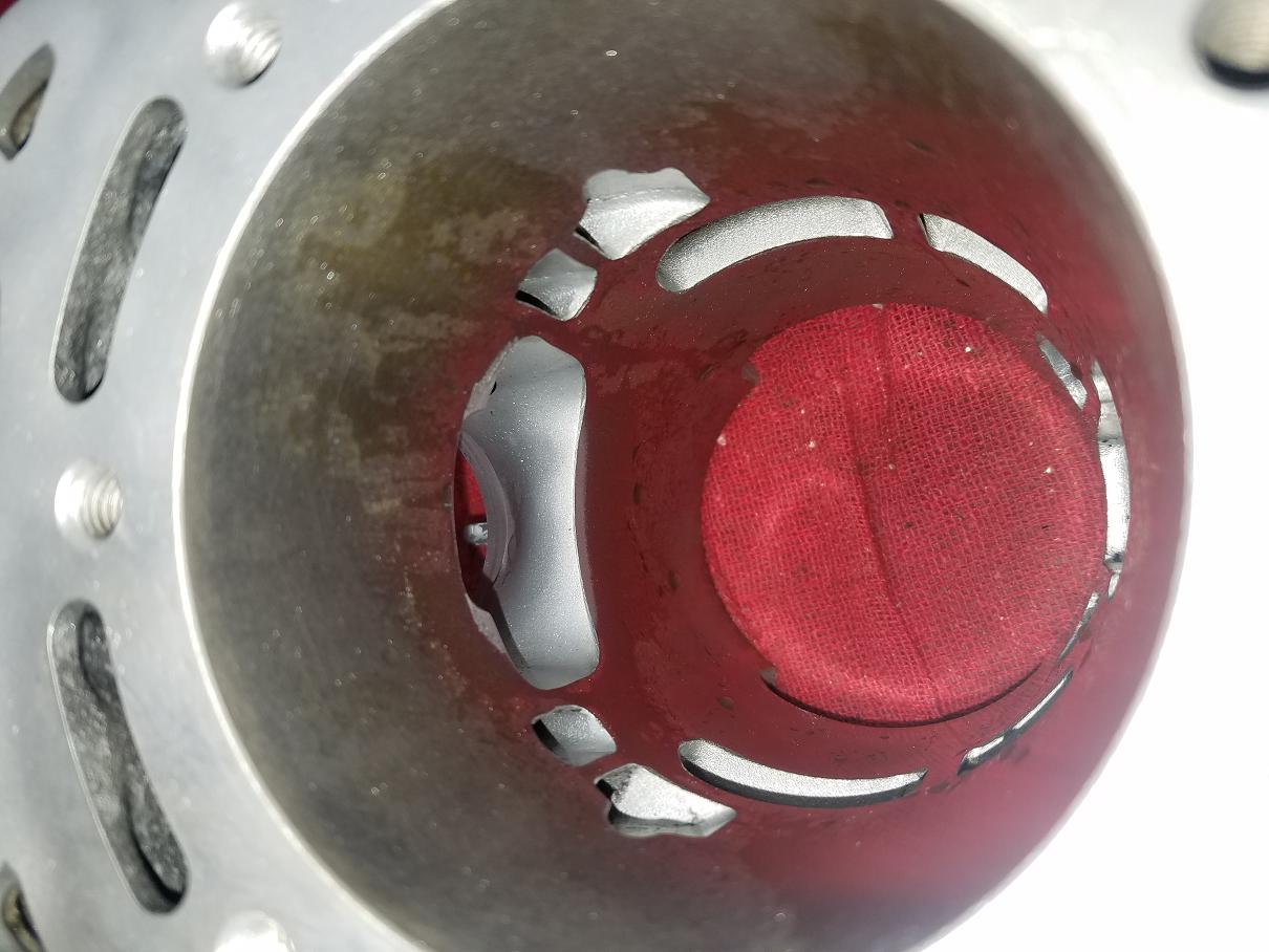

I was doing some more clean up at the bottom of the cylinder and discovered that the plating is wearing through at the bottom of the exhaust port.
KX GURU RACING SEAN COLLIER KX500 177.JPG (124.62 KiB) Viewed 11286 times
KX GURU RACING SEAN COLLIER KX500 178.JPG (91.68 KiB) Viewed 11286 times

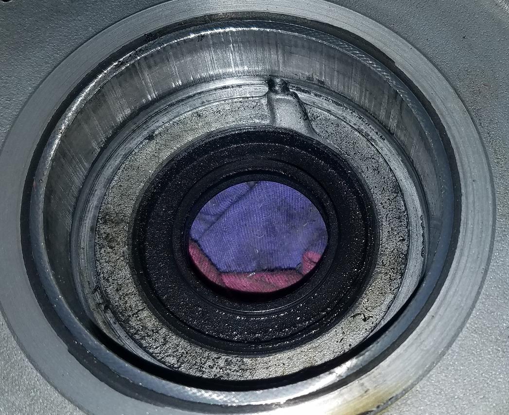

The left main seal was leaking.
I was told that there was some sort of repair done there.
Sure enough, the main bearing journal was bored out then sleeved.
In practice, this would be an excellent repair.
Unfortunately this one was not carried out correctly.
I believe that it is out of round which may be helping contribute to the intense vibration this motor puts out.
KX GURU RACING SEAN COLLIER KX500 187.JPG (234.04 KiB) Viewed 11283 times

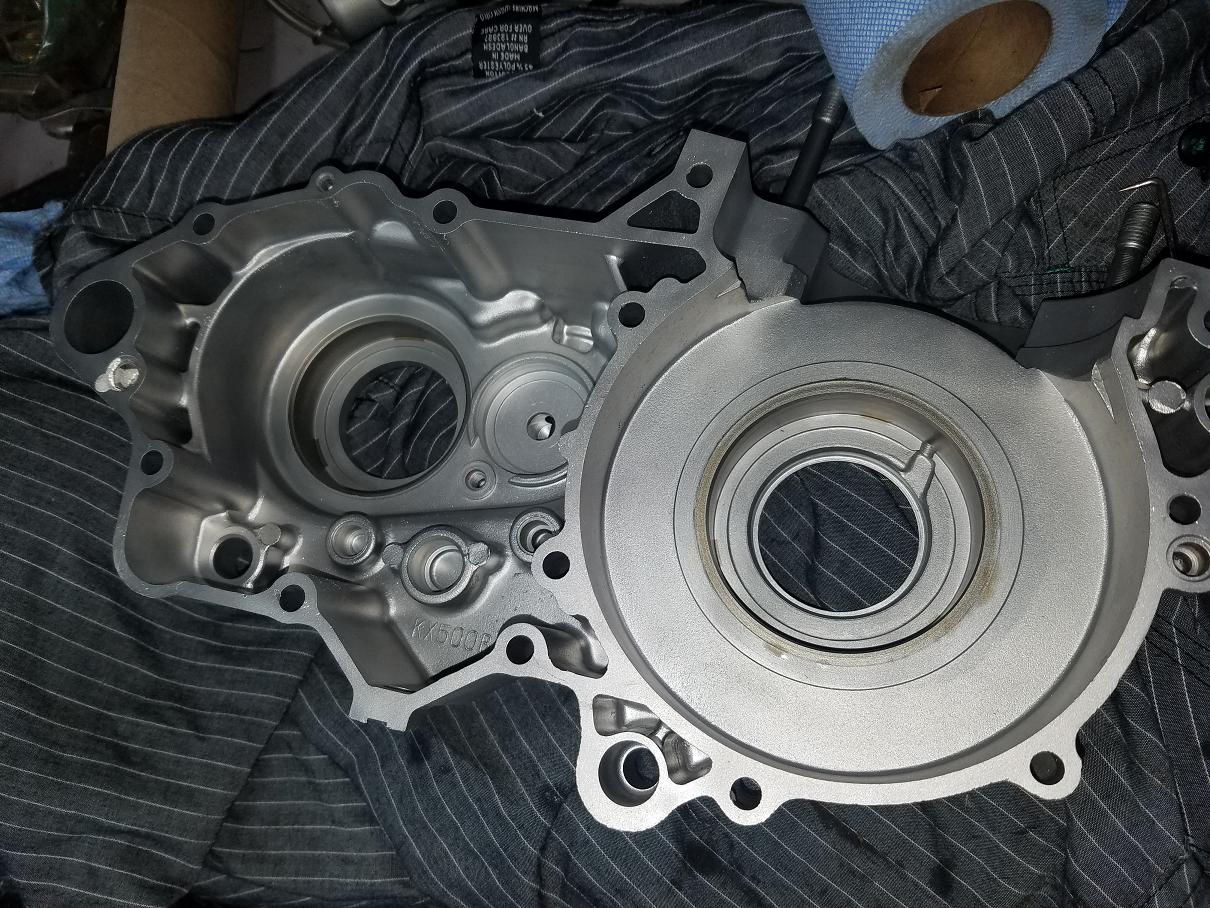

However, I can't justify it so I rounded up this replacement case..
She is a beauty..
KX GURU RACING SEAN COLLIER KX500 180.JPG (256.41 KiB) Viewed 11283 times
KX GURU RACING SEAN COLLIER KX500 181.JPG (241.1 KiB) Viewed 11283 times
The fact is I was going to save this case for something special so it's going to a good cause ;)

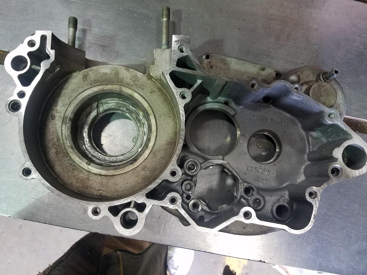

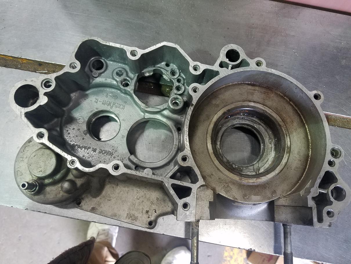

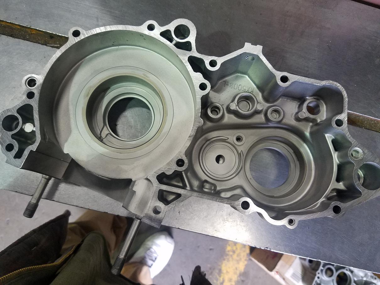

Ok, took the cases down to a local machine shop and ran the cases on a surface machine..
Before..
KX GURU RACING SEAN COLLIER KX500 178.JPG (184.9 KiB) Viewed 11273 times
After..
KX GURU RACING SEAN COLLIER KX500 179.JPG (176.6 KiB) Viewed 11273 times
Other side... Before..
KX GURU RACING SEAN COLLIER KX500 180.JPG (209.91 KiB) Viewed 11272 times
After...
KX GURU RACING SEAN COLLIER KX500 181.JPG (211.61 KiB) Viewed 11272 times

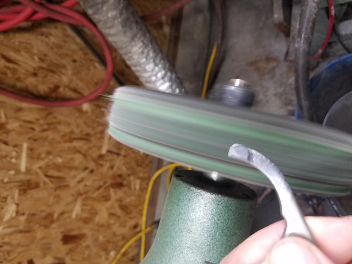

A little time with a buffing wheel and some polishing compound goes a long way..
KX GURU RACING SEAN COLLIER KX500 183.JPG (108.61 KiB) Viewed 11269 times
Shift fork shaft... One of many parts being polished to improve shifting..
KX GURU RACING SEAN COLLIER KX500 184.JPG (259.49 KiB) Viewed 11269 times
