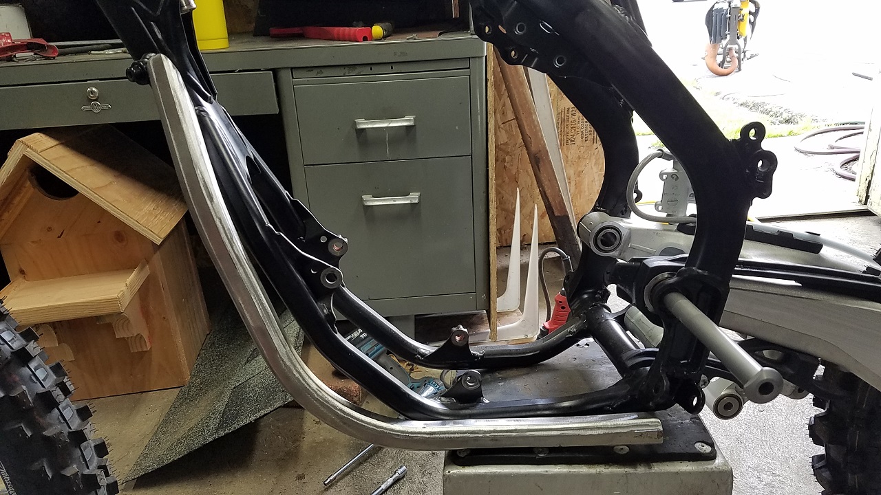

Jason has the 07 frame rails cleaned up and ready to start fitting on the 16 frame..

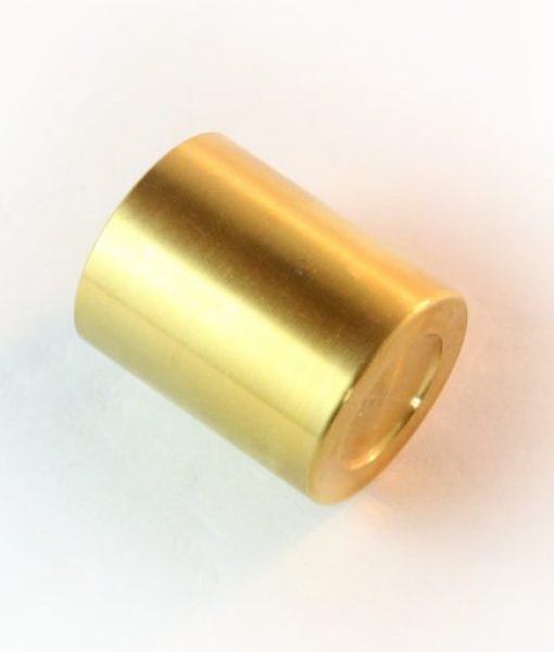

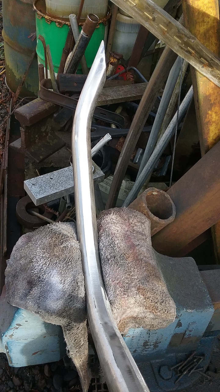

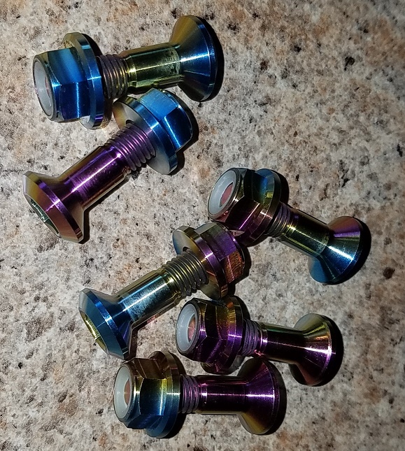

Just some small bits and pieces.. But when your trying to shave weight titanium has a lot of advantages..
Remember what this use to look like...

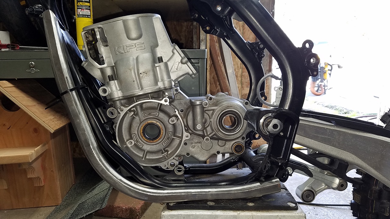

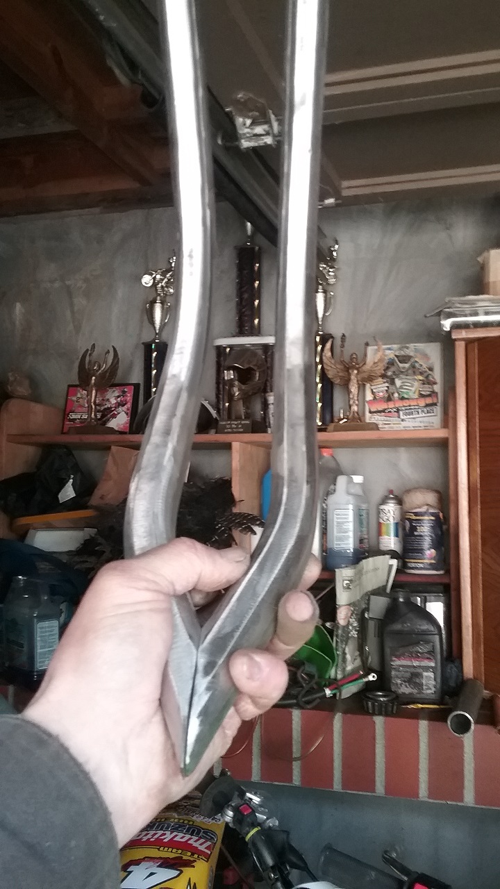

This pic shows why we decided to cut up a 450 frame in order to use the frame rails
KX GURU RACING 2016 KTM 250SXF KX500 CONVERSION 112.jpg (365.68 KiB) Viewed 10696 times

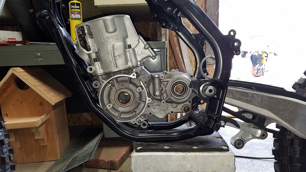

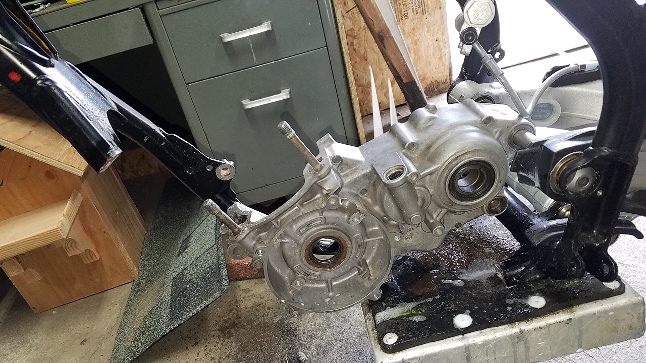

With a KX500 case drilled out to fit the KTM swingarm pin and my mock up cylinder we are checking the clearance and engine angle
KX GURU RACING 2016 KTM 250SXF KX500 CONVERSION 113.jpg (393.98 KiB) Viewed 10695 times

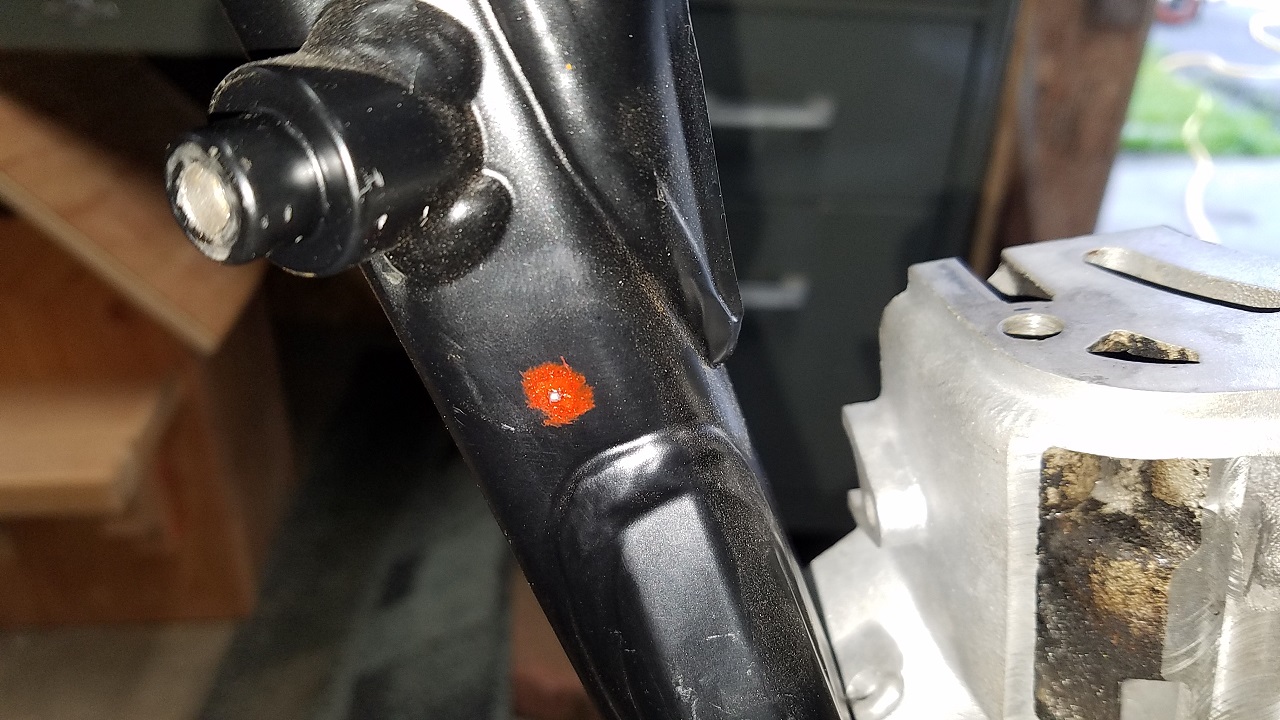

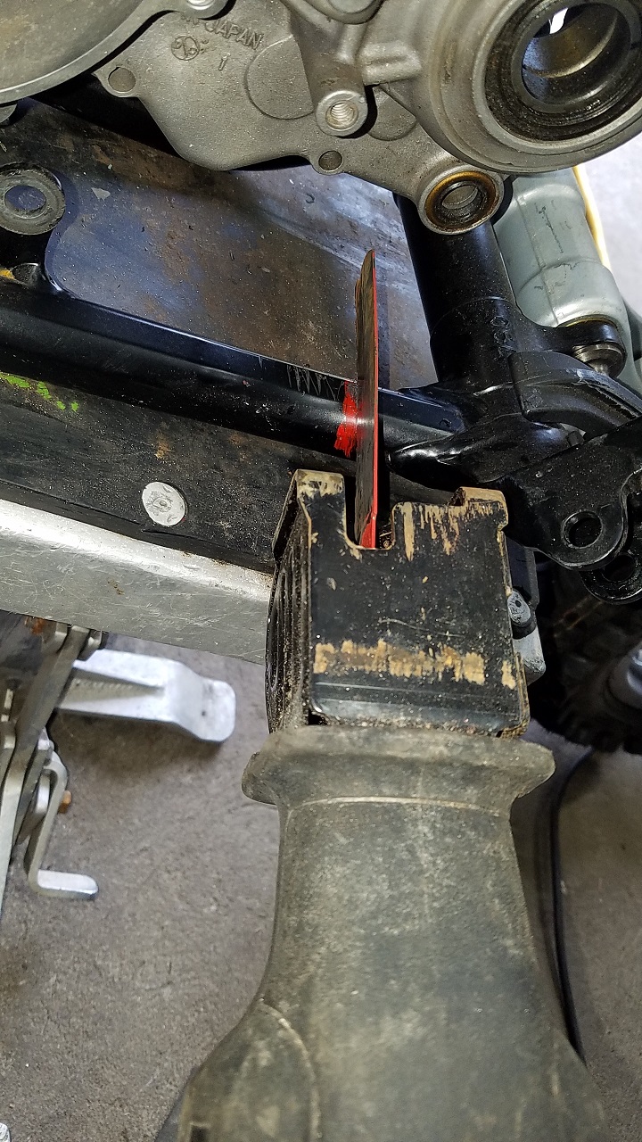

Before I cut the basket rails I'm making some control points on both sides of the frame
KX GURU RACING 2016 KTM 250SXF KX500 CONVERSION 115.jpg (310.88 KiB) Viewed 10693 times
I placed the control points at approximately the same location on both sides of the frame and measured from there to the centerline of the swingarm pivot pin..
18" on the left
17 15/16" on the right
Then I rough marked the frame rails...
KX GURU RACING 2016 KTM 250SXF KX500 CONVERSION 116.jpg (447.58 KiB) Viewed 10693 times

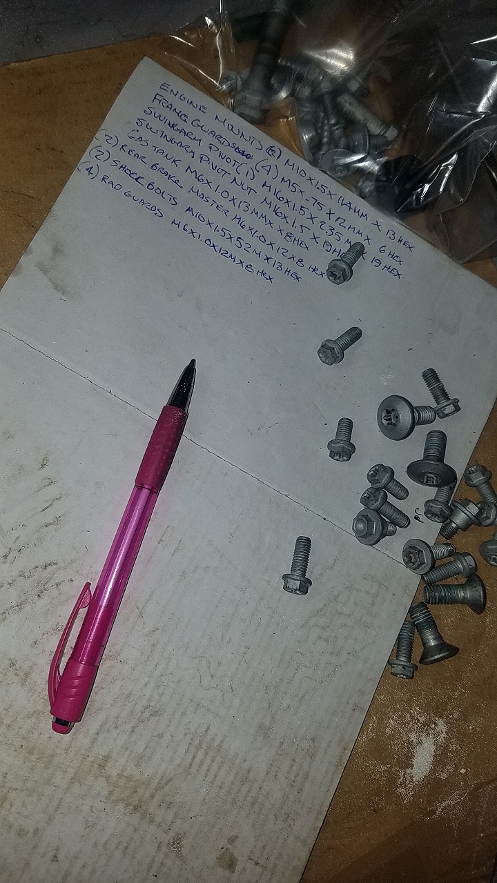

Meanwhile I'm recording all the bolt sizes for replacement titanium...

I wasn't able to get anything done on the bike the last few days other then wrapping all the plastics in bubble wrap and putting all the parts in storage.
I also managed to measure and order a bunch of titanium replacement fasteners..
I'm trying to keep the weight down for a few add-ons I'm working on :shock:
I ordered more titanium from Titan Classics..

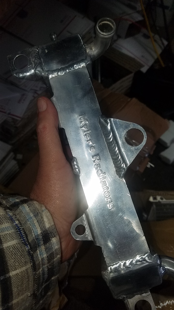

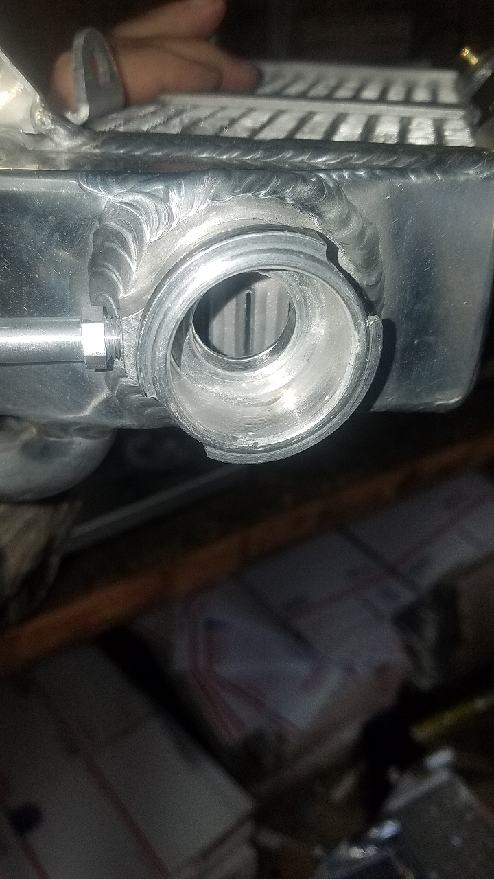

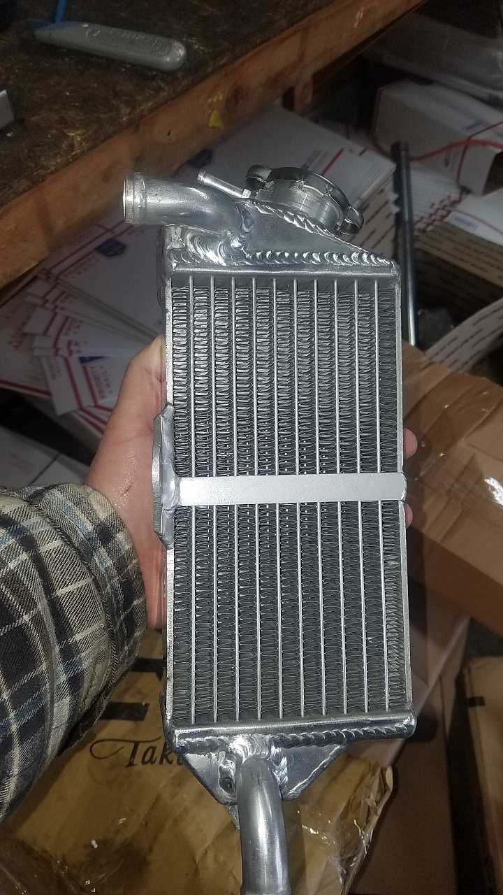

And while I was there I picked up one of these for the old girl
Hmmm... These show promise..
