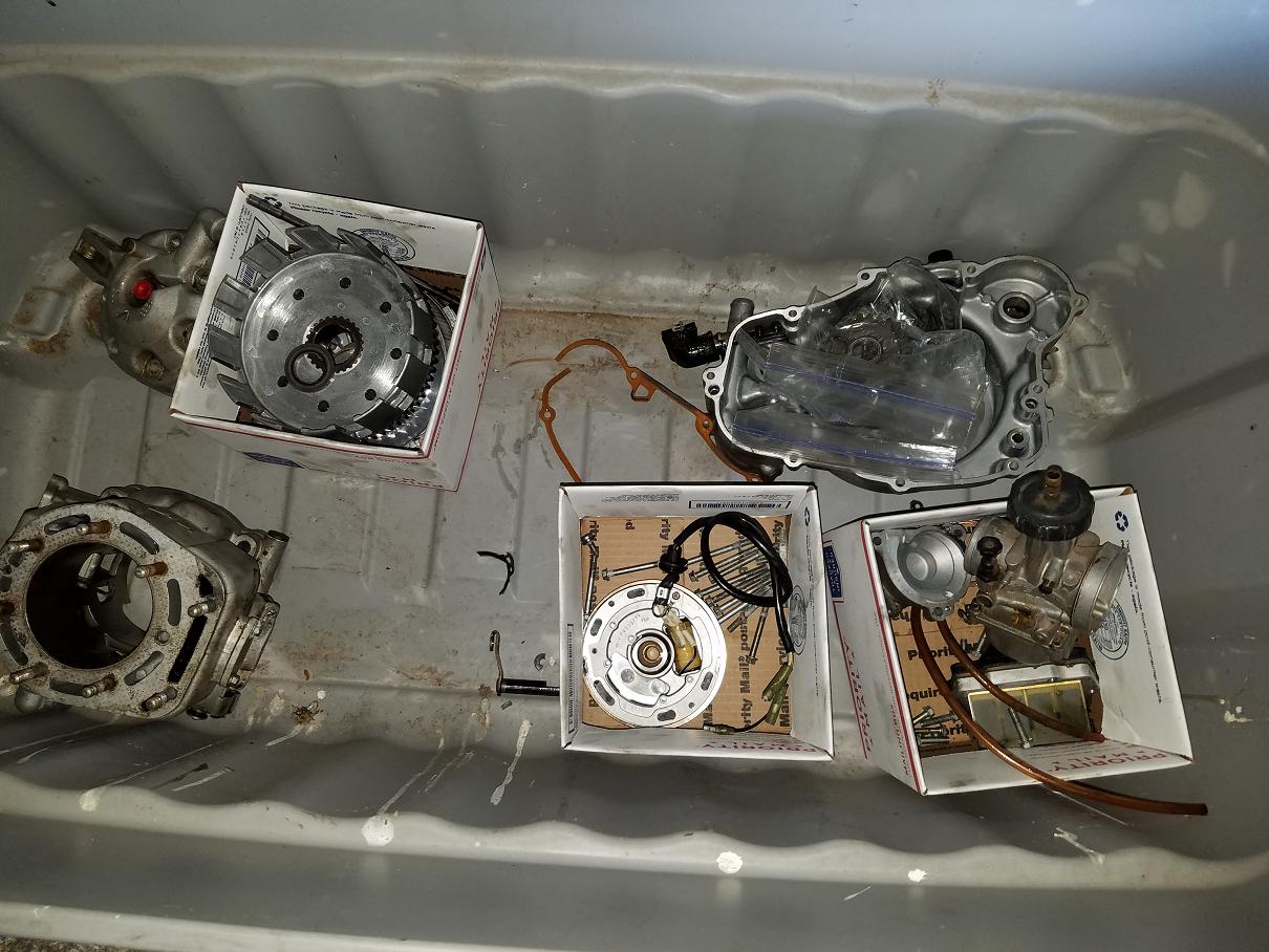

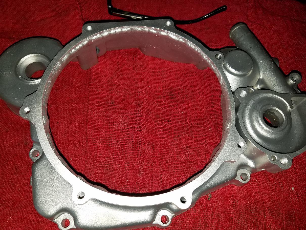

Ok, the plating was actually pretty good...
We could slap in a stock piston and ring set and run it....
But that isn't gonna happen :lol:
Flywheel weight...
Hmmmm... Maybe.... Maybe not ...
KX GURU RACING SEAN COLLIER KX500 114.JPG (178.25 KiB) Viewed 12966 times
She is coming apart nicely and so far I really like what I see..
KX GURU RACING SEAN COLLIER KX500 115.JPG (174.79 KiB) Viewed 12966 times
Nothing cracked, broken or overly worn...

And of course... It wouldn't be right to do this level of build without a 2 piece clutch cover..
KX GURU RACING SEAN COLLIER KX500 116.JPG (281.33 KiB) Viewed 12965 times

My initial thoughts is the engine is in really good shape.
The only negative is the crank to bearing fit was a little looser then I would like but I have not measured it yet.
No biggie... I'm going to use that crank anyway... :D
I'll try to get it torn all the way down later today so I can really check it thoroughly...
Re: Sean Colliers KX500 build
Ok... it's all apart except for the exhaust valves and the gears on the trans shafts.
That will happen later today..
So far so good..

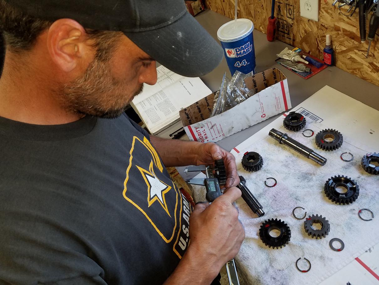

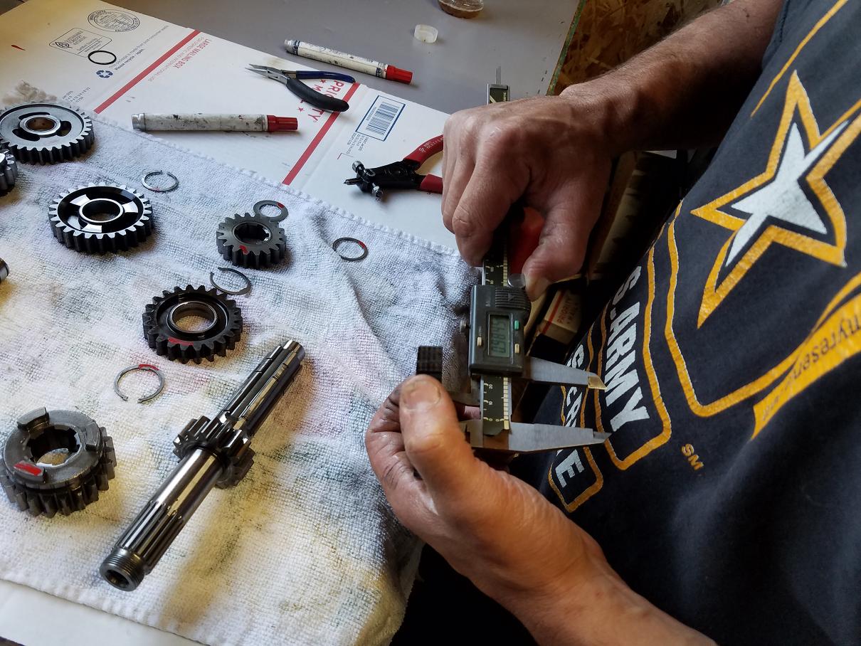

Any KX500 build should keep one thing in mind... Build that bottom end like you want it to last forever... cause it won't :lol:
But, there are several things you can do to ensure that it last's a good long time...

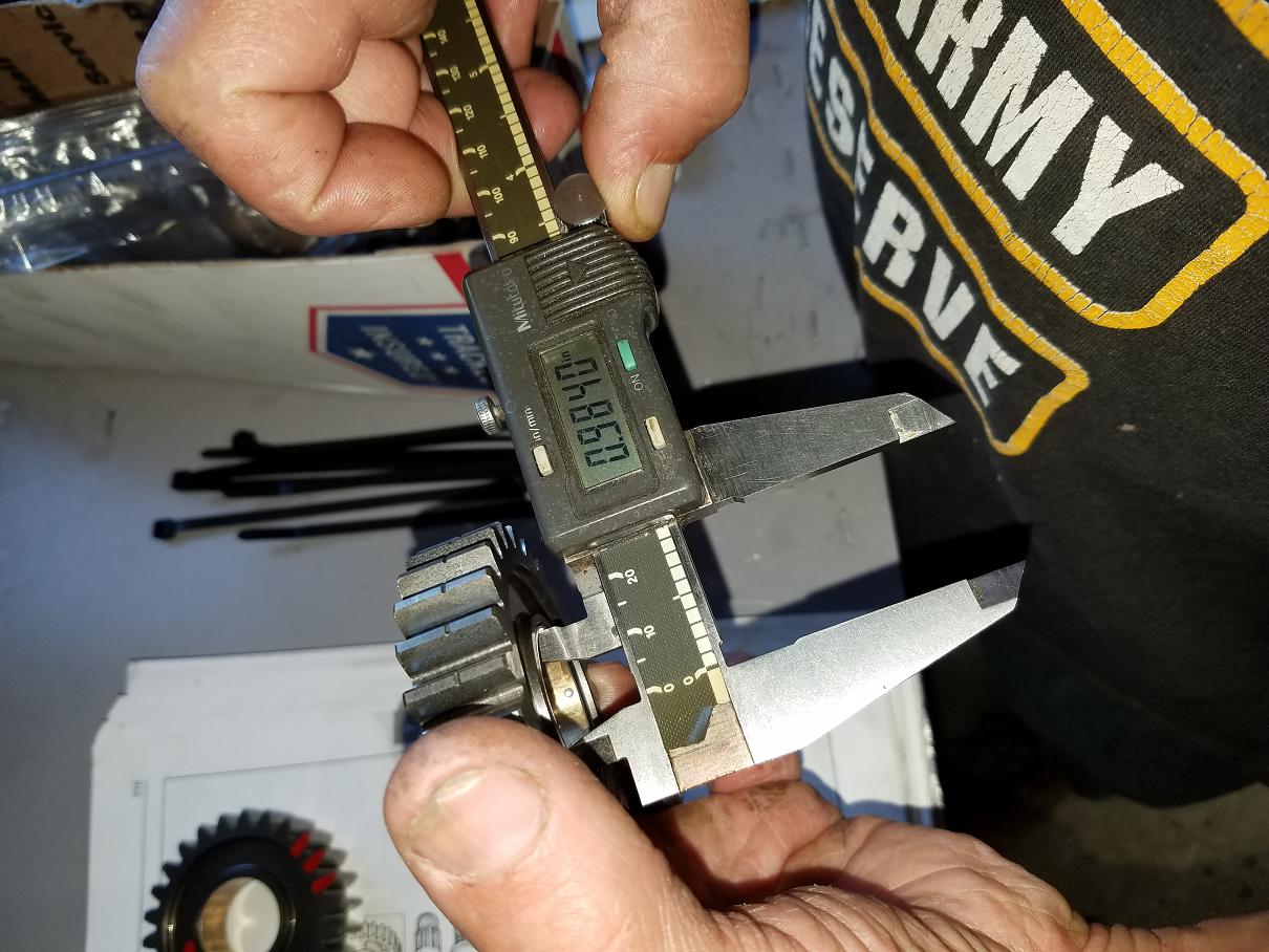

Number one.... INSPECT EVERYTHING!!!!
Every gear should be carefully measured and inspected..
KX GURU RACING SEAN COLLIER KX500 108.JPG (216.49 KiB) Viewed 12943 times
KX GURU RACING SEAN COLLIER KX500 109.JPG (209.14 KiB) Viewed 12943 times

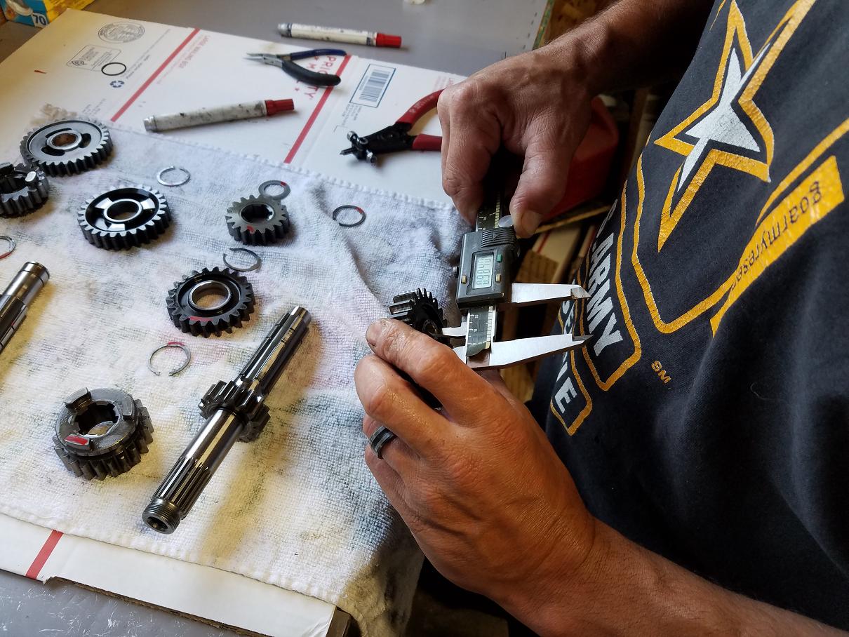

KX GURU RACING SEAN COLLIER KX500 110.JPG (207.91 KiB) Viewed 12942 times
KX GURU RACING SEAN COLLIER KX500 111.JPG (217.02 KiB) Viewed 12942 times
KX GURU RACING SEAN COLLIER KX500 112.JPG (212.31 KiB) Viewed 12941 times
KX GURU RACING SEAN COLLIER KX500 113.JPG (225.21 KiB) Viewed 12941 times

A steady hand, a keen eye, and attention to detail, makes Jason Tanner (JT Engine Works) crucial to a project of this magnitude.
KX GURU RACING SEAN COLLIER KX500 114.JPG (202.48 KiB) Viewed 12940 times
KX GURU RACING SEAN COLLIER KX500 115.JPG (142.95 KiB) Viewed 12940 times
KX GURU RACING SEAN COLLIER KX500 116.JPG (175.91 KiB) Viewed 12938 times
Even if you think you know the manual forwards and backwards... keep it handy... You never know when it can save you from a glitch in the matrix :?
KX GURU RACING SEAN COLLIER KX500 117.JPG (137.69 KiB) Viewed 12938 times
This is probably the nicest used trans from a KX500 that I have seen in the recent past but leave it to Jason to find some gears that just aren't up to his standards.

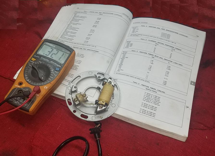

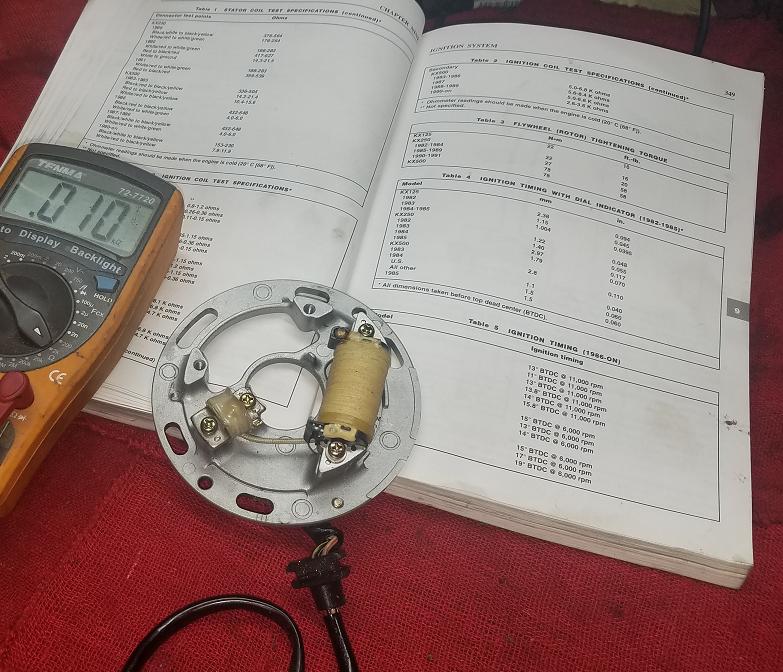

Today Jason tested the Stator for resistance...
And when it comes to Ohms specs... Always believe the book :-)
The last thing we need is to have electrical problems on this bike... :shock: :o
KX GURU RACING SEAN COLLIER KX500 118.JPG (109 KiB) Viewed 12897 times
KX GURU RACING SEAN COLLIER KX500 119.JPG (101.14 KiB) Viewed 12897 times
