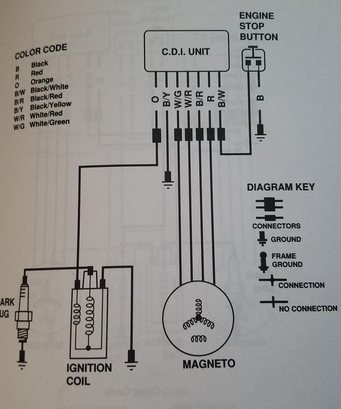

I'll see if I can locate the original wiring diagram for this...
Re: MY 1991 KX250 HAS NO SPARK!
Here you go :D
1991 KAWASAKI KX250 WIRING DIAGRAM.JPG (152.68 KiB) Viewed 16468 times
A 91 has no pure white wire... Hmmm..... More research is required...
A 91 KX125 has a pure white wire...
That is a 91 engine number.
But here is the thing.
Somewhere along the line your CDI or stator was swapped out.
Because it's non standard it will be tough figuring out what is what.
Let me see if I have the wiring diagram for the 91 KX125.
Here is the 1991 KX125 Wiring diagram

Thanks for the diagram still couldn't figure out were that White wire goes can you please tell me if I have wired it up correctly
