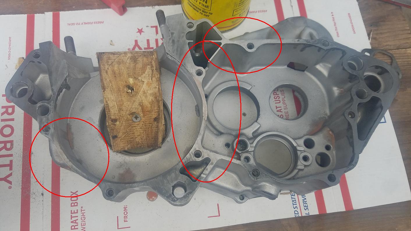

I must love lapping cases... I have gone through a entire can of Timesaver.. :lol:
JT ENGINE WORKS 89 CR500 CART ENGINE BUILD 111.JPG (178.31 KiB) Viewed 15132 times
JT ENGINE WORKS 89 CR500 CART ENGINE BUILD 112.JPG (184.38 KiB) Viewed 15132 times
JT ENGINE WORKS 89 CR500 CART ENGINE BUILD 113.JPG (154.87 KiB) Viewed 15132 times
JT ENGINE WORKS 89 CR500 CART ENGINE BUILD 114.JPG (213.27 KiB) Viewed 15131 times
This is ugly....

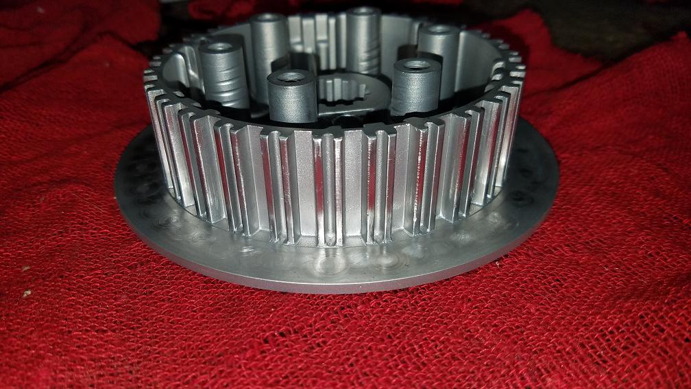

the clutch basket is hashed and there is not enough time to get another...
JT ENGINE WORKS 89 CR500 CART ENGINE BUILD 121.JPG (63.49 KiB) Viewed 15126 times
So, out come the files :shock: I know, I know, that's not all that great but it will get him through a few races..

Worked on the basket a bit more today..
JT ENGINE WORKS 89 CR500 CART ENGINE BUILD 124.JPG (111.8 KiB) Viewed 15120 times
I even cleaned up the inner hub a bit..
JT ENGINE WORKS 89 CR500 CART ENGINE BUILD 125.JPG (123.61 KiB) Viewed 15120 times

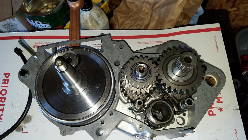

Getting it ready to slap together :D
JT ENGINE WORKS 89 CR500 CART ENGINE BUILD 127.JPG (132.7 KiB) Viewed 15119 times
JT ENGINE WORKS 89 CR500 CART ENGINE BUILD 128.JPG (104.85 KiB) Viewed 15119 times
More progress..
JT ENGINE WORKS 89 CR500 CART ENGINE BUILD 129.JPG (118.83 KiB) Viewed 15098 times
JT ENGINE WORKS 89 CR500 CART ENGINE BUILD 131.JPG (186.56 KiB) Viewed 15098 times
JT ENGINE WORKS 89 CR500 CART ENGINE BUILD 130.JPG (119.31 KiB) Viewed 15098 times
