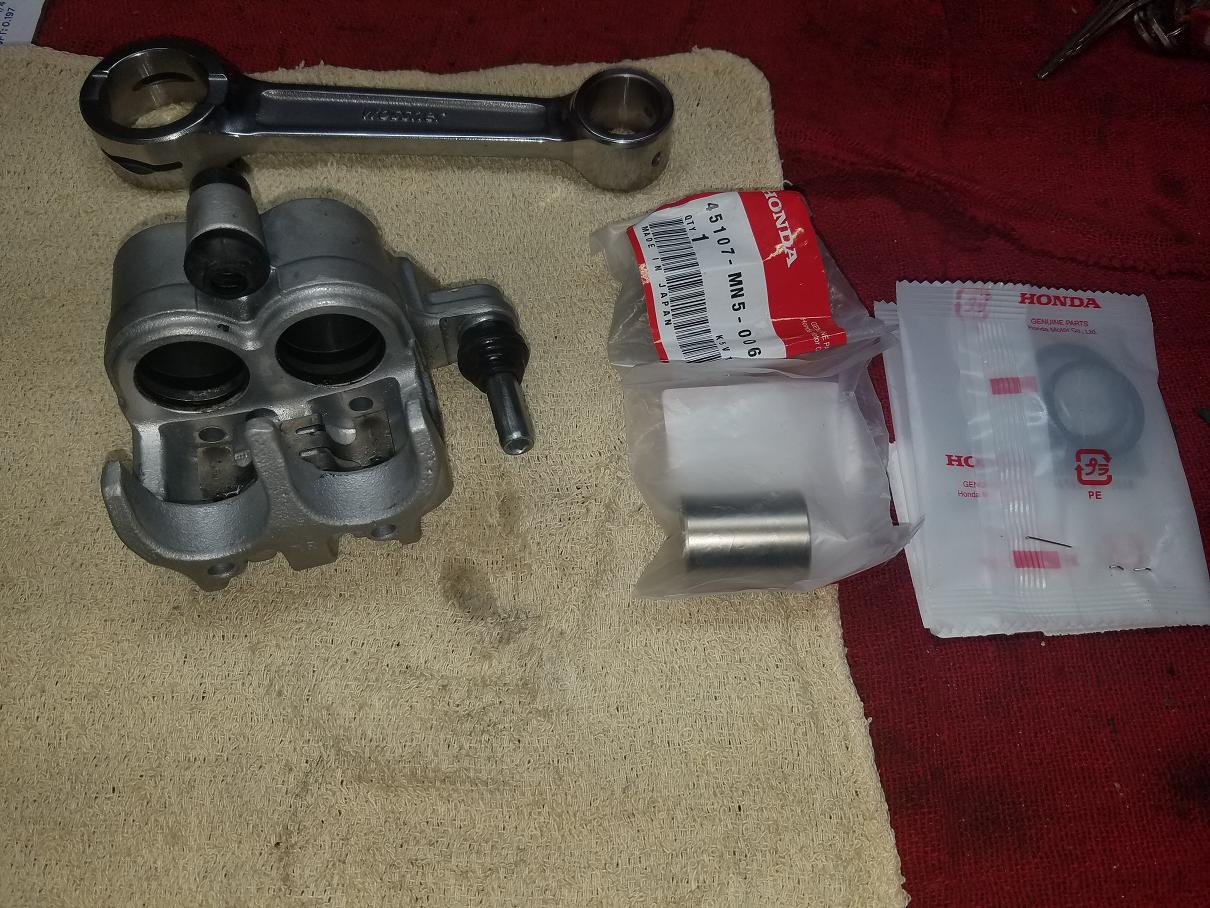

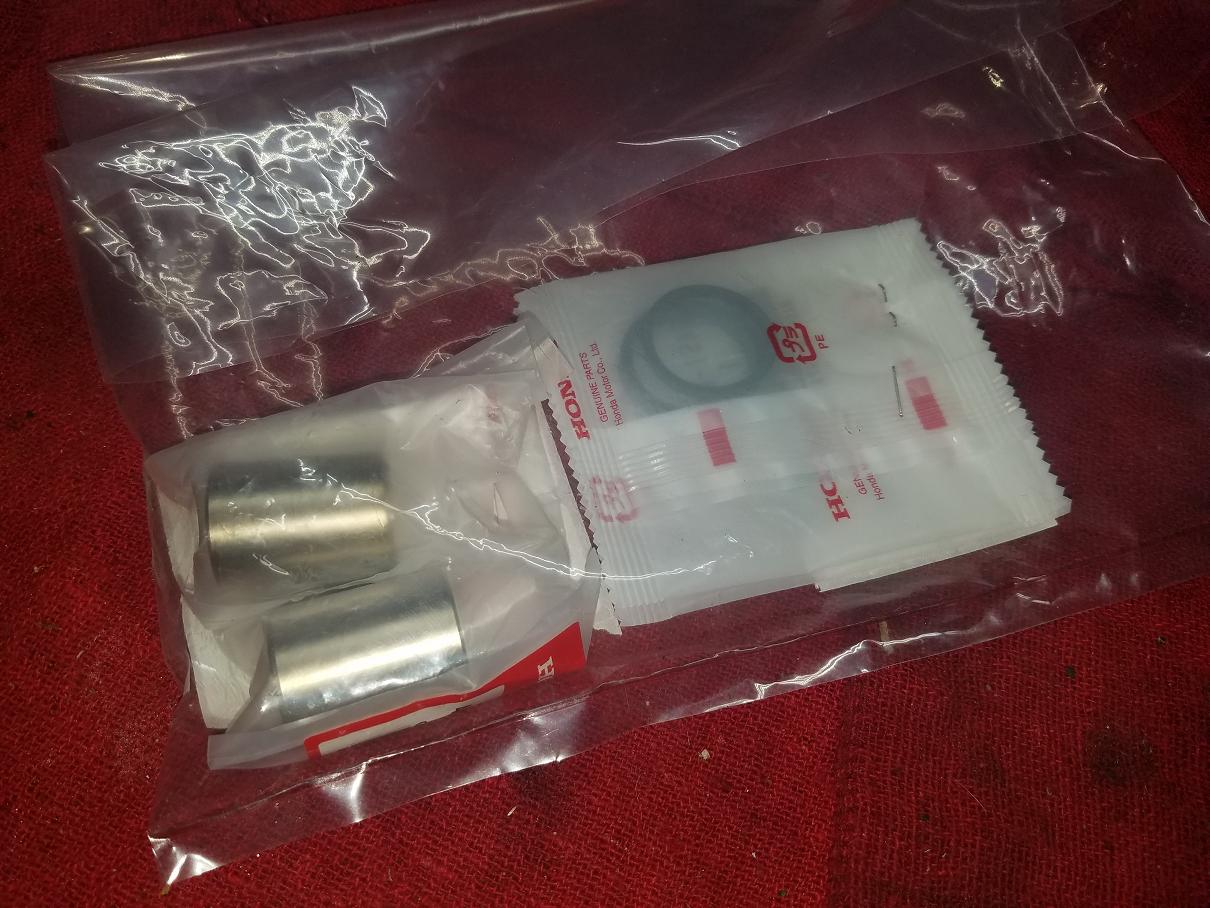

Ok, all the parts are here for rebuilding the rear caliper as well as the SS hose.
KXGURU.COM KX500 REAR BRAKE UPGRADE CBR600 1994 121.JPG (166.2 KiB) Viewed 10726 times
Please ignore the polished KX500 Wossner rod in the background :mrgreen:

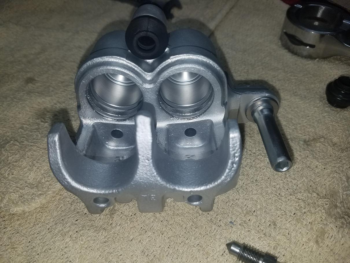

KXGURU.COM KX500 REAR BRAKE UPGRADE CBR600 1994 122.JPG (221.55 KiB) Viewed 10726 times
So I pulled the caliper off my bike and completely disassembled it... Then cleaned it up really nice... Not that it wasn't clean before... But we are trying for a new level :lol:
KXGURU.COM KX500 REAR BRAKE UPGRADE CBR600 1994 123.JPG (194.91 KiB) Viewed 10726 times
Unfortunately I ran out of carb cleaner and can't reassemble until I make sure it is absolutely ridiculous tomorrow.

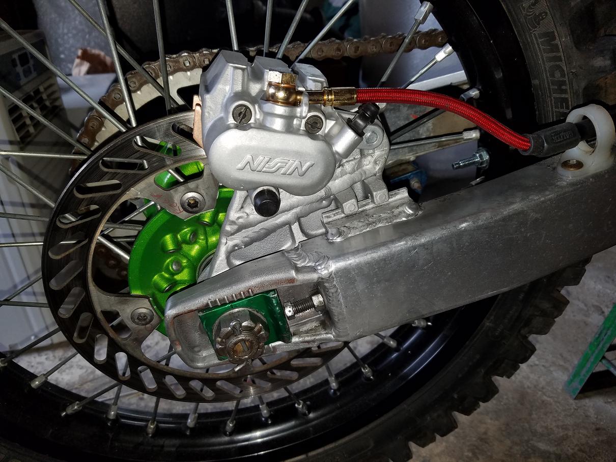

Posted: Sun Jul 10, 2016 2:07 pm
Everything is ready for the final test.... Just waiting on the weather :cry:
KXGURU.COM KX500 REAR BRAKE UPGRADE CBR600 1994 124.JPG (199.57 KiB) Viewed 10716 times
Posted: Thu Jul 14, 2016 2:53 pm
Ok... here is where we are at on the rear brake mod. Yes, it works... But nothing special so I don't recommend doing it as it currently is. However, I have a more powerful rear brake master cylinder I'm working on so all is not lost. Plus.... I'm working on another direction and will post pics as I make some progress...

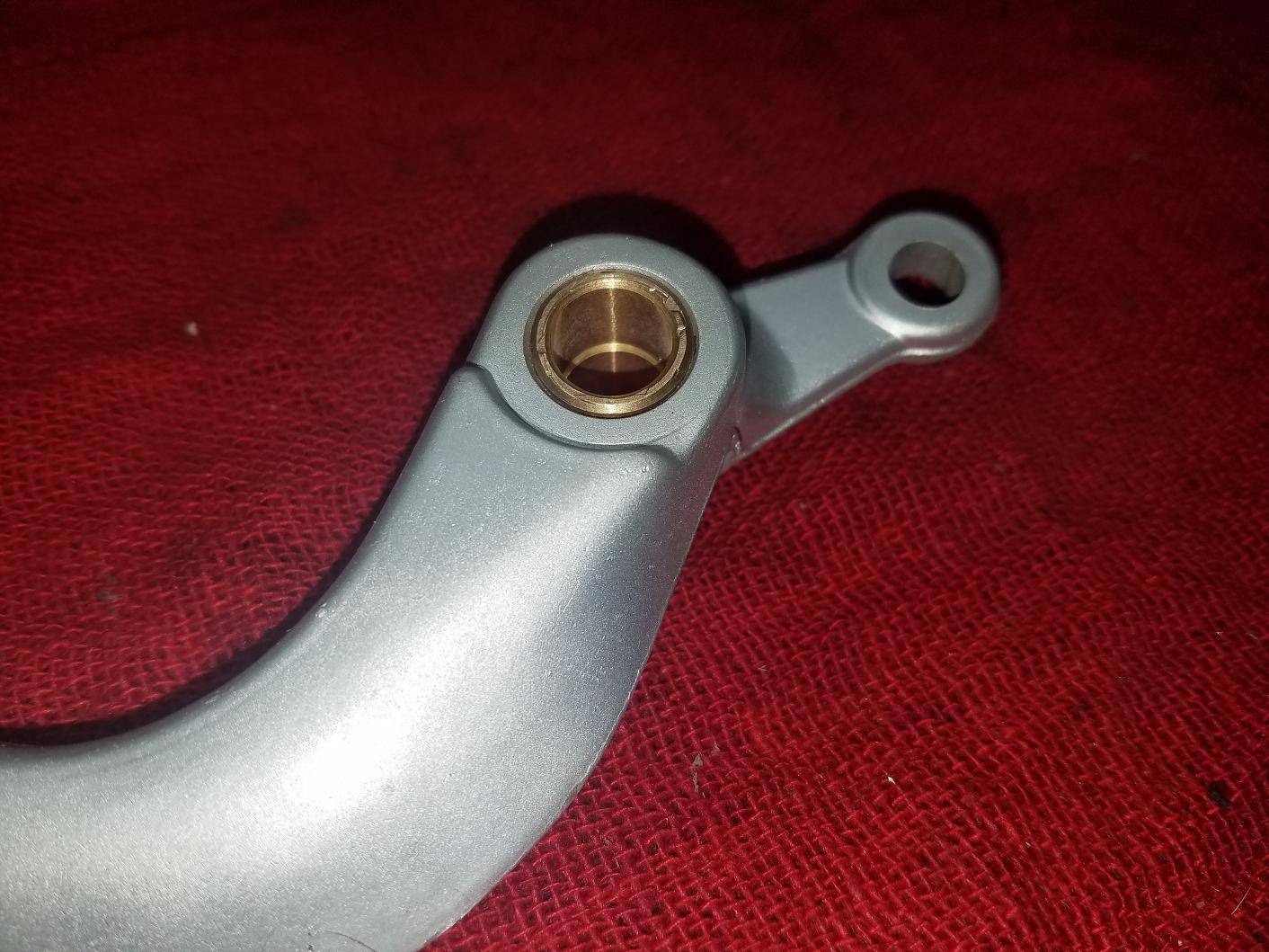

Posted: Fri Jul 15, 2016 12:06 am

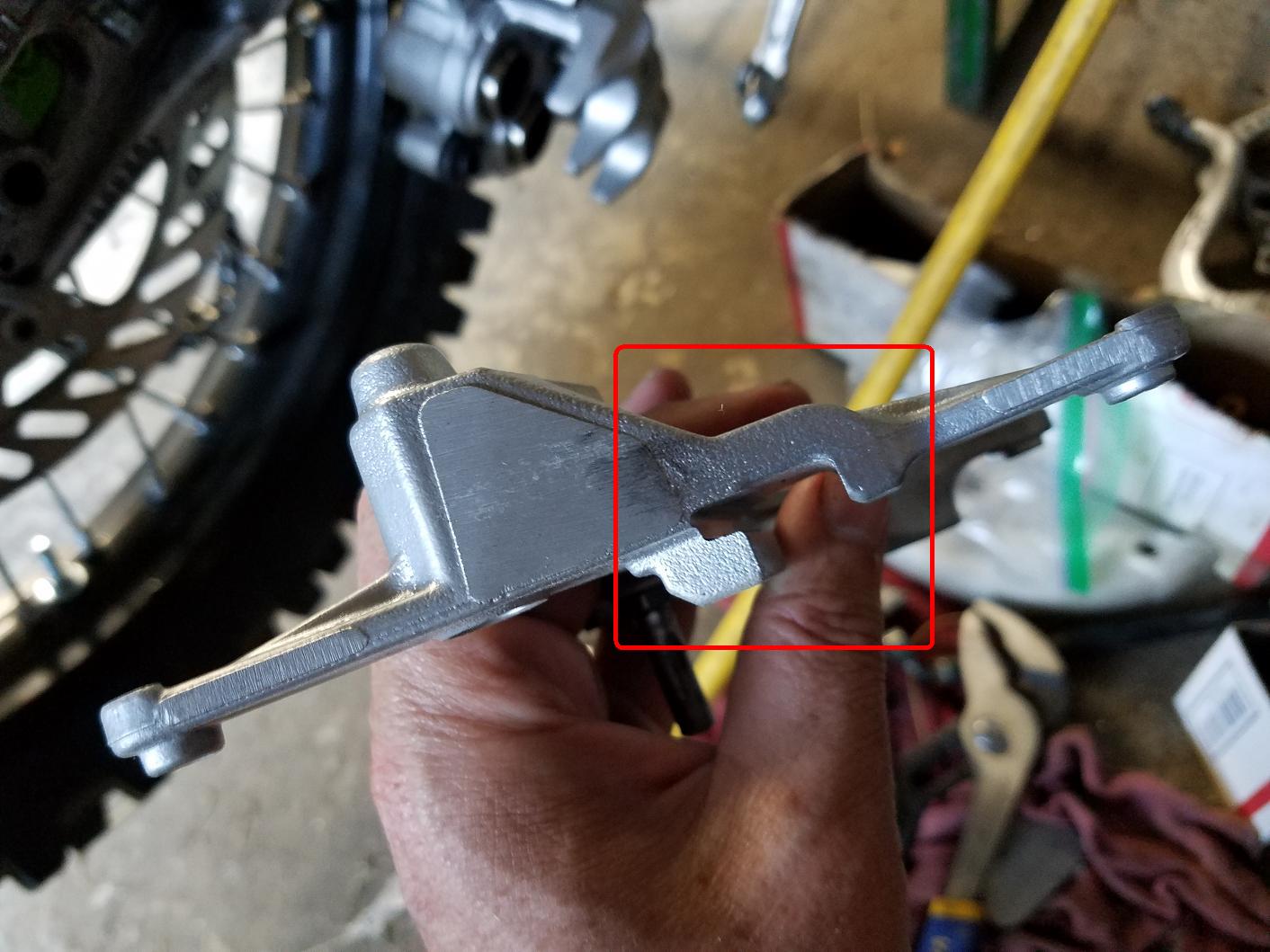

Hmmmm.... This lever is about 1/2" longer then the KX500 lever...
KXGURU.COM KX500 REAR BRAKE MOD 101.JPG (157.86 KiB) Viewed 10701 times
And it looks like all I need is a bushing for the pivot point...
KXGURU.COM KX500 REAR BRAKE MOD 102.JPG (161.37 KiB) Viewed 10701 times

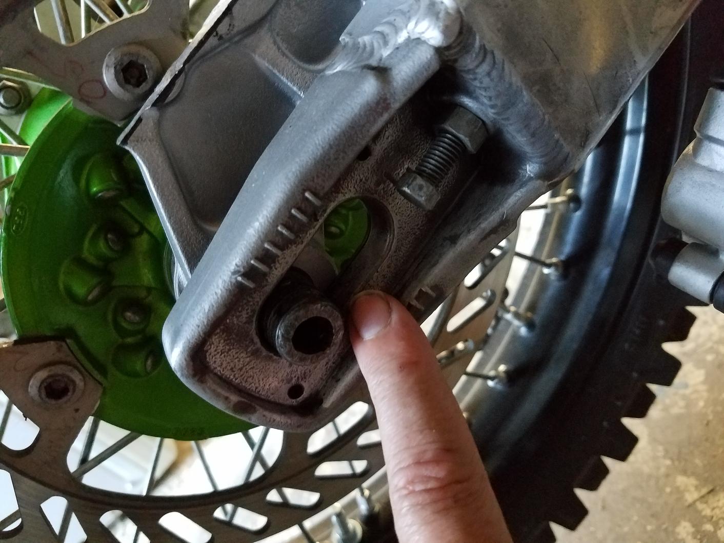

Posted: Wed Jul 27, 2016 1:51 am
And I make a new hanger on the inside of the swing arm to fit this..
KXGURU.COM KX500 REAR BRAKE MOD 105.JPG (171.74 KiB) Viewed 10669 times
So the bottom line is, everything in the back except the swingarm will be KX450F...
The entire brake system including the brake lever will be KX450F.
SS brake hose, after market Brake rotor, and Motul 5.1 :geek:

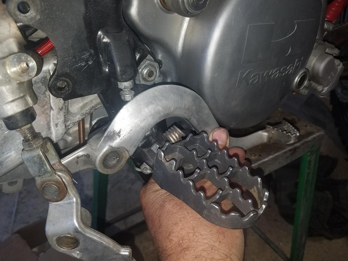

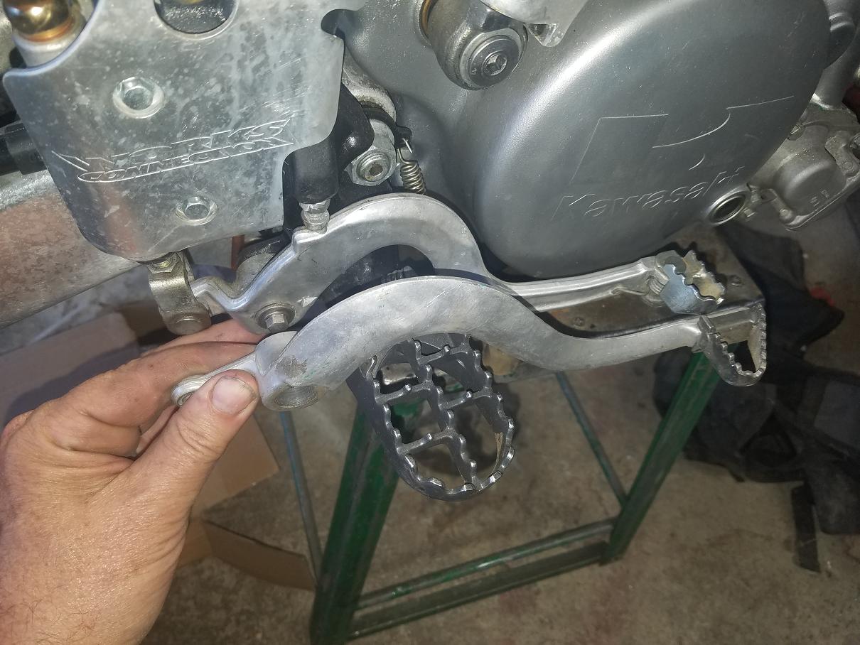

Back to the rear brake lever...
KXGURU.COM KX500 REAR BRAKE MOD 106.JPG (409.93 KiB) Viewed 10636 times
KXGURU.COM KX500 REAR BRAKE MOD 107.JPG (203.02 KiB) Viewed 10636 times
Ready to test fit
