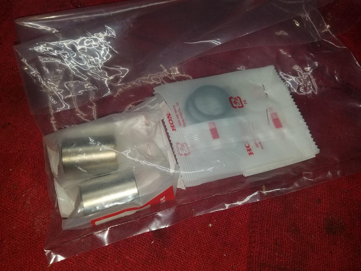

Ok, all the parts are here for rebuilding the rear caliper as well as the SS hose.
KXGURU.COM KX500 REAR BRAKE UPGRADE CBR600 1994 121.JPG (166.2 KiB) Viewed 10723 times
Please ignore the polished KX500 Wossner rod in the background :mrgreen:

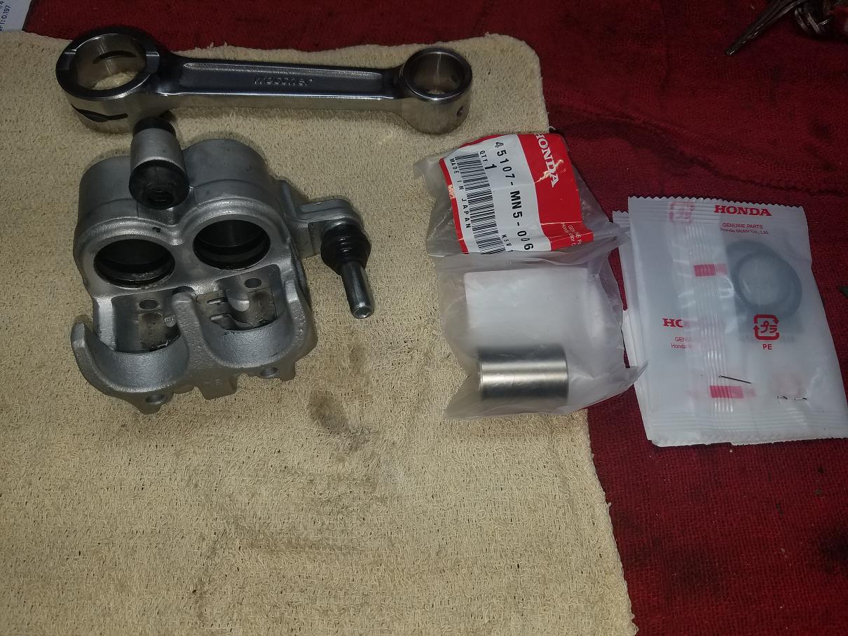

KXGURU.COM KX500 REAR BRAKE UPGRADE CBR600 1994 122.JPG (221.55 KiB) Viewed 10723 times

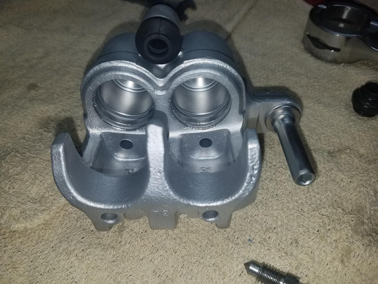

So I pulled the caliper off my bike and completely disassembled it... Then cleaned it up really nice... Not that it wasn't clean before... But we are trying for a new level :lol:
KXGURU.COM KX500 REAR BRAKE UPGRADE CBR600 1994 123.JPG (194.91 KiB) Viewed 10723 times
Unfortunately I ran out of carb cleaner and can't reassemble until I make sure it is absolutely ridiculous tomorrow.

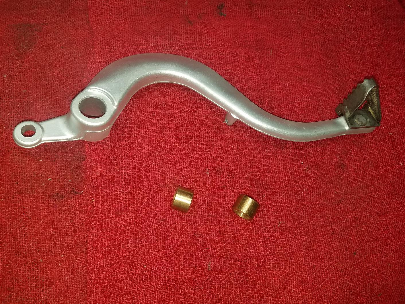

Hmmmm.... This lever is about 1/2" longer then the KX500 lever...
KXGURU.COM KX500 REAR BRAKE MOD 101.JPG (157.86 KiB) Viewed 10698 times

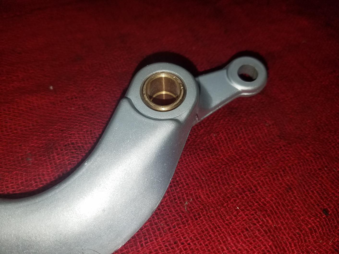

And it looks like all I need is a bushing for the pivot point...
KXGURU.COM KX500 REAR BRAKE MOD 102.JPG (161.37 KiB) Viewed 10698 times

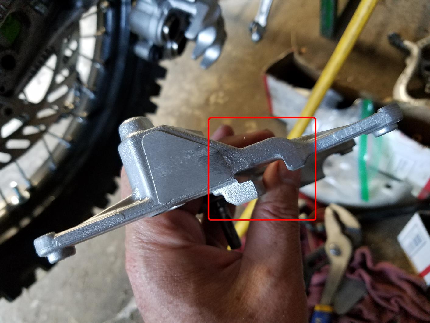

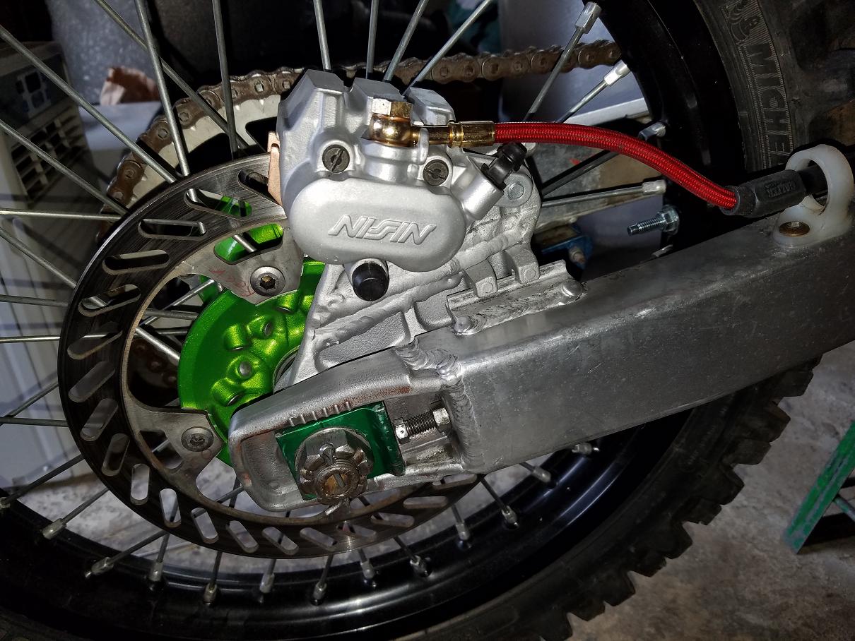

Ok... So here is where I am headed...
This gets removed and cleaned up like it never existed...
KXGURU.COM KX500 REAR BRAKE MOD 103.JPG (211.32 KiB) Viewed 10668 times
This goes from 20mm to 25mm...
KXGURU.COM KX500 REAR BRAKE MOD 104.JPG (196.45 KiB) Viewed 10667 times

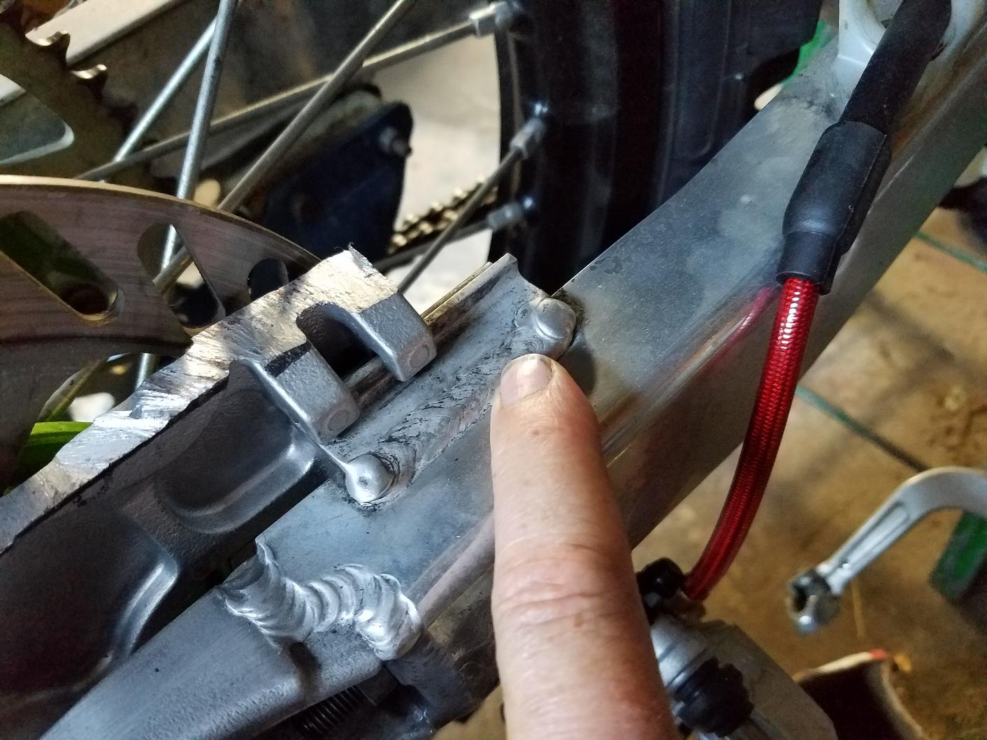

And I make a new hanger on the inside of the swing arm to fit this..
KXGURU.COM KX500 REAR BRAKE MOD 105.JPG (171.74 KiB) Viewed 10666 times
So the bottom line is, everything in the back except the swingarm will be KX450F...
The entire brake system including the brake lever will be KX450F.
SS brake hose, after market Brake rotor, and Motul 5.1 :geek:

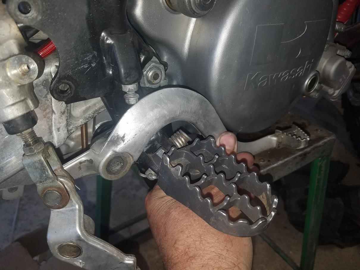

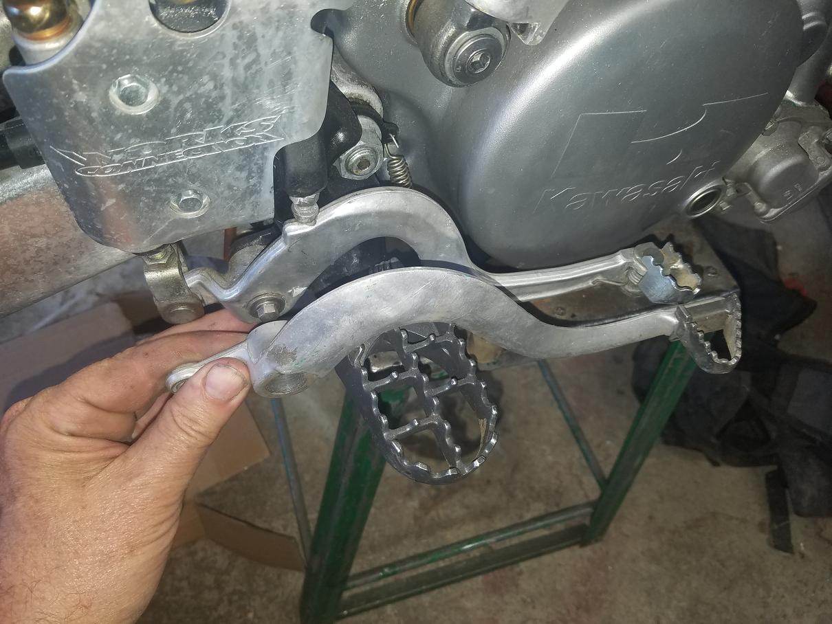

Back to the rear brake lever...
KXGURU.COM KX500 REAR BRAKE MOD 106.JPG (409.93 KiB) Viewed 10633 times
KXGURU.COM KX500 REAR BRAKE MOD 107.JPG (203.02 KiB) Viewed 10633 times
Ready to test fit
