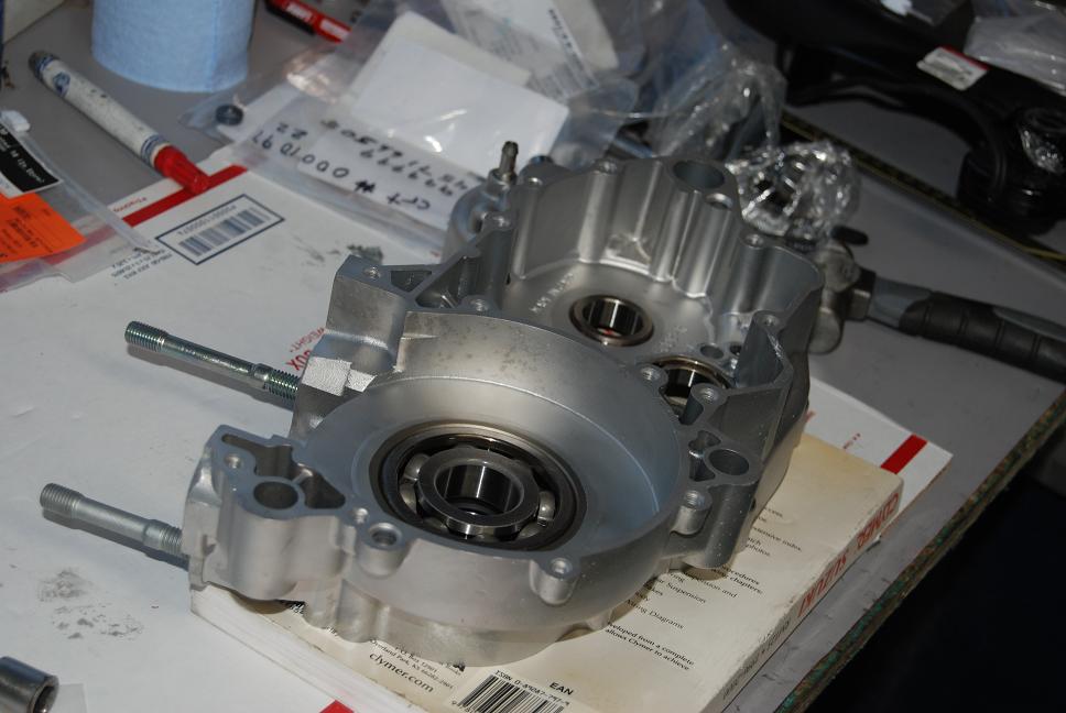

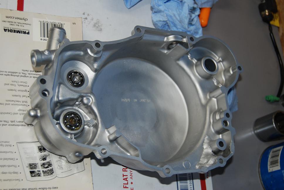

Re: KX500 BOTTOM END REBUILD FOR SCOT By JT Engine Works & OEM-CYCLE
Scot just sent me this... Anodized and ready for bearings..

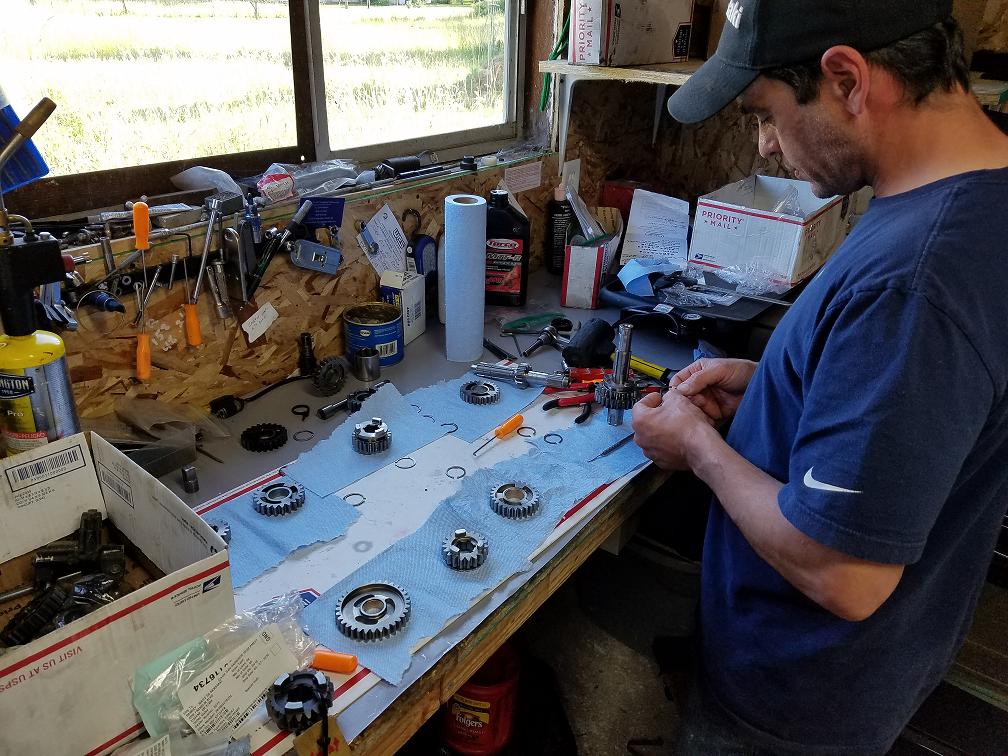

Stripped the trans, cleaned every part, inspected everything, replaced every cir-clip, washer, and bushing..
JT ENGINE WORKS AND OEM-CYCLE KX500 BOTTOM END REBUILD 132.JPG (174.14 KiB) Viewed 8737 times

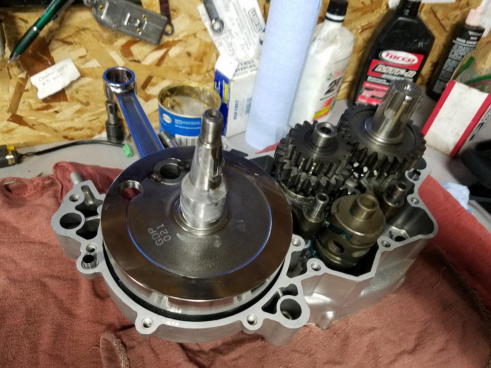

Fresh out of the oven..
JT ENGINE WORKS AND OEM-CYCLE KX500 BOTTOM END REBUILD 133.JPG (175.47 KiB) Viewed 8737 times

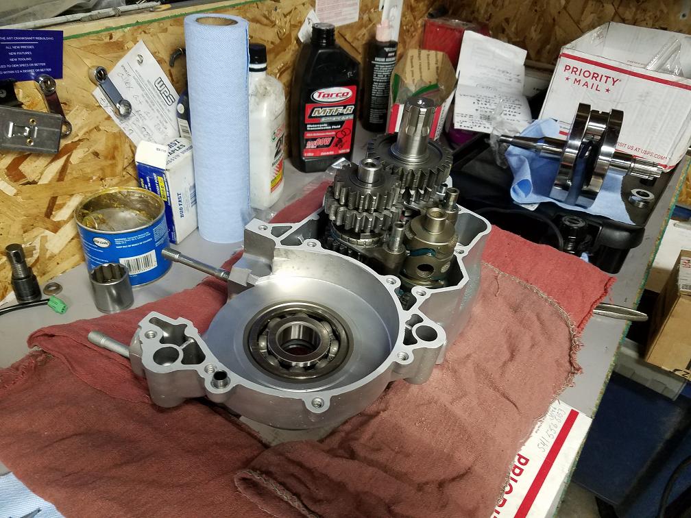

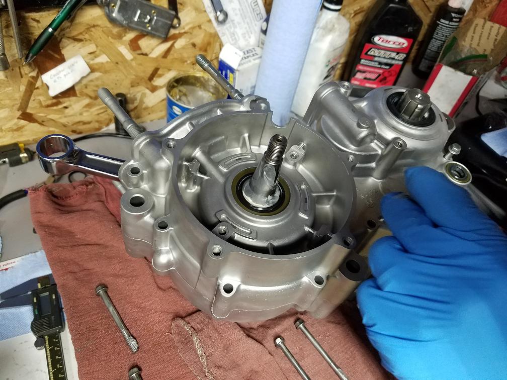

Drop in the crank while it is hot..
JT ENGINE WORKS AND OEM-CYCLE KX500 BOTTOM END REBUILD 135.JPG (163.64 KiB) Viewed 8737 times
Oh yeah...
JT ENGINE WORKS AND OEM-CYCLE KX500 BOTTOM END REBUILD 134.JPG (154.1 KiB) Viewed 8737 times

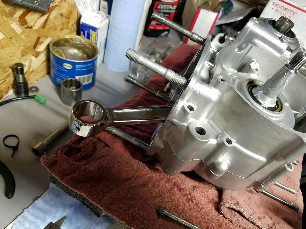

Tomorrow we will button up everything except for the flywheel because it isn't here yet :-(
JT ENGINE WORKS AND OEM-CYCLE KX500 BOTTOM END REBUILD 136.JPG (151.99 KiB) Viewed 8735 times

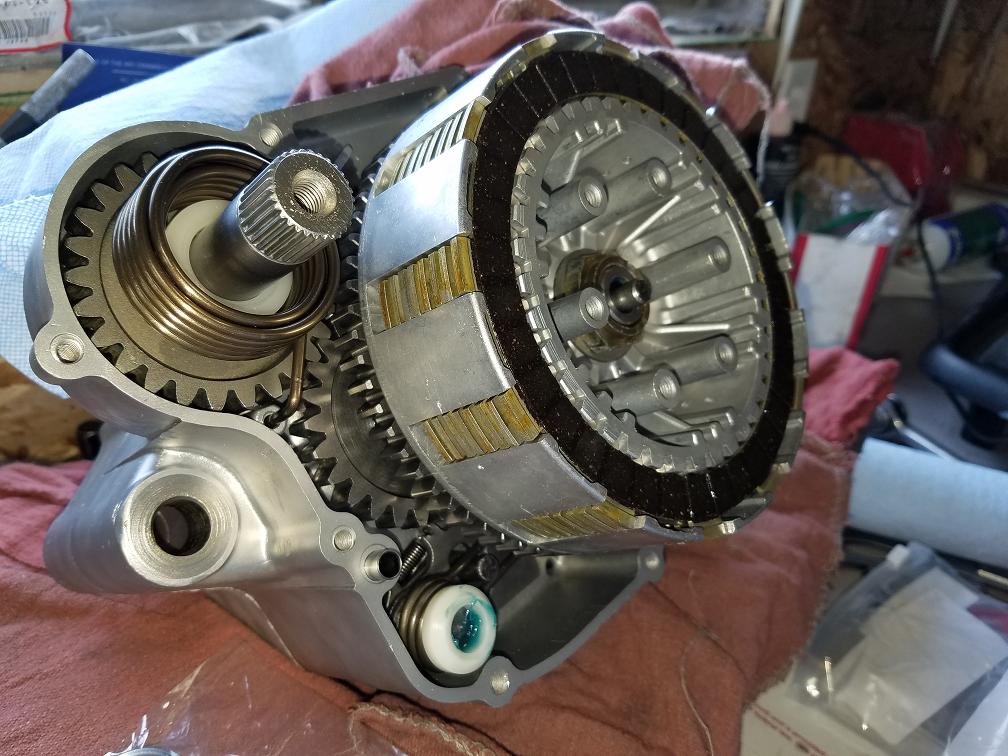

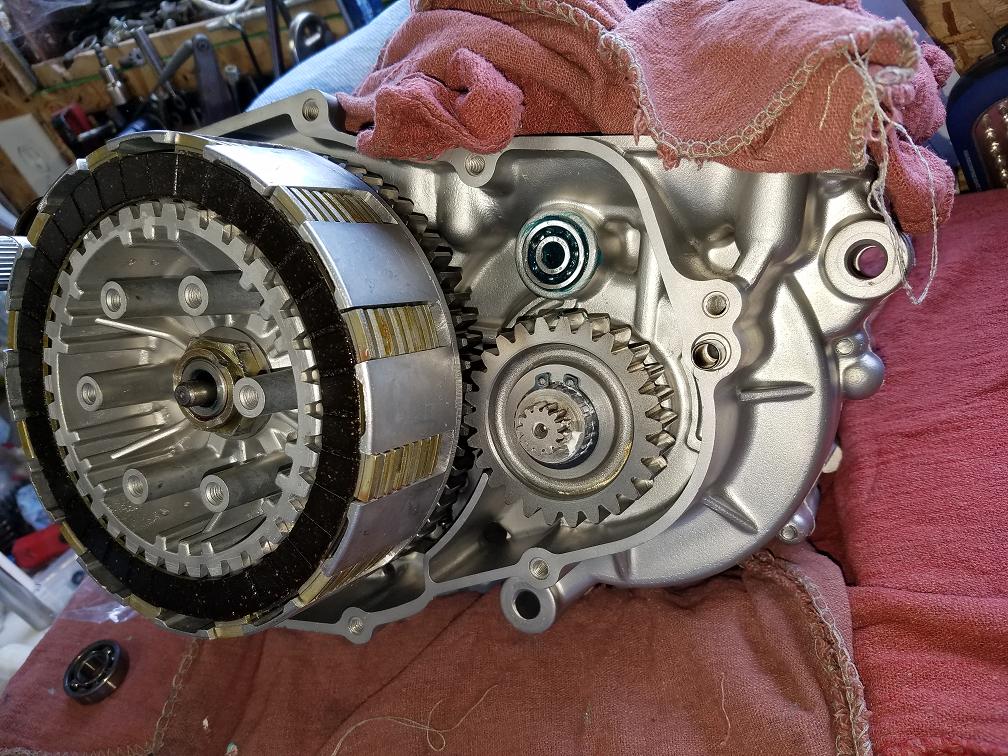

A bit more progress..
JT ENGINE WORKS AND OEM-CYCLE KX500 BOTTOM END REBUILD 138.JPG (214.55 KiB) Viewed 8721 times
JT ENGINE WORKS AND OEM-CYCLE KX500 BOTTOM END REBUILD 139.JPG (146.18 KiB) Viewed 8721 times
This basket had been filed on before and the tangs were angled instead of inline with the clutch plates so it was going to wear out very quickly.
So, Jason files them square again.
While filing on a clutch basket really should not be done, the basket can be replaced relatively easily.
And, with a new bottom end you don't want the customer to have shifting issues so.. File away..
JT ENGINE WORKS AND OEM-CYCLE KX500 BOTTOM END REBUILD 140.JPG (244.93 KiB) Viewed 8721 times

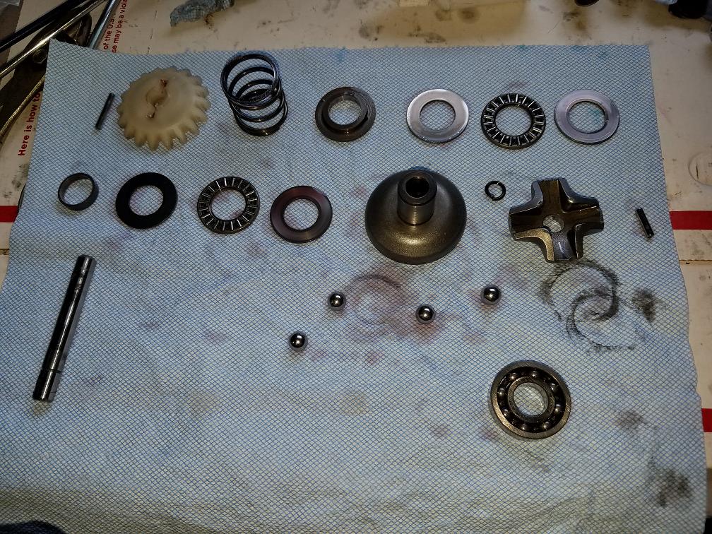

On our KX500 builds we replace all the goodies in the governor... Bearings, spring, washers, ect..

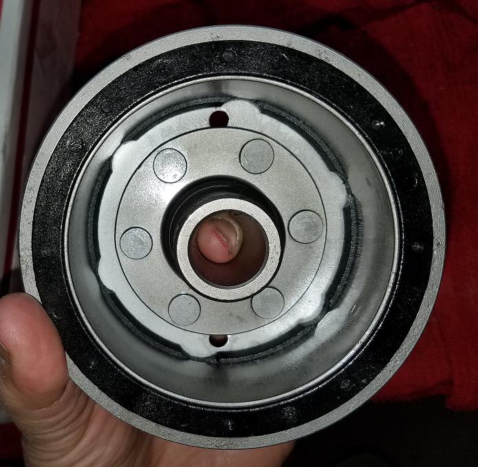

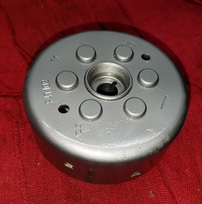

The flywheel came in today..
It cleaned up pretty good..
JT ENGINE WORKS AND OEM-CYCLE KX500 BOTTOM END REBUILD 141.JPG (68.12 KiB) Viewed 8709 times
JT ENGINE WORKS AND OEM-CYCLE KX500 BOTTOM END REBUILD 142.JPG (95.25 KiB) Viewed 8709 times
It's baking in the oven right now for an hour at 200F

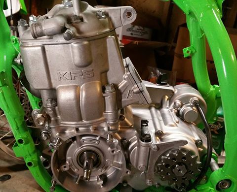

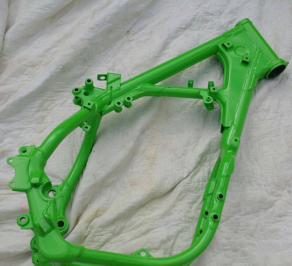

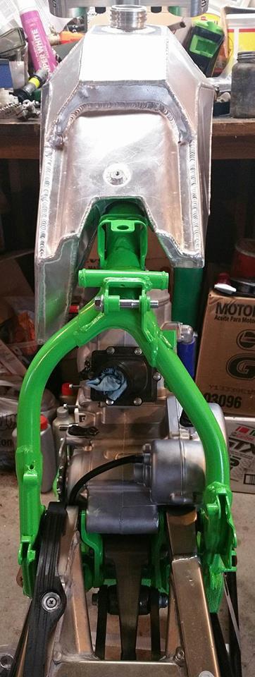

Little bit more progress tonight on the KX500. Ran into a couple of snags, but we're in no hurry. Still waiting on a few parts and I need to make a call or two tomorrow. This beast is gonna be new from the ground up.
