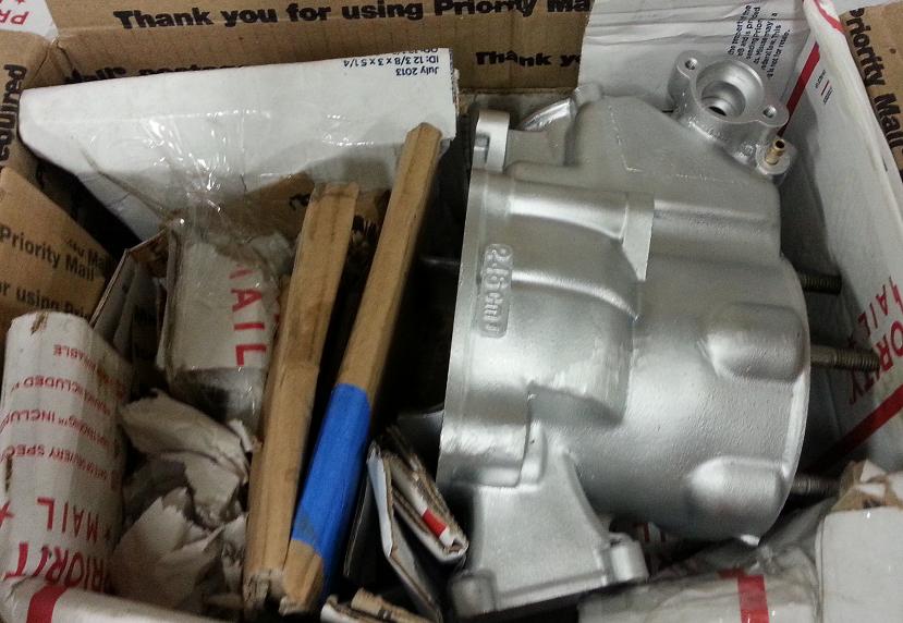

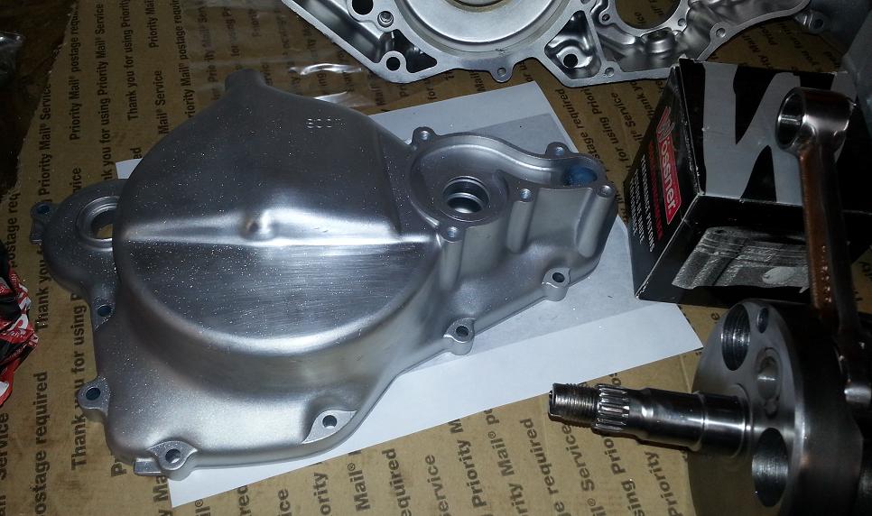

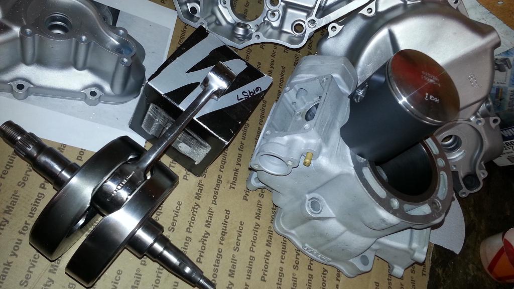

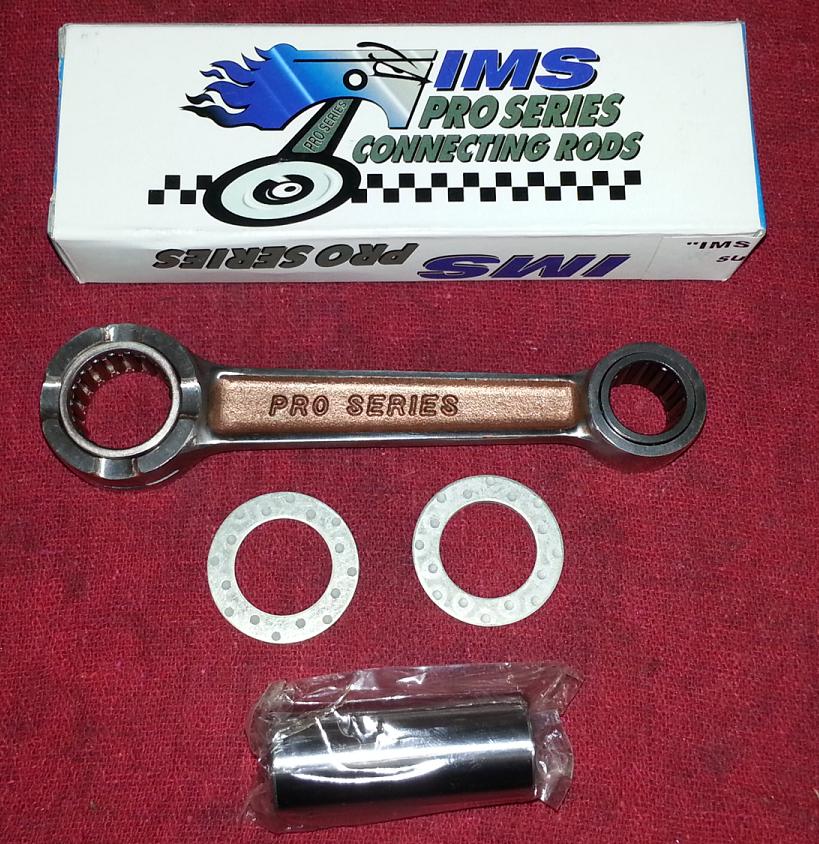

Got the rod kit in... Nice!
OEM-CYCLE.COM 1988 RM250 ENGINE REBUILD 124.JPG (151.36 KiB) Viewed 8928 times
Got the crank split and it is now ready for clean up and some polish..

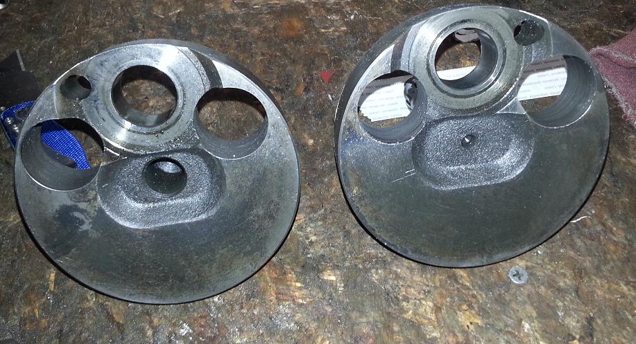

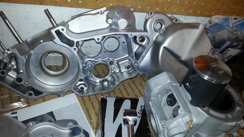

We should make Millennium happy with this order..

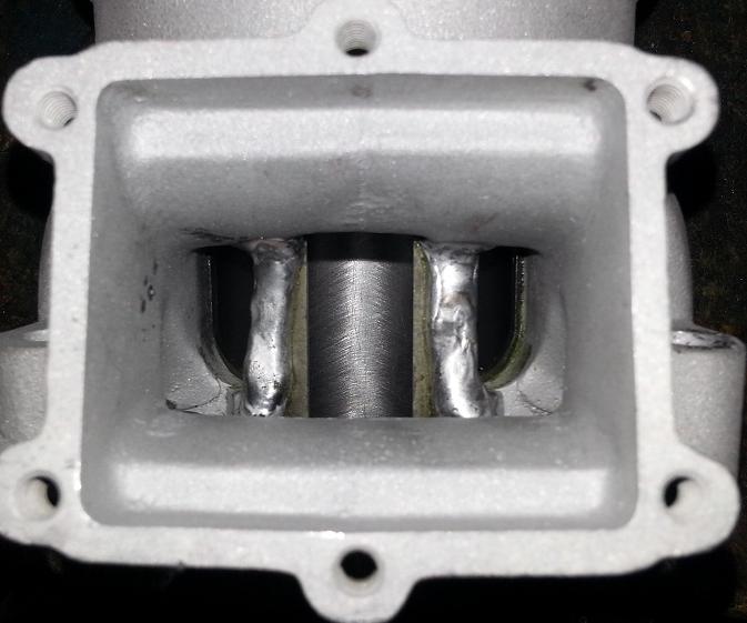

Remove sleeve, weld, install new sleeve, port match and grind the deck to clean up.
Rebuild the crank using a IMS Pro rod...
We even Vapor blasted the parts so that they would be nice and clean for them to work on :D

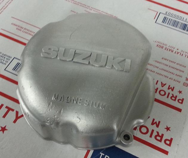

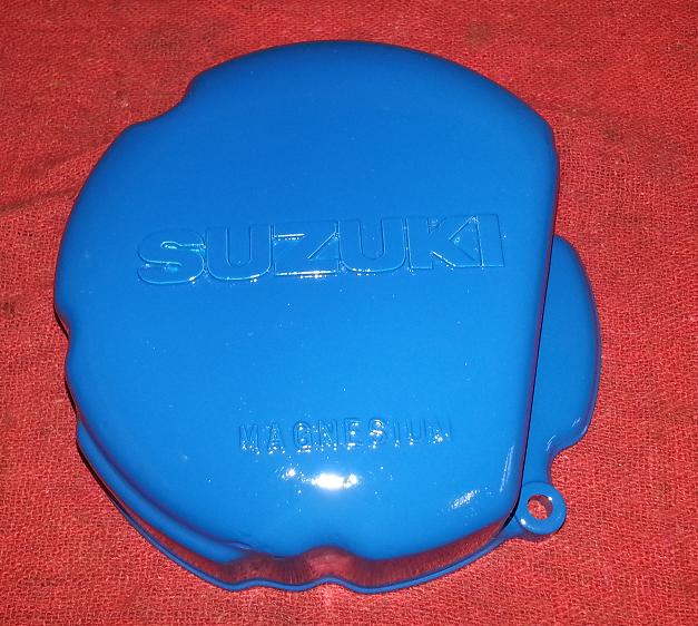

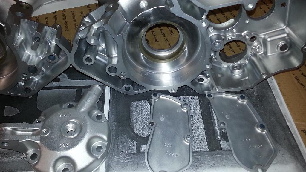

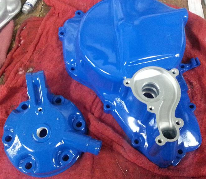

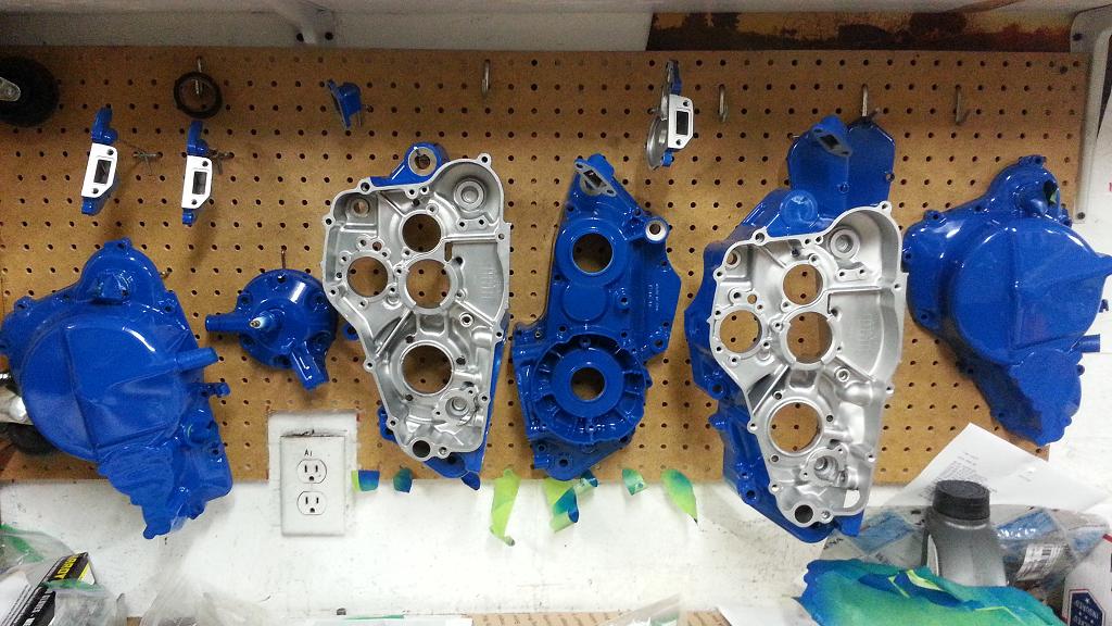

More clean up and paint test..
Vapor blasted but since it is made from Magnesium you can't leave it unpainted or your asking for trouble.
We used VHT Engine Paint SP134 Ford Light Blue.
Painted the inside and bakes at 200f for an hour.
Then we let it cool and painted the outside and baked it again for another hour.
Turned out pretty good.

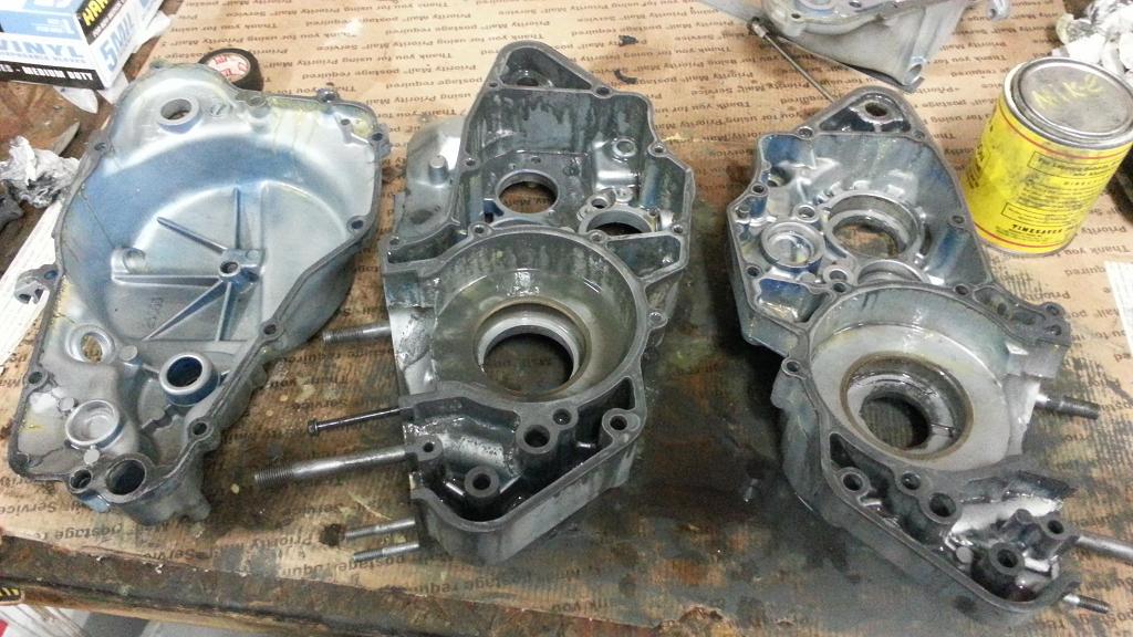

Lapping and prepping the cases..

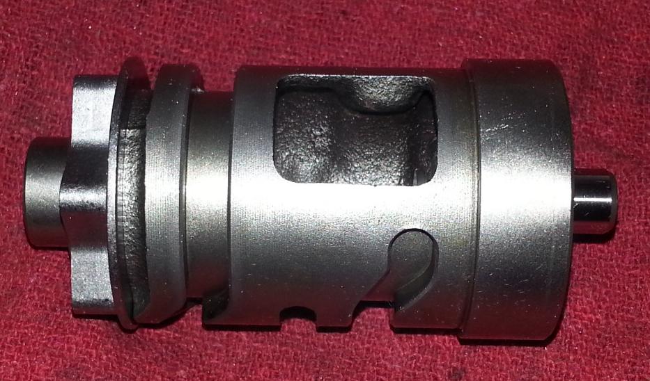

These look good but didn't pass inspection..
Found some wrinkles :evil:
1988 RM250 ENGINE REBUILD WWW.OEM-CYCLE.COM 135.JPG (68.89 KiB) Viewed 8846 times
These are good to go.
1988 RM250 ENGINE REBUILD WWW.OEM-CYCLE.COM 136.JPG (152.09 KiB) Viewed 8846 times

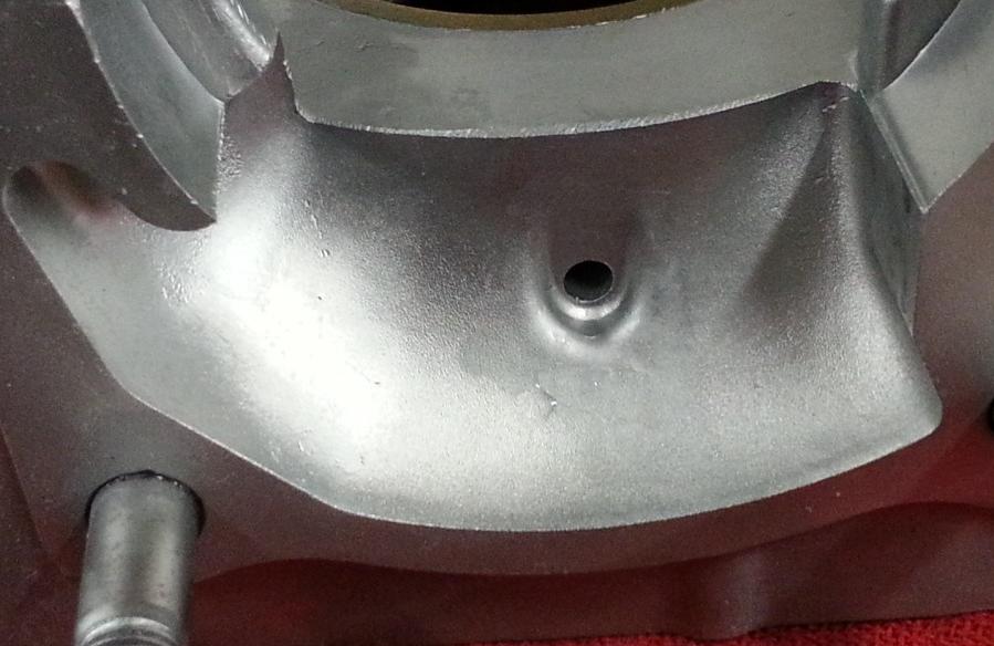

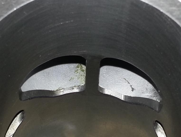

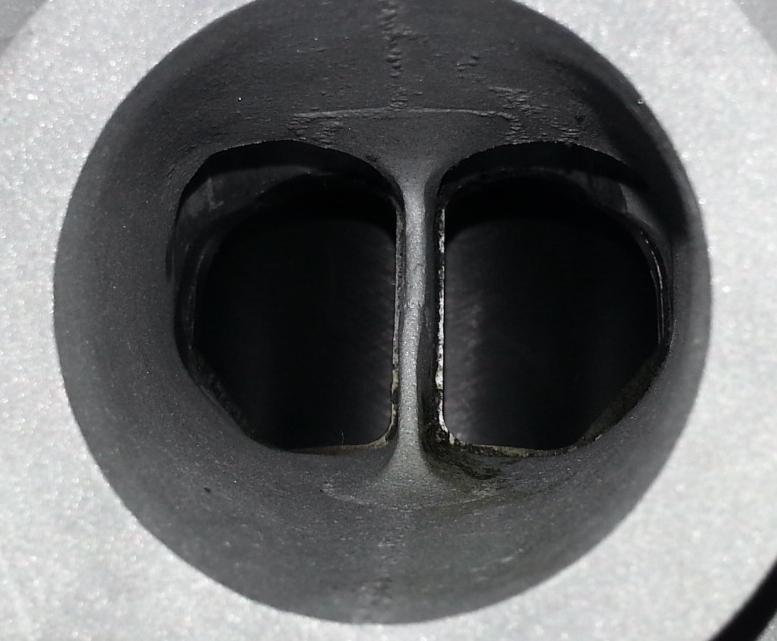

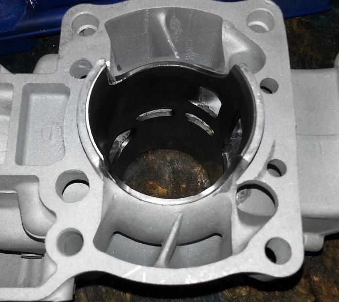

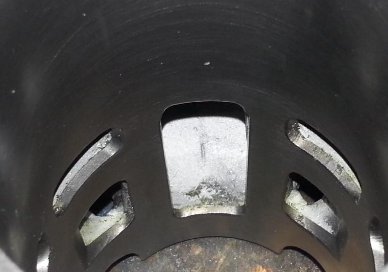

Starting to port the cylinder.
Here is what we are starting with.
1988 RM250 ENGINE REBUILD WWW.OEM-CYCLE.COM 140.JPG (47.88 KiB) Viewed 8845 times
1988 RM250 ENGINE REBUILD WWW.OEM-CYCLE.COM 141.JPG (56.33 KiB) Viewed 8845 times
1988 RM250 ENGINE REBUILD WWW.OEM-CYCLE.COM 142.JPG (41.32 KiB) Viewed 8845 times
1988 RM250 ENGINE REBUILD WWW.OEM-CYCLE.COM 143.JPG (37.02 KiB) Viewed 8845 times
1988 RM250 ENGINE REBUILD WWW.OEM-CYCLE.COM 144.JPG (39.36 KiB) Viewed 8845 times

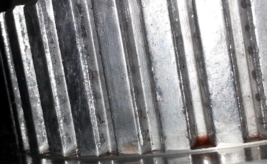

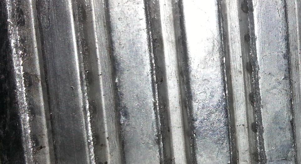

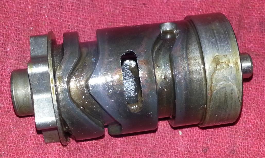

We are having a rough time finding a inner clutch hub in good condition.
This is the best of 4 that we have available.
1988 RM250 ENGINE REBUILD WWW.OEM-CYCLE.COM 145.JPG (102.83 KiB) Viewed 8826 times
1988 RM250 ENGINE REBUILD WWW.OEM-CYCLE.COM 146.JPG (108.67 KiB) Viewed 8826 times
But we have something in mind to make this a bit easier to shift :-)
