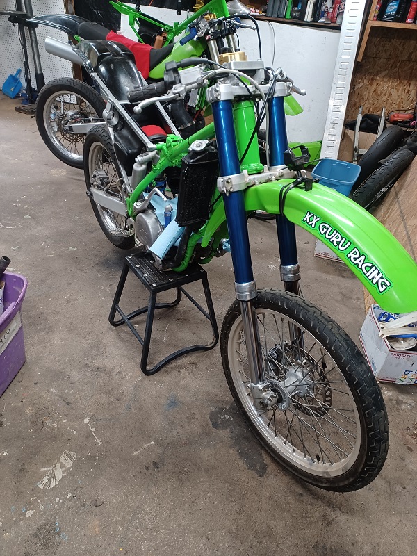

The latest project is getting the bike to the correct seat height.
Kawasaki claims 37".
Both my Land Speed Bikes measure 37.5"
From what I have been told for this class, every 1" of height looses you 1 mph.
Getting the suspension right should net us 1/2 mph.
We will see..
Before our next run I'm doing another compression change.
I'm hoping to pick up another 1/2 to 1 mph with the seat height and the fork height.
But we will see...
Looking at these forks you would think that I'm lowering much more than 1/2".
But I'm doing two things here.
1. lowing the fork height but compensating for the angle.
2. by allowing the fork tubes to be lowered into the triples more I can run the controls closer to the centerline of the bike and allowing the bars to be narrowed further.

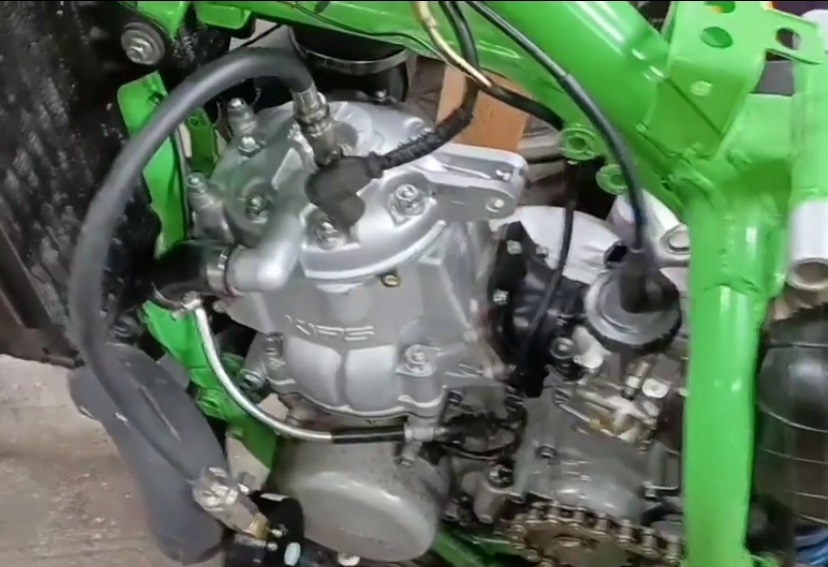

Ok, the compression is dialed in with the new head installed.
The chassis is set for height.
I changed the bar style to give it a bot more stability at high speed.
The steering stem bearings loosened up a bit since I built this bike so I made that adjustment.
I bled the front brakes so they grab a bit more than before.
It's nice to be able to stop :lol:
Here is a vid outlining some additional items, you will need a facebook account to view... Sorry
https://www.facebook.com/10000109367869 ... 145854224/

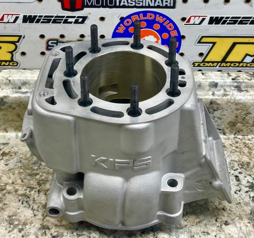

On our last test date I stripped a head stud :-o :-o :-o
I shipped it off to Tom Morgan Racing to have some cracks welded in the exhaust port, get it re-plated, and replace all the studs with CR500R studs.
Tom has finished my cylinder and it is being shipped this week so I should have it soon.
The lower end has all the ceramic bearings installed and is buttoned up excluding the top end.
I need to remove the existing bottom end and get the new one installed.

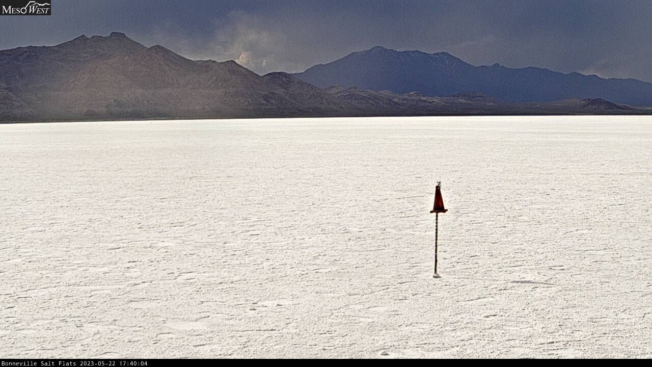

I just found this site from the University of Utah for a camera view....................
https://home.chpc.utah.edu/~u0790486/wx ... ?cam=BFLAT
Looks to me like Bonneville will happen this year... YES!!!

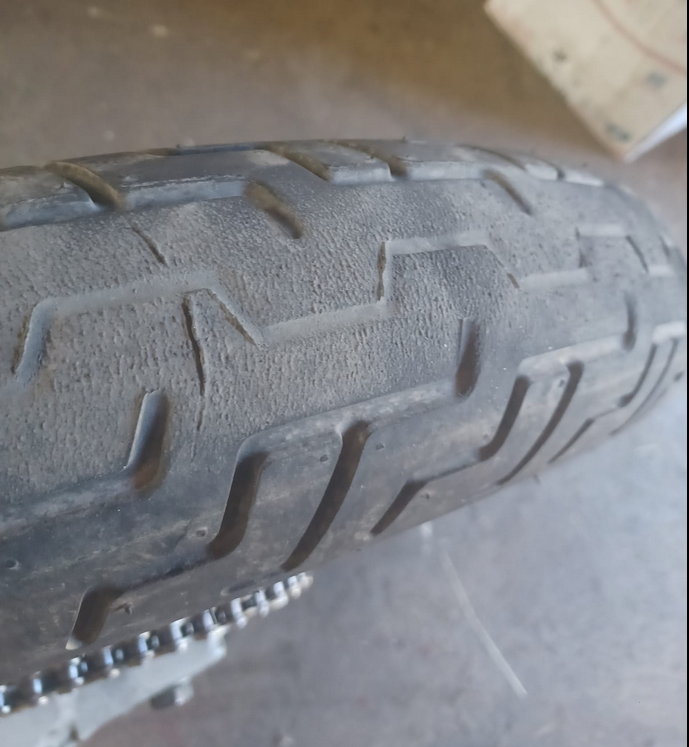

Rained out again for 2023...
That means that we need to go faster :lol:
Here is what 500 miles of land speed testing looks like on a tire..
