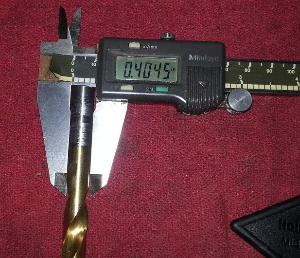

You may want to double check your drill bit size to be sure it is accurate.
This one is close enough:

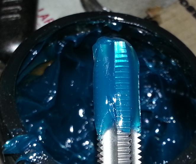

Take the drill bit and apply a liberal amount of grease to the end of it.
This will help prevent or greatly reduce any aluminum chips from getting into your engine case.

Pull the drill out and prep your tap by greasing it just like you did with the drill.
Once again, stop when you are almost all the way through, clean the tap off, and reapply the grease.
Continue tapping until the tap goes at least a half inch into the motor to get full thread engagement.
When your done, back the tap out and clean any debris.

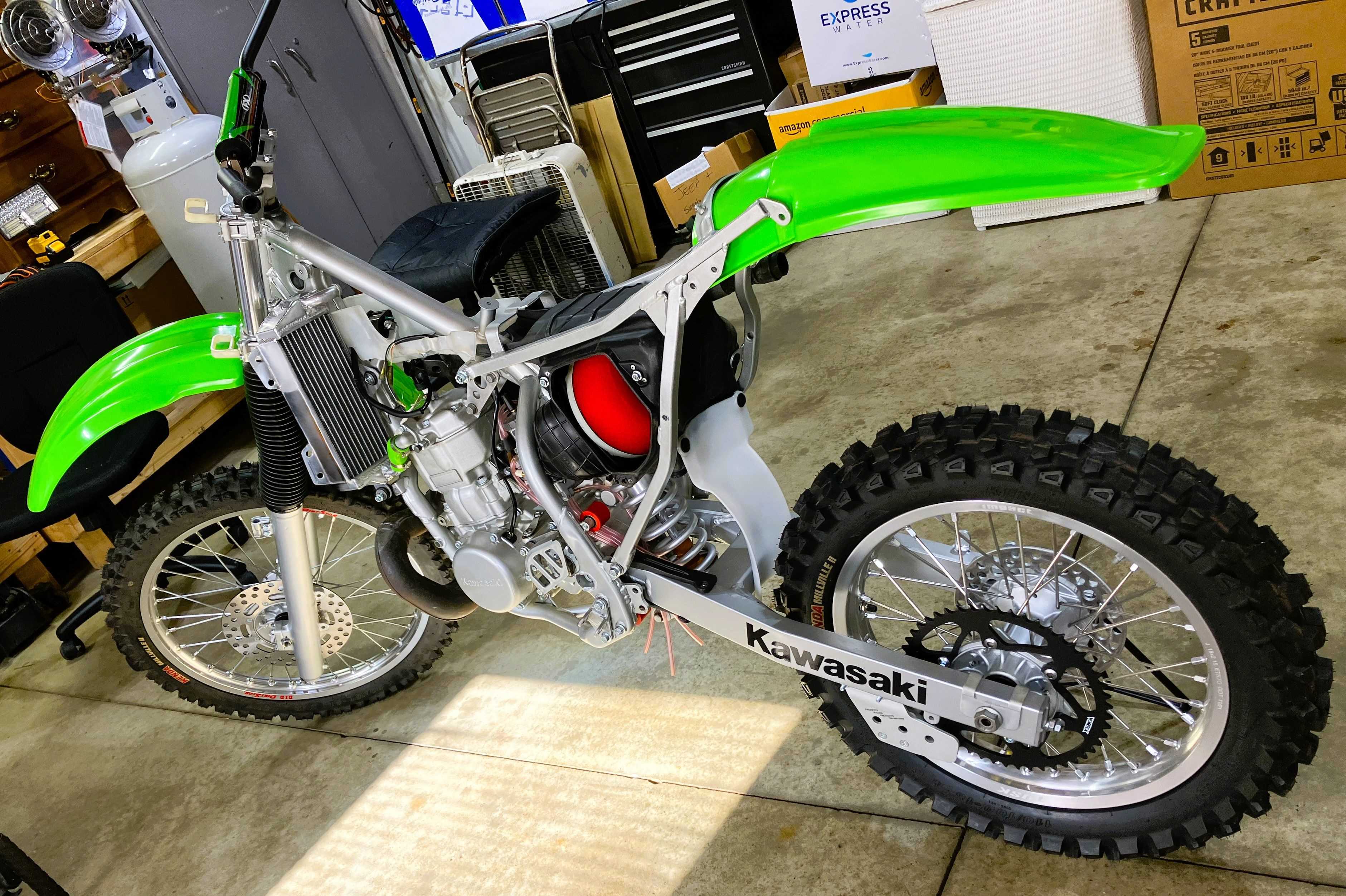

Well, I'm about 2 years late in responding to "how's that '87 running", but here's the answer:
1. I got old before it was finished. Arthritis, tendonitis, backache-itis, and fatigue-itis set in big time.
...well that may be a tiny bit of hyperbole.
2. Winter came and it got too cold in the garage.
3. Summer came and it got too hot in the garage.
4. Like any project, after being away from it for a couple years, I lost interest.
5. Suddenly, I got fired-up after watching Derek Bieri of Vice Grip Garage fame encouraging us guys with unfinished projects to get busy on them.
6. I got started a few weeks ago, and I'm moving along right smartly now...
