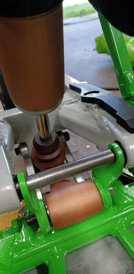

My original idea was to put the 19 shock in completely stock except for the spring. But then I thought, this is going on The Haas bike. Why not add one more detail. So I contacted Brian Bolding from N2Dirt suspension https://www.n2dirt.com/ and he is going to take this project to the next level. Brian has software that allows him to test and record results for all sorts of fancy suspension stuff 😄
He is mapping the shock so I will be providing measurements and doing all the wrench work here in Oregon.

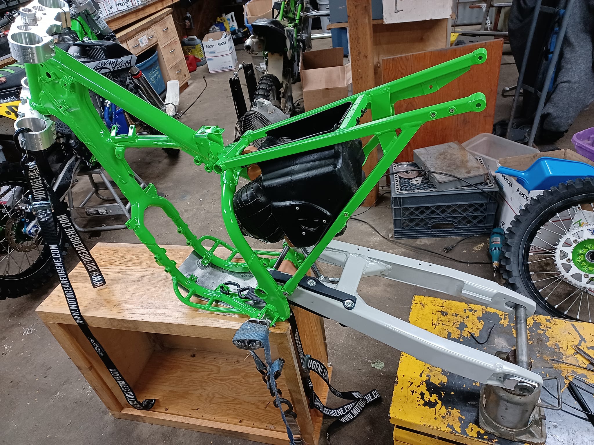

For this project, one of the things that Brian Bolding at N2dirt Suspension wants is a map of how much the shock shaft travels in relation to how much the rear wheel moves. I thought it would be linear but have discovered that it moves on a curve. For those of you who know this stuff already just ignore this post and move along 😁 Hey... I'm a engine guy, not a suspension guy 😎 Tomorrow I will get some more tie downs so I can get more accurate measurements. The slightest movement of the chassis can throw off the readings quite a bit...
Re: 2019 KX450f shock on a KX500
OK, here is the date.
Measured in 1 " increments of rear wheel travel
1" = .21875"
2" = .21875"
3" = .3125"
4" = .3125"
5" = .3125"
6" = .375"
7" = .375"
8" = .375"
9" = .40625"
10" = .4375"
11" = .375"
12" = .250"
