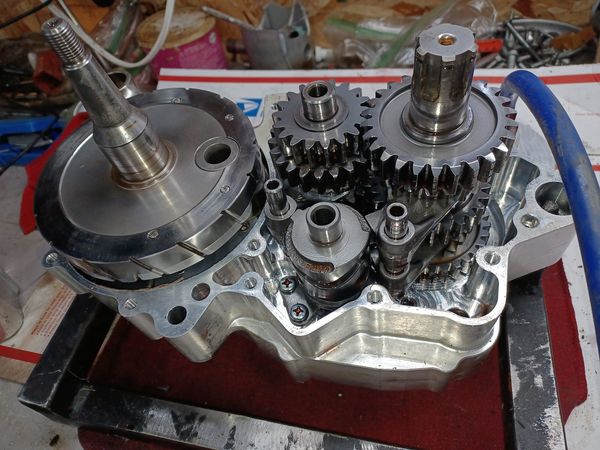

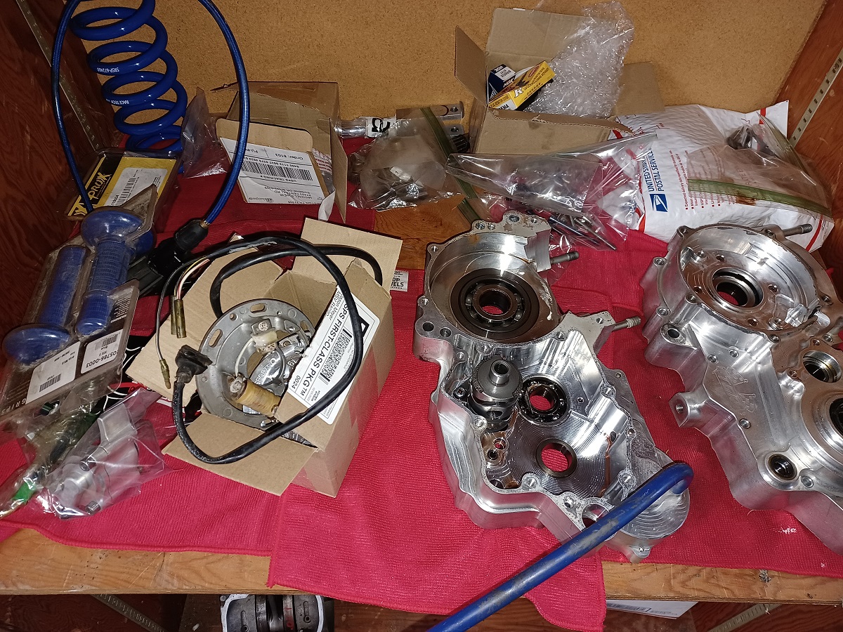

This is the engine that will be going in this build for the time being..
TSR Billet cases with hydraulic clutch.
Cost on these as of 4-1-22 $2200 AU.. At this time that's about 1700 US plus shipping.
Something special about this crank... Thanks Steve Parris at Parris Racing Concepts.
And, check out that full stuffer :shock:
