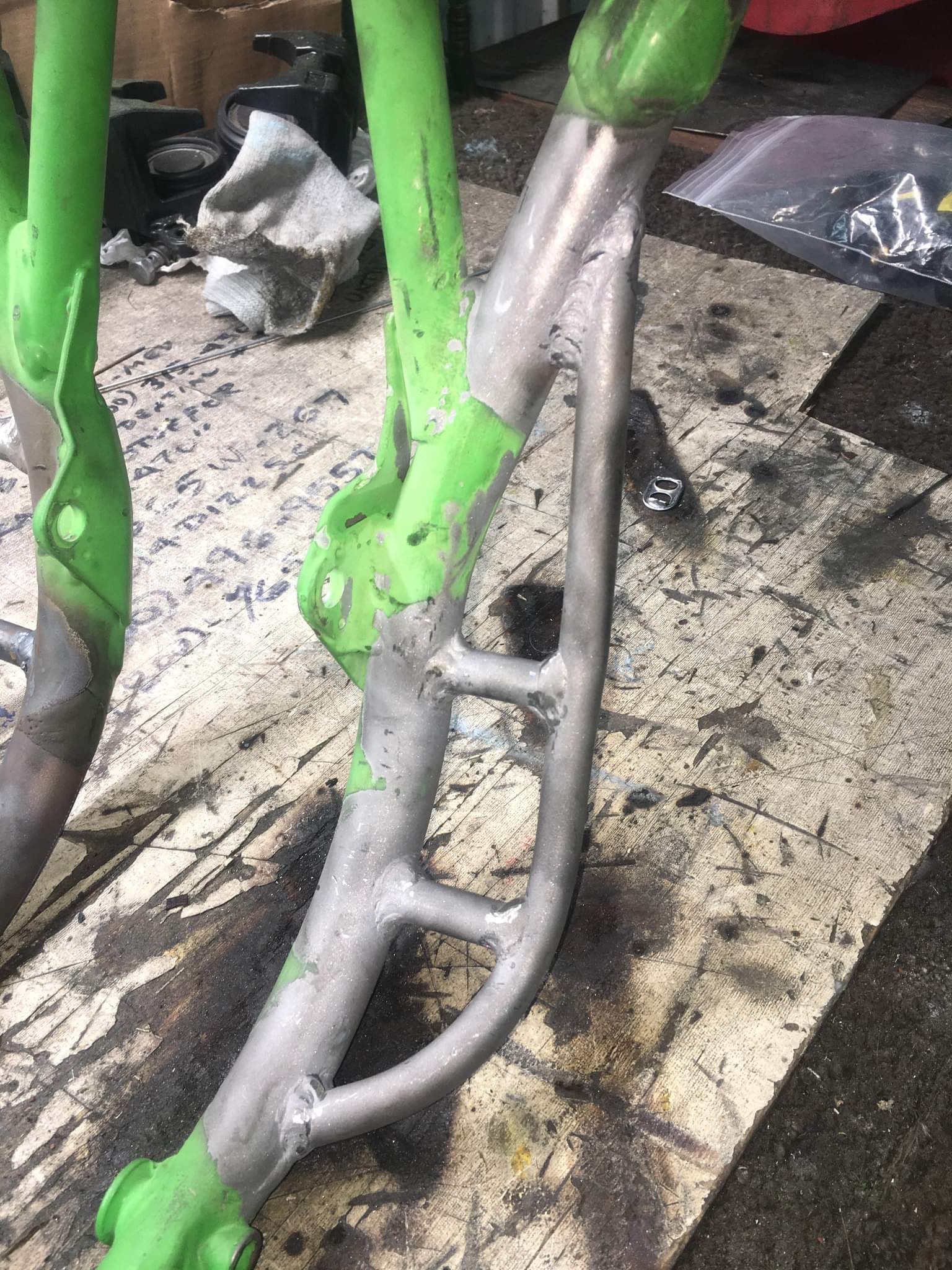

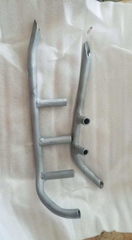

If your KX500 does not have these engine guards, it's not a Haas build..

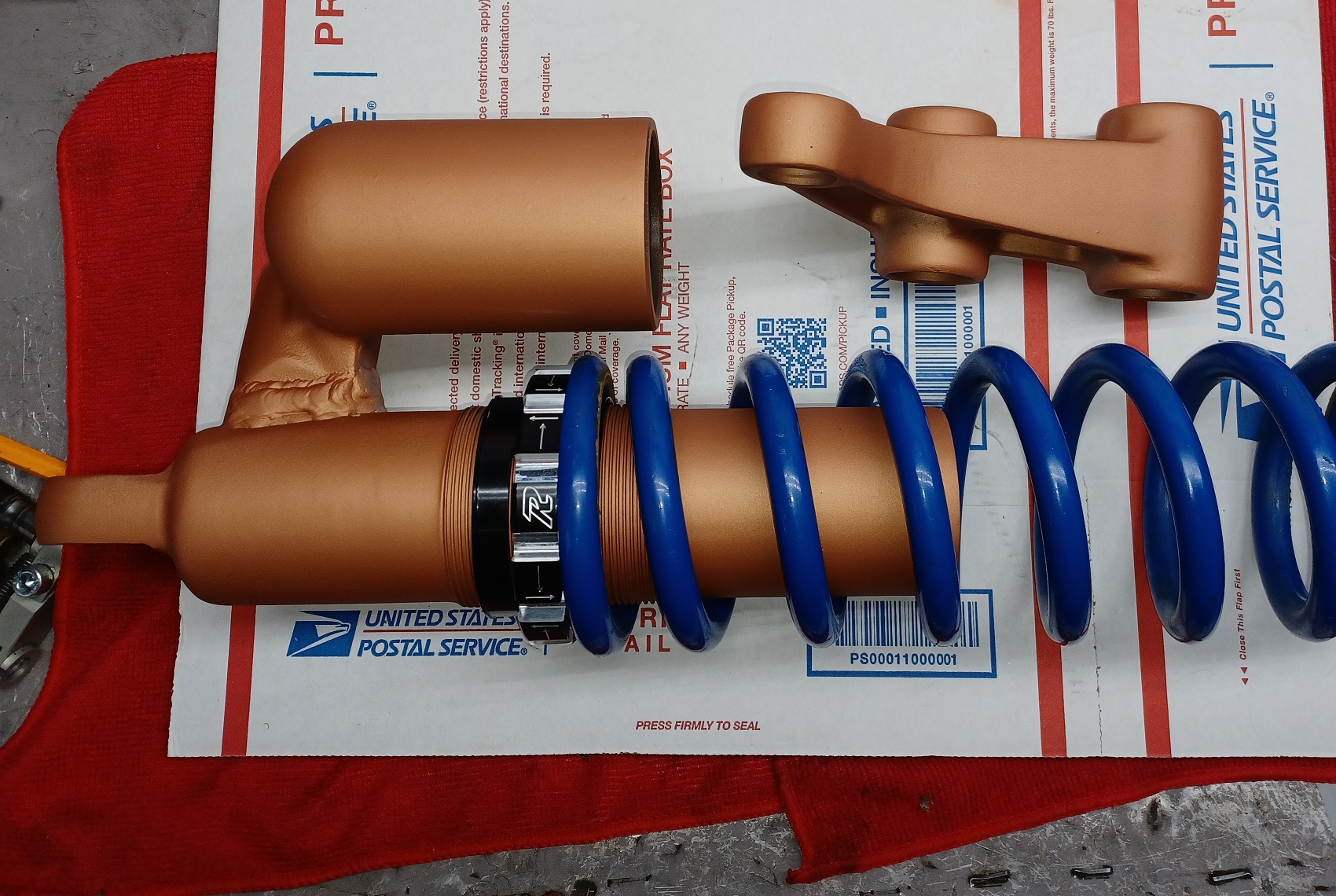

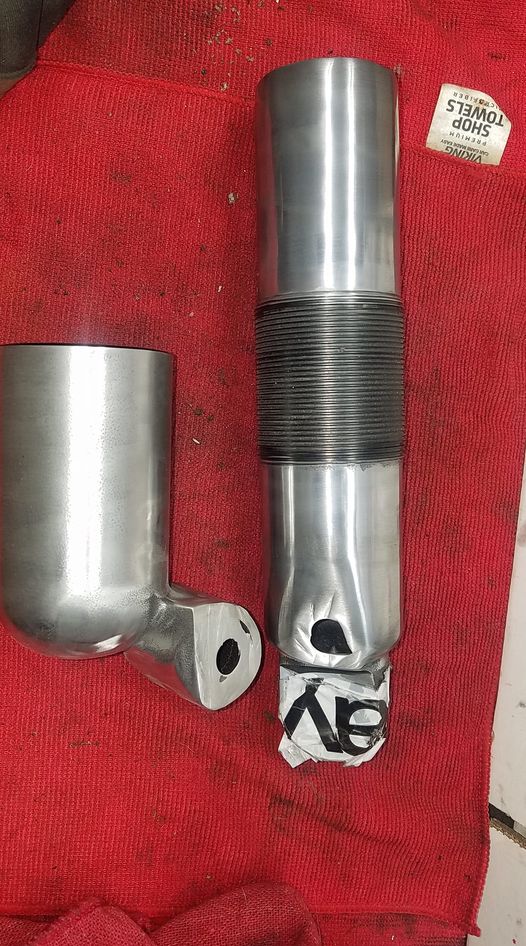

There are a few things that have to be done to make a 450F shock fit your KX500 frame..
Here is a pic of the shock after I cut the reservoir off...

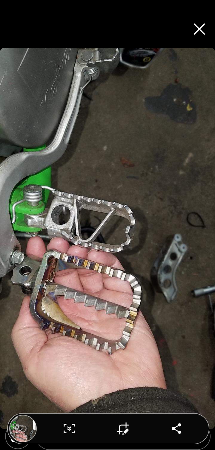

I removed the stock KX500 peg mounts and had my good buddy Vince Brewer weld on some YZ250 2020 ish foot peg mounts to fit my Titanium Paragon pegs...

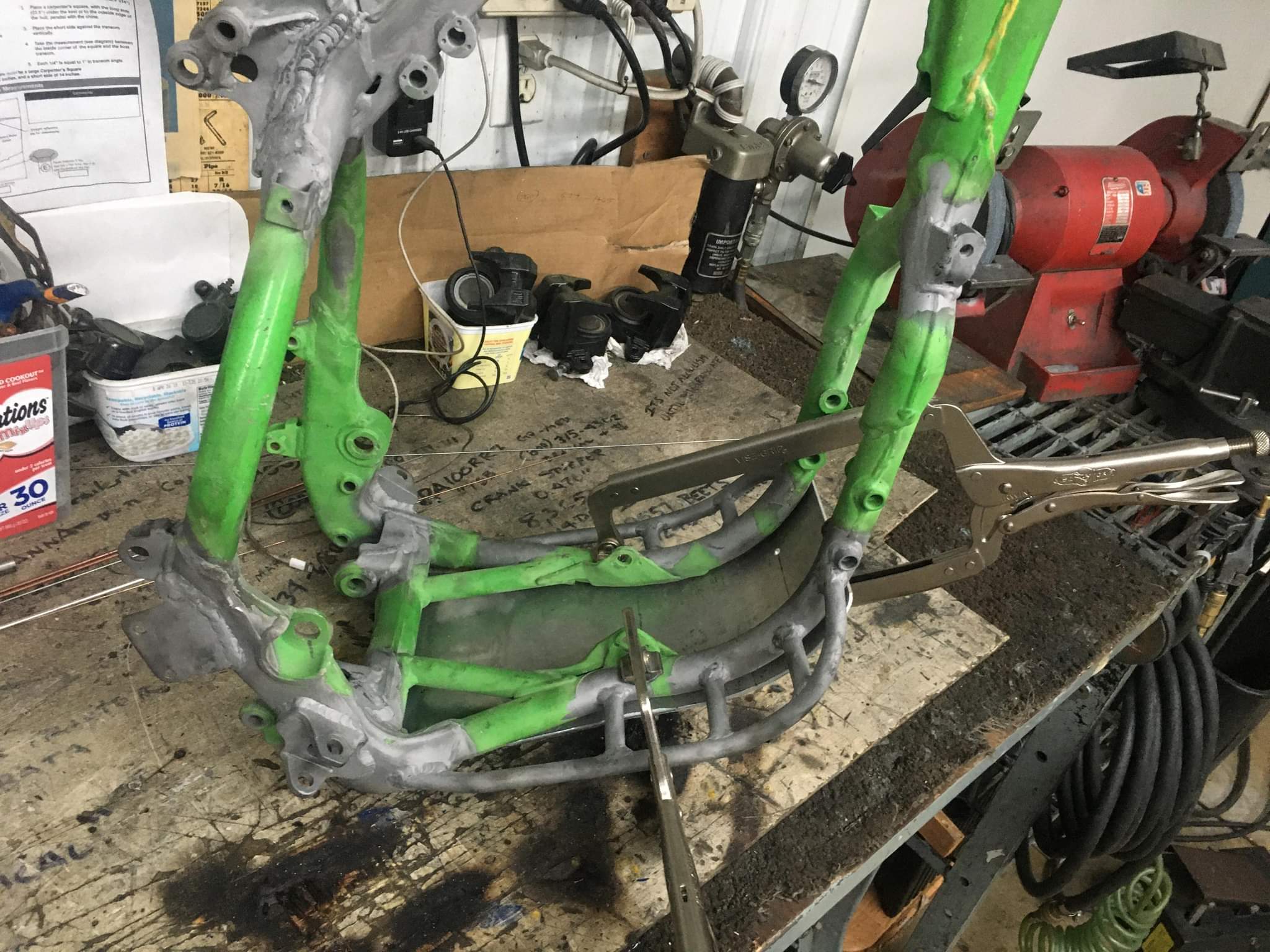

After that was done I sent the shock, frame, JT Engine Works Gusset kit, and Dyno Doug Haas Engine guards to none other than Dyno Doug Has for more fabrication and weld.

In the mean time I took the 2019-21 KX450F shock and Cerakoted it in Copper...
I went ahead and did the Unitrak linkage as well...

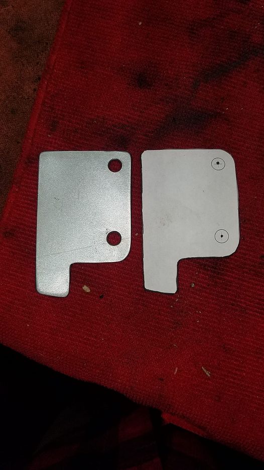

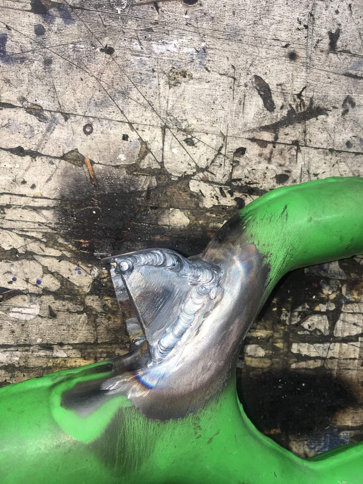

I had Doug weld on this rear brake master cylinder relocation tab for using a 19-21 KX450F master cylinder.

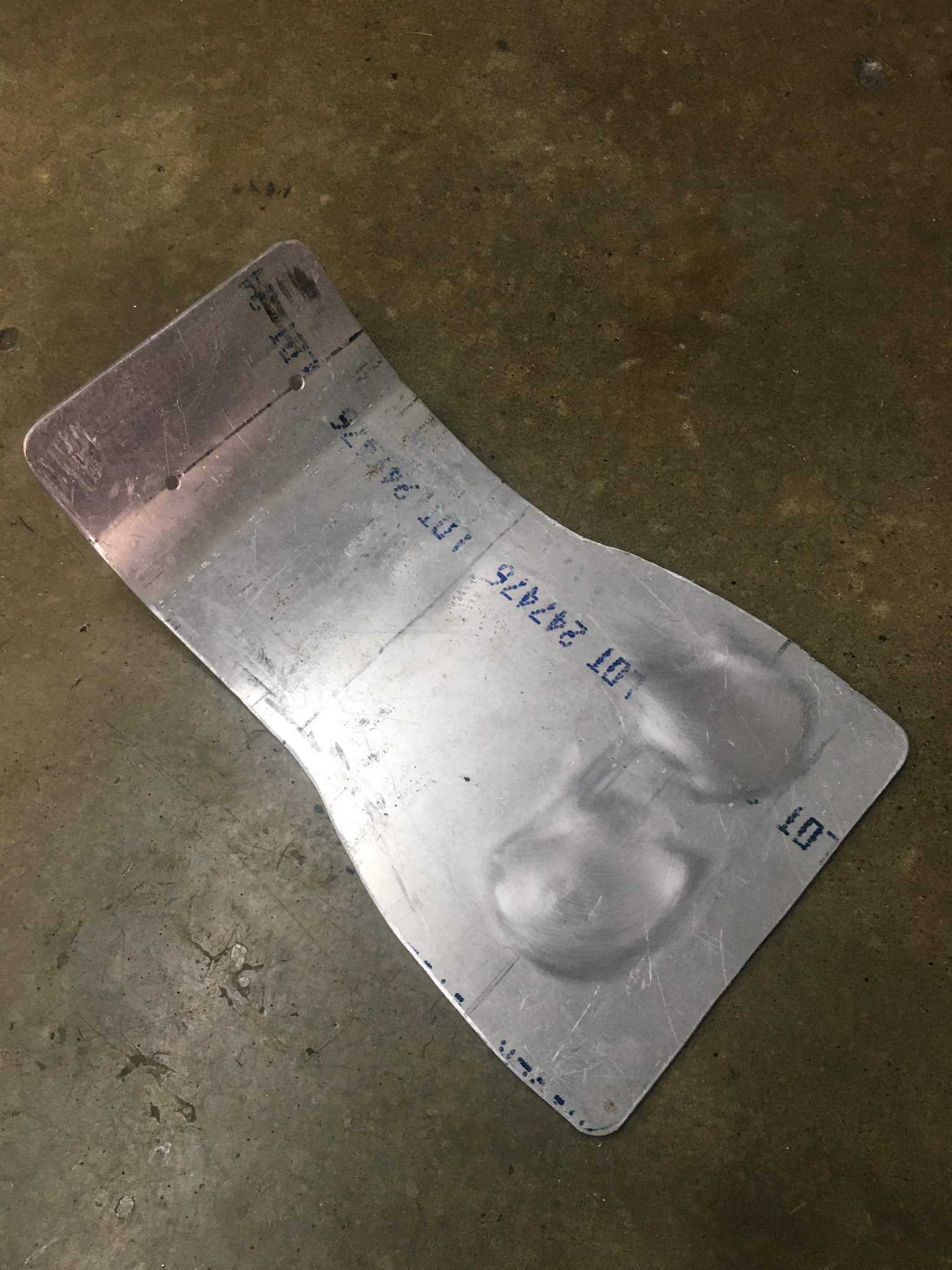

What is this?
A custom Dyno Doug skid plate.
It's a one off.
Nothing else will fit this set up..

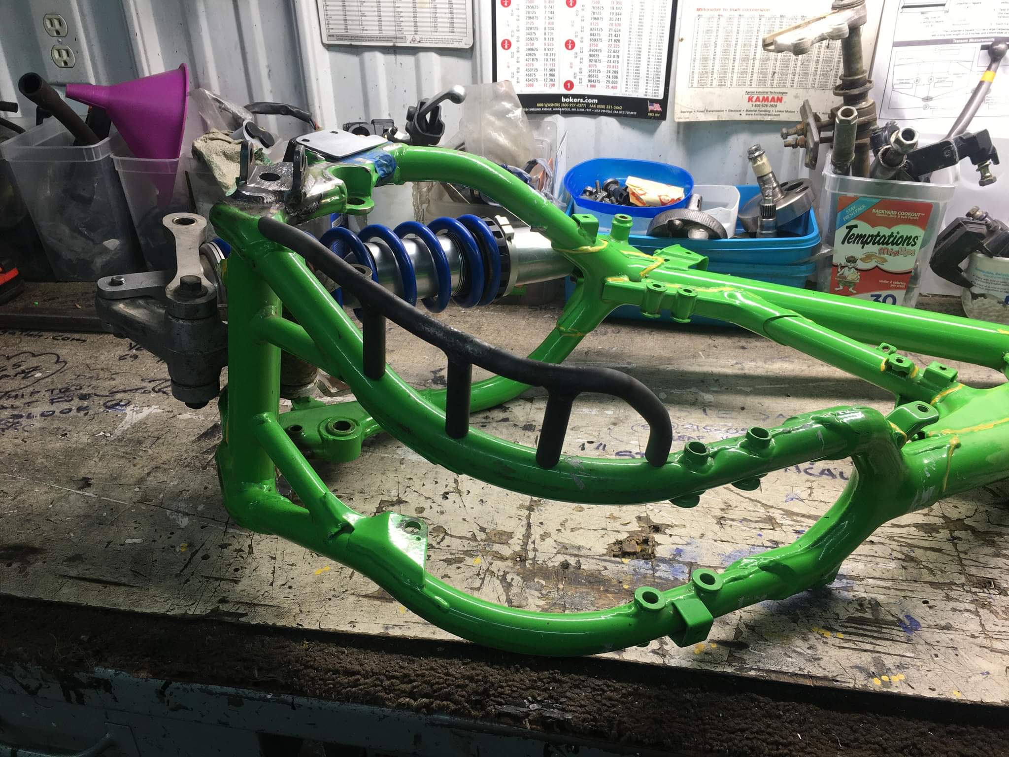

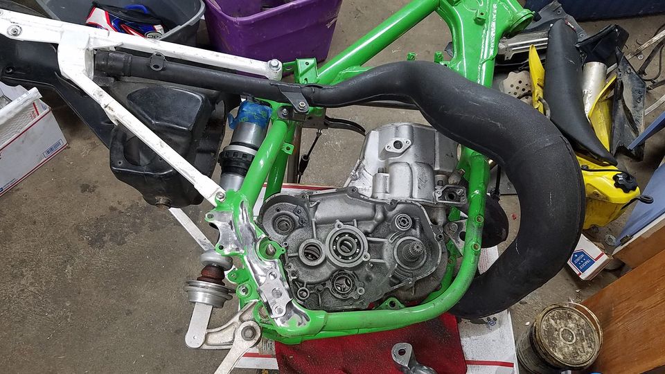

Before I sent this frame off to Doug, I mocked everything up to be sure I would have the proper clearances.
So far, so good 8-)

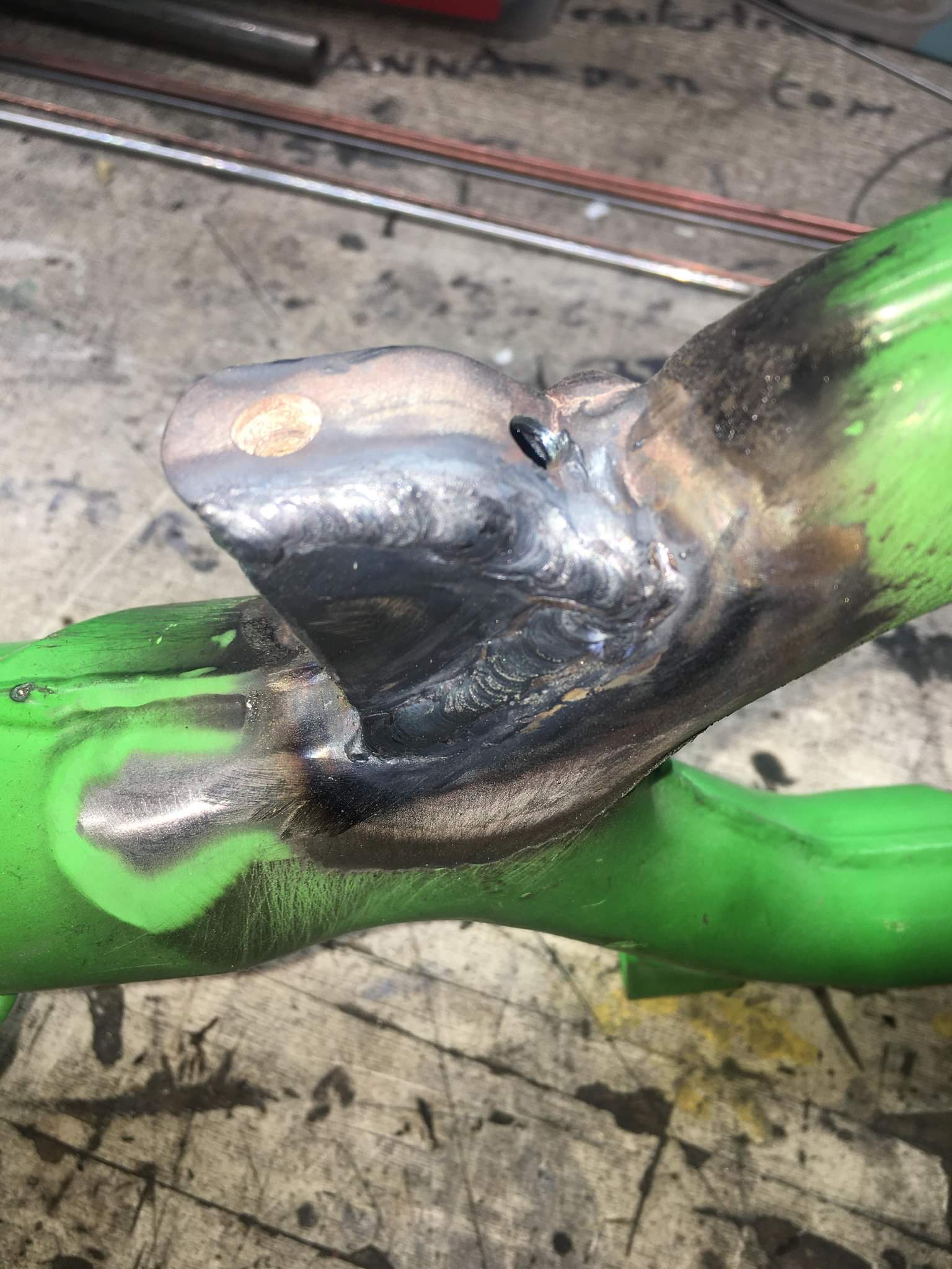

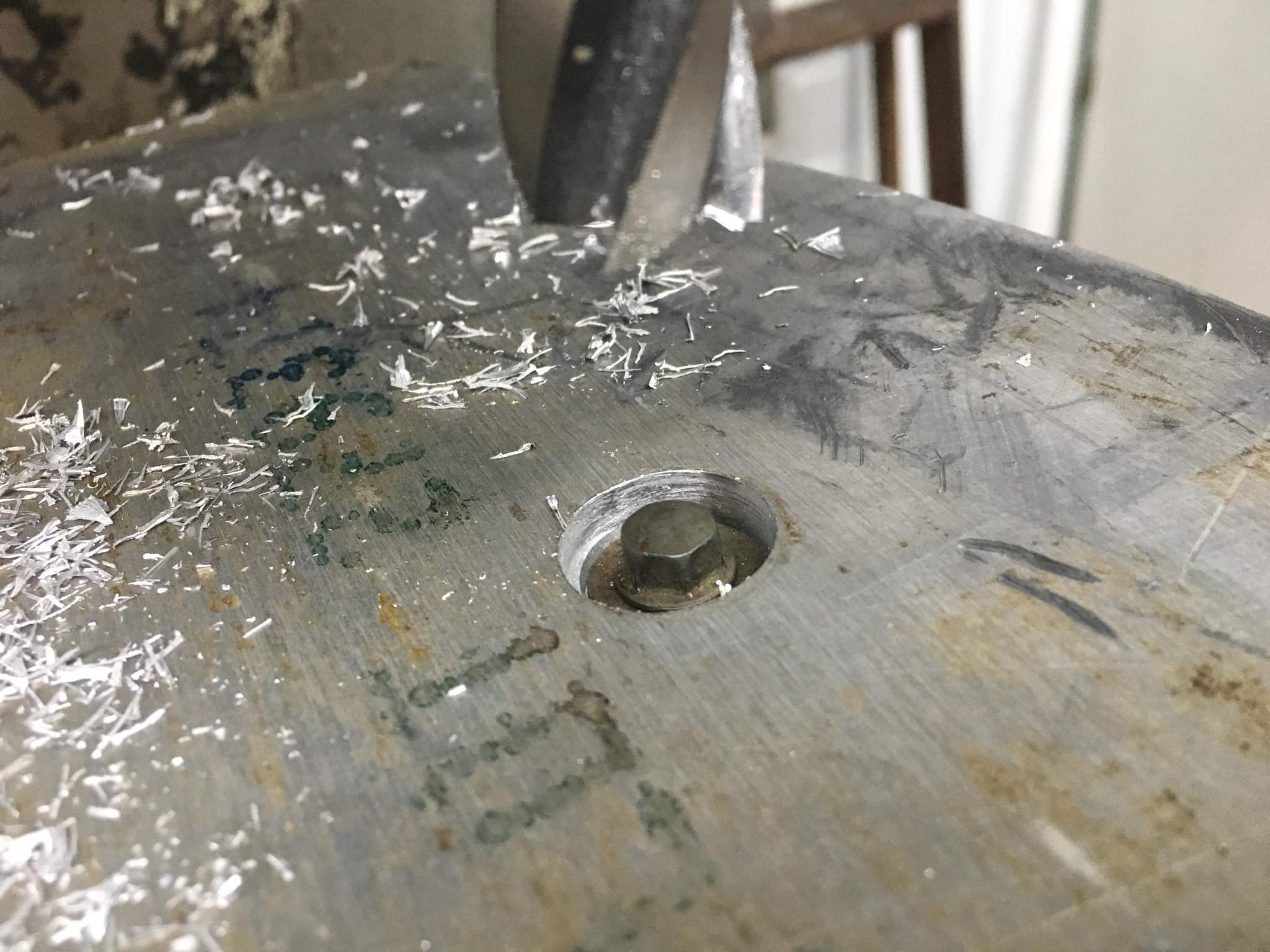

Yep... Fixing all the little details...
Note the drain hole...
