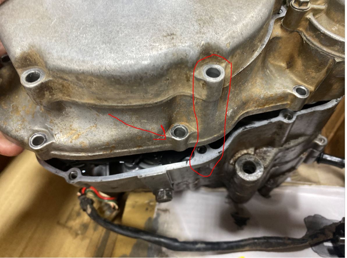

I see what you mean with the extra bolt, my case and cover do not match. From what you stated the lower end is 97 up and the cover is 96 down? Is that correct or do I have it backward? The bolt in the red circle goes all the way through the right side cover to the case, the red arrow is the extra bolt hole.
Posting pic for clarification
kx case.JPG (153.68 KiB) Viewed 12608 times
Re: Bottom end identification
I don't know, I'm a 500 guy :lol:
