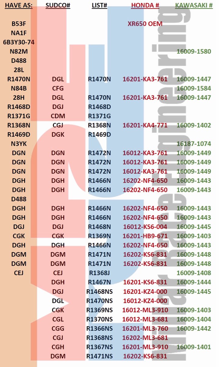

CARBURETOR NEEDLE CROSS REFERENCE CHART
This chart was provided by Adam Millar.
Thanks Adam!!!
ADAM MILLAR CARBURETOR CROSS REFERENCE NEEDLE CHART.jpg (171.27 KiB) Viewed 8545 times

I found this in the manual of my 1994 KX500.
As you can see in the chart, the sequence of the needles does not follow A-Z = Leaner to Richer or vice versa. This leads to me to a few questions. The popular N82M needle which side would the needle fall under, the upper and lower table. and of the two tables (P-T or D-H), which is the leaner or richer of the two?
