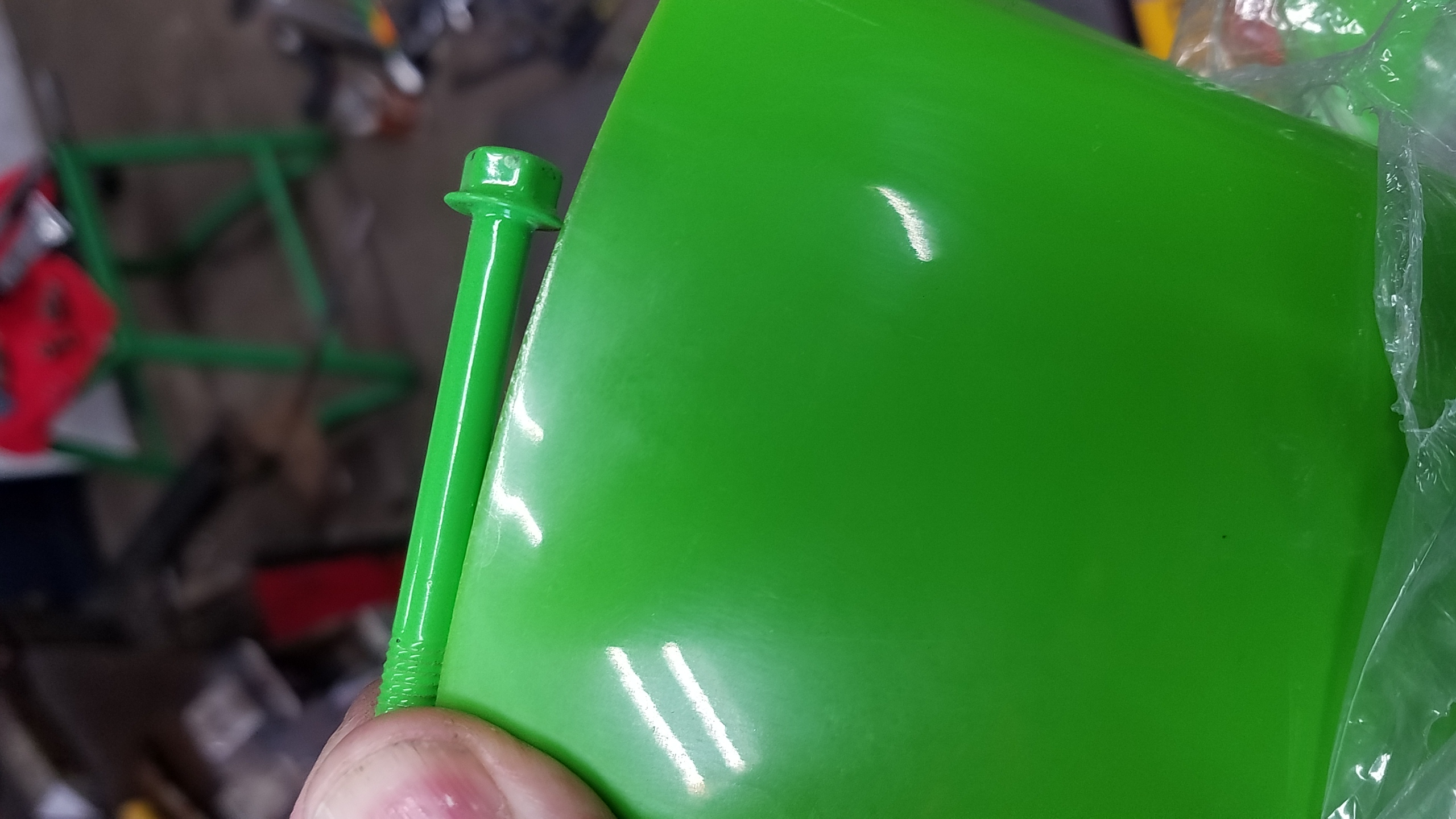

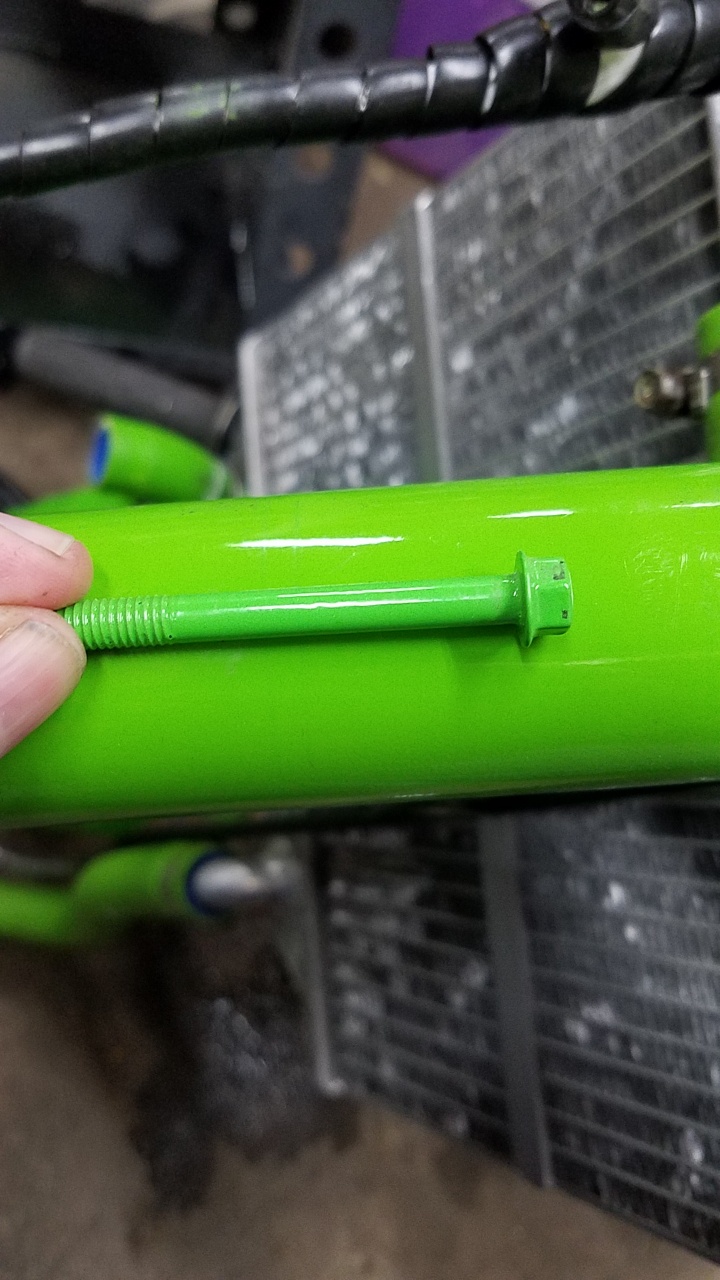

The bolt is in Prismatic Powders Kiwi Green
The frame is the stock KX500 green.

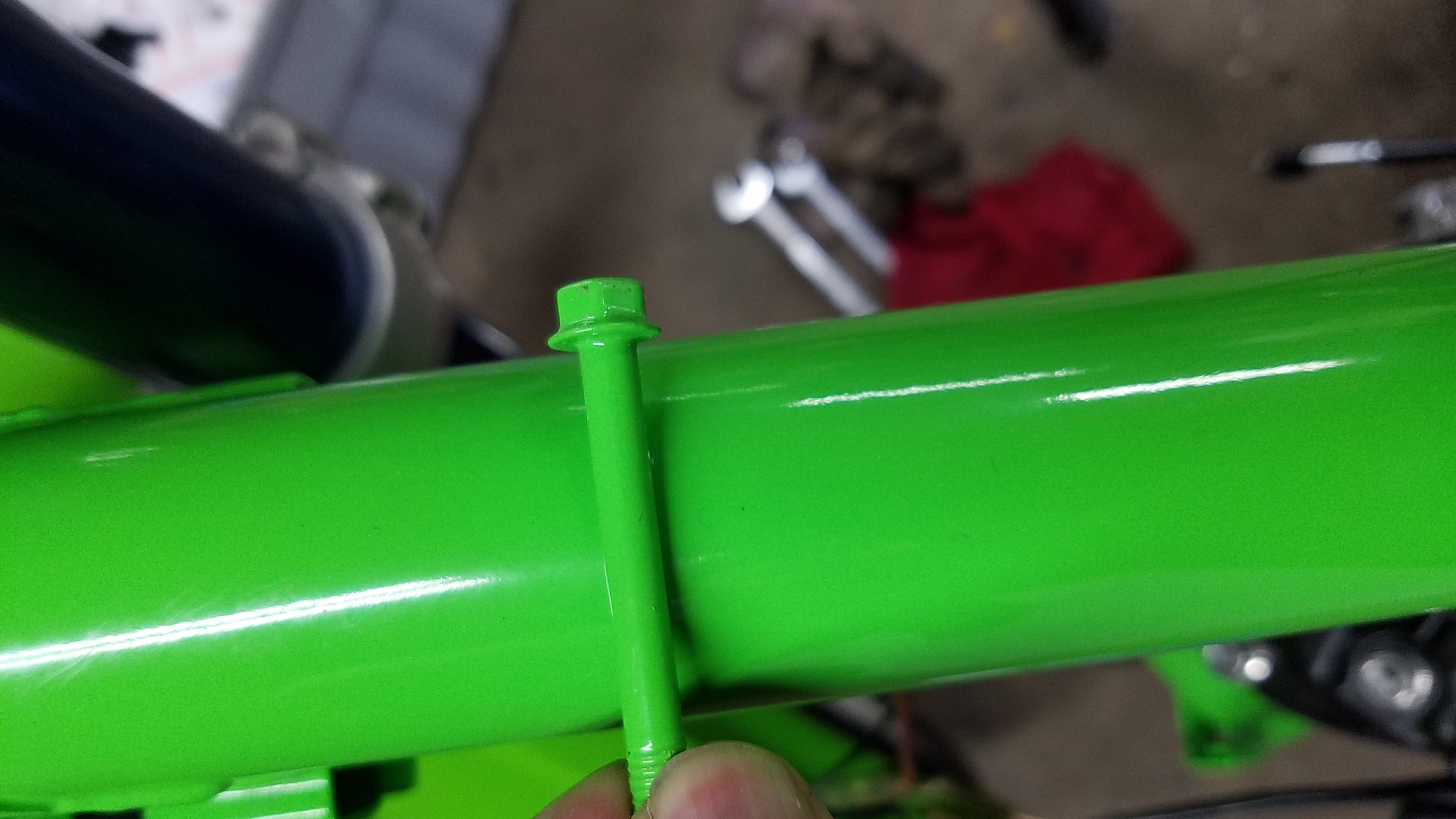

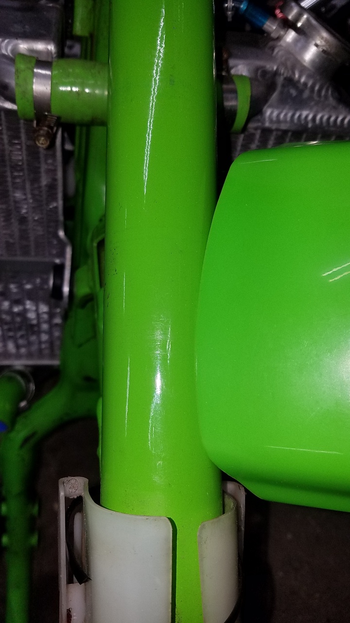

The bolt and the frame is in Prismatic Powders Kiwi Green
Coated on the same day at the same time.
The fender is stock and brand new.
No flash

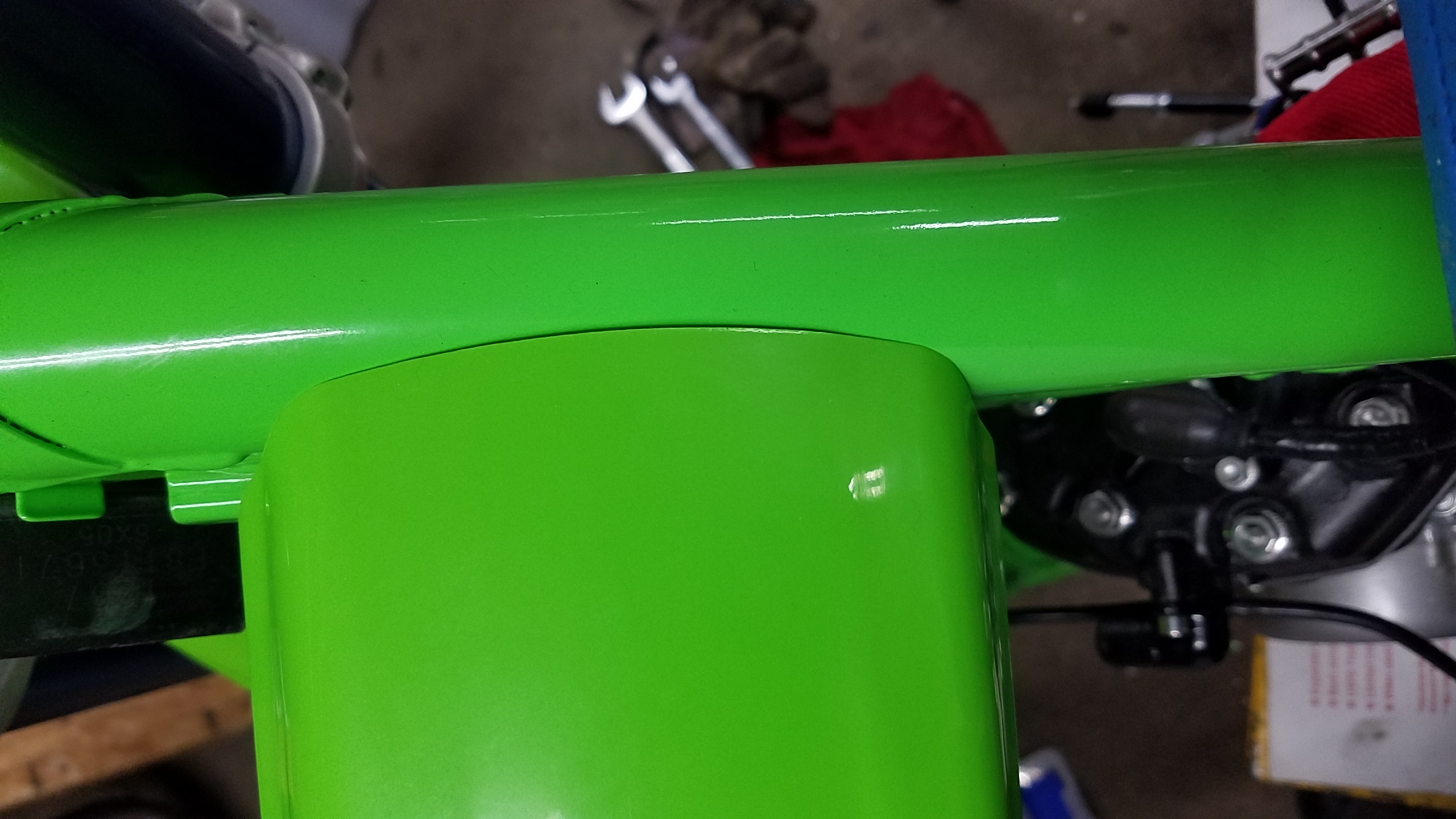

With flash

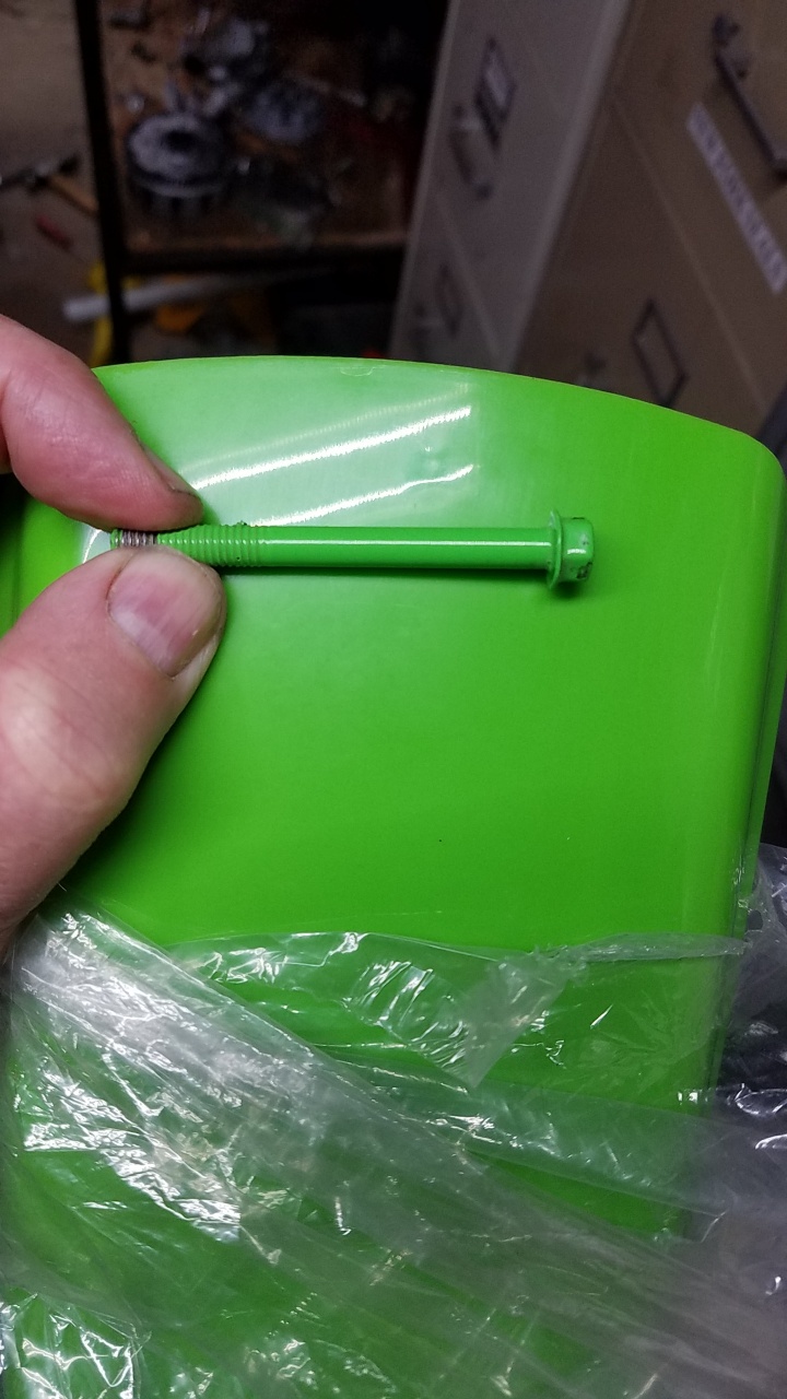

With flash
