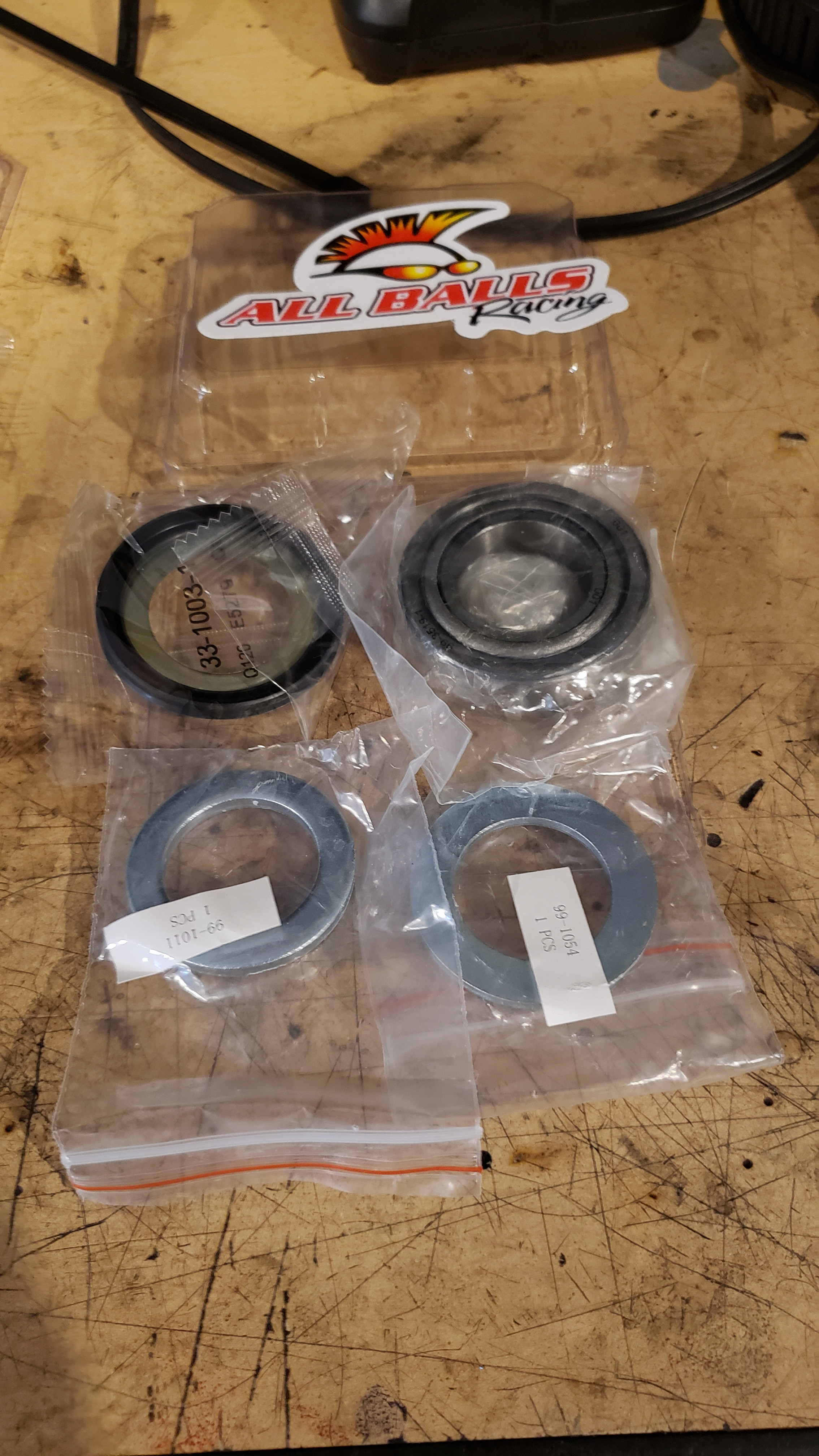

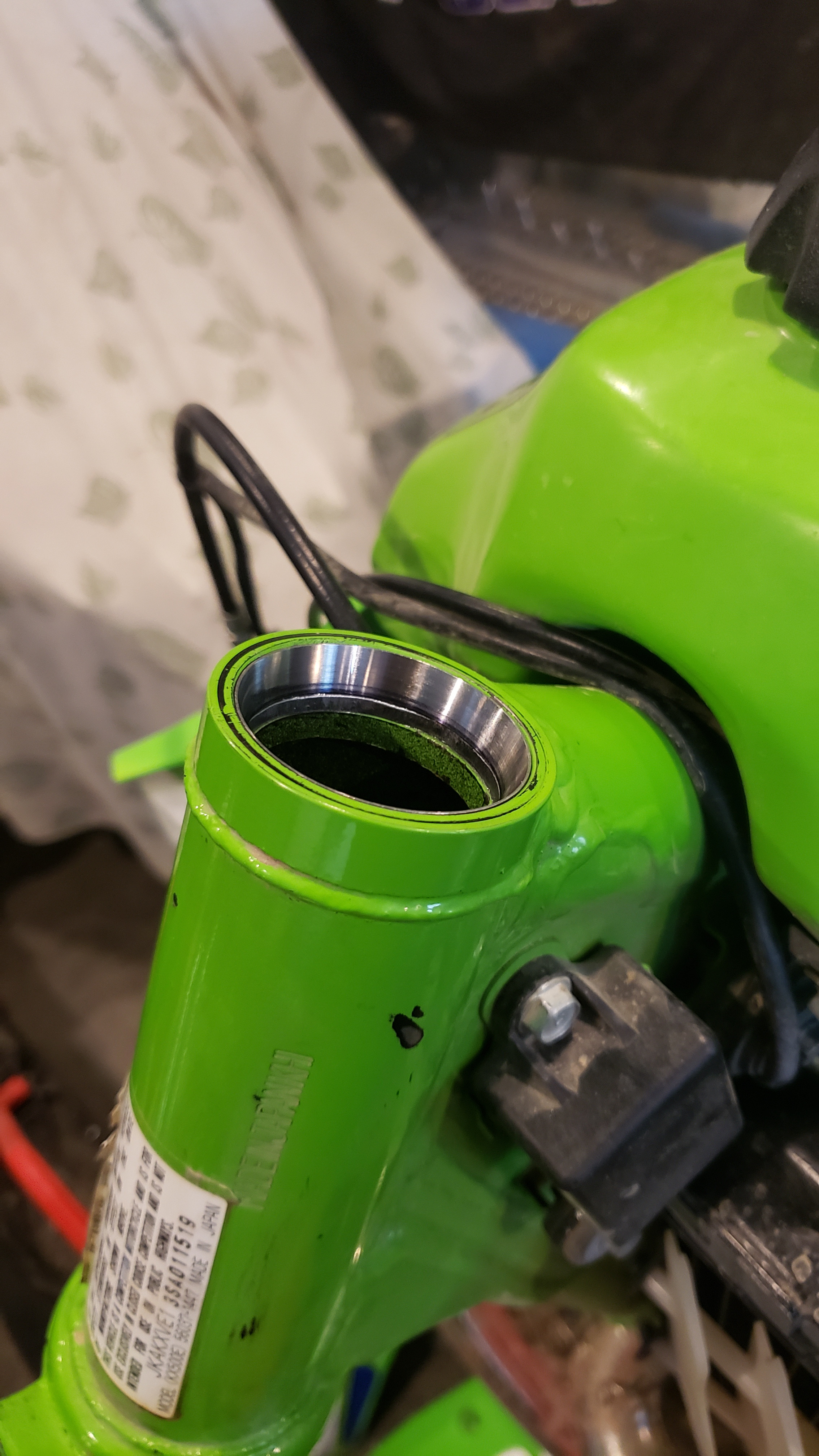

I bought the conversion kits from all balls for the upper and lower steering stem. Here is what came in the box; each box contained the bearing and cup required for the swap, dust seal and 2 washers of different diameters and depths. Good stuff, 3 of the 4 washers in the two kits are not needed.
What's in the box?

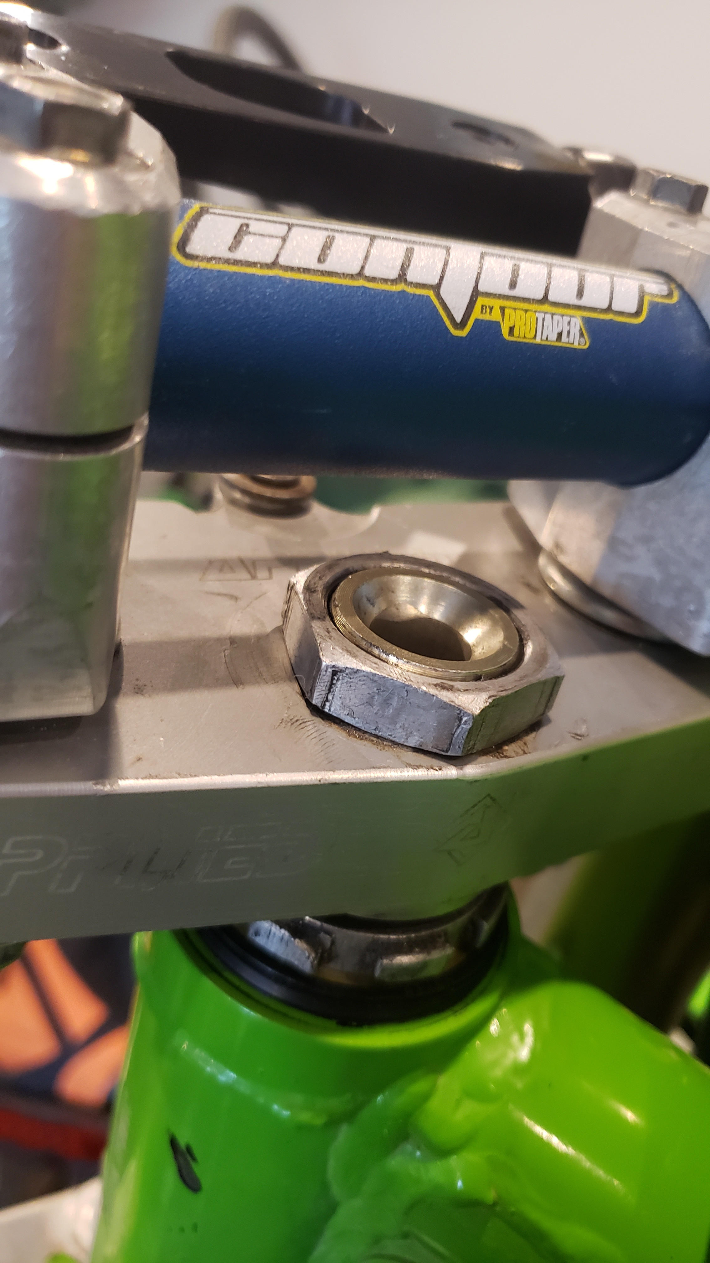

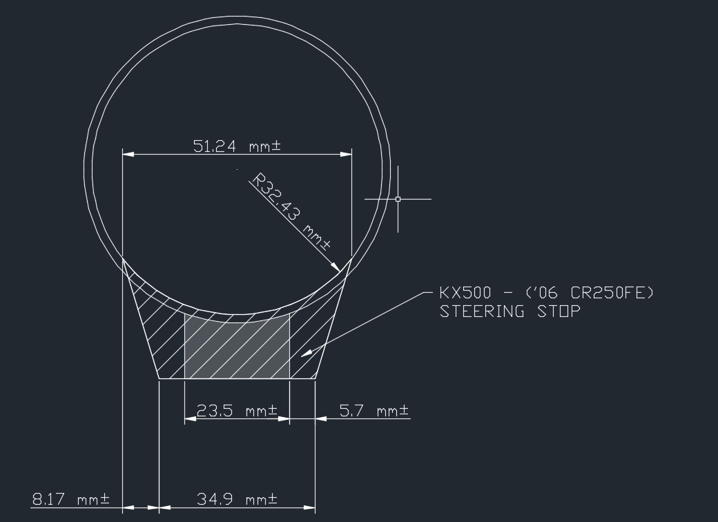

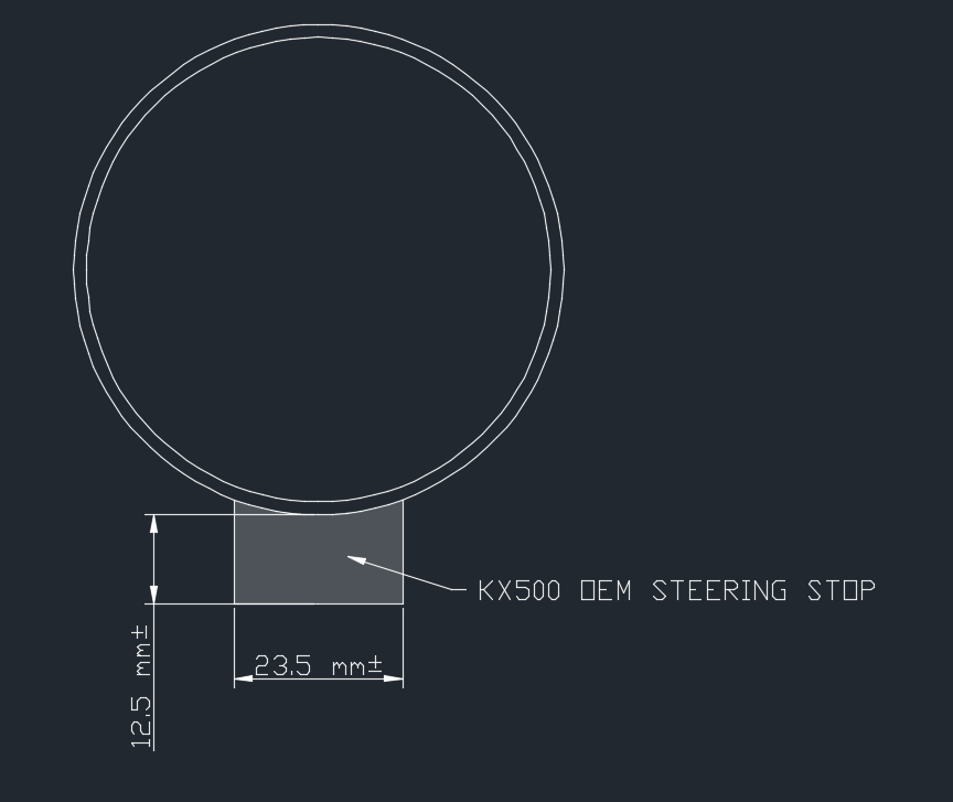

This swap is/was relatively drama free. One of the washers from the conversion kits is the correct depth for the upper bearing race. It is needed as the supplied bearing is 3 mm less wide than OEM. However the washer needed to be modified as follows, the inner diameter needed to be increased to allow the bearing to seat into the cup properly and the outer diameter needed to be decreased to allow the washer to fit into the steering race. In addition a steering stop needs to be created. My solution is to weld on additional material to the original stop tab and frame and engage the tabs on the lower triple clamp. I have it drawn up in CAD.
Fit AND Finish:
CAD:

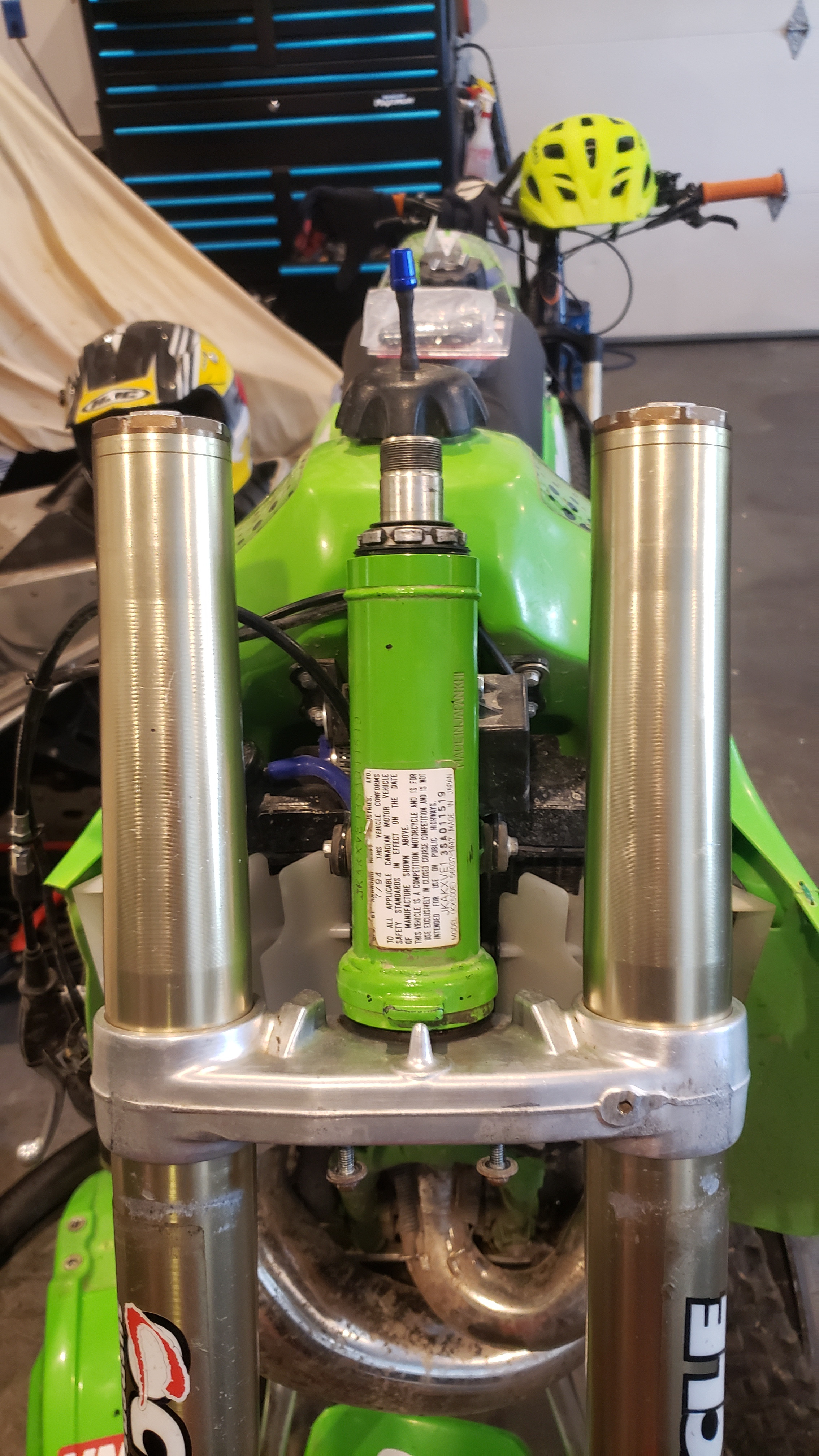

I will post some pictures to show the nut engagement on the triple and how the fitment looks. I couldn't be happier with how it fits.

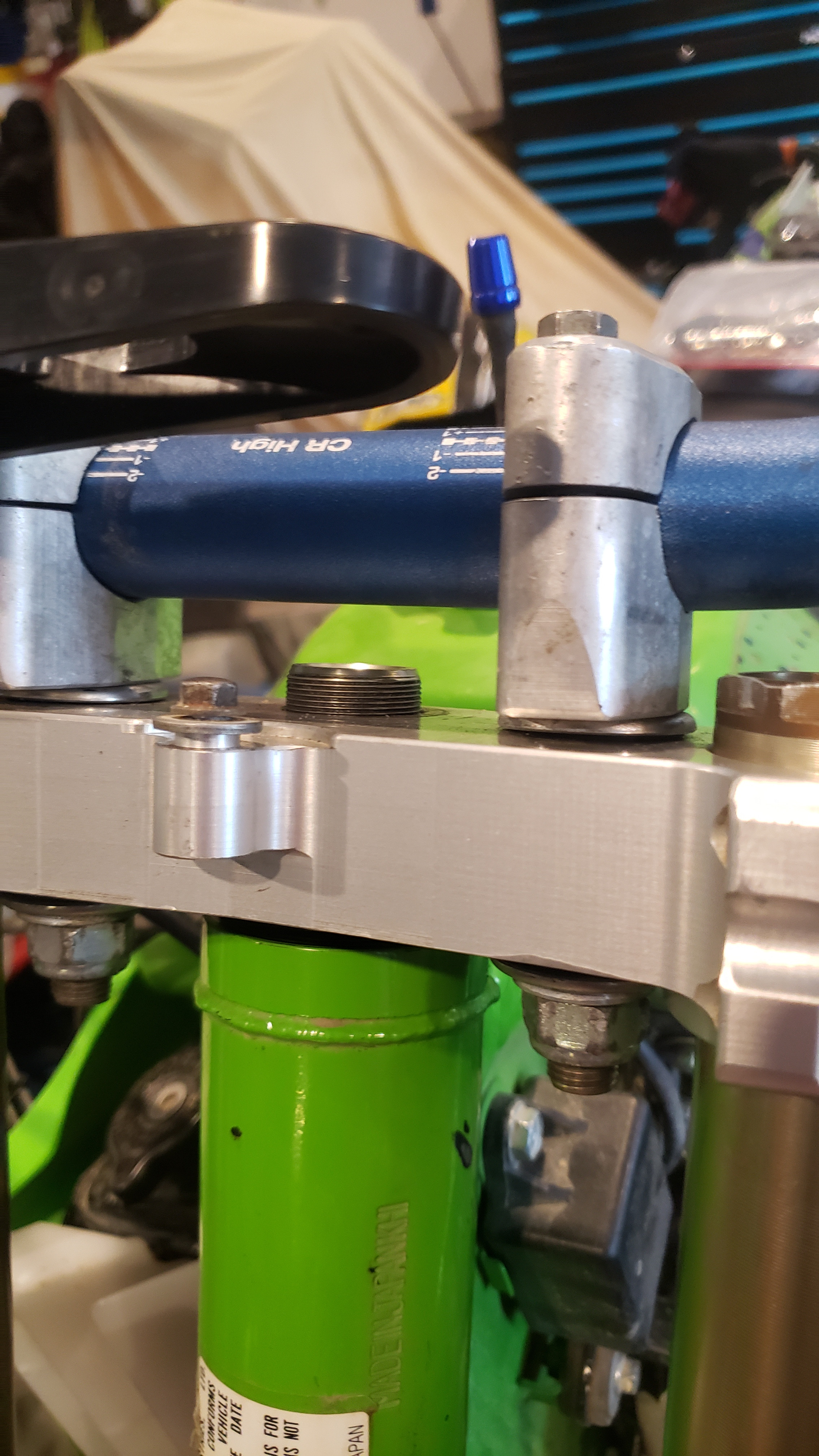

Progress.
I tried the trick engineering steering stop, it needs to be modified significantly, but useable. The bottom triple clamp needed a slight modification as well so that the bottom number plate mount did not interfere with the steering stop.
The steering stop and the triple clamp as it came:
I had to flip the steering stop over so that it cleared the nipple for front number plate for test fitting.
Modified steering stop and number plate mount:
I decided on about 1/4" - 5/16" clearance from the fork tube hitting the radiator cap. I may take more material off the steering stop after a couple of rides. Maybe take enough material of the steering stop to close the gap up to 3/16" or so.
The nipple on the bottom triple clamp for the front number plate can be cut down to clear the steering stop. It allows the front number plate to engage the nipple with enough material to not be an issue. The bolt for the number plate is at the top and essentially locks it in.
