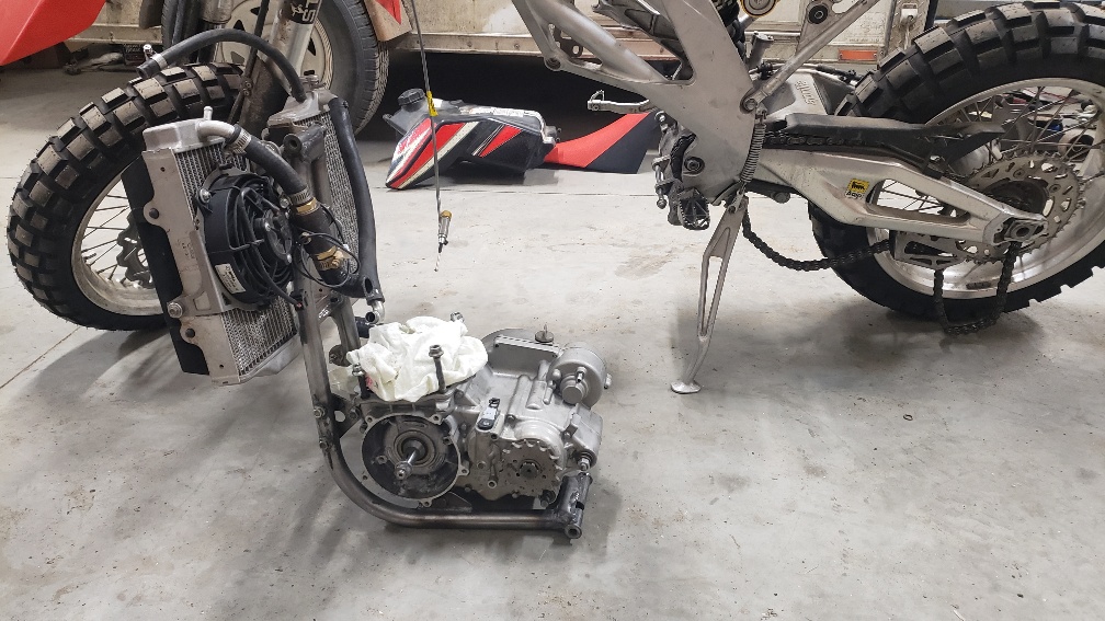

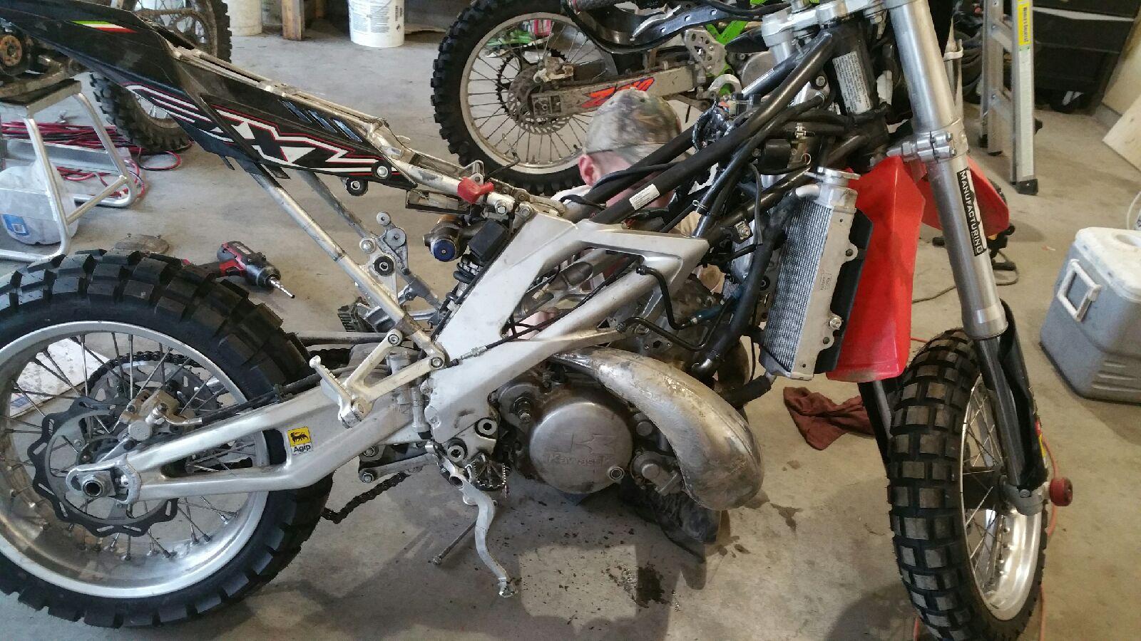

I bought a used 2008 SXV 550 and ran it for a summer and then in the spring when I fired it up for my first ride I checked the oil and it had the milkshake (leaking head gasket those engines are known for) on it. Then I pulled the engine apart and found the sleeves, the pistons, the camshaft were out of spec. Fairly pricey to replace all that so I thought why not put a KX500 engine in there.
I tried using the frame rails from the KX500 frame but they just wouldn't work out. Used a tubing bender and made frame rails from 1" chromoly tubing.

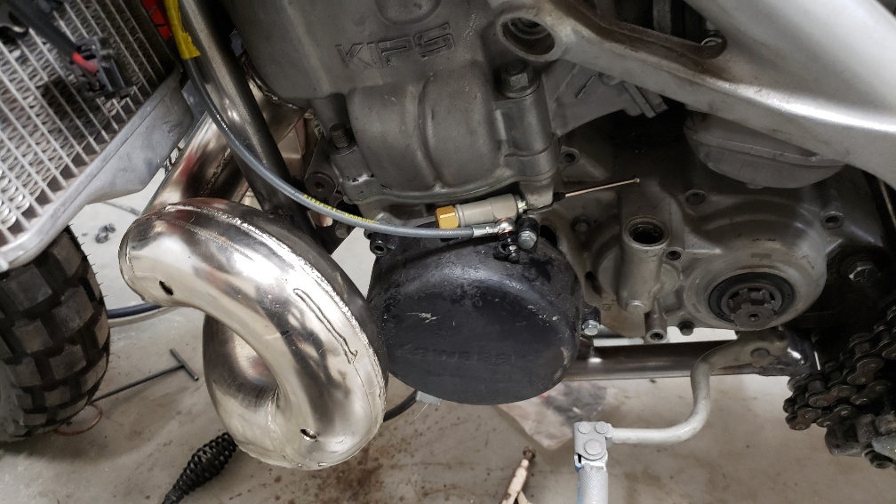

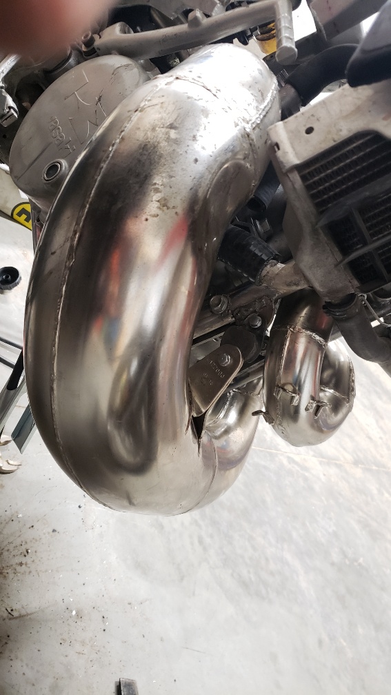

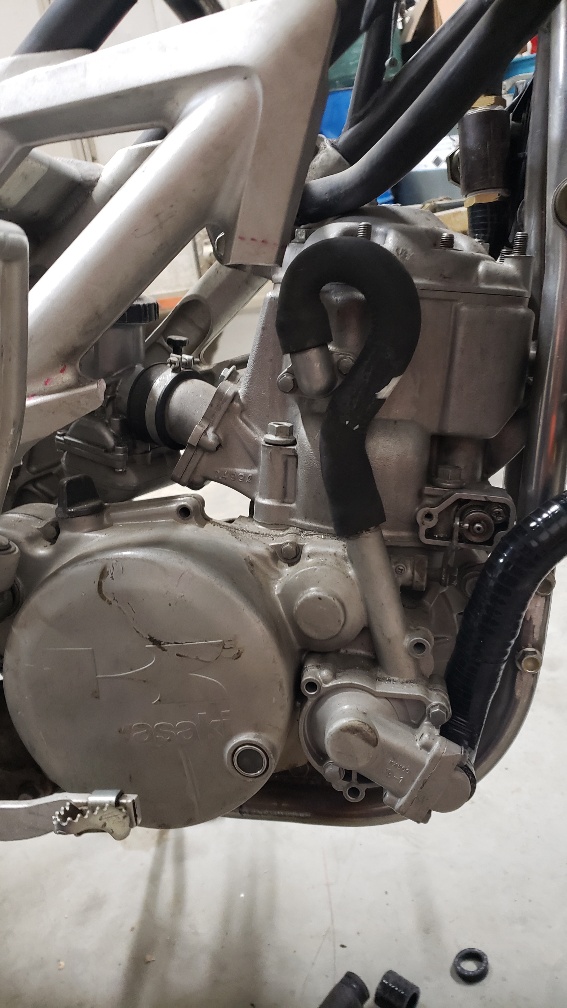

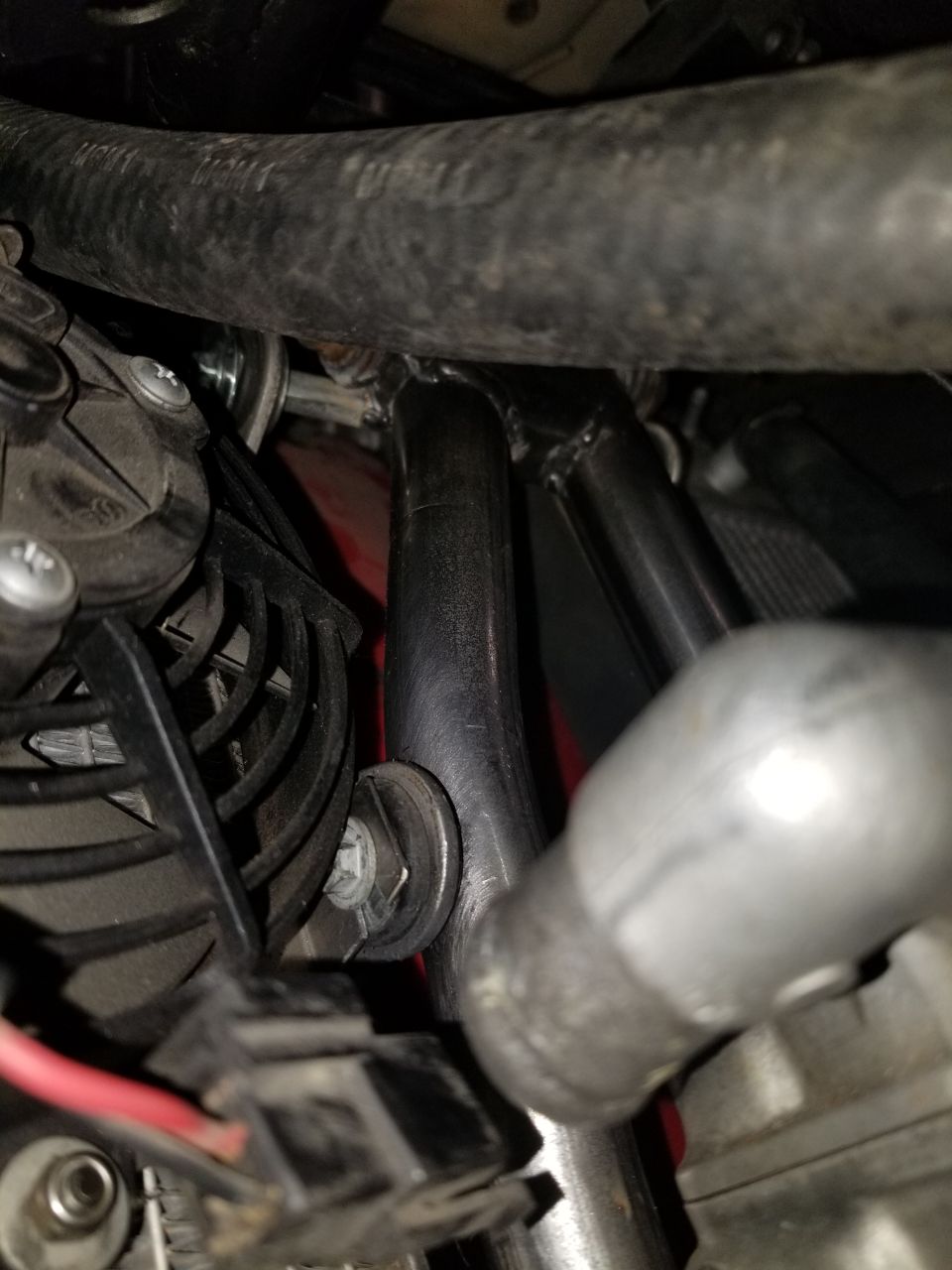

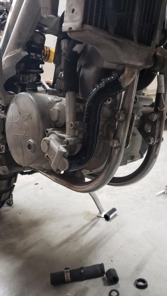

The pipe is a Service Honda gnarly, used a dayco part # 71415 hose to flip the coolant fitting on the cylinder
Hardest part of this project was taking a recip saw to the beautiful Aprilia frame

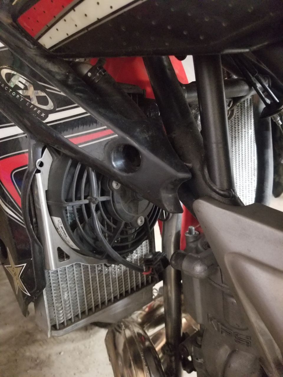

The rest of the coolant lines I built mostly from pieces I got from Pegasus racing, they sell different bends in lots of different sizes of hose

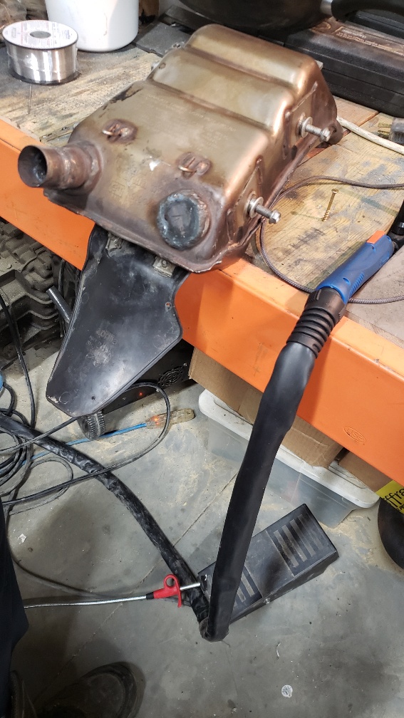

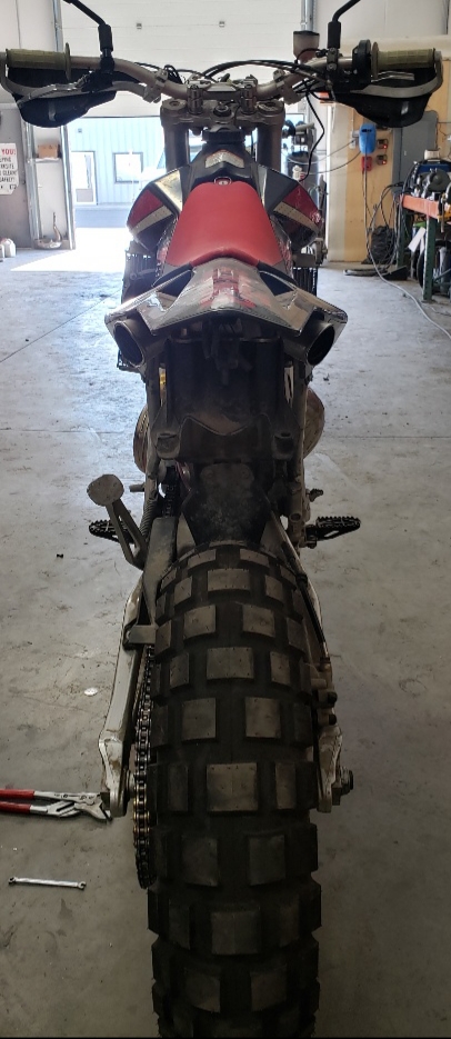

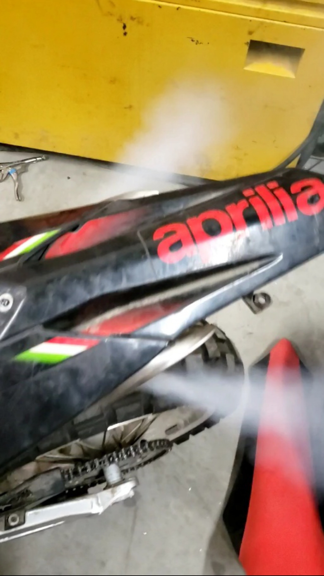

I used the stock silencer. It's a cool design on these bikes, it sits under the seat and functions as mud guard for the rear tire, then it has dual slash cut tips that come out behind the rear of the seat. Since the original engine is a v-twin I capped off the left side and ran the pipe into the right side. Works pretty well, exhaust seems to come out of the tips evenly and it's fairly quiet

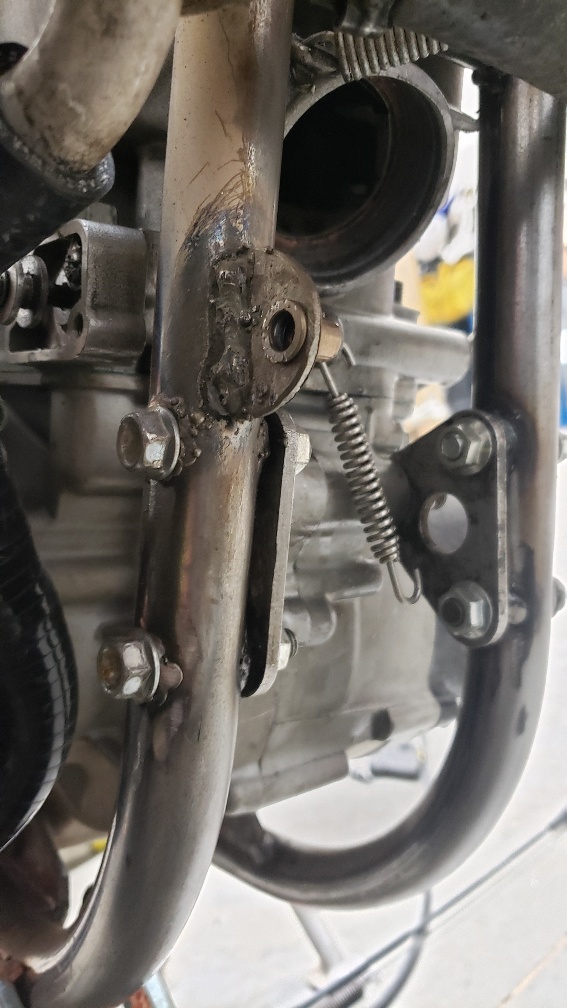

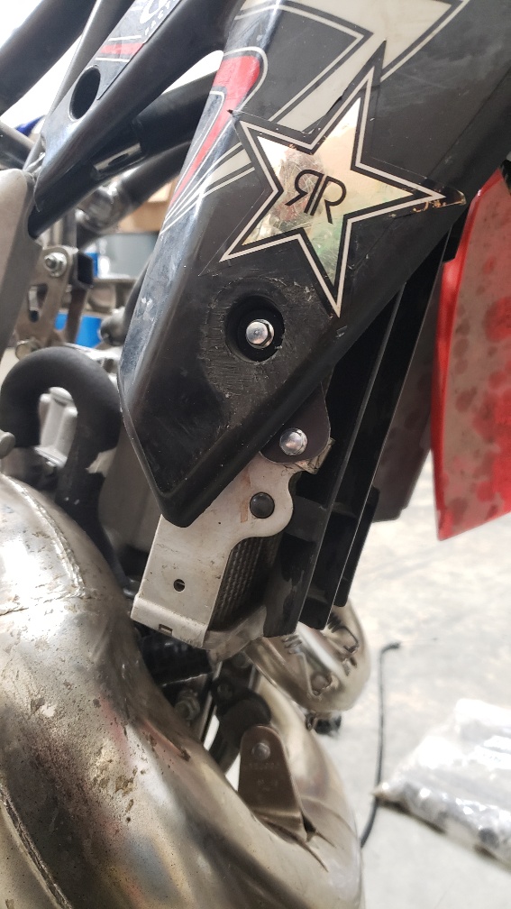

Head mount

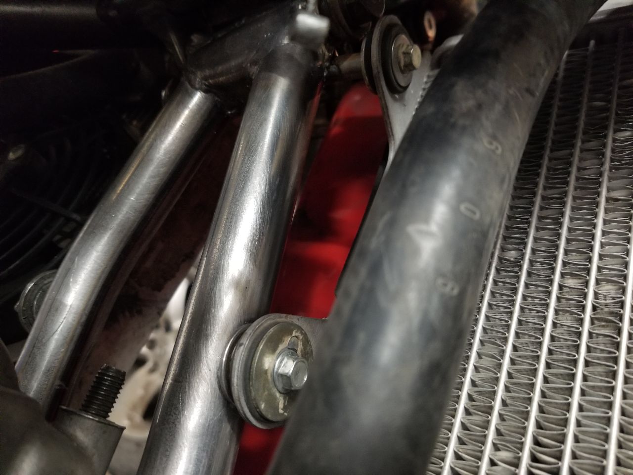

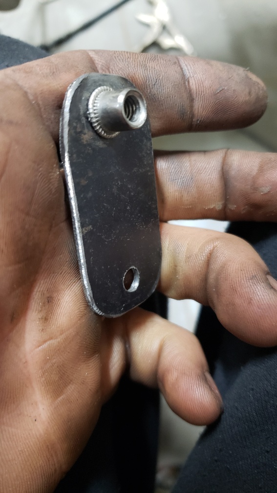

Radiator mounts

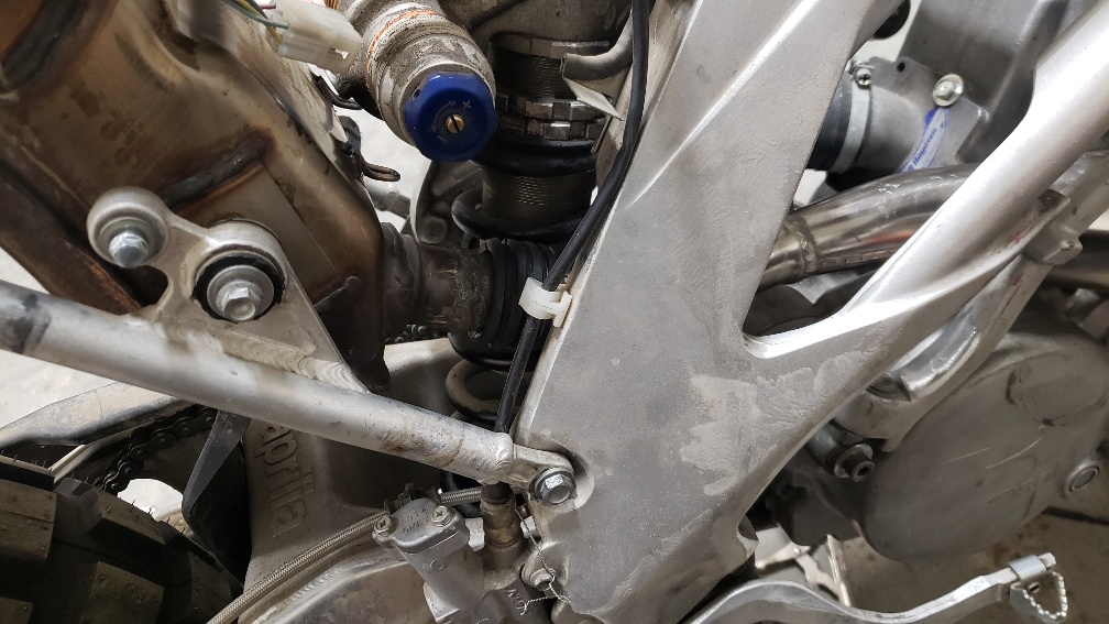

Bottom of the right radiator was moved forward a little so made a bracket to adapt the rad shroud

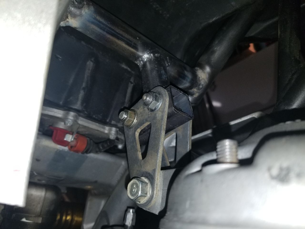

Swingarm pivot engine mount

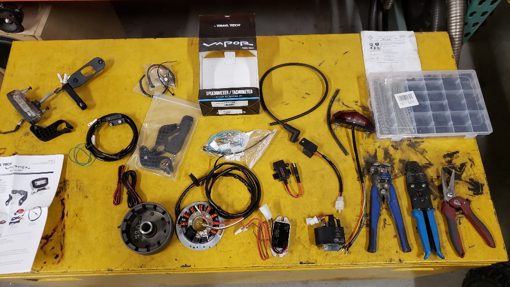

Used an MZB Penton ignition, I love the kit they make. Also used a small (1.7 farad) capacitor bank instead of a battery. Lights don't flicker and I won't have to worry about battery maintenance

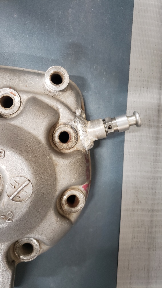

Did my own decompression head, welding cast aluminium sucks but it works

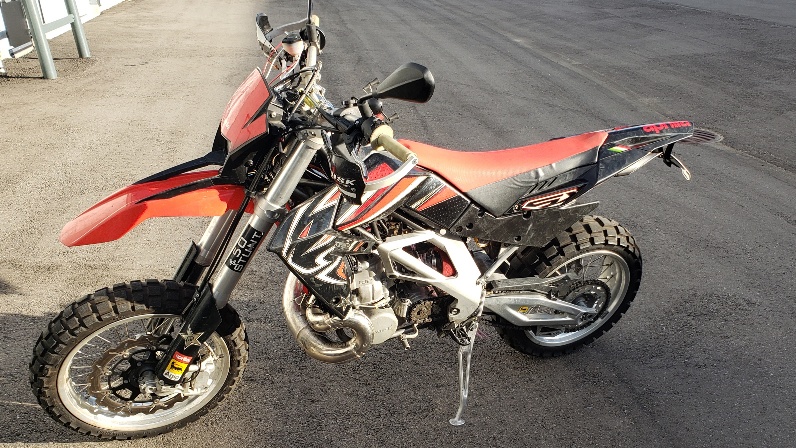

Rides really good, I have a CR500 supermoto and the KX engine is smoother, works much better as a street engine IMO. I'll try to get a video of it in action just have to get my buddy who has a go pro
I forgot to mention it has boyesen reeds, I updated my other post
Also it weighs in at 290lbs with a half tank or so of gas
