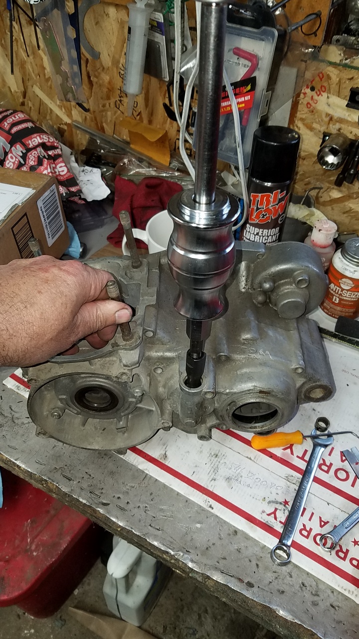

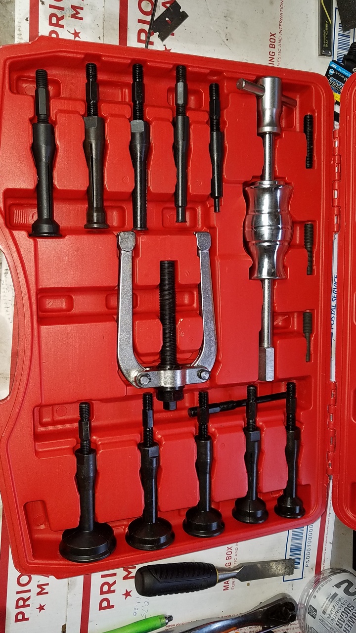

I have and used the Motion Pro kit for about 20 or so KX500 builds and then the puller broke and they would not sell me another. They wanted me to buy another kit.... Nope.
I hate to admit it but I jumped on amazon and ordered a cheap kit.
It works just fine... so far :lol:
https://www.amazon.com/Generic-Bearing- ... 37&sr=8-11
Here is the kit..
1st bearing gone...

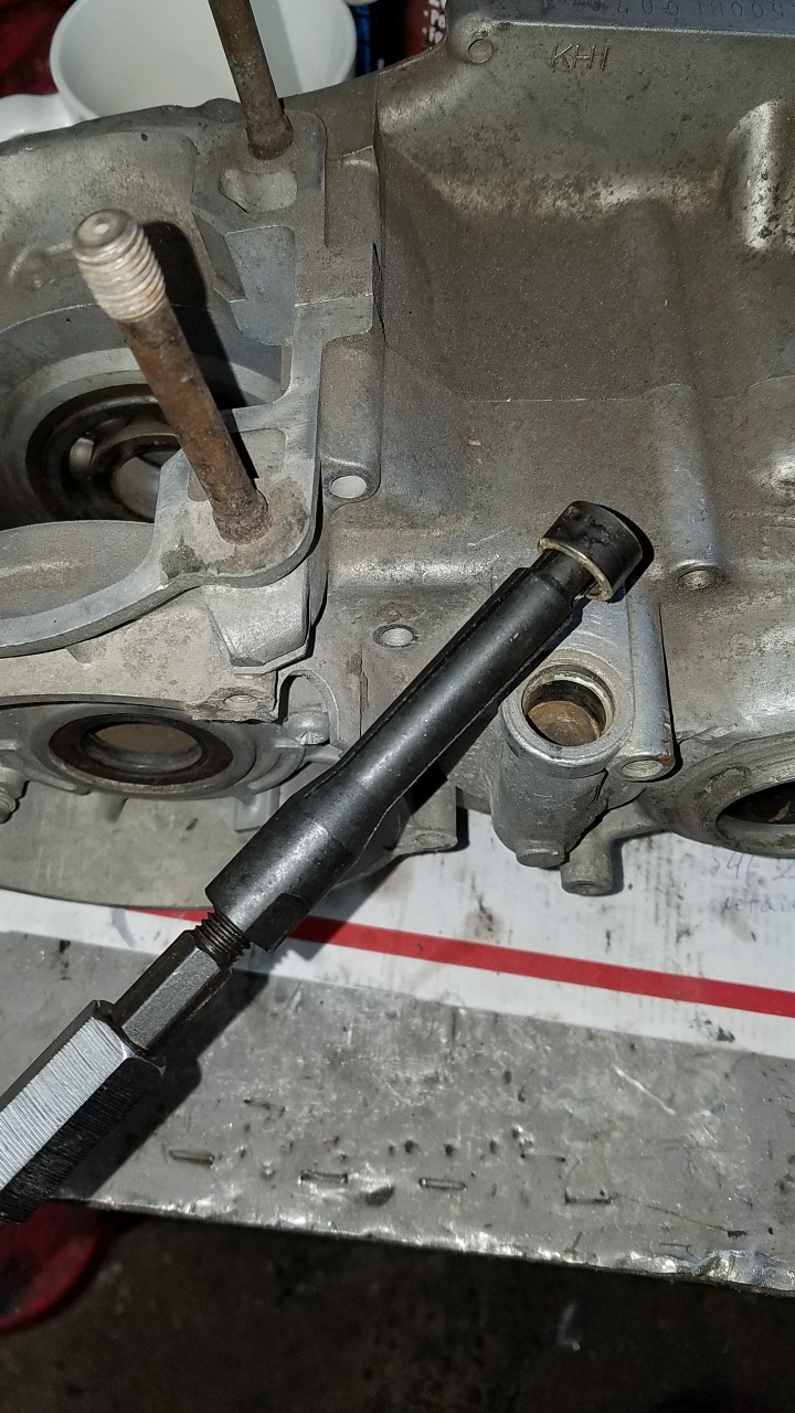

Set up for the deep bearing... Yep, the tool is plenty deep..

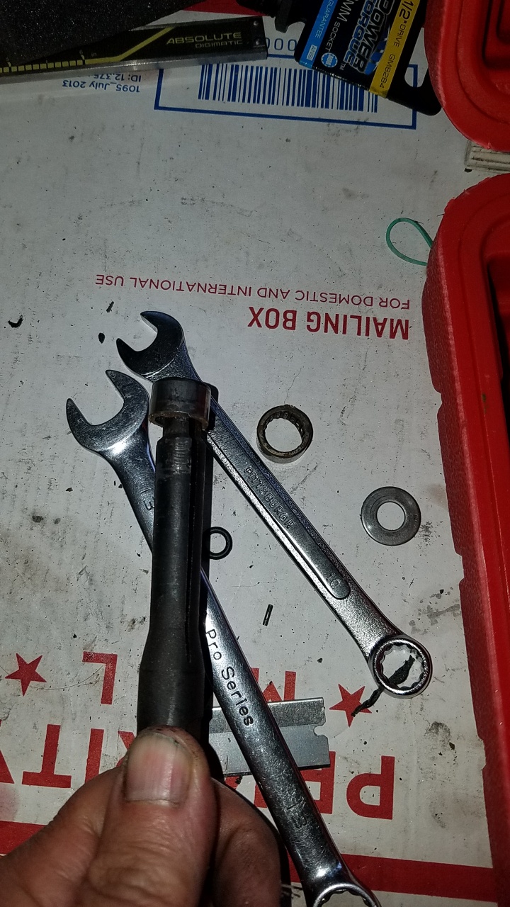

Done..

Thanks for the response. I was looking at some of those cheap amazon kits but I couldn't tell how long the collets were. The descriptions and reviews were both equally unhelpful. I'll be ordering that kit soon. Keep up the good work!
